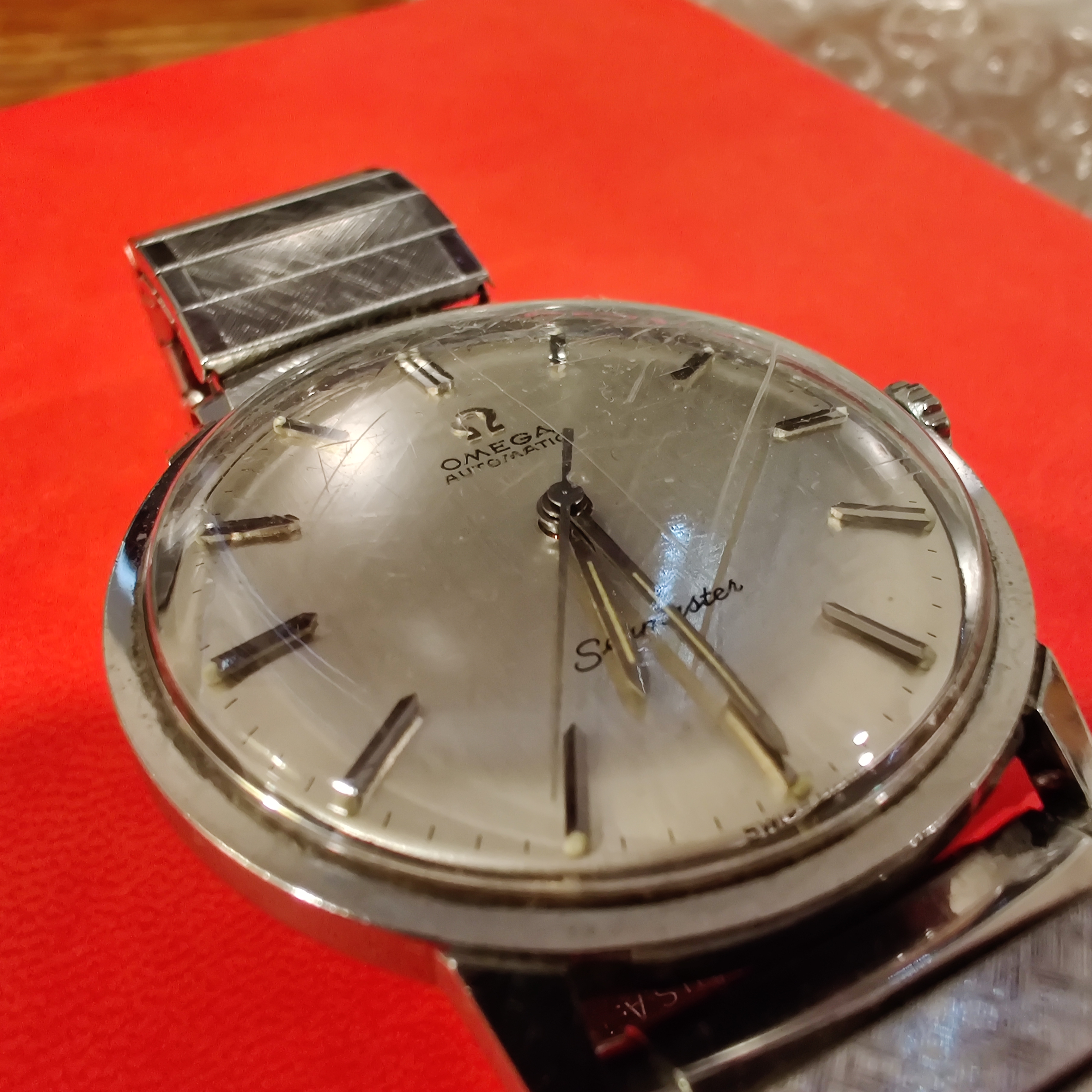

Alright Gurus! Here’s one for ya!

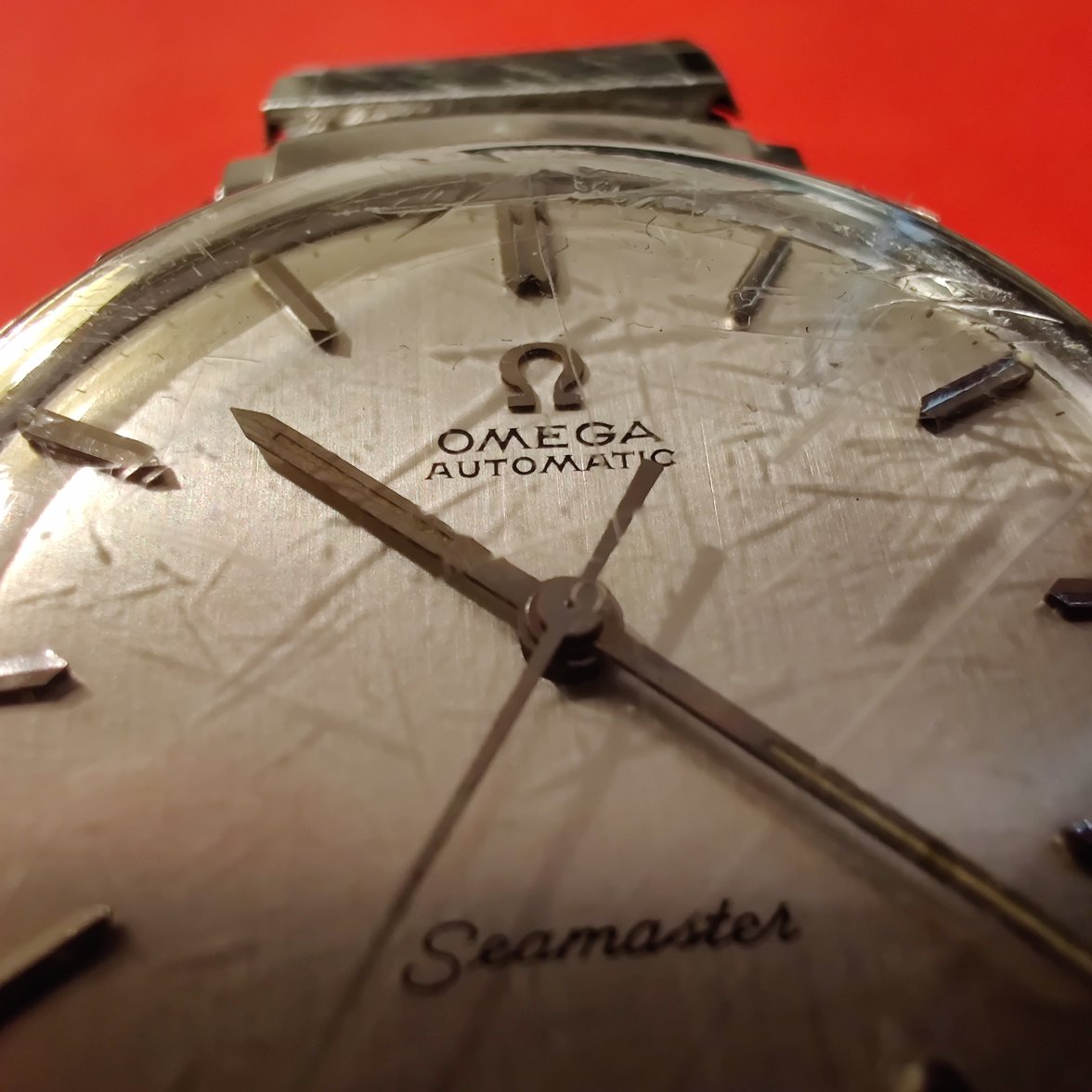

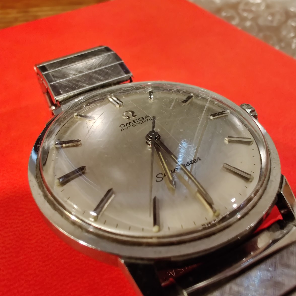

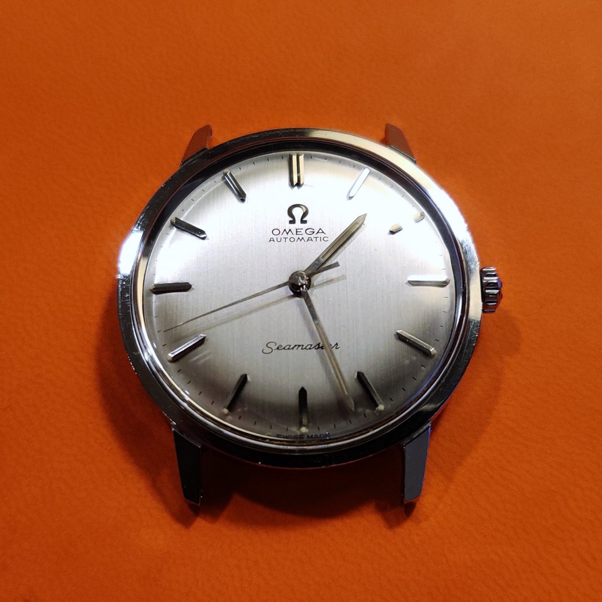

Here are more photos. I took the band off to gently clean it with a dry toothpick and Q-tip. I don’t know if it should get wet at all and I’m afraid to chance it. I’m sure that it resists water having survived all of these years!
Good photos, but I would absolutely not assume that water resistance is something you won't need to worry about. Every passing minute makes the watch more vulnerable to moisture and is the top reason to make investing in a service a priority. The crystal and the gasket in the caseback need to be checked and possibly replaced, and the crown bushing may be another problem area. I'd say it's not worth it to try cleaning it.
Would having the back opened for the serial number tell me exactly what I have?
It would certainly help. The tools and the skill needed to open that kind of watchback are not generally available around the house, so—well, you know what I'm going to say. Local independent watchmaker.

Great find!!! I wouldn't wind it anymore. I'd get it serviced and either replace the crystal, or see if it can be polished. I'd bet my pension that it hasn't been serviced since I was skinny and had dark hair. You will risk wear and possibly parts damage if you continue to wind it, the oils probably dried up when Truman was President.

I agree 100% that this watch deserves a proper service. Parts for these bumper automatics aren't super easy to come by, so preserving them with proper cleaning and lubrication is better than replacing them. @AnitaVarney this is a fine watch in surprisingly good condition. The case looks to be in pretty good condition and the dial has an even and pleasing patina. It looks to me that the crystal is too far gone to really come back well with a polish. I would have it replaced with new a genuine Omega crystal. I wouldn't have the case polished because you would lose the crisp edges and a shiny case would not go well with the aged dial. Finding a strap will be fun. Check out this thread for some inspiration:

In the second set of photos it looks like there are cracks in the crystal to, but I could easily be wrong.

Agree. There are shrinkage cracks in the crystal meaning that it should be replaced. Water resistance is definitely comprised.

I appreciate everyone’s feedback. It’s keeping perfect time, which is pleasing! I cleaned the band up to wear it around today and see if I really want to keep it. I agree now that it’s definitely patina; but looks nice!
