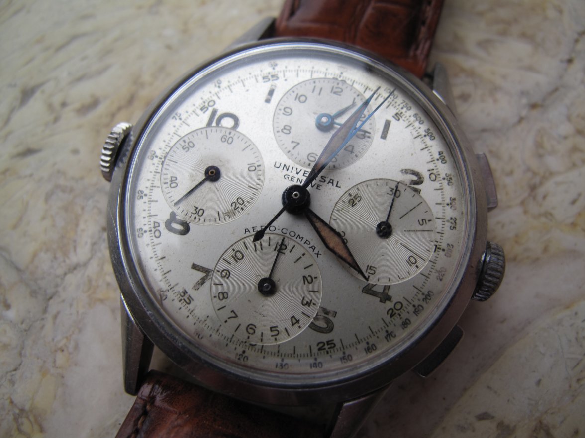

Hello all,
I am the owner of this watch. Thanks to Larry S for opening this thread
I have no problem with this discussion and I encouraged Larry S to initiate the thread.
Thanks to all members who have taken the time to post in this thread.
I bought this watch off the original owner who bought it in New York after the war. He was 92 years old when he sold it to me so he may have forgotten things. I spent about 3 hours at his house and he appeared to have all his marbles!!!
The original owner told me he had only had the watch serviced once, in 1959, and he stopped wearing in 1961 as he bought a Rolex Submariner. He didn't mention that the dial had been replaced and he is no longer alive to ask. I suspect he would have mentioned it if it had been as he said he treasured the watch.... I felt a bit guilty about buying it and asked him if he was sure he wanted to sell this watch. I bought 4 other watches off him, he didn't care a toss about the others. He actually had every watch he had ever owned. He said he was selling them as his wife had died a year or 2 previously and he had cancer. I used to have an add in the paper looking for old watches and he had seen it and called me.
I paid him pretty reasonable money for it, I cant remember exactly how much. I always tried to pay good money to people like him.... you would be surprised how many referrals I used to get from seller like him... it was good business to do so.
I don't care what the watch is worth, or if I ever sell it. Like most watches, its the story behind them that's really interesting.
Regardless of the outcome, I will always fondly remember meeting the original owner of the Aero Compax.

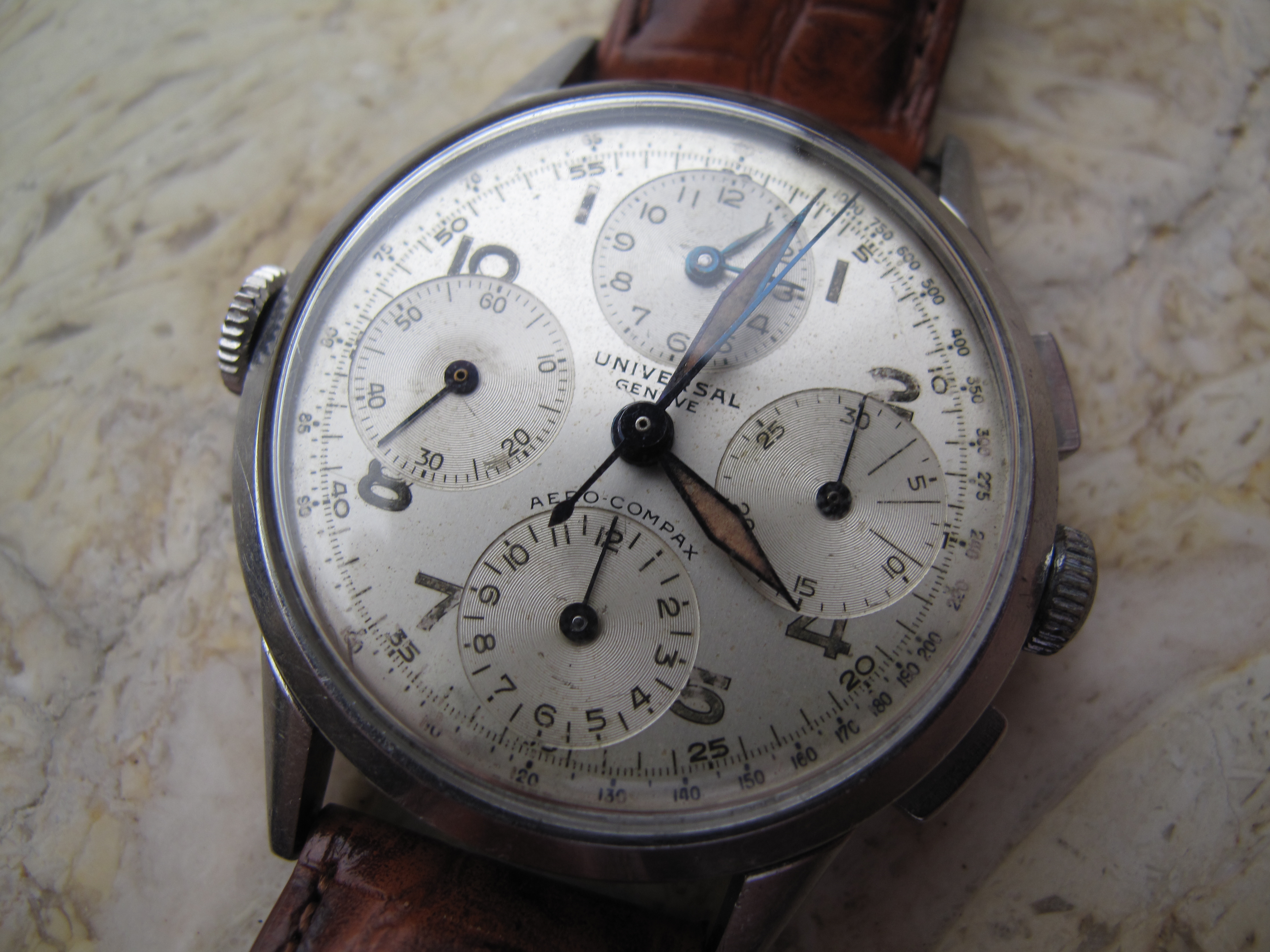

The initial watch in question is a redial. All the font if you look closely is incorrect. All the numbers, letters, etc. It is a clear redial.

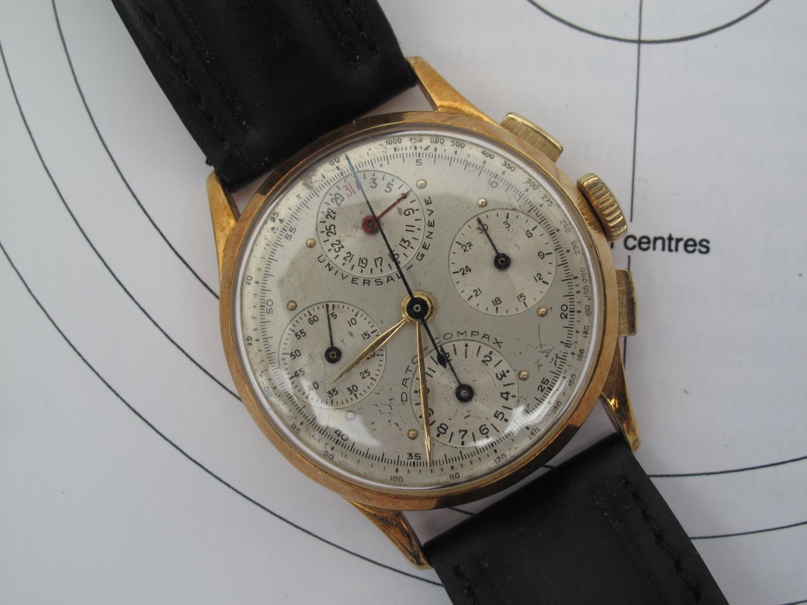

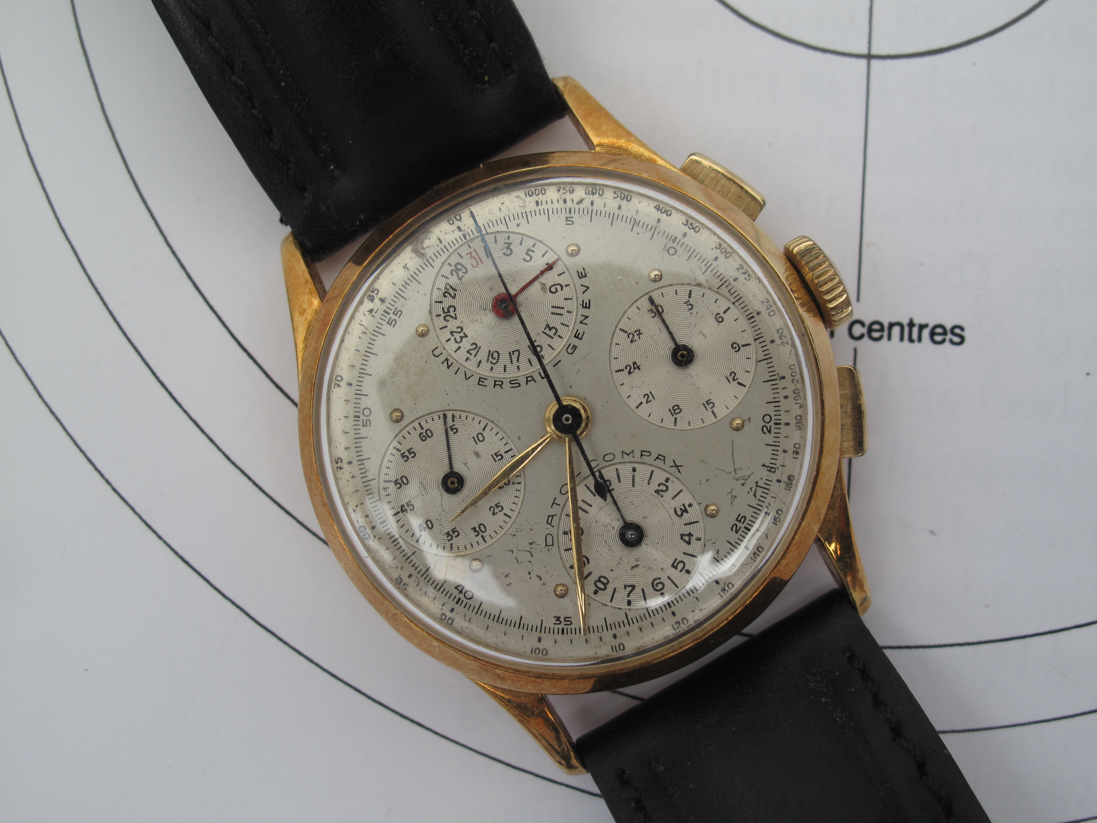

Here's my Aero-Compax, a 22547 rather than a 22289, but the serial number is close at 1068xxx. The rounded threes worry me in the OP, but not as much as the off-centre recorder dial at 12 o'clock. the A's look a bit wonky to me too. But we're talking about Universal, and they put out some shockingly bad dials back in the day. I've also attached a picture of my Dato-Compax: I'm pretty sure that's original, but the dial design looks like the work of a happy kid with a crayon.

I am a little late but original Aero on this thread is a redial. Sala's is great, but there are lots of questionable references and photos. @MattF hi nail on the head. Totally agree with your assessment and comments ! 😀

For the education of those of us that don’t know these watches but want to learn- what are you seeing on the OP watch that says redial to you- specifically?
With every new watch posted in this thread I see variations in every dial, different use of serif or non-serif, different placement of text and numbers, mixed open 6’s with closed 6’s, flat topped 3 and rounded 3’s- all on the same dails but in different places. There is even a crossed 7 !! It looks like UG was all over the map- how can we possibly know what came out of the factory with this many variations?!
3,697
8,509
There's almost nothing "standard" about the dials in question. But the rounded 3s in lower subdials, the closed 6 and 9 in hour sub, the use of different numbers altogether in the tachy scale, the UG and aero compax fonts, the lack of Swiss, and the lume plots at 3-6-9-12 is plenty to focus on.

There is also 3 different font used for the 4.
But doesn't it means that both (subject and Sala example) have been "re"dialed by the same company very long times ago ?
I never seen someone able to make an ageing Lume like this.
