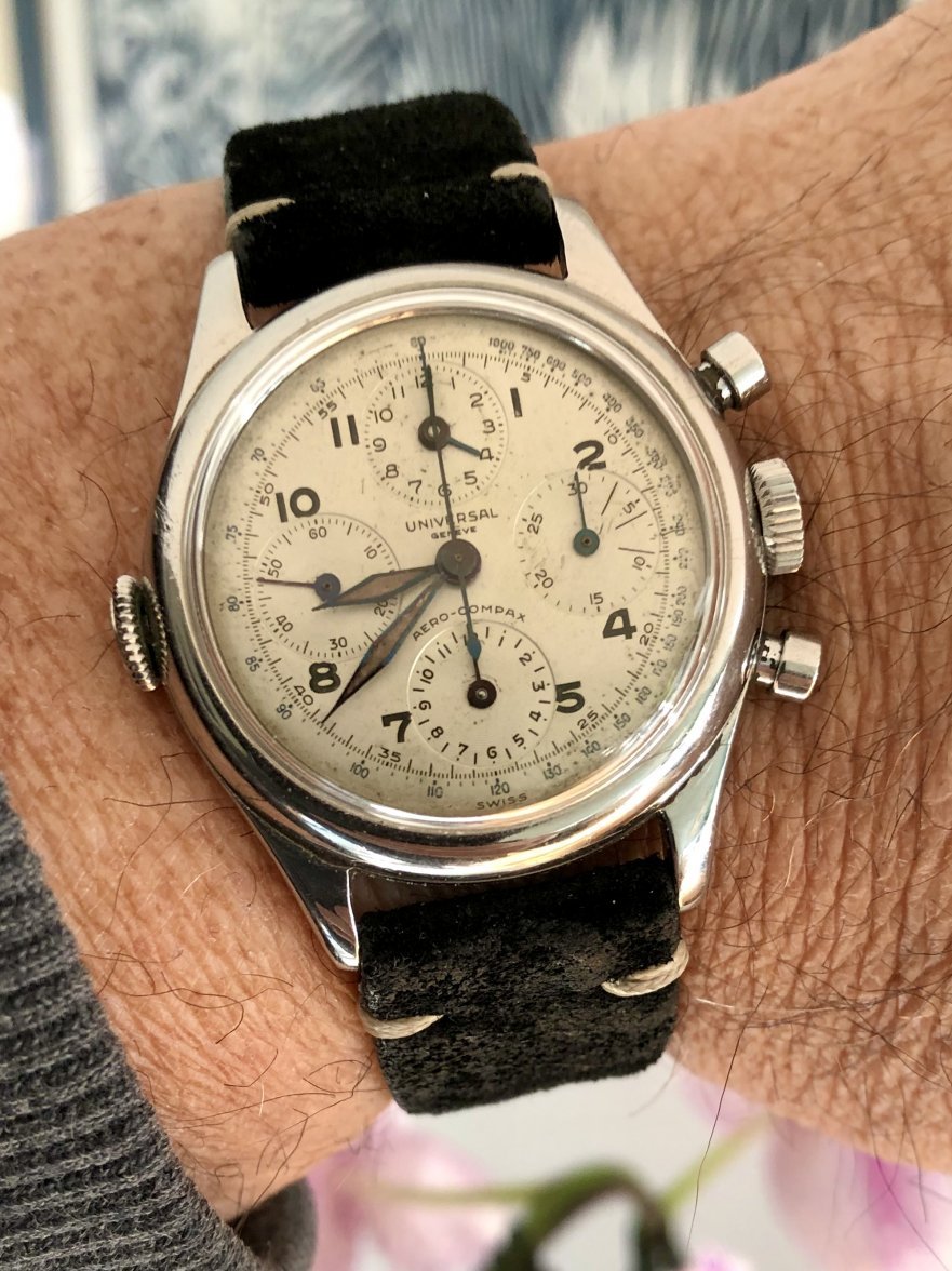

I post this with the encouragement of @oinkitt who is the owner of the piece discussed in the 25.12.19 link on this thread. I also invite him after he gets done fighting fires in OZ to opine here as well. As has been discussed, we should have moved this debate away from the FS ad per the rules. Here is an opportunity to add another reference discussion to the UG Sub Forum.
https://omegaforums.net/threads/withdrawn-from-sale-universal-aero-compax.106649/

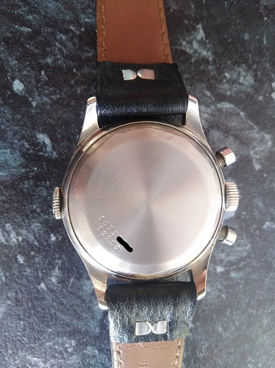

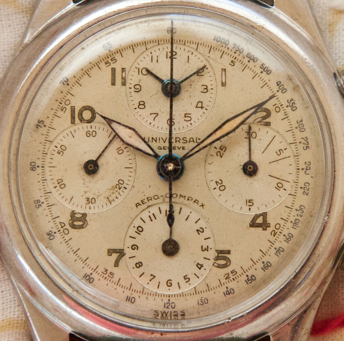

To make a long story short, one LT member disagreed with the original dial claim and was seconded by another member. No specifics were provided. Per OP request, I posted more detail on what concerns possibly were, others opined and the watch was withdrawn. There was also the matter of the chrono hand not being blue, but I think that has been explained. The challenge herein is that there is a color plate in Sala for this reference that matches the OP watch. The B&W plates however contradict the color plate. @bgrisso and I also own this reference with a very different dial and a 3 in the fourth SN position vs a 2.

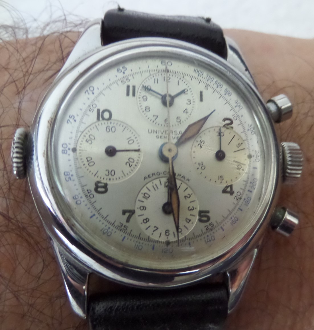

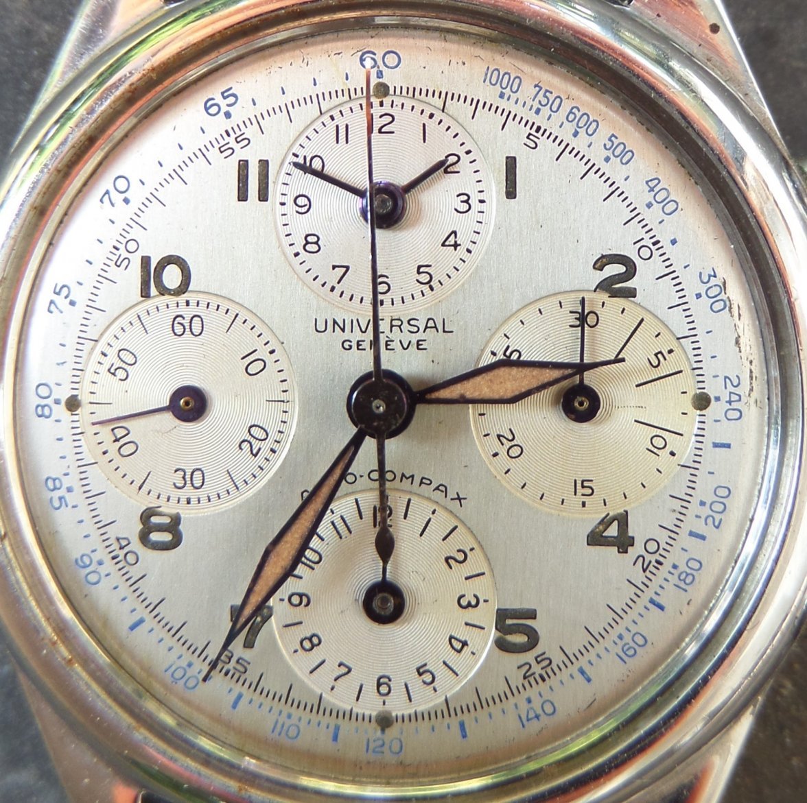

Photos provided by @oinkitt: (crystal on and off)
The suspected issues: rounded 3's on hour and seconds subs and odd 3 on the minute sub/Closed and open 6's/printing not as fine on the outer scales, UG logo seems to crowd the upper subdial....and of course the color of the chrono hand. No Swiss.

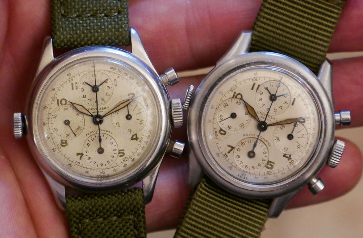

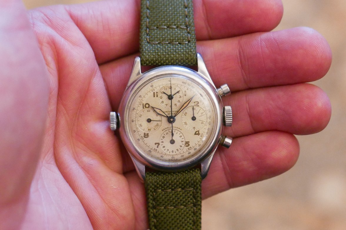

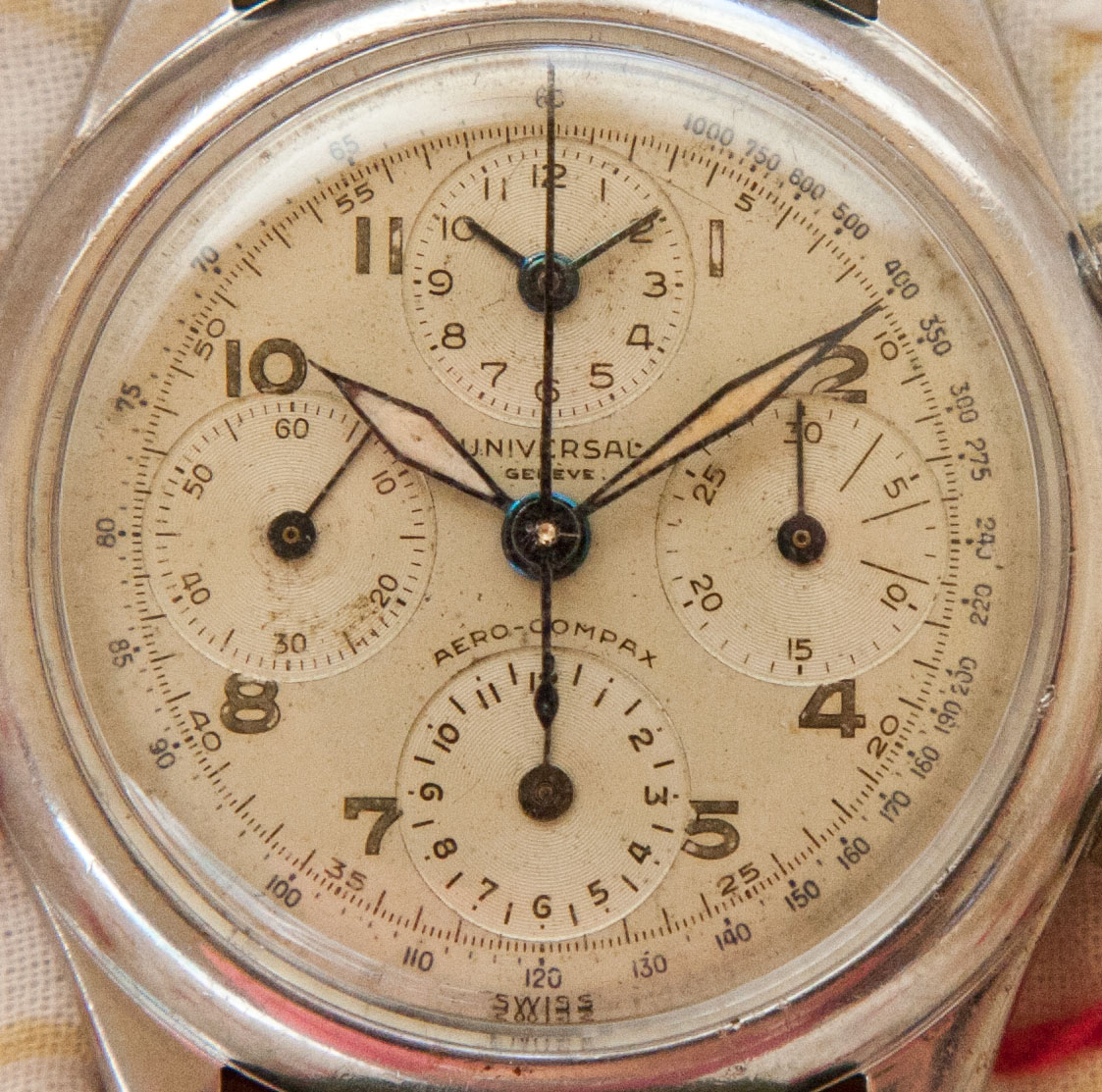

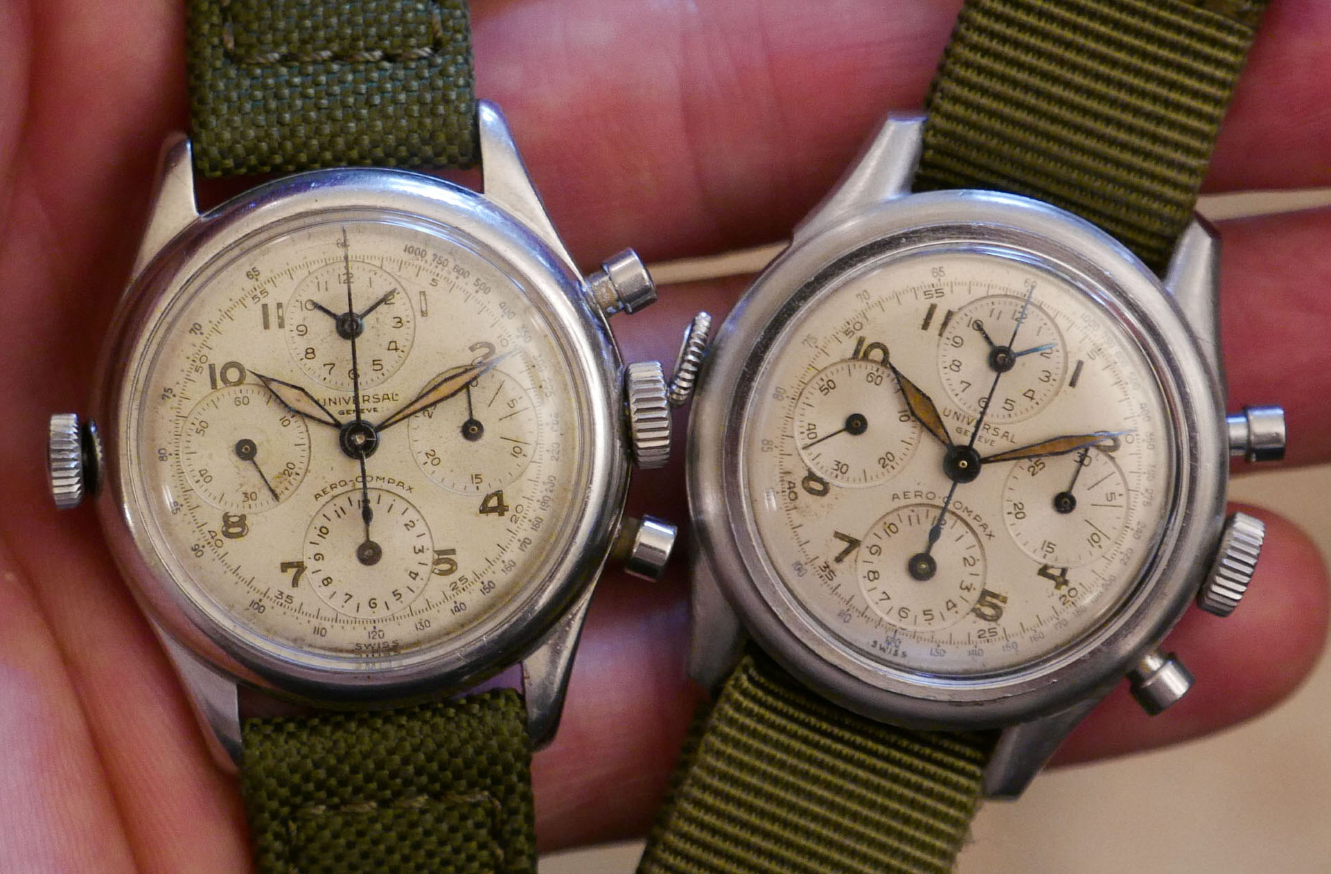

Pictured next: @bgrisso watch/my watch also 22289 but S/N 1073.......Note that they are the same and track with the OF understanding of mid 40's fonts. (Flat 3's, Open 6) ...Print quality is also finer.
They also appear to match the rather crappy B&W Sala Factory Plates:
And yet, as has been mentioned before, the color plate for the reference looks exactly like @oinkitt 's watch!
So what gives? Is the watch an original dial? Is the forth figure in the reference number 2 vs 3 a meaningful demarcation? Is this yet another problem with color plates? Later dial? Service dial? I don't personally think its a redial.

The "universal geneve" and "aero-compax" text (and the tachy ring, amongst others) looks very sloppy in comparison on the watch(es) in question...
Could be a redial, could be a service dial, could be bad quality control...
All i can say for sure is that if i were given the choice between the two, i would definitely choose one of the bgrisso/larryS examples.

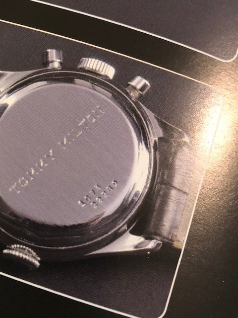

I didn't read that missing swiss what mentioned and also the fact that the tachometer scale is different.
Without the caseback engrave with Tommy Milton, it would be possible to suggest that watch in colours plate is the same as the one from @oinkitt. But too difficult regarding picture resolution to go on that way further.
Regarding the missing Swiss on the dial, does UG produce such watch in the US or something like that ?
Tommy Milton was a US car racer and it could be the previous owner of the one in the color plate.

I know that you are not saying that, but it was one of my hypothesis to explain similar dial from subject and color plate.
There is nothing more similar than the same watch... 😀

1) as CaptainWinsor just noted, UG is notoriously inconsistent. Not too long ago I was comparing two UG Aero ref 22290 that were only 239 serial apart, and the number of differences was suprising. Even the cut on the case was significantly different (I'm quite sure they were both orig), and there were numerous differences on the dials. Granted, they were not the type of differences we are seeing in the dial in question, but still, we all know this, it's just something to keep in mind.
2) I will post a pic of my two Aero, ref 22289 and 22290. The differences in the size and font of the hour markers, and the UG and Aero Compax text between these two are exactly the same differences I was seeing comparing the two 22290 that were only 239 serials apart. Again, not directly relevant to the dial in question, but an interesting aside.
3) If I had only seen OP dial in question I would assume redial, due to numerous issues pointed out. However with second example in Sala, exact same dial, same reference no less, the idea of two redials ending up in the same ref seems not very probable. (It's two different watches clearly, as the serial is different and one has a personal caseback engraving).
4) it could be service dial, again odd coincidence the first time we are seeing potential service dials, they are both in the same reference?!
5) it could be original dial, weird batch, although I really struggle with the quality of the printing on UG and Aero Compax, not to mention the numerous other issues.
I had a look around and couldn't find any more of these dials online. I think our biggest problem here is sample size. With only two of these dials so far, I don't think we can reach a conclusion, and will probably just have a range of opinions. For myself, I don't have enough info to reach a firm conclusion, I would just say it's an open question, and I hope that we see some more examples turn up in the future.
