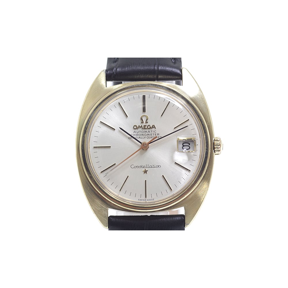

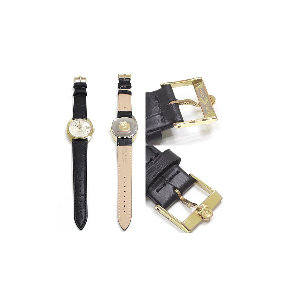

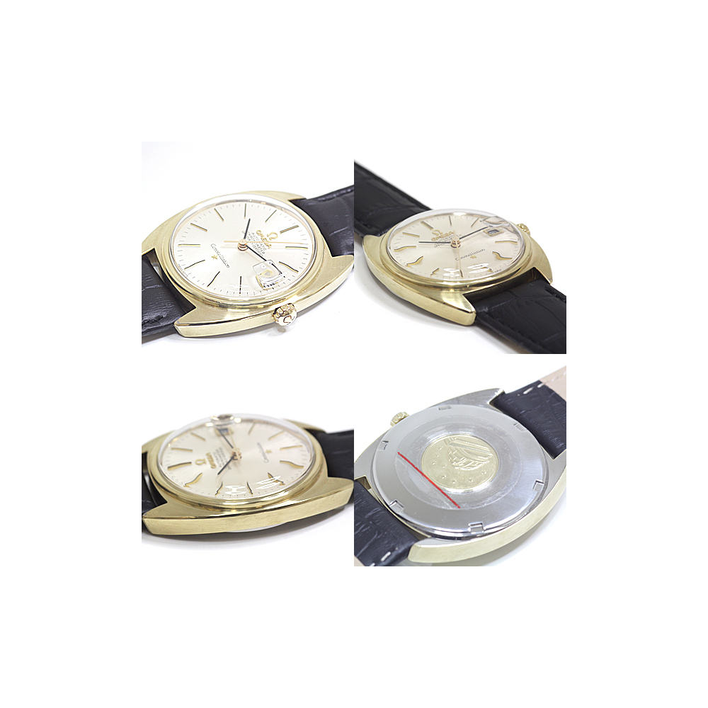

Hello all,
I’m considering picking up a C Case Constellation, and the one below caught my eye. The photos are few and small, but in my quite uneducated opinion I think it looks good. The asking price is $1395, which seems to be on the high end for a gold plated one of these. Seller rates the condition highly, and online reviews suggest their ratings are reasonable accurate.
What does the forum think? Look OK? What about the price - seem fair for a dealer?
Thank you in advance for any advice.

Looks solid too me, but I’m not an expert on these.
16,305
45,025

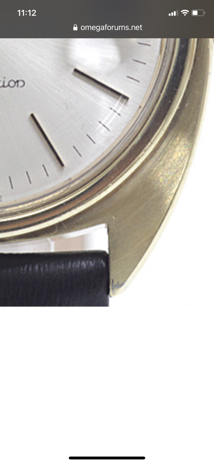

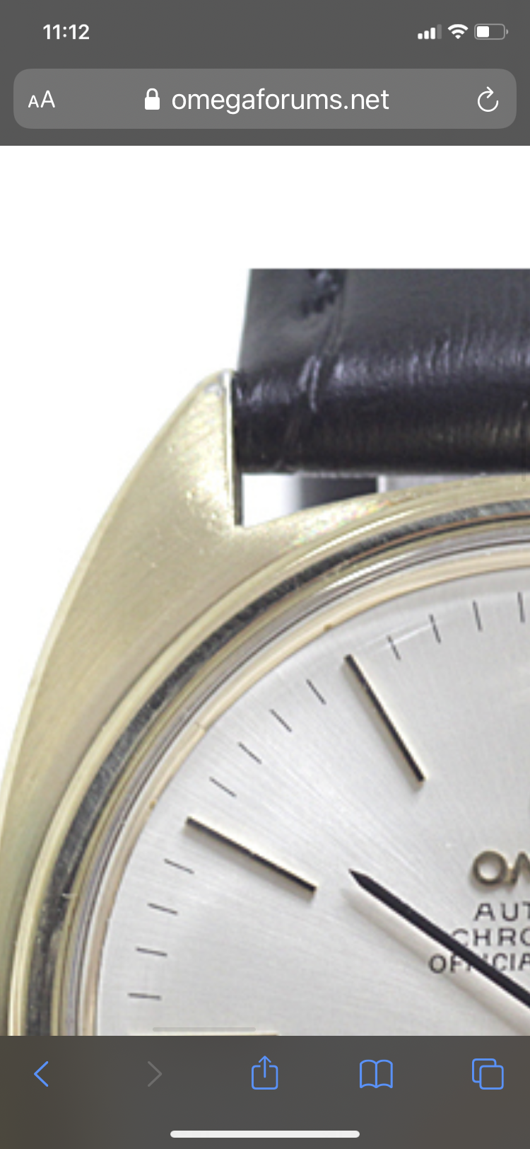

Plating wear-through on the case- don’t need to look any further
Overpriced by twice

gold capped case. yes, bit overpriced. if your eyes is glued on c-case, don't limit it
this one. try looking for an all steel c-cased.

$1400 is about double what I would expect one of these in good condition to fetch. For an overpolished one, it's robbery.

So ignore what I said @ConElPueblo knows
To be fair, if JW hadn't blown up the photos, I wouldn't have seen the coarser than original brushing and the worn down capping. Such a shame 🙁

These watches had pretty good water resistance and solid movements, there are a lot of survivors and they're not as popular as their more traditional looking cousins. You can afford to be picky in getting the right one and this isn't it at $1400.

And if you’re paying 1400$ for one, that’s the money for a linen dial, 18k fluted bezel example in great condition with an Omega brick bracelet and a recent service. Which still wouldn’t be a bargain (but an acceptable price).

Thanks everyone. I’ll take a pass on this one. JWRosenthal, really appreciate you blowing up the photo. Would never have seen the worn through plating otherwise.
I’m now kind of hooked on the idea of a gold plated C case, but will keep my eyes open for a better example - or at least a similar one for much less.
Have a great day all

Crown looks incorrect - and possibly wrong second hand, I believe the correct one should reach the inner edge of the minute marker tracks. You're right to check on these C case models - there are many imperfect ones out there, so take your time and find the right one thats in good condition and the right price.

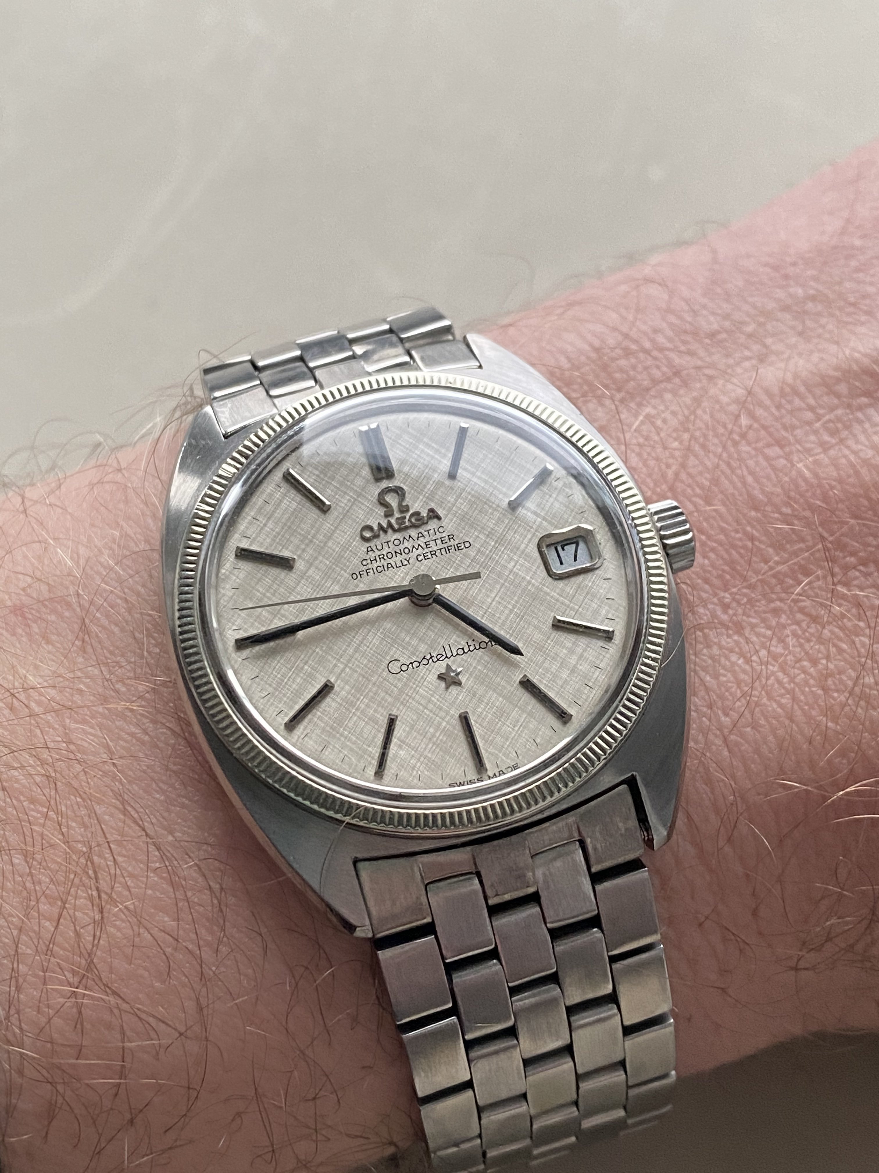

My apologies if my comment triggered frustration, but even though that wasn’t my intention I stand behind it in so far as I don’t consider it an exaggeration. I didn’t mean that this is a price you can pick these up for any day of the week, but if I may just point you to two examples that were sold here very recently:
https://omegaforums.net/threads/omega-constellation-c-case-ref-168-029-serviced-1-300.124274/
Serviced, WG bezel, brick bracelet, 1300$.
https://omegaforums.net/threads/fs-...rick-bracelet-nickel-grey-dial168-029.121876/
WG bezel, brick bracelet, equivalent of ~1000USD. Leaves 400$ for a service, which should be realistic.
Both examples aren’t perfect, but I like their condition and would absolutely wear them. Note that both have the grey dial, which personally I’d consider as more sought after than a regular white one.
These C Connies are beautiful pieces and I’m happy to have one in my collection, but they were produced in considerable numbers, so nice deals can be found with some patience. I’d say this is the right place for it. 😀
And if I may, a third example - this is mine. Also certainly not NOS, but I’d argue it’s in good nick, has a linen dial as a nice bonus and cost me ~1100$ serviced. Bought from a friendly member here.
