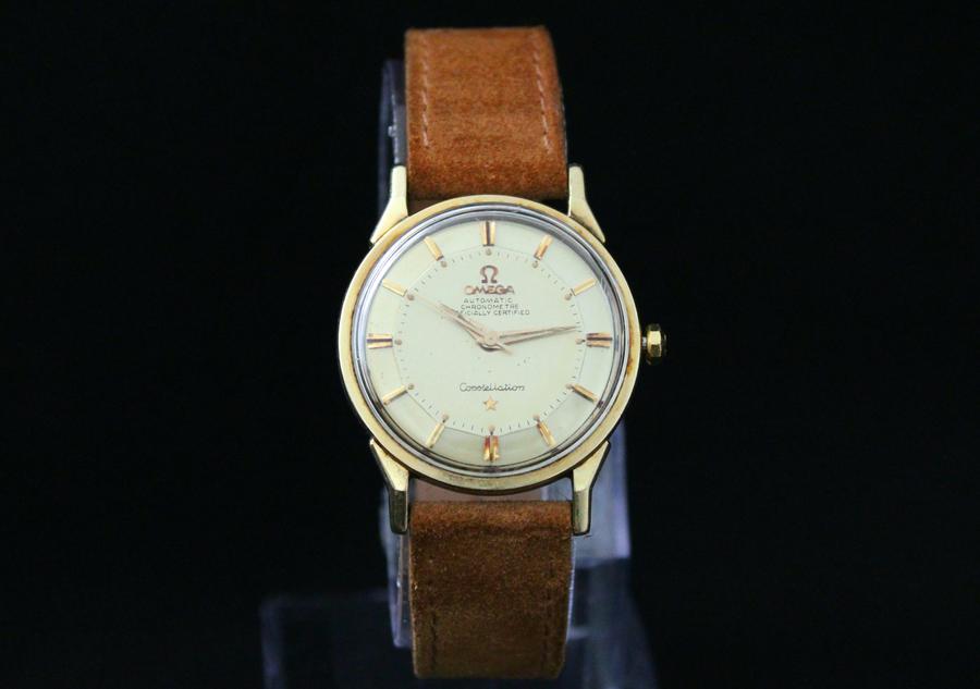

Further on my search now, I came across this nice-looking pie pan. Just wondering if anyone could kindly advise on the dial.
The image isn't the best ( have requested more) but to my untrained eye there doesn't seem to be anything obvious?

Fonts and spacing among other things are not original.
I vote redial
And if that is the type of pix the seller uses, it is not by coincidence.

And to add insult to injury, the case is very soft. Hard pass.

IMO, it's generally best to wait for good photos and then ask your questions. Otherwise, people may just look once and give up. However in this case, the alignment and spacing of the printing are poor enough that it can be identified as a re-dial even with this poor photo.

All of the above plus mixed Ms and CHRONOMETRE on a dogleg says redial.
