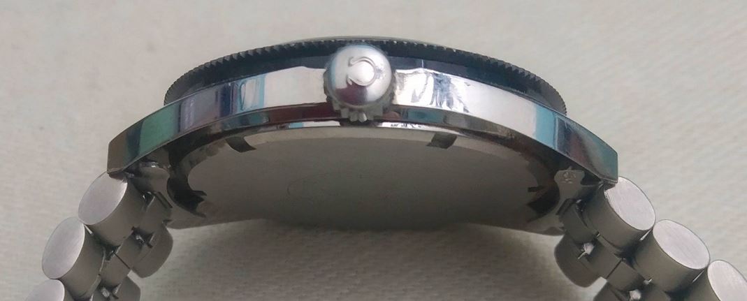

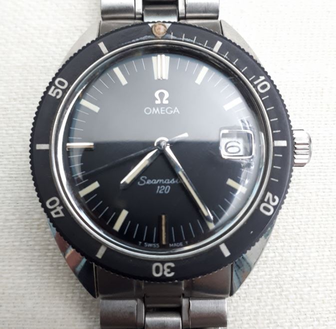

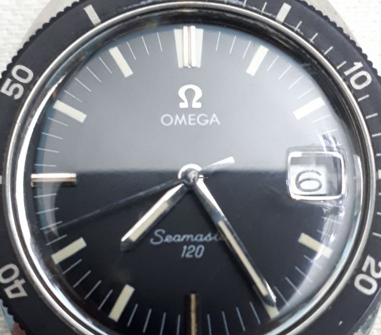

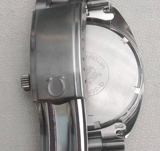

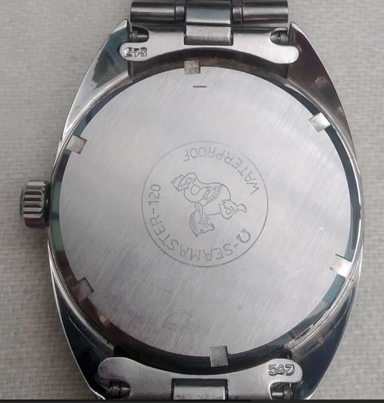

Read through 25+ pages of gemini4's Seamaster 120 guide, examples, and discussion, thinking I was well-informed and well-armed to peruse the 120 market. Then, like usual, I freeze up when I find one in the wild, and second-guess everything.

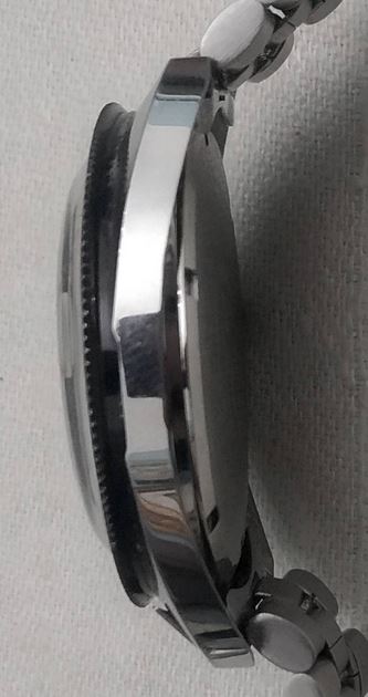

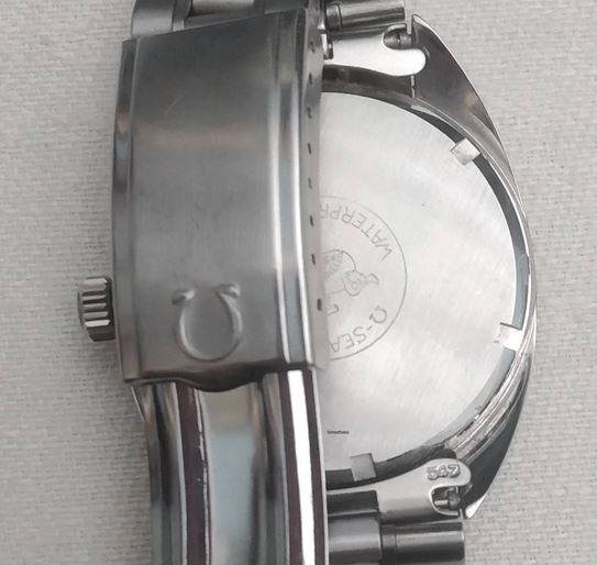

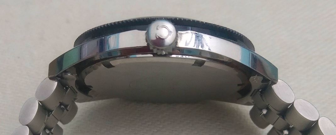

Case engraving is shallow and lettering correct; case is notched at 9 & 3; crown looks right, bezel looks correct. Crystal is correct (etching can be seen in closeup). Second hand is steel vs. white, not sure if that is correct.
Seller states his father owned this piece as an Omega retailer in the 70s, and considers it almost NOS. He does NOT want to open the caseback for me, it's never been serviced and he wants to leave it unmolested. I asked if he's amenable to an inspection period, or something to verify the movement.
Asking price $2300.

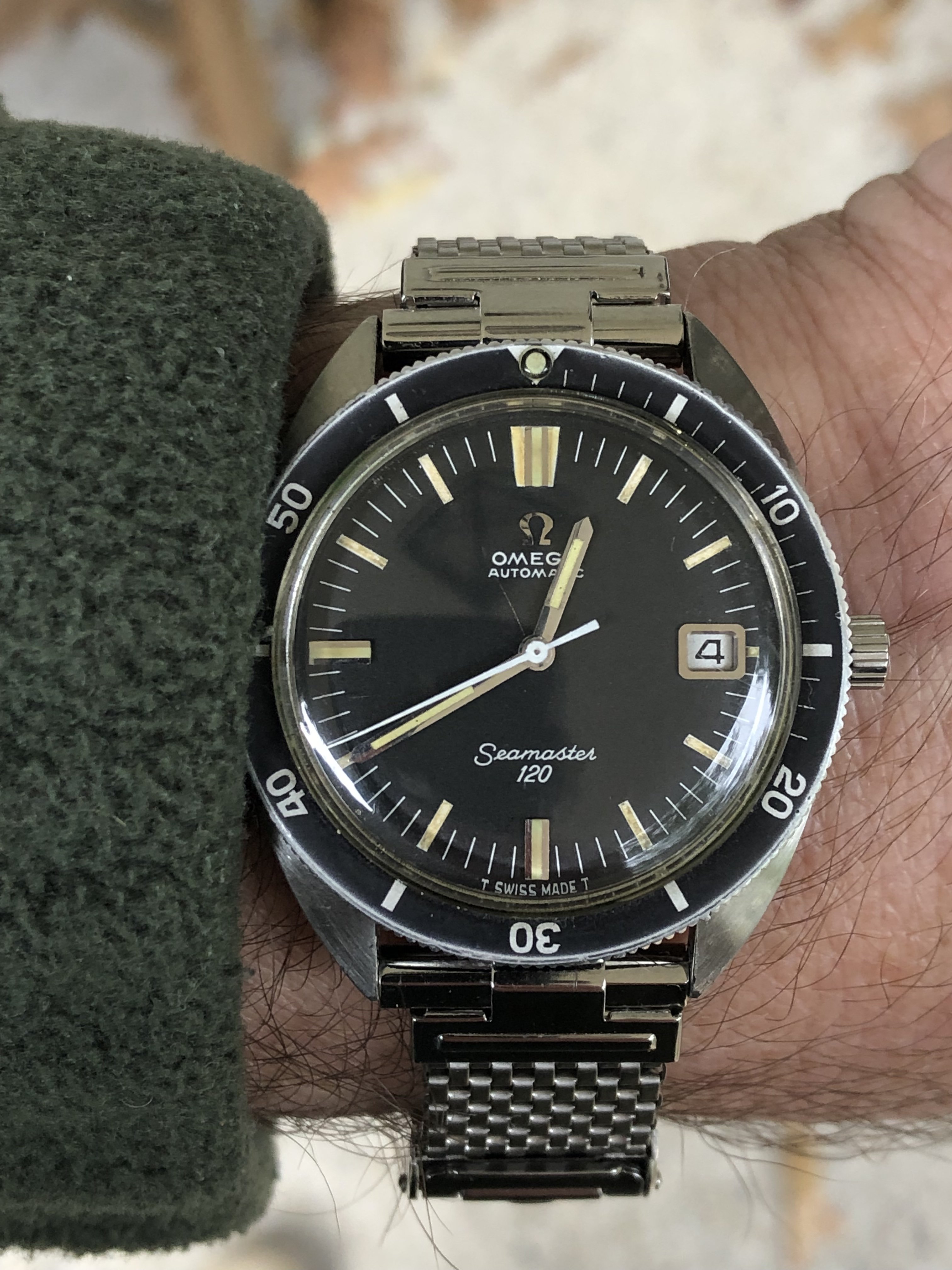

Looks good to me. Except for the second hand.
Then the question is. If it was never serviced how did it end up with this hand. And with everything else looking so pristine, why would there have been a need for a hand swap 😕
5,026
18,607

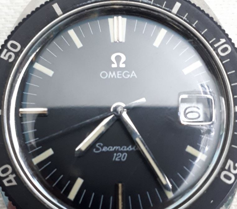

Is the plexi original omega? It's hard to believe it came with a cyclops plexi. If it's not omega the watch was probably serviced.
16,305
45,025
I share your curiosity about the second hand. The endlinks are correct for a 1098 which is a period match, and the aging of the lume strips at 12&6 look legit. But the script looks more grey than white- May just be the lighting- I would want to see more pics in better lighting and bracelet stampings to confirm 1098

Thanks for your replies. The seller has agreed to open the caseback so I can verify the movement. I will ask to verify the bracelet ref and see if I can get a brighter picture.
The plexi is an Omega, as the etching is visible on one of the steadier front-facing shots. It looks like a cyclops to me as well, but there's a weird reflection from the room hitting the glass too, and it may be from that.

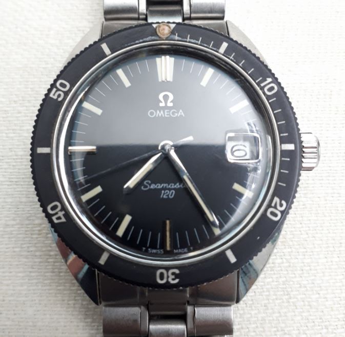

This is what I mean about text color
Even in this crappy lighting the white script is poppin white

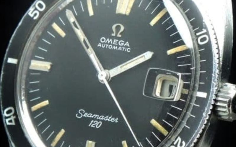

Here's another reference photo w/ the cyclops on a totally different 136.027...is that the incorrect plexi for this reference?
Get that crown sorted JW 😁
BTW I think the text looks a bit off because it’s not in focus. Doesn’t look like the fake grey version to me.

What is wrong with the hand. Isn't the hand normal for a 136.027?

here's the best i can get from his photos. asked him to take more in better lighting!
That's an automatic reference, 166.027.
It’s hard to say anything with certainty but none of the old catalogues show it with cyclops and it’s quite uncommon to see one with.
I’ve been trying!!! But nobody wants to sell me a crown! My watchmaker didn’t have access to the correct crown and I’m not putting an old leaky crown on there.

This is also an automatic reference.
Does the text color vary from auto to manual?
The only reason I bring it up is that all the fake “kits” we see out there have the grey text and not white..but they all may be auto’s- I haven’t paid close enough attention.
