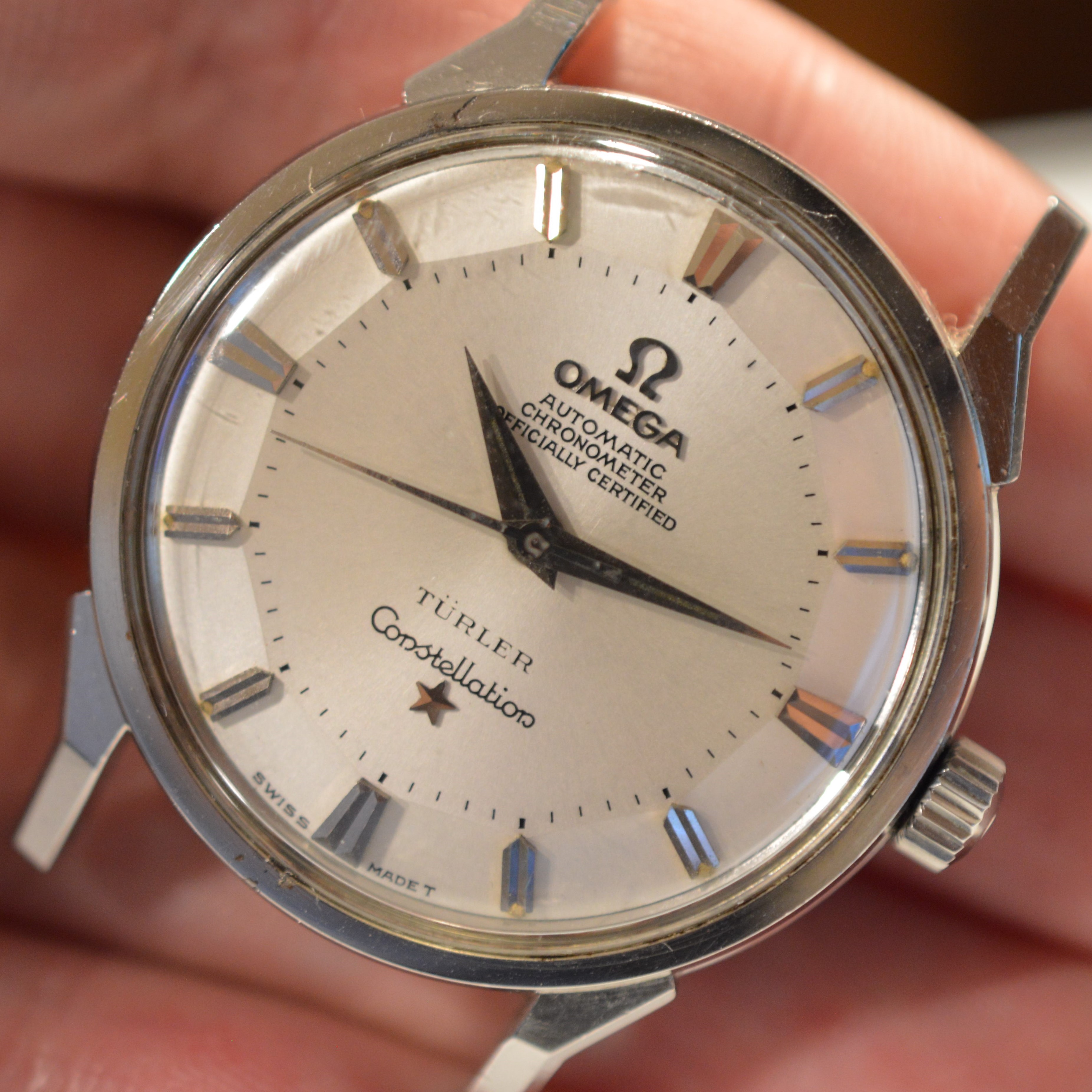

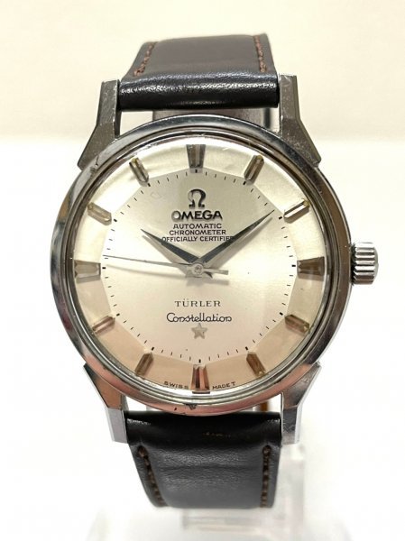

Hello, I am interested in this one, but I am not sure about the dial. Crown looks like a replacement. Price could be around 800eur.
What do you think? Legit? Thanks for any advice.
13,676
19,044
Quality of photos are poor, but I have seen very few fake T眉rler stamps. I vote original dial and replacement crown.
Price is reasonable for condition.

I also wonder if the hands were replaced or relumed with black paint...
5,026
18,608
I can'nt imagine that they would Turler on a refinished dial. Besides that, the dial looks good to me

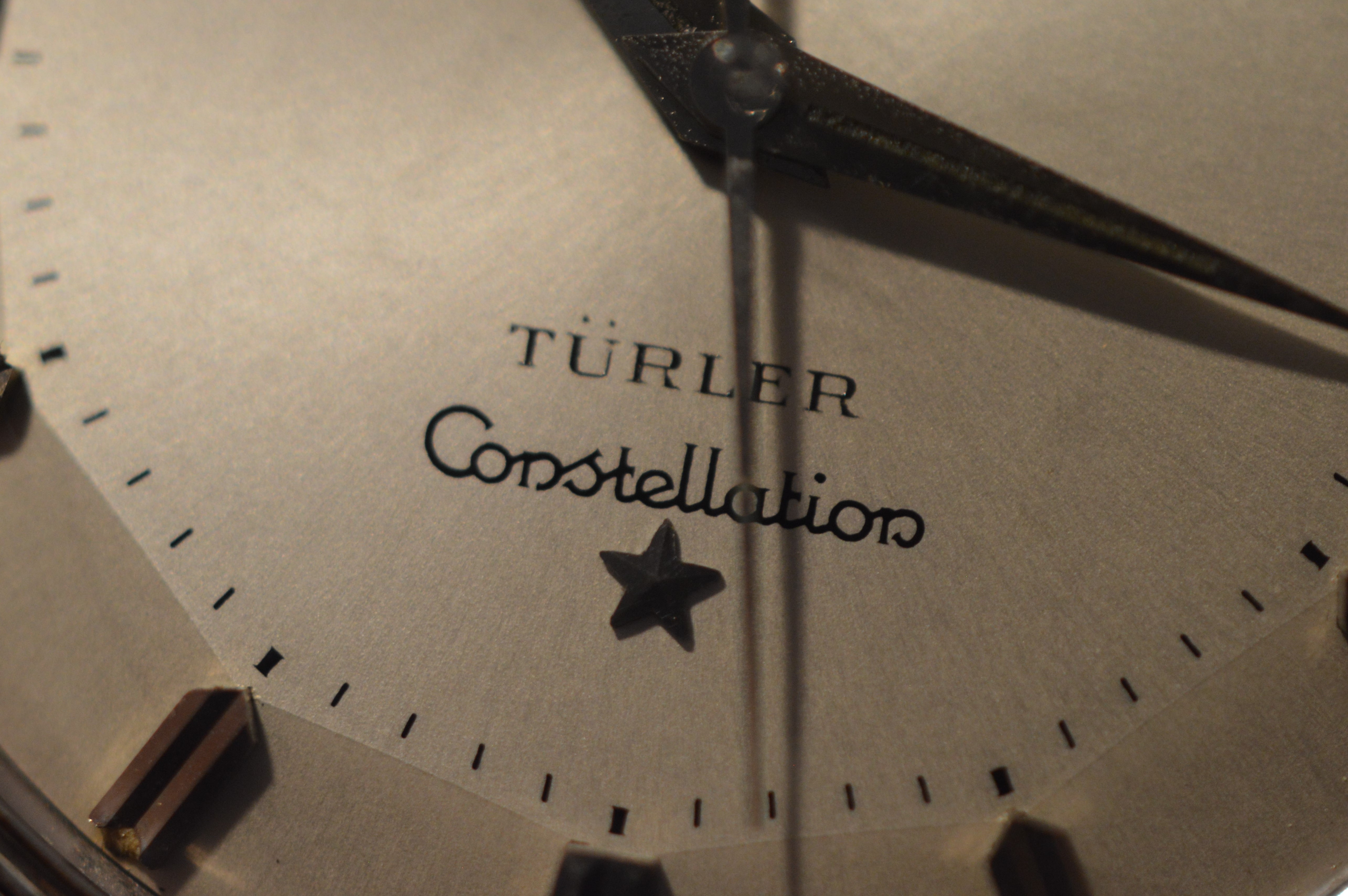

I hesitated because the t tritium mark on a - 61. I am never sure about no t, one t, two t, etc. And have seen so many bad redial with t Swiss t.
379
328
ill agree with all the other comments, crown looks like a replacement and dial might be original
505
738
To me, with an early constellation, you shouldn鈥檛 have the 芦 t 禄 for tritium, which appears around 64 on those Connie...

Does the bezel has a crack at 10:30 ?
馃槈 I thought about it at first but side picture shows nothing I can see at 10:30. Thanks for the heads up.
EDIT: when I enhance the picture, I think there is something wrong with the bezel. I just dodged a bullet, I don't need the headache.
Don't forget that -61 is the model year, not the actual production date. Like a 105.003-65 made in 67, for example.

Might be worth saying that I'd been following the auction of this watch since before the thread was created, and managed to win the auction. Personally, I don't think the bezel is cracked. It looks to me like some sort of dirt/debris at best and pitting from corrosion at worst. Either way, it's not an unfixable cracked bezel, and I think the dial is beautiful enough that I'm willing to take a gamble on it.

The dial appears to be a wholly original 'no-step, big-star' pie pan with 'T脺RLER' script.

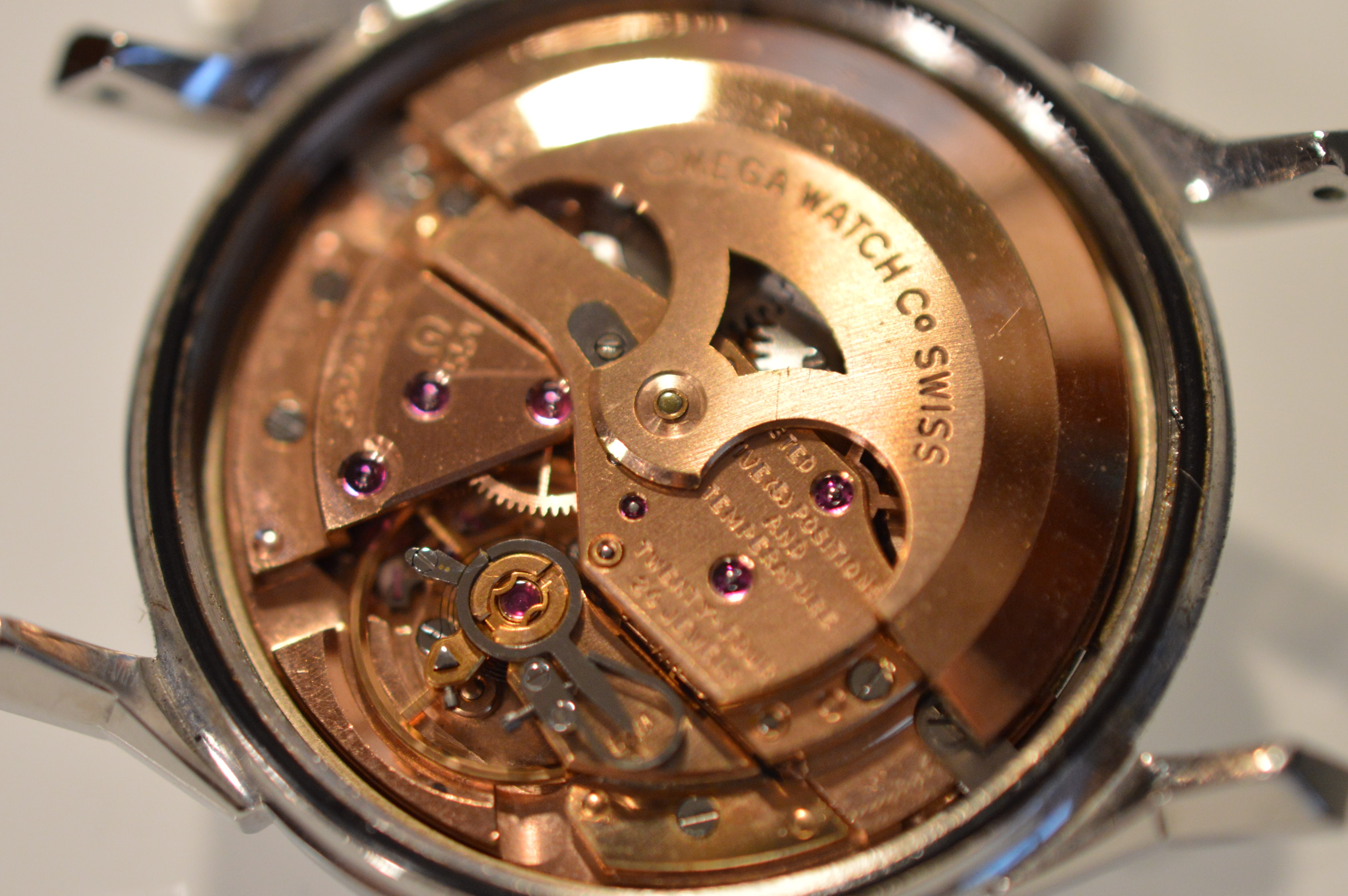

The movement is alright. It appears to be in pretty decent condition but definitely needs a thorough cleaning. No bridges or parts appear to be swapped, which is a relief. I'm definitely considering putting a display back on it, as I think this 551 will look quite stunning when fully serviced.
A beautiful rose-gold heart lazily ticks away...

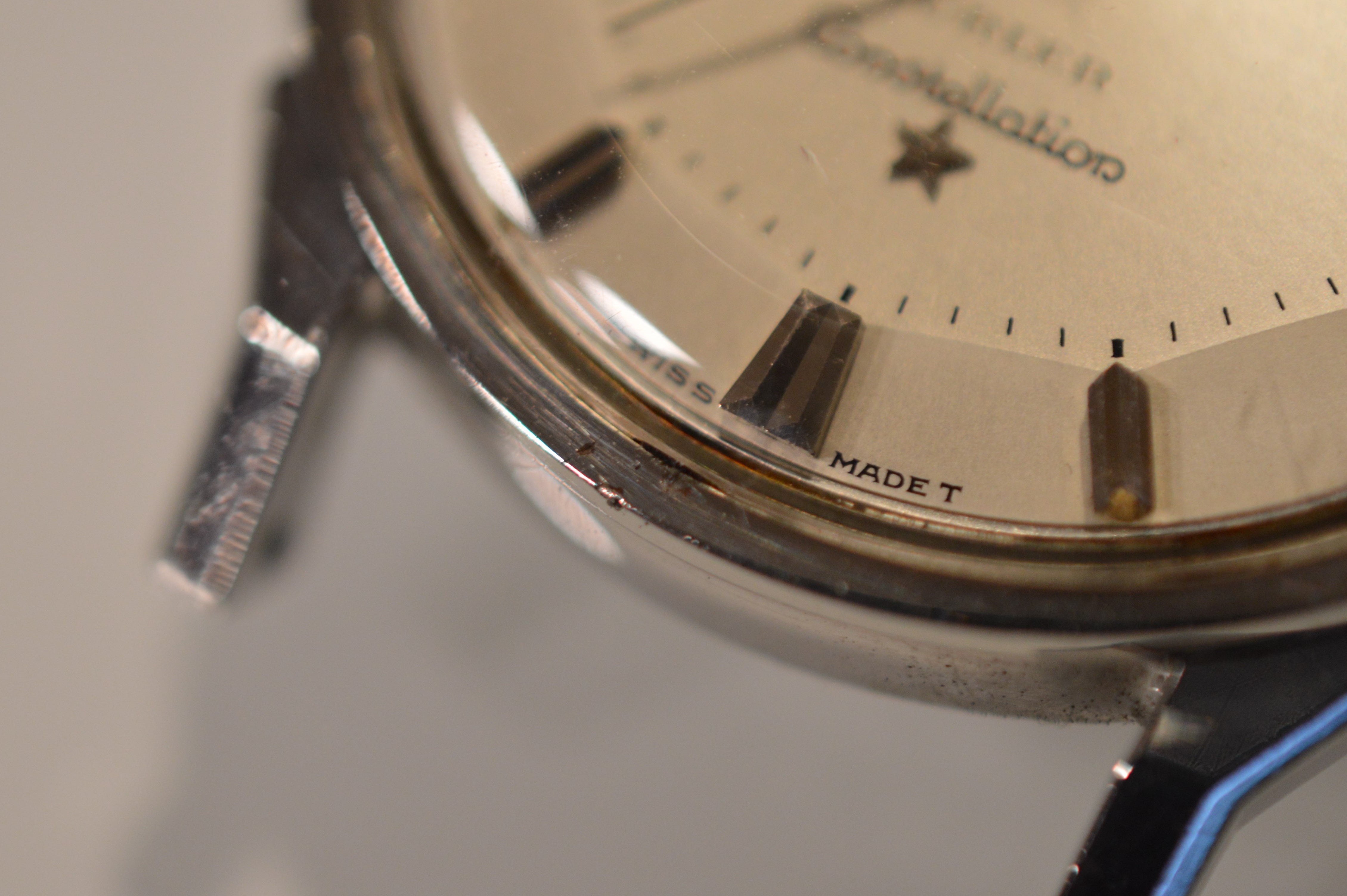

The case is worn, but shows no signs of brutal polishing. The observatory medallion still has its original matte finish as well.
The marks on the bezel appear to be light corrosion, as it won't rub off. However, it isn't cracked, which means it will be repairable by laser.
Looks to me like the 'Swiss Made T' is original too. Nice and sharp!

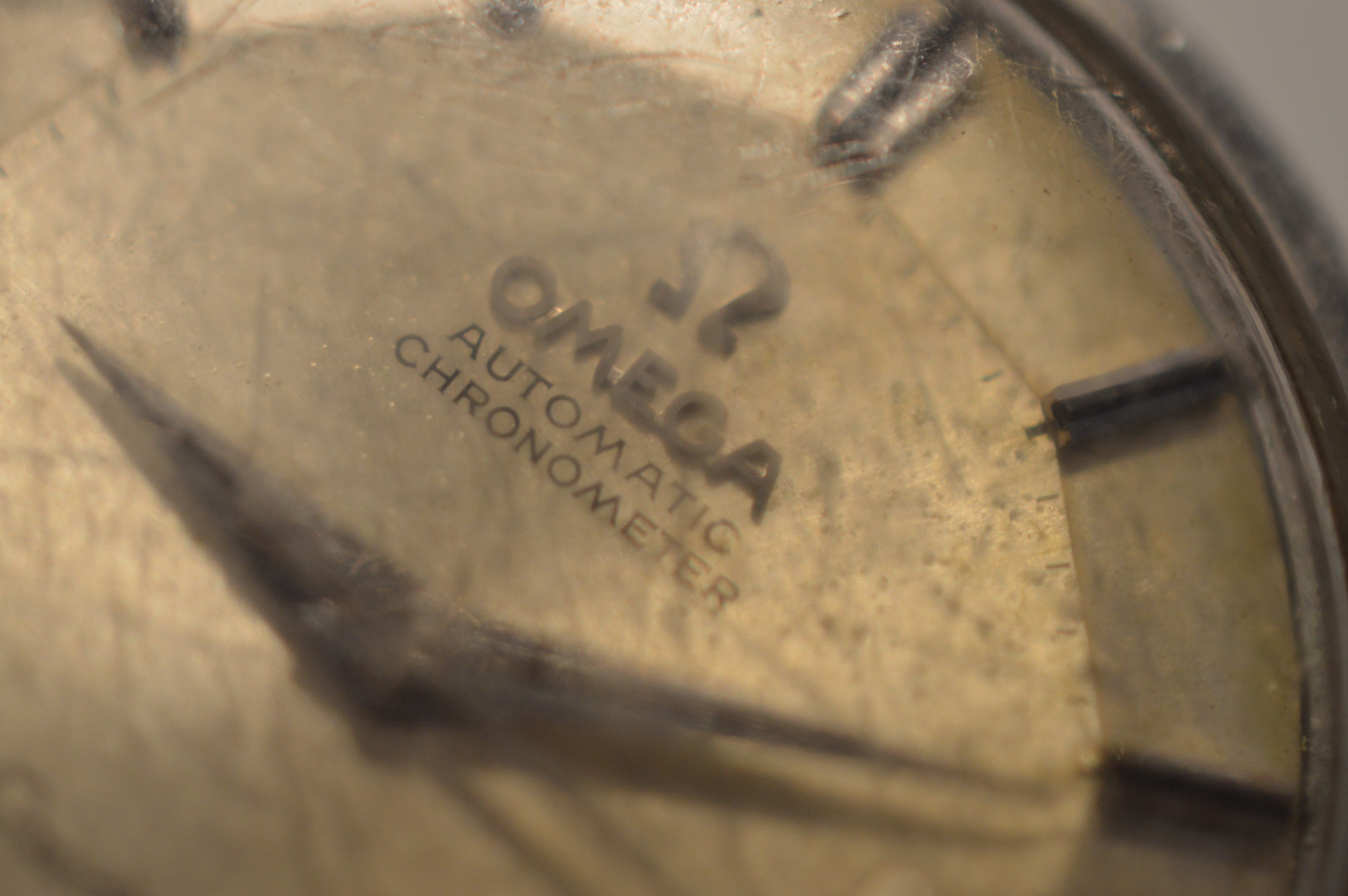

Overall, I think I was pretty lucky that I was able to pick this piece up, especially for what I did. Many vintage Constellations and Seamasters with sunburst dials from Japan have either heavy patina or lacquer bubbling from the humid climate. Case in point, this piece I picked up as a project watch:
