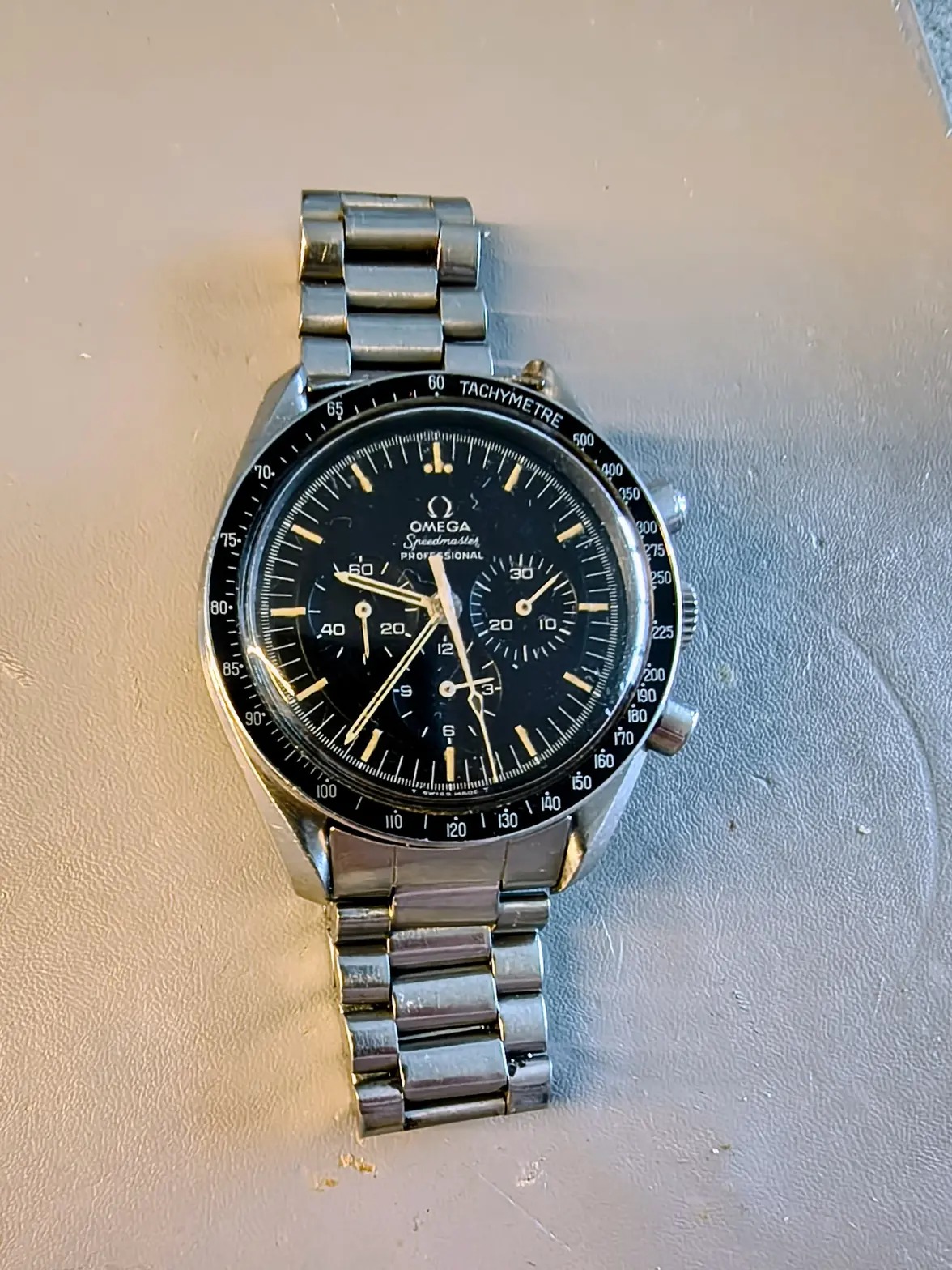

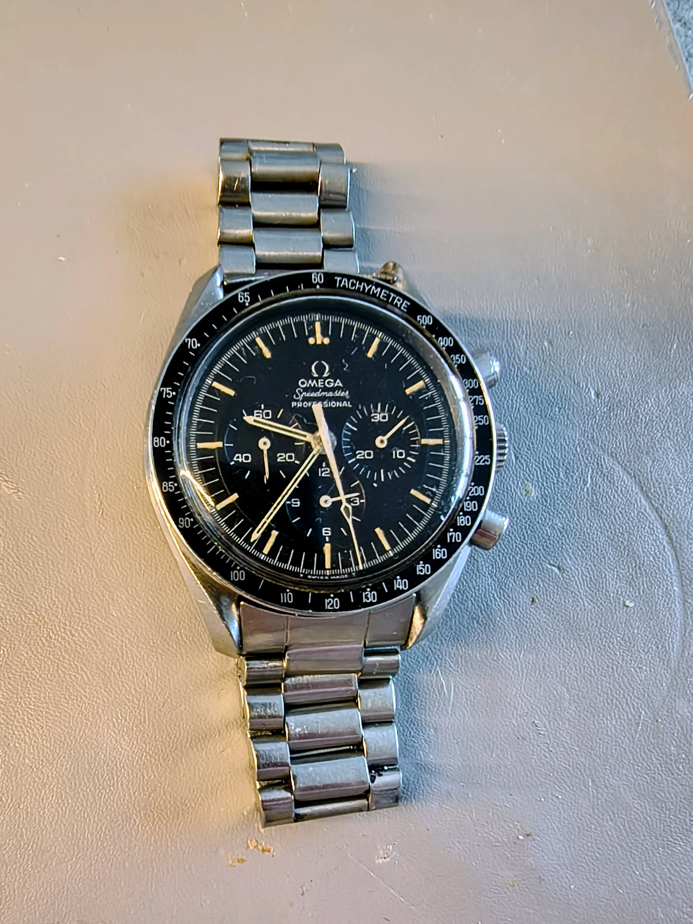

I’m looking for some help identifying and valuing a family watch. This Omega Speedmaster Professional has been in our family since I believe the early 1970s. From my own research, I believe it’s a 145.022-69, likely produced in the late 1960s or early 1970s, but I am far from an expert and likely missing some of the finer details you all know so well.
The family member who owns it is potentially looking to sell due to old age, so I'm trying to gather accurate information to help them make the right decision.
What I think I’ve identified so far:
• Dial: It appears to be a "Step Dial" with a painted logo.

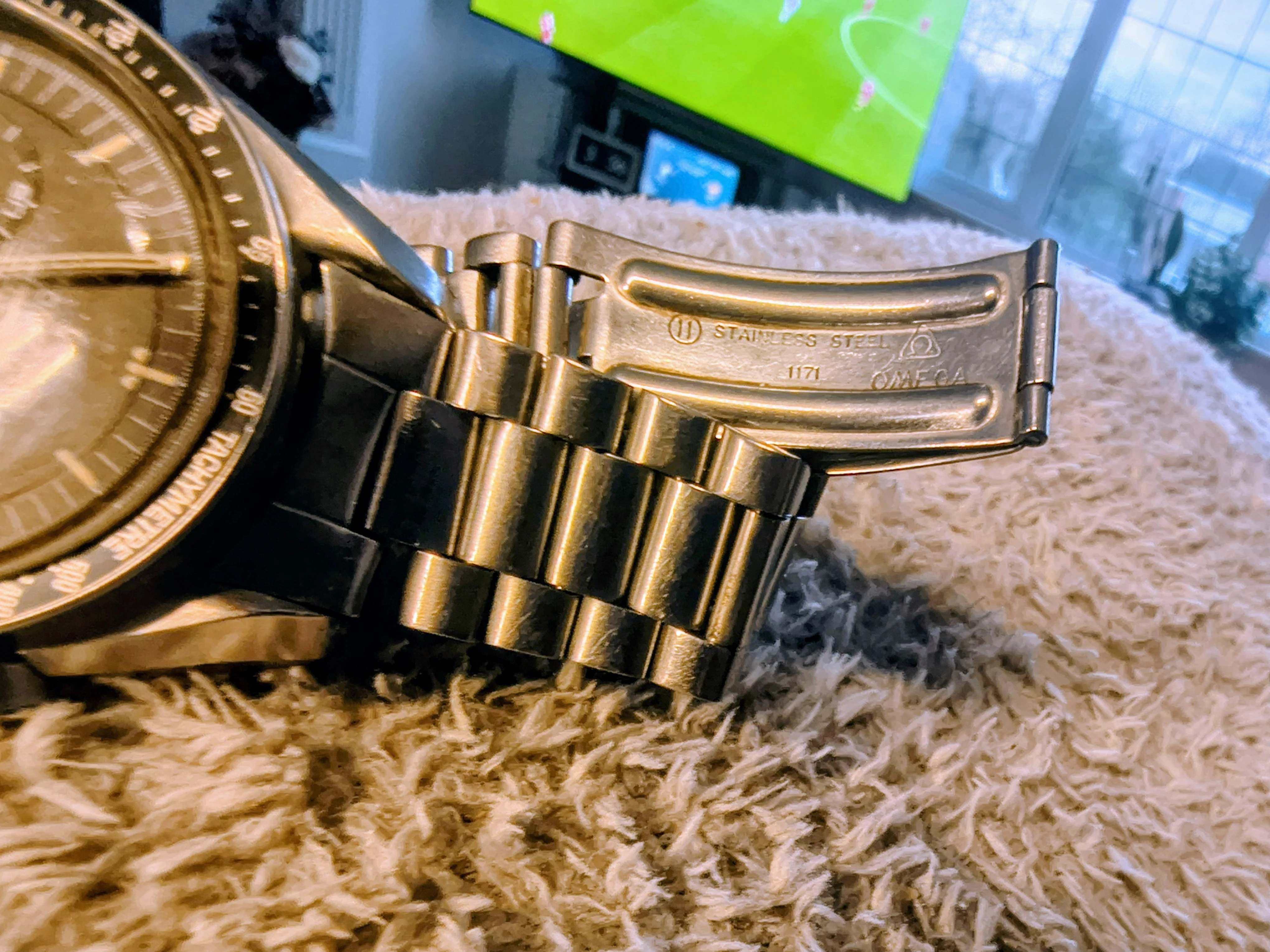

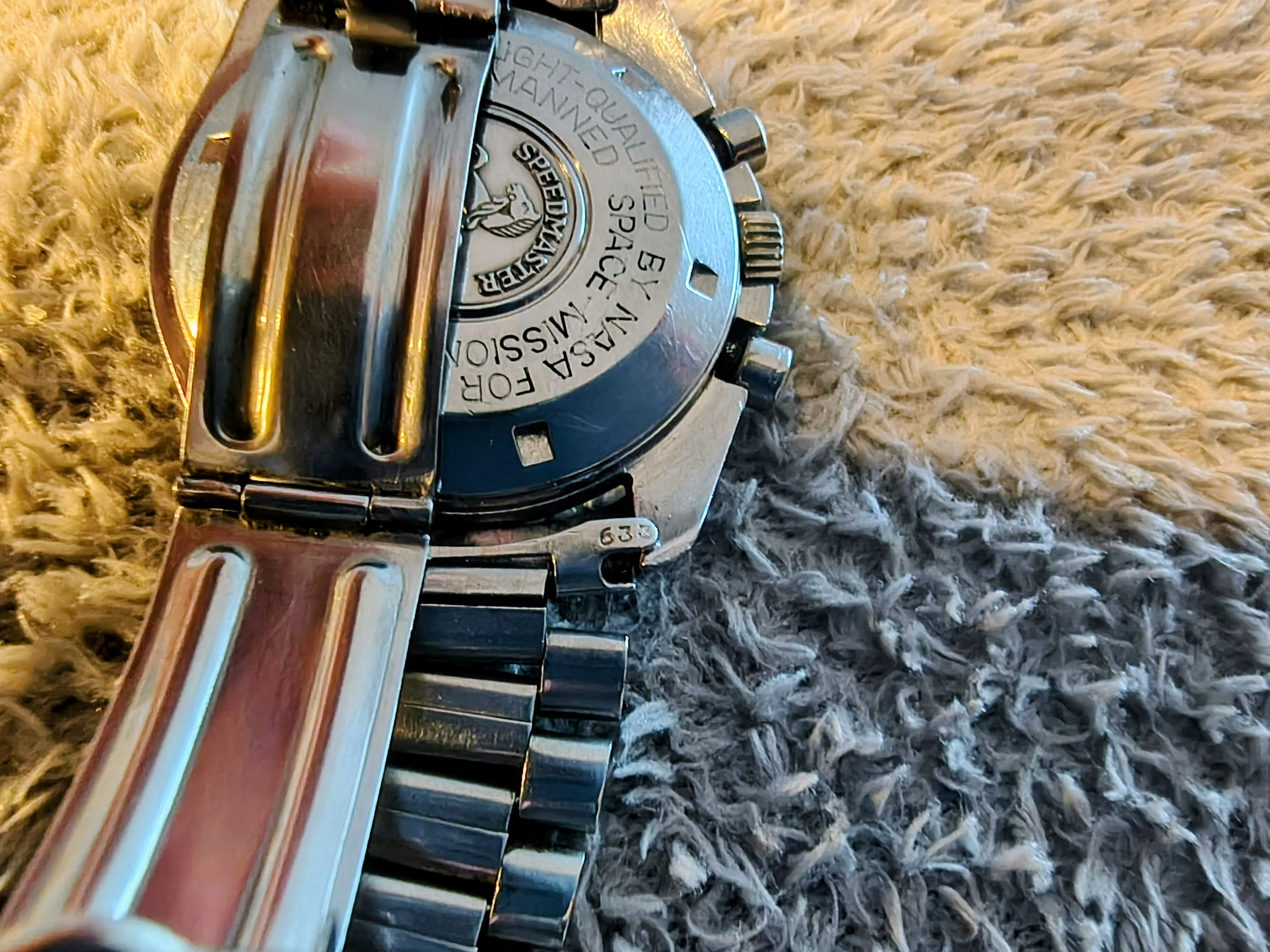

• Bracelet: It’s on an 1171 bracelet with 633 end links.
• Bezel: I believe it to be a dot next to 90 rather than dot over 90.

1. Does my assessment of it being a -69 seem correct based on these photos?

Your observations seem basically correct to me.
A commonly used pricing guide is here: https://speedmaster101.com/price-chart-2/
I think FAIR would be safe for rough appraisal, you might do a little better depending on how you sell it. But we can't evaluate the condition from those photos, so I would err on the conservative side. The value on the chart does not include the bracelet, but at first glance, the bracelet looks pretty rough.
Good luck with your sale. The owner got their money's worth from the watch over the years, so I'd say it doesn't owe him very much.
Edit: Sorry, the post-moon caseback indicates -71, not -69. I didn't note the back initially

Hello and welcome,
It appears to be a 145.022-71, not a 145.022-69.
It is very lovely (to my eyes, at least!).

@Seaborg has probably nailed the reference, but it could also be a 74?
But since you wrote that it was in the family from the early 70´s, lets go with that.

The watch looks correct, but the dial does have some strange bleeding from the lumeplots..?
