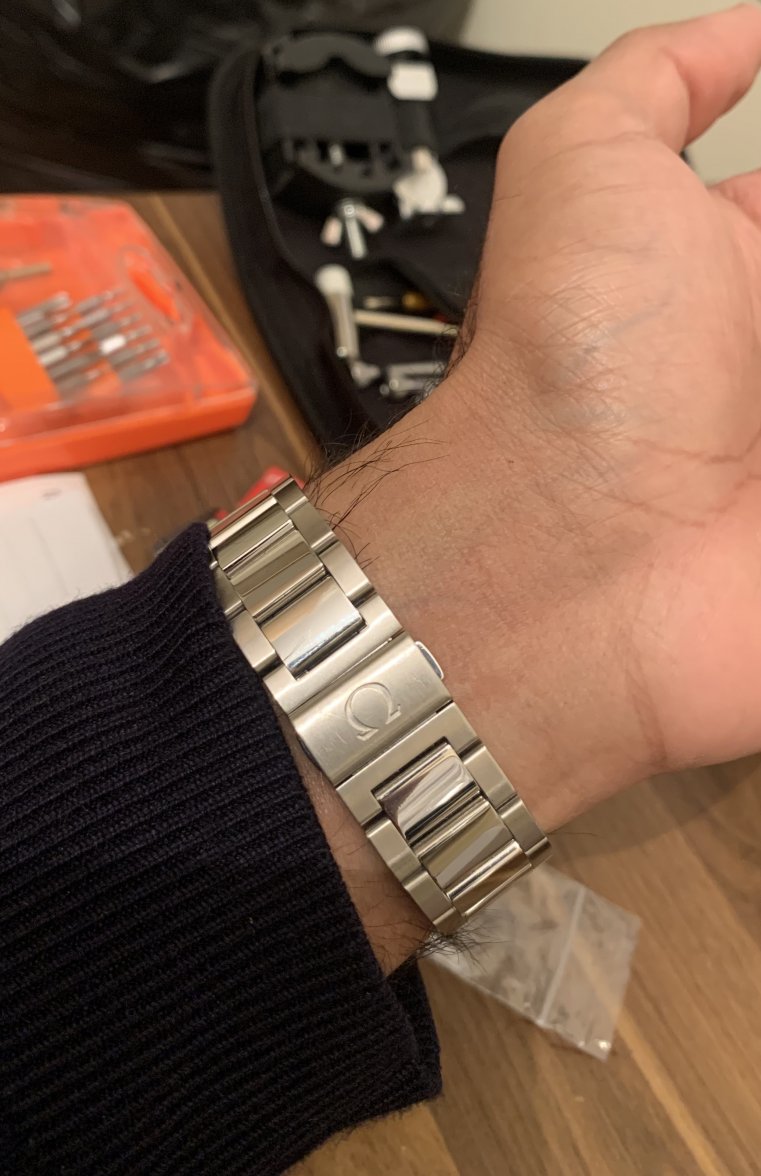

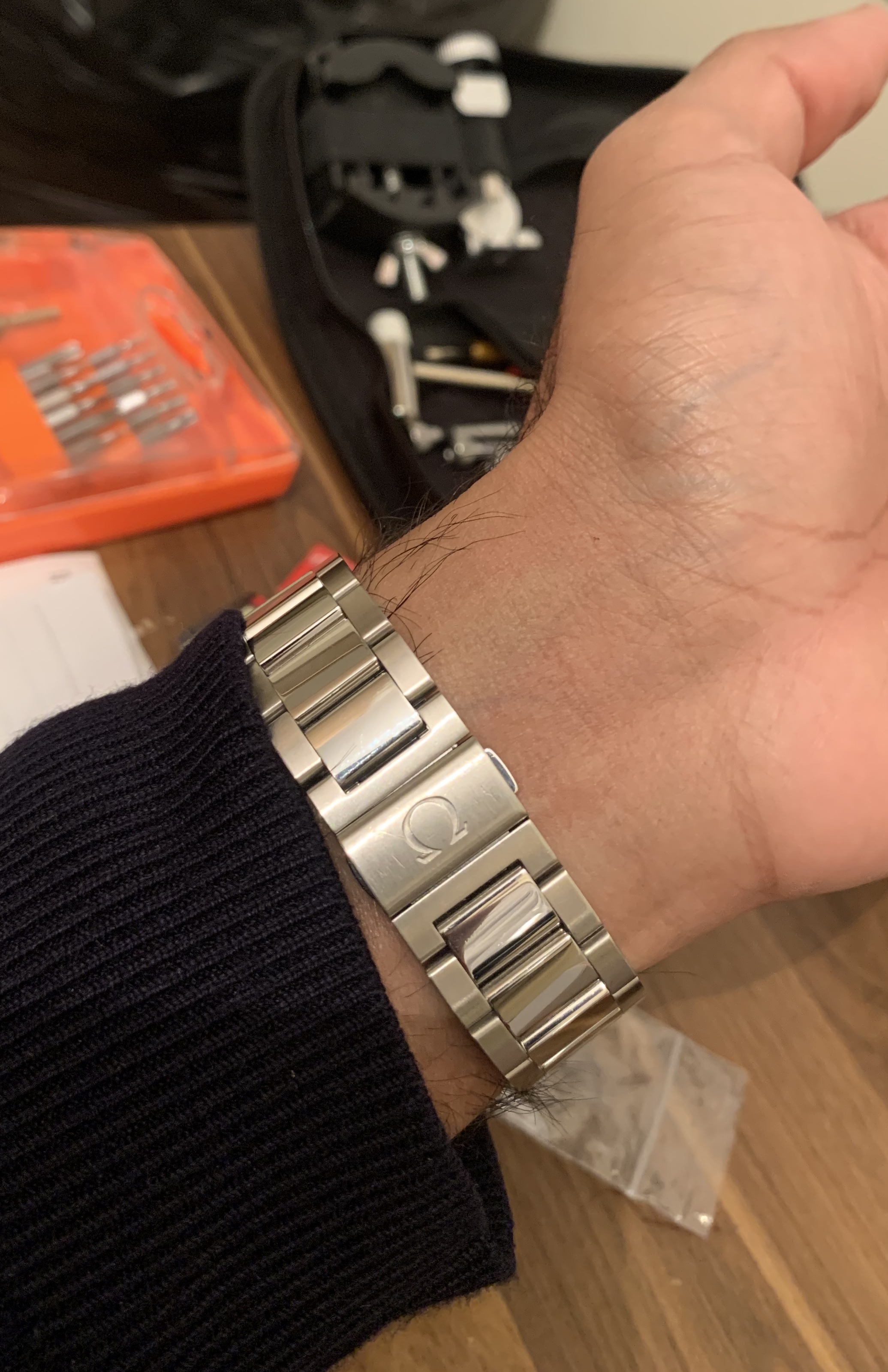

Hi guys

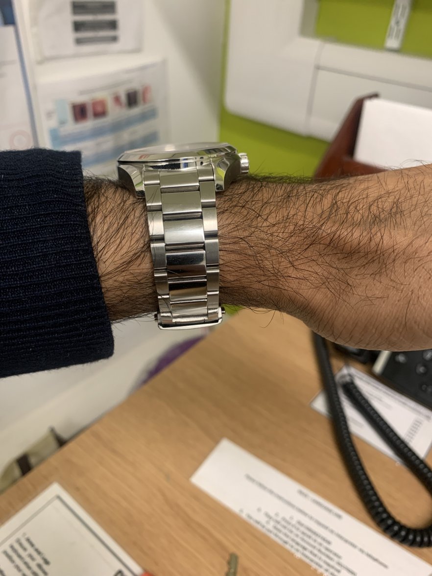

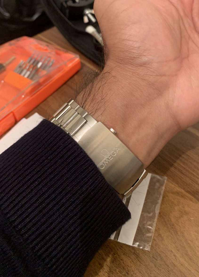

Been following this forum for a long while and have enjoyed and learnt much on it. Thought I would post a useful first post.
I previously owned a Moonwatch and had bought an adjustable clasp for it because I could never get the right fit. It was brilliant. Due to missing the date window I exchanged it for a 2016 Aqua Terra with day date function. The bracelet, although looking nicer, was such a poor fit. Bought extra half links and played around with the combination, but didn’t get anywhere. It was either too tight or it moved around too much. I have one of those wrists which are larger in the morning and slightly less so in size in the evening.
When I exchanged my watch I kept my adjustable clasp and leather strap/clasp. So i thought I’d look at whether I could change the butterfly clasp over to the adjustable clasp. However, I came across the end links of the adjustable clasp and found them to be narrow. So I looked around, searched forums and couldn’t find the exact end links required. I popped into the local boutique in Birmingham, Uk, who have been very useful in the past, but even they couldn’t help me out! So in the end I had the end links filed by a Jeweler so the bracelet links slot in perfectly!!
The purists may outcast me, but I enjoy wearing the watch so much more now. And personally I think it looks the part too.

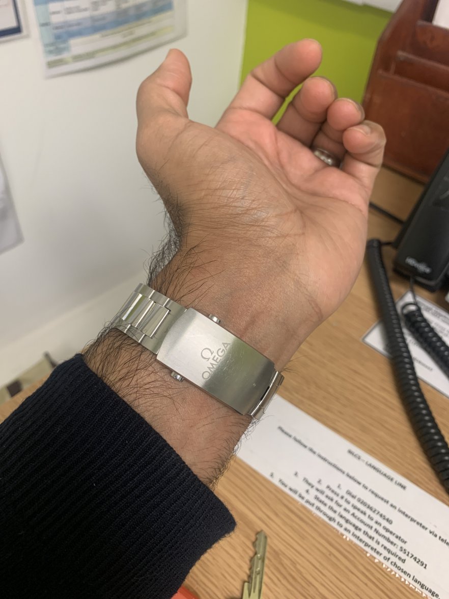

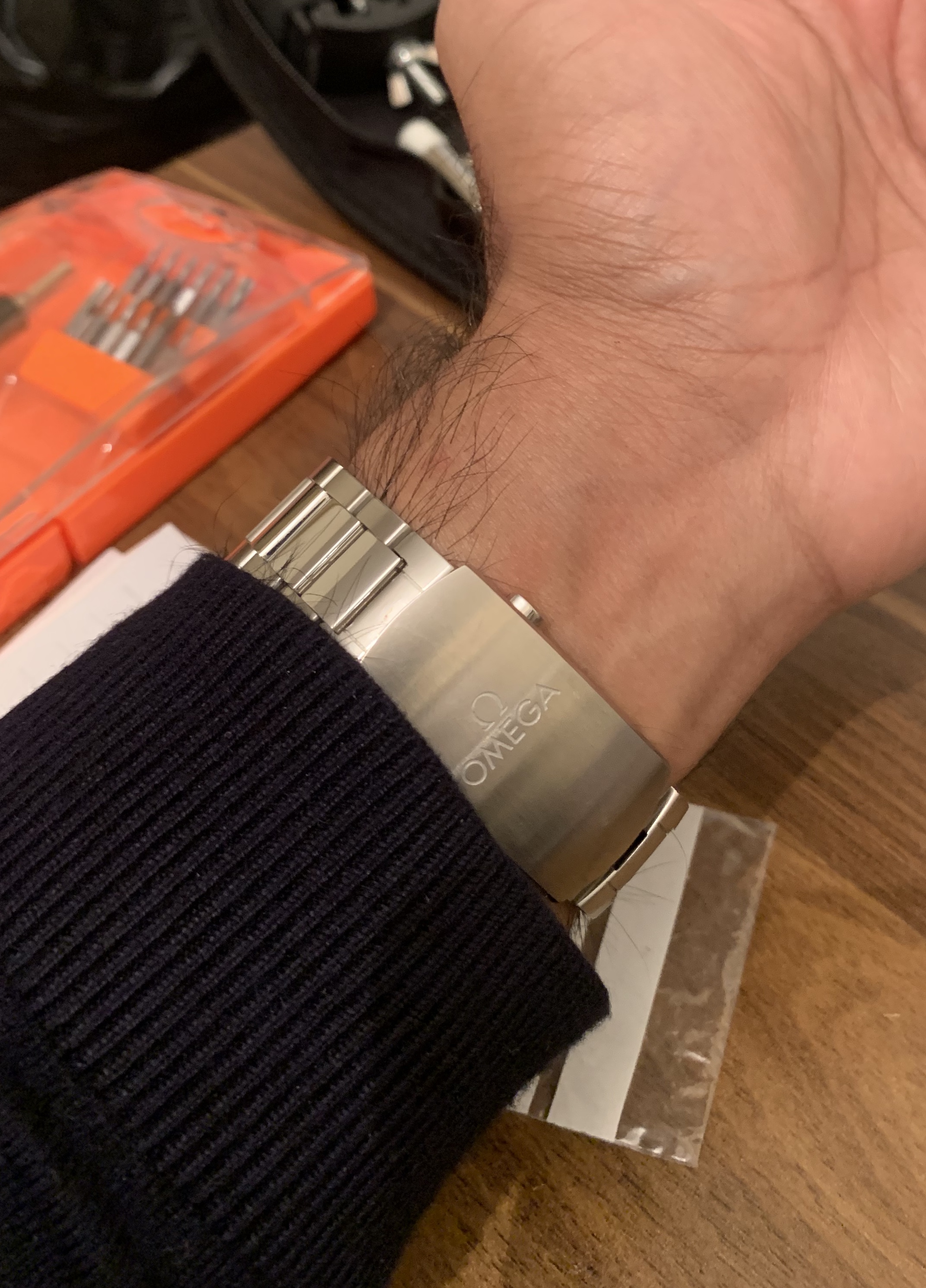

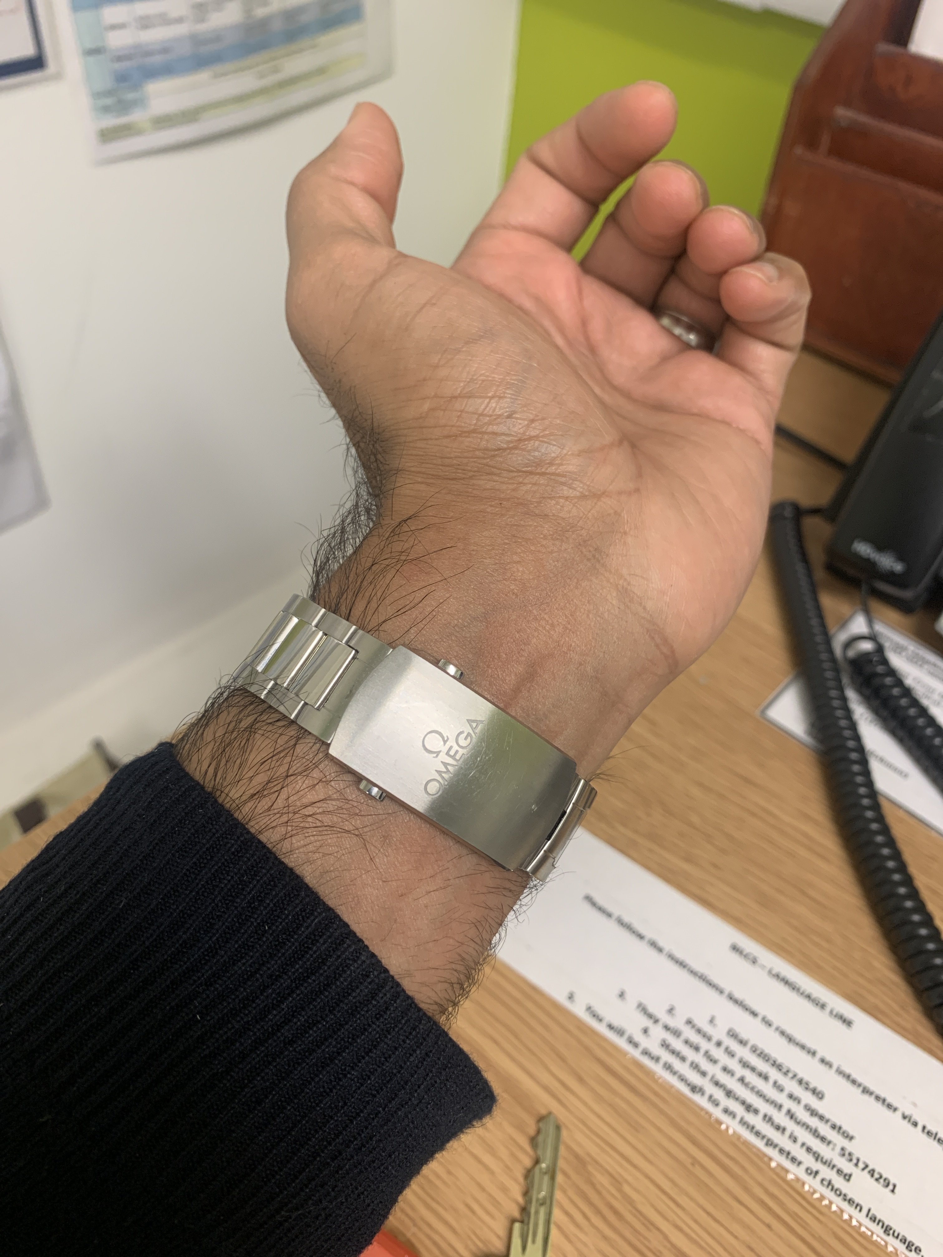

This is interesting...
Would you be able to take post a photo with a clean shot of the clasp (sleeve pulled back) please? i'm just trying to gauge how chunky it makes the bracelet...
thanks

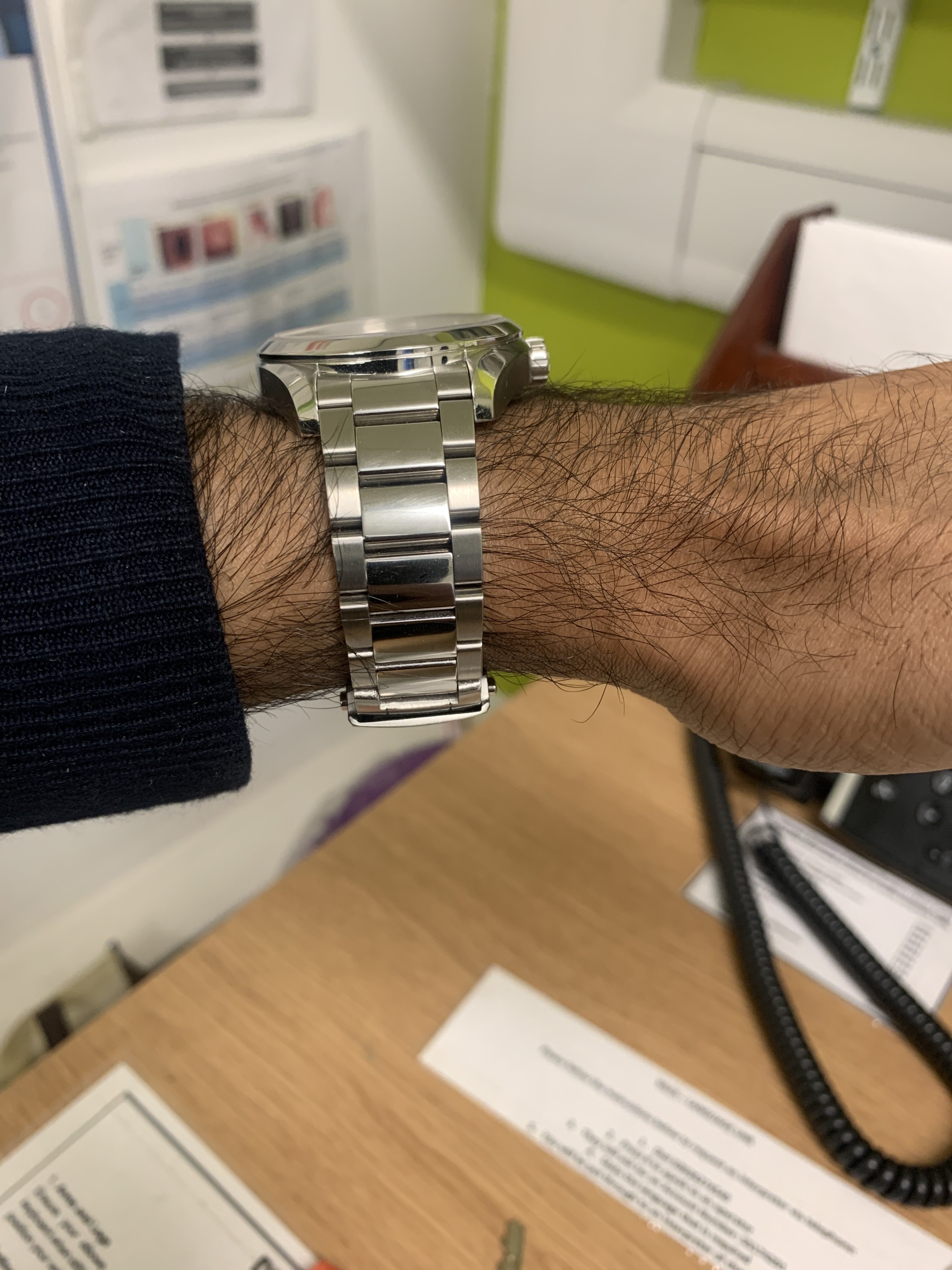

it is very slightly bigger. We are talking about 1mm on each side.
It is also very slightly heavier than the original butterfly.
However, it feels more secure, and sits a lot better and centred

Pretty impressive hack/bodge. My girlfriend has an AT that doesn't quite seem to fit perfect either and this has got me wondering if this is the key.
I've installed the micro adjust clasp on two of my POs and on my Speedy and it's a night and day difference. I'd love to see that clasp fitted to as many bracelets as possible going forward.

Cool project! What end links did you use for the conversion? I know you said had a jeweler filed them, wonder how much did he had to mill out on each side to make it fit
