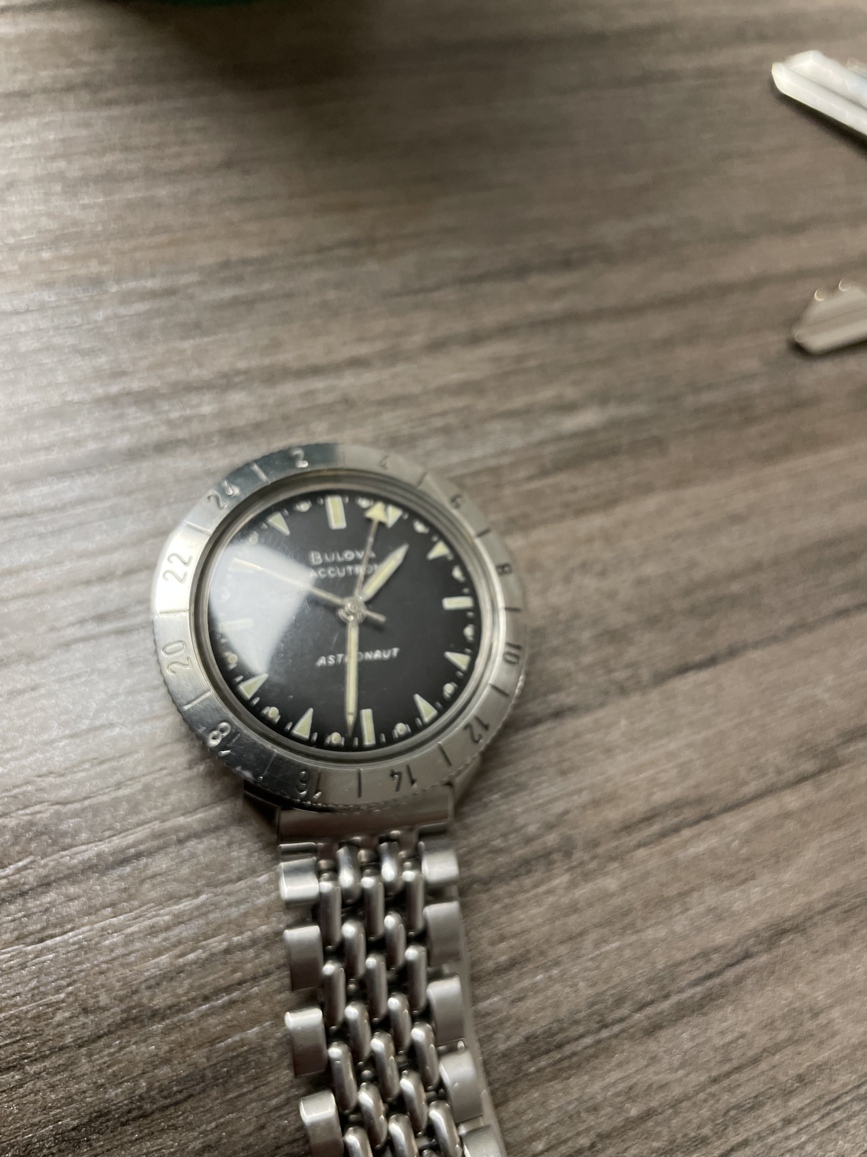

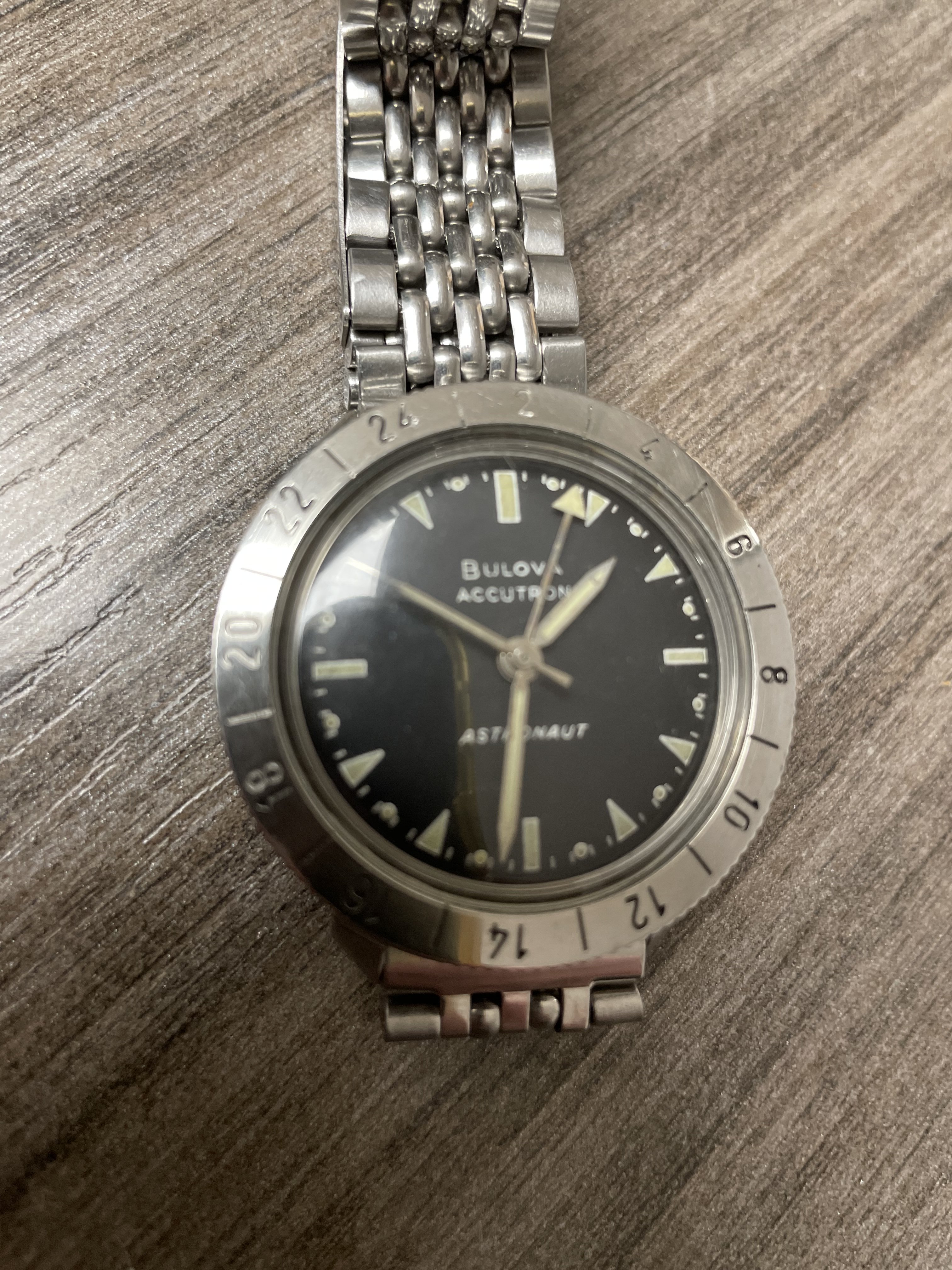

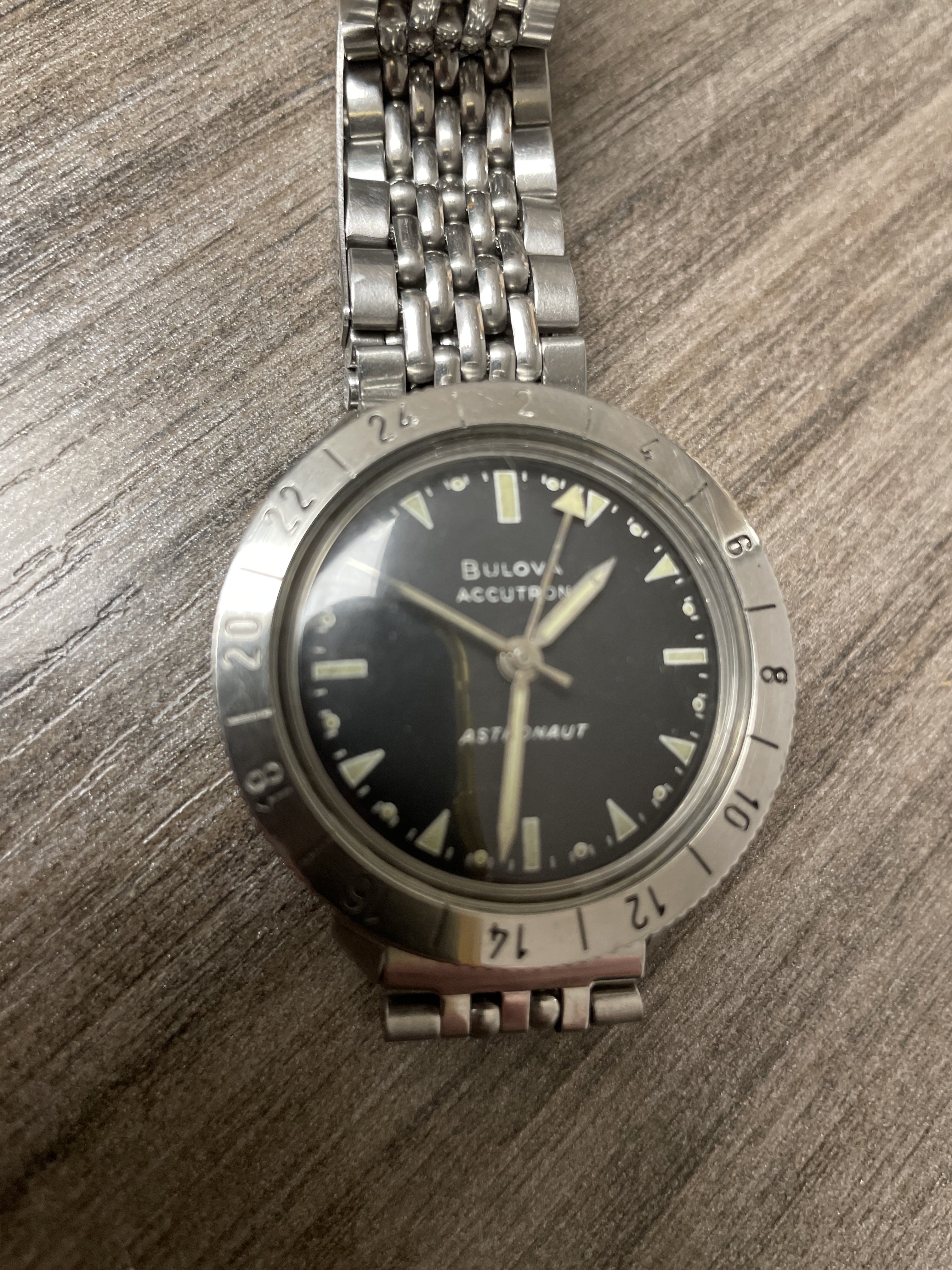

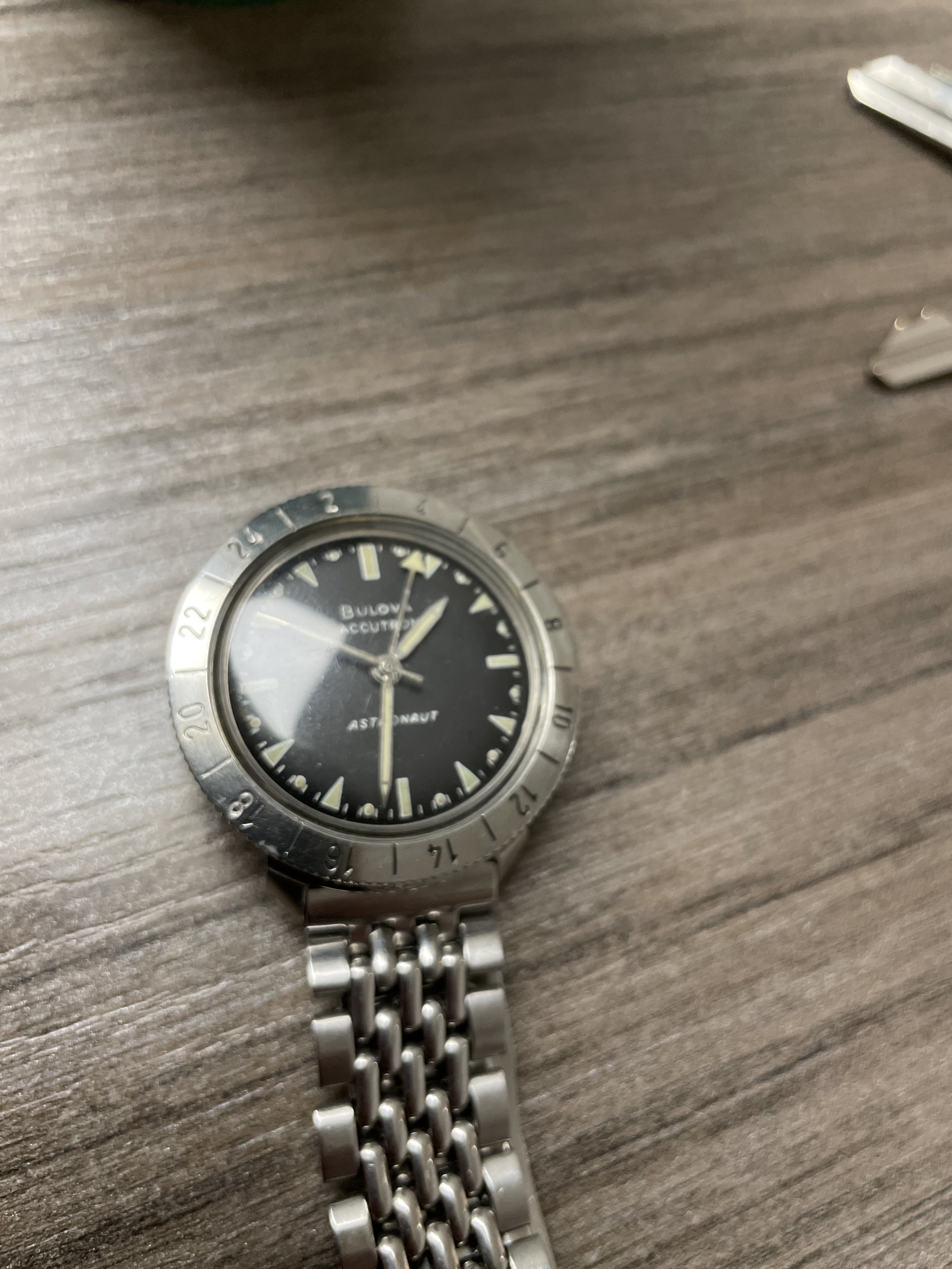

Cool how does yours look. I just picked up a 67 that is at my watchmakers he should be able to straighten it out if not I’m going to mail it out. The suggestions above should be fine. Don’t have mine now but I think I still have the picture. Looking forward to getting it going they are nice looking watches with a cool history. No original bracelet I’m thinking it might look nice on leather

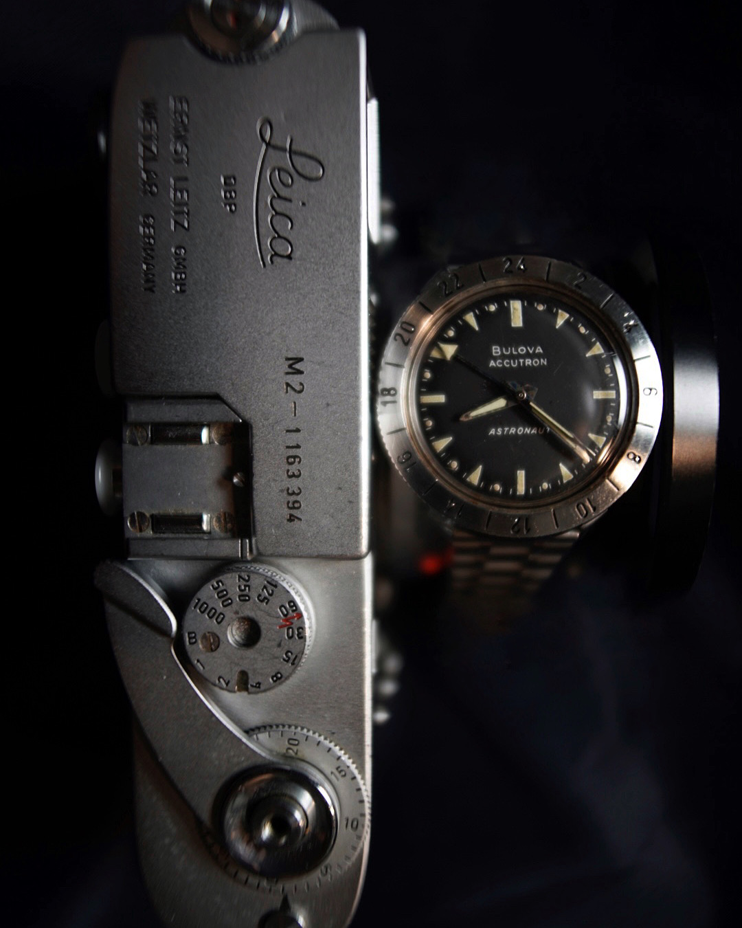

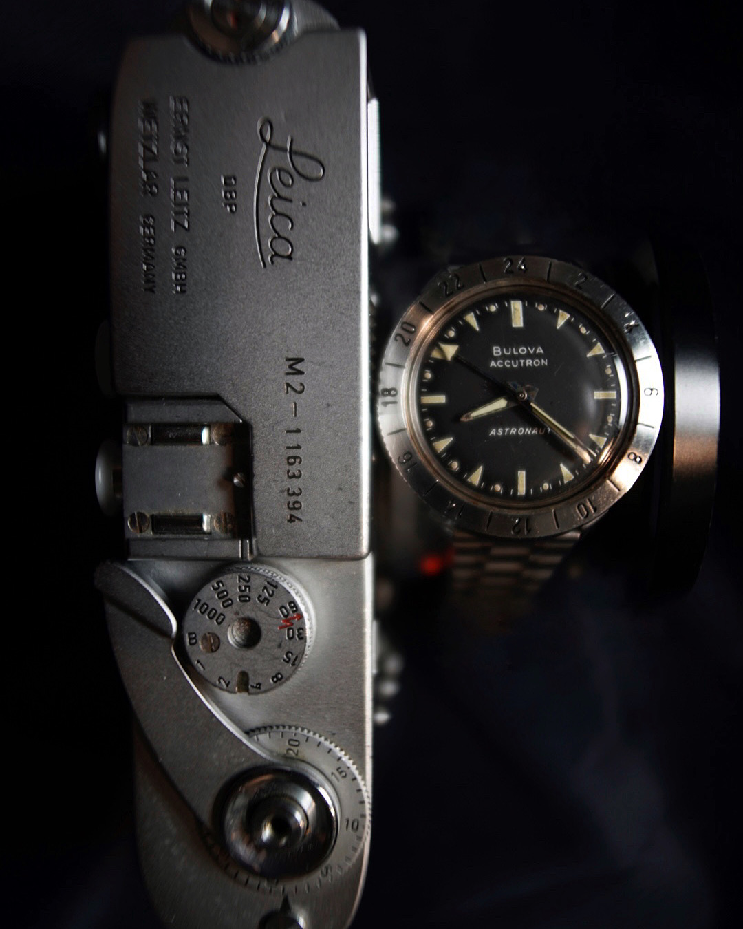

They're not cheap, but Forstner sells a modern version of the "bullet" bracelet which is nice (I have it on my Astronaut pictured above). It doesn't have the curved end-links of the originals, but since the bezel overhangs on the Astronaut, you can't see where the bracelet meets the case, anyway. Per the other Astronaut thread, Forstner's Komfit also works for an authentic '60s look.
