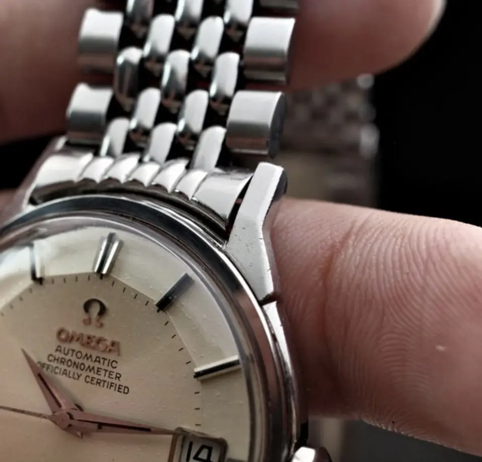

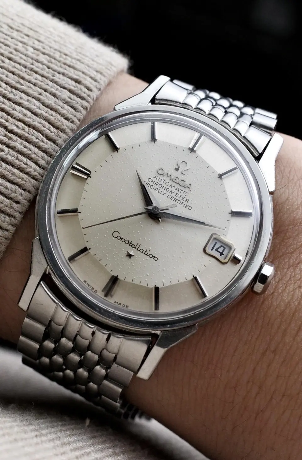

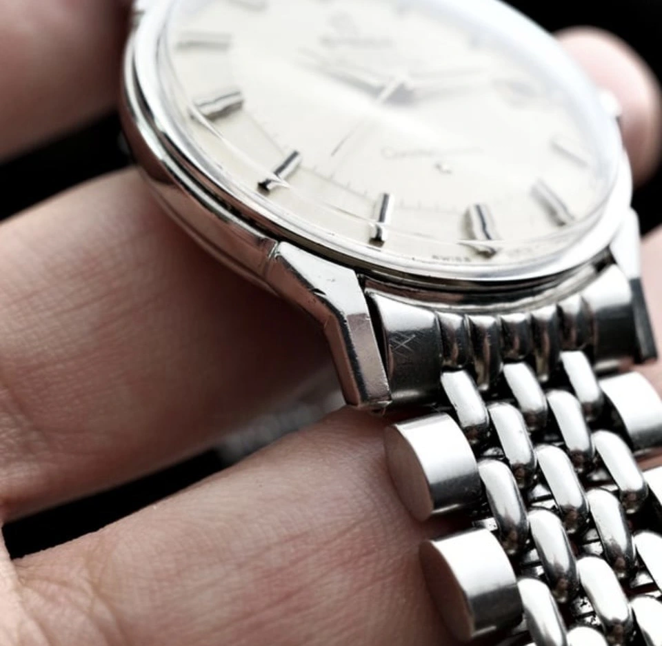

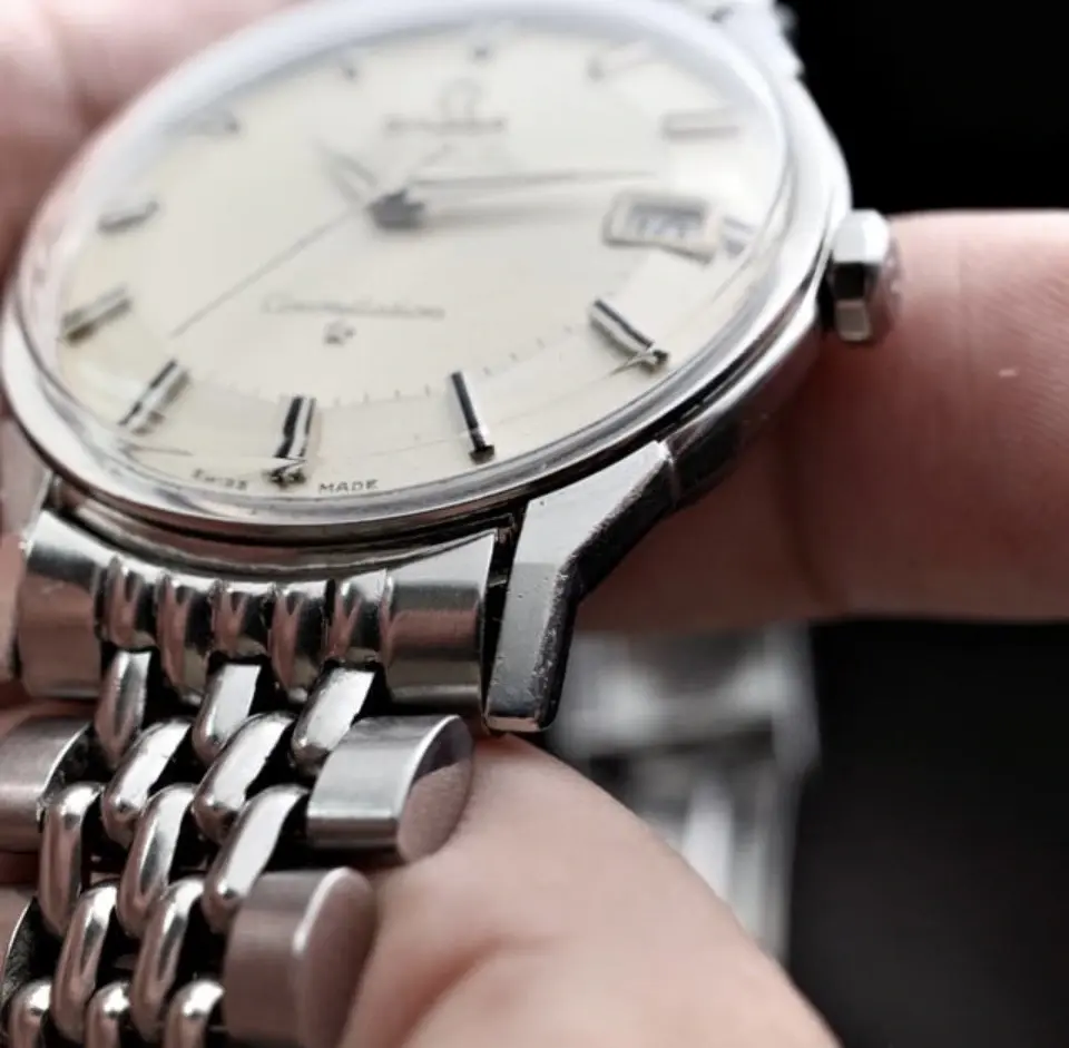

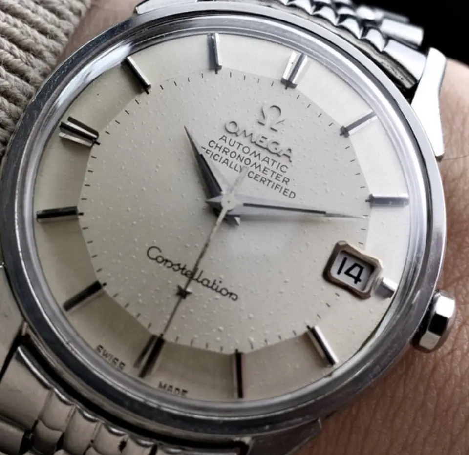

About to go all in on this one.
187
171
I've been looking for a nice 168.005 for some time. This one looks very nice despite the few nicks and fleabites here and there. It doesn't appear to have been heavily polished.
It has been recently serviced and seemsto be running well with good amplitude.

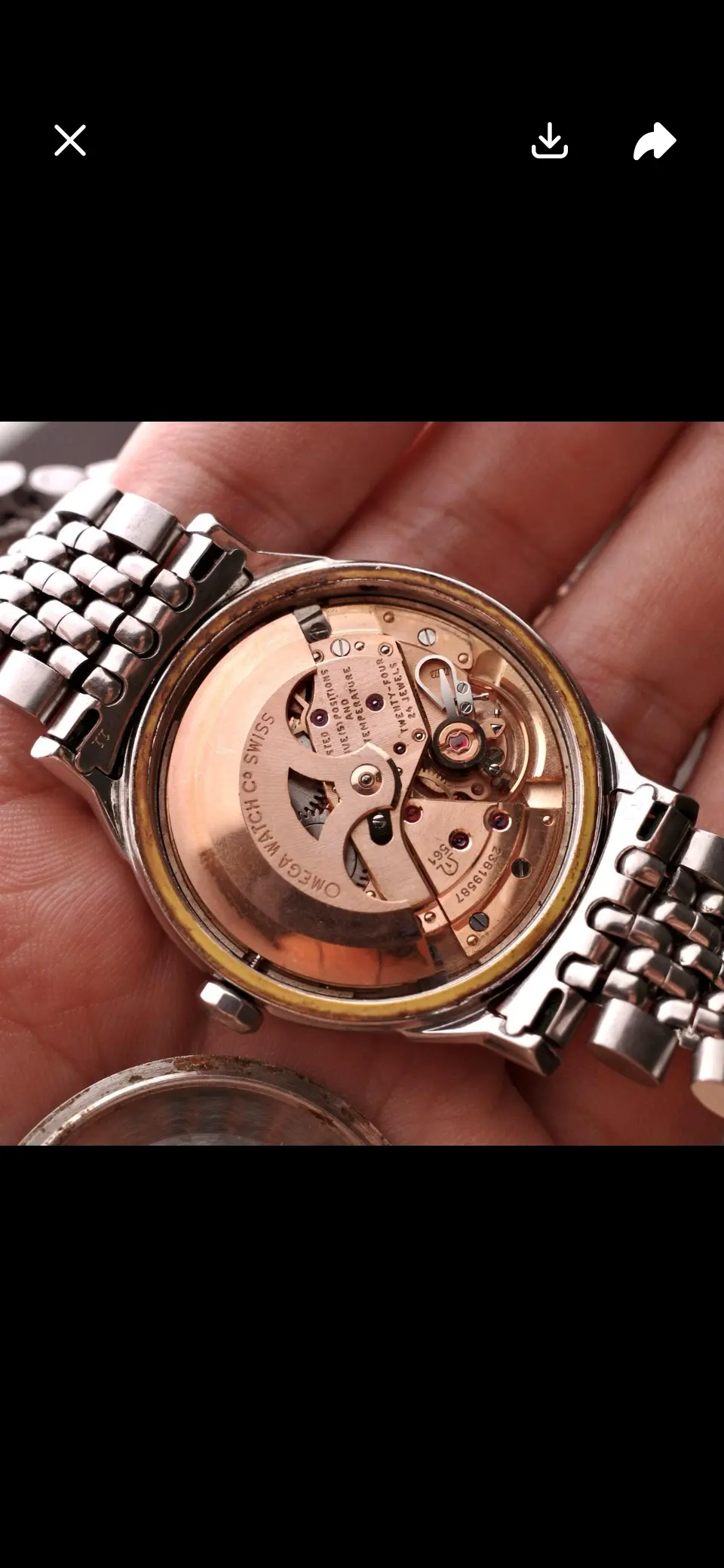

I am awaiting photos of the case back and movement.
I realize the bracelet is not original to the watch and I may replace it if I purchase.
Any red flags?
TIA.
Chris
6,829
10,499

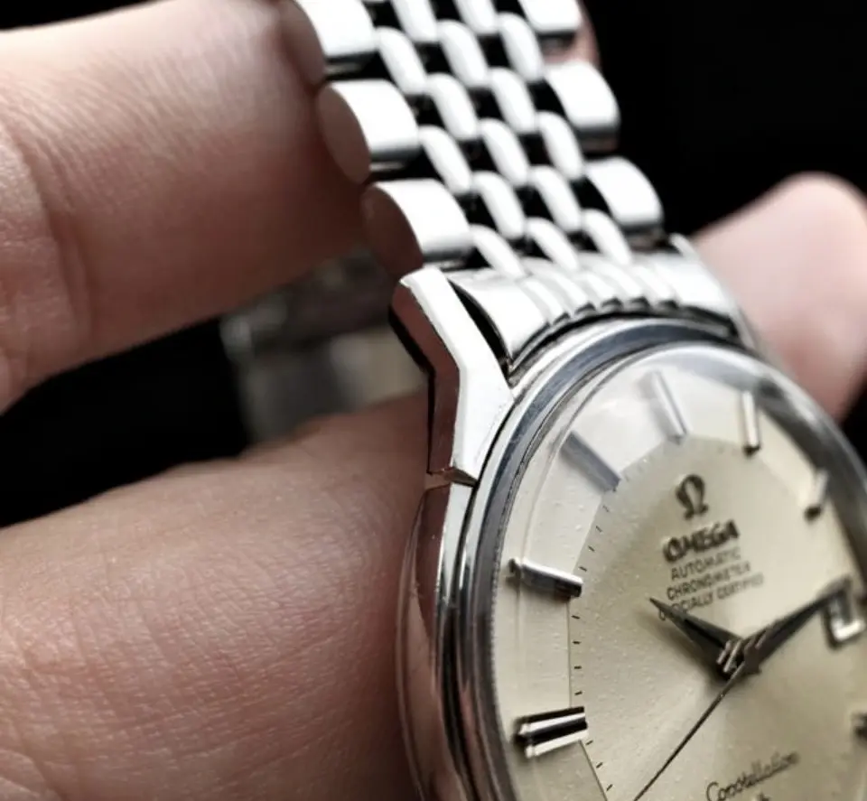

The dial looks correct but has serious lacquer bubbling, from moisture intrusion
I think the lugs have been quite heavily polished as they are really quite soft with little definition left of the facets (the main feature of a dogleg) and have had a very hard life with all of the scratches and dings shown.
It all depends on your tolerance for a 'well-loved' watch - and the cost of course.
I'm sure it would look fine on the wrist but I wouldn't pay a premium for it.

The blistering on the dial is probably not as distracting to the naked eye as it is in the photos, but it is probably going to be noticeable. I don't think it's necessarily a dealbreaker, but something to think about. It's probably the kind of thing that will catch your eye from certain angles, and a matter of personal taste.

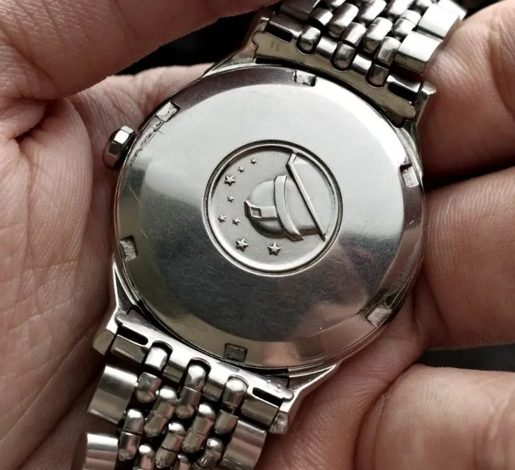

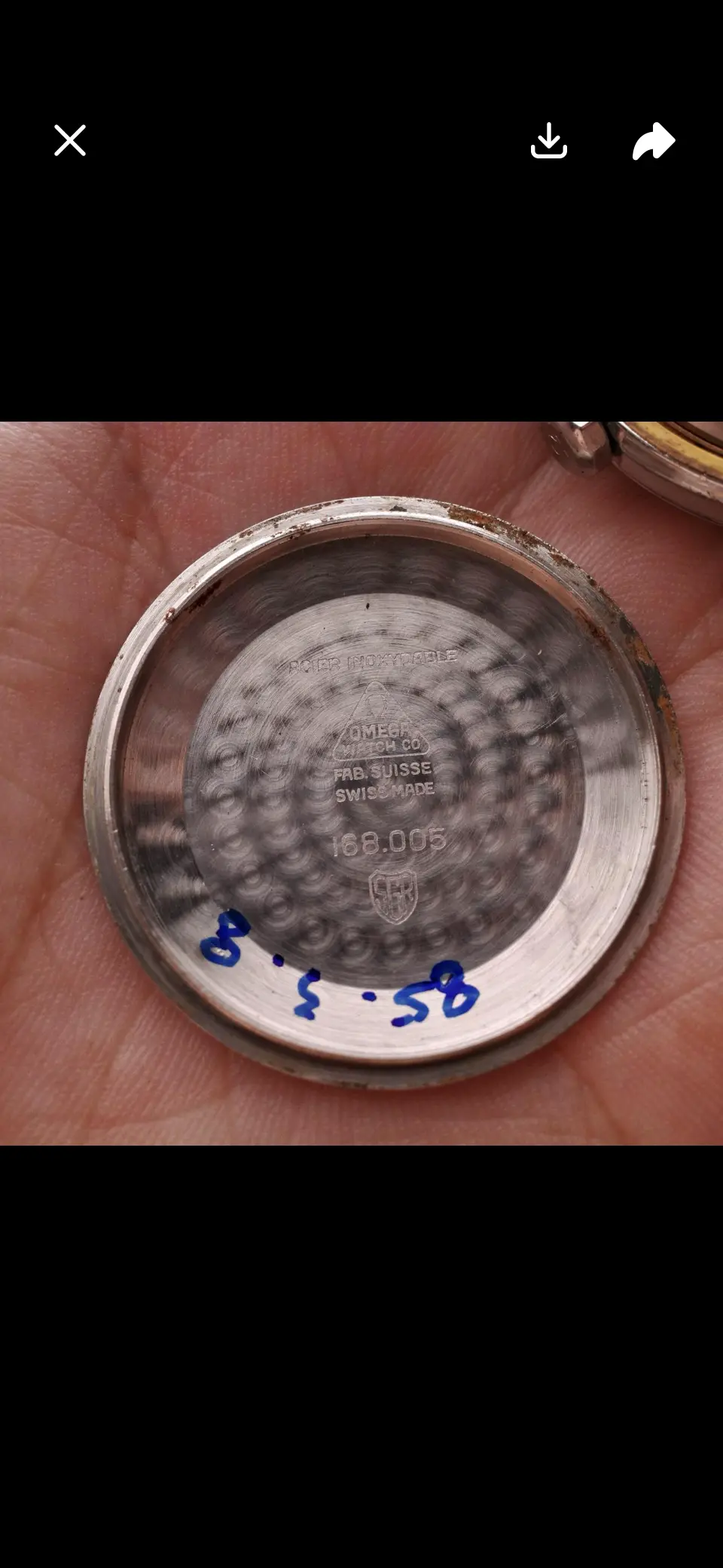

From the new pics, it still all looks correct.
It has a very old gasket and some corrosion around the caseback lip.
The caseback has some heavy 'idiot' marks from cack-handed opening.

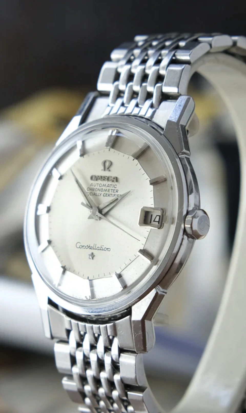

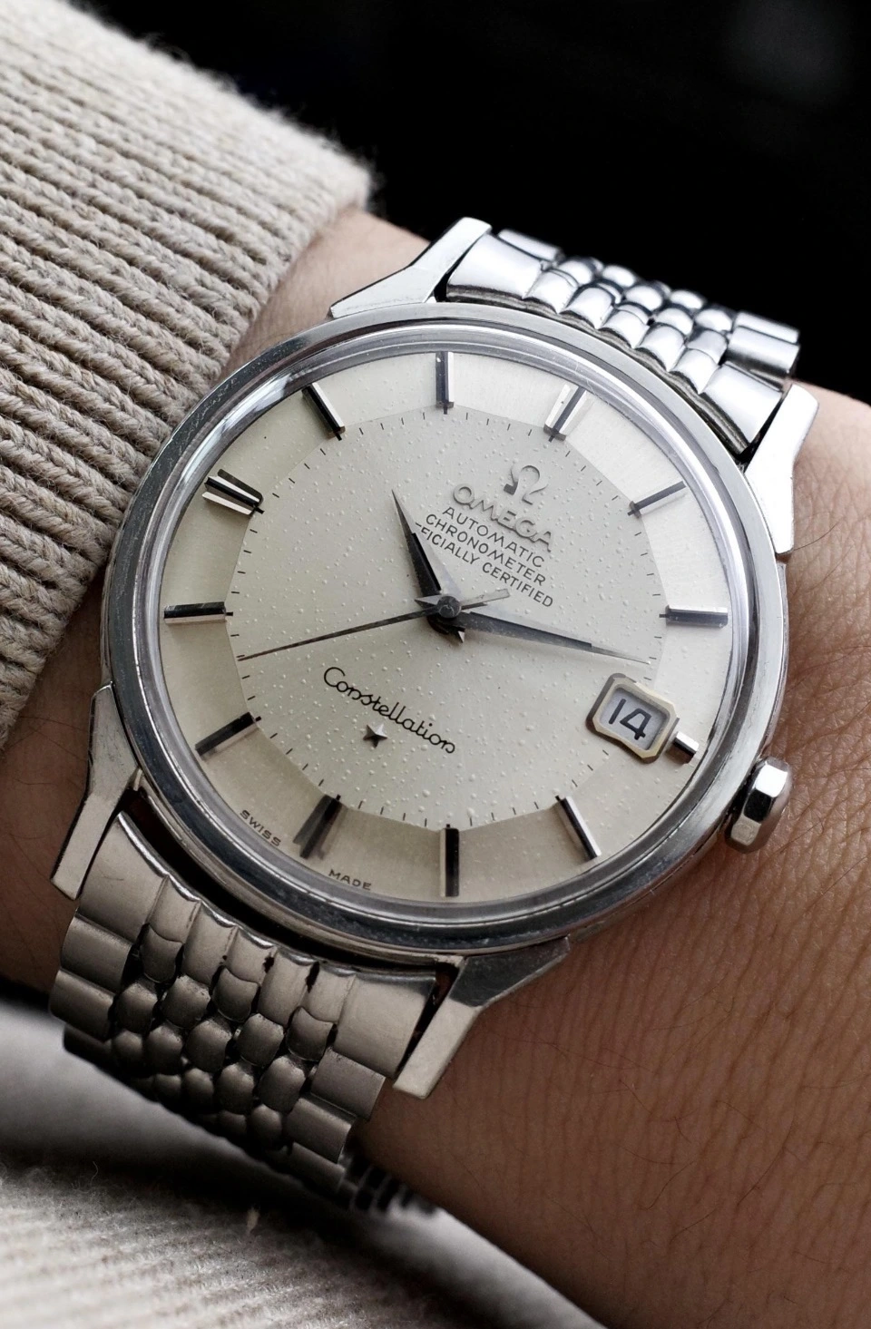

Was doing some looking online and found this much sharper example with minor dial aging that recently sold for several hundred less than the asking price for the other.
I think I'm just going to take my time and wait till I hit 200 posts here and put up a want to buy ad.
From that one photo, this looks to be a significantly better watch than the one you first posted here.
Just look at how much the facets are showing on the lugs on this one.
Yes the first had onyx inserts, which are desirable, but the dial on this one looks cleaner than the first.

Yes, I was poking around to see what nice not over-polished examples looked like and found this one that evidently sold for 2300.
My favorite examples are the ones that have the gold furniture and hands in the all steel cases. There's something about the contrast that really appeals to me.
It's a good idea to wait but there is no reason that you can't post something that you find, for comment.

I noticed that too. It that tells you one of two things:
a) He's a bullshitter and it hasn't been serviced at all but has a readable trace on his $50 Chinese timing machine
b) Its been serviced really badly ie dunked in Horolene then put back in the case with a reassuring squirt of WD40
No one who does a decent job leaves a filthy, degraded gasket like that in place. Particularly as it is covered in dirt (best case) or rust (worst case)
Either way price it as unserviced.
This is me, who is selling this watch. Been selling hundreds of watches for years and always stand behind my stuff. It's funny that you can say I'm a bullshitter when I literally have it serviced and sent a pre-service pic.
10,796
16,805
So why send a pre serviced pic?
1,981
3,868
and how do you feel about that now ?
93
423
Because that was what I had in the gallery at that time.
Nothing I guess. Just say what I have to say.
10,796
16,805
Well do you see how that pic prob did more harm than good? You are a professional seller. Was it too much trouble to take a post service pic? Anyhoo the damage is done.
