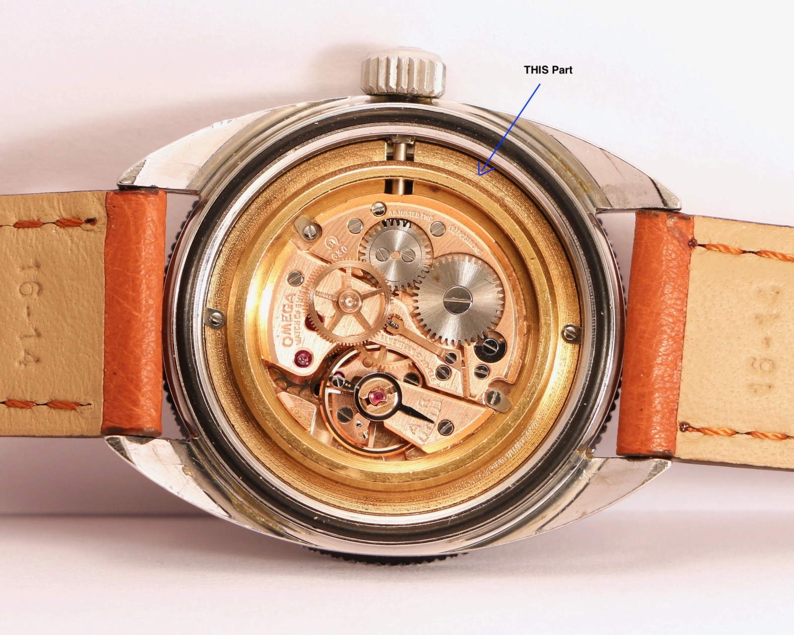

I'm currently restoring a 535.007. I love this watch.
But I can't find a movement holder for the caliber 630 that will secure it in the case. Do you happen to know the part number or have any idea where I could find this part? I'd like to avoid using a plastic holder…
I'd also like to know the part number for the hands for this watch. I don't know how to find it. Is there a list with these part numbers?
Thank you for your help!

630 is the sweep version of the ever ubiquitous 620. Some of the parts are interchangeable. Most likely any 18mm movement holder will work. I use the Bergeon 4039 movement holder.
The 670 and 680 ladymatics are also of similar size. As far as I have experience, the dials and hands are interchangeable.
Not sure why the 630 is so rare? Would love to find more myself as this is a good three hand movement. I think the 630 is usually found in the dynamic style case like the 535.015.
Later production used 625 for dress and 635 for sweep. Those are not as nicely made.

I don't know why 630 is so rare. If you need, i have one, he's ok but need revision. It stops after 1 minutes.
Here you have the part I'm looking for. I write on the picture...
29,672
76,830
07906200C | ENLARGMENT RING​
14
Thanks a lot!!! it will help me.

The arrow looks to point to a movement retainer. My guess such a ring will be next to impossible to find. -- I see while writing this @Archer posted the ref. Omega does not sell parts to US watchmakers anymore (@Archer is in Canada.) so there are no longer any independent Omega watchmakers who are competent in the US. Especially in places like the SF Bay area where I have yet to find one I could trust with my speedmaster. So one has to find another watch to scrap or get lucky with an estate auction on eBay. And the competition is fierce --
There is a trend to think that something rare is special and valuable. In practice rarity is more like a white elephant. To special to use as a work beast, too expensive to feed.
The best one can do with the incomplete case and movement is to list it for a low amount on ebay say 0.99 with no reserve. The parts will sell for close to if not a bit above the market value.
I personally would not bid more than 150 for such a watch. I used to get them for 65 to 78 or so. There just is no a market for Ladies watches. I have more than I can use or work with. Economics and budget dictate that one is better off using funds to acquire parts for the more popular 55x. 60x and the 330 bumper along with the older 30 Tx calibers.
It also may work that separating the case and movement could bring in a bit more. The sweep wheels are fragile. Especially the spring which if bent will cause the sweep pinion to come loose. The third wheel snaps off easy.
If the dial and hands are good. They can fetch in a separate auction as much as the movement or case.
The other option would be to have the retaining ring made. It does not need to be base metal. Delryn or Acrylic would suffice and are easy to turn. It could also be 3D printed. The watch would not be salable, would be usable. Servicing the movement would cost more than the watch if complete.

As an Omega certified watchmaker I have access to information that the general public does not, so I found this information on the Omega Extranet - any certified watchmaker will have access to this information.
Do you know where I can find it?
Not on the open market, and honestly it's not likely a part you are going to find easily. I don't know where you are located but if you can find a certified watchmaker in your area, they can order the part from Omega and install it for you - it is still available.
Ok thanks a lot. The response is very clear and for me very important. It's my beginning in oméga watch. I love only these. I'm in france, so maybe here it's possible. If you have, I will buy it! thanks for all!!!
