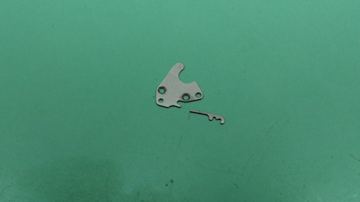

Keep in mind that rotors by nature typically have a very thin cross section from the area near the axle (or bearing) leading out to the edge where the weight is. The thin plate can be subject to deflection, so if the watch receives a shock it's not impossible for that to bend enough to have momentary contact with the edges of a bridge on the movement, causing that clicking sound.
The flexing can even crack this area of the rotor over time if the design is weak, like so:
Now as I mentioned previously in this thread, I've seen rotors bent to try to provide clearance instead of fixing the bushing, so it's possible that if there is a bend or twist in the rotor it may be closer to the bridges than it should be, and even a small external force causes it to hit the bridge. The only way to know it to open the watch and inspect the gap as you turn the rotor to see how close it is - I often see them with a slight twist that I correct using #8 tweezers...
Cheers, Al

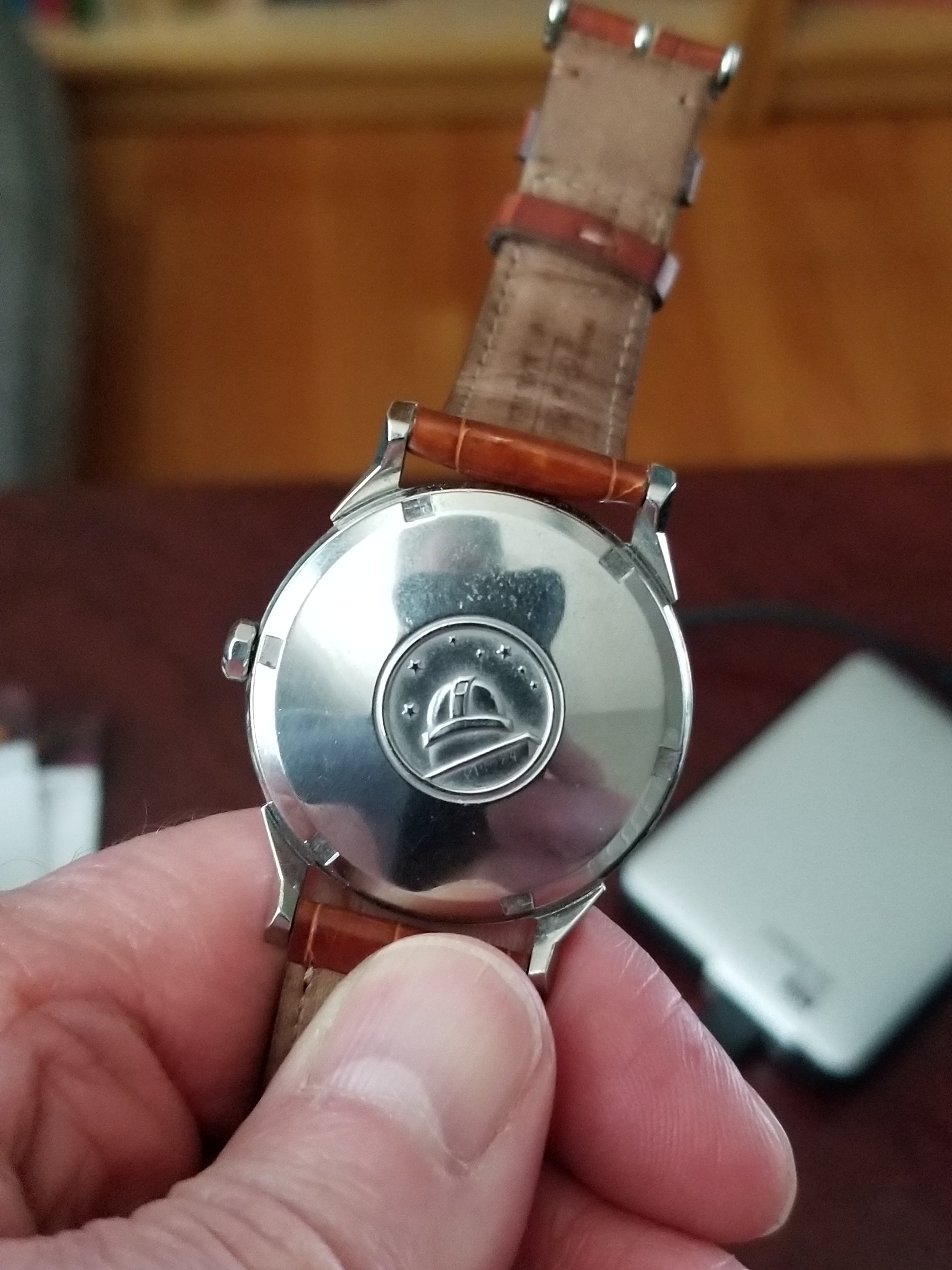

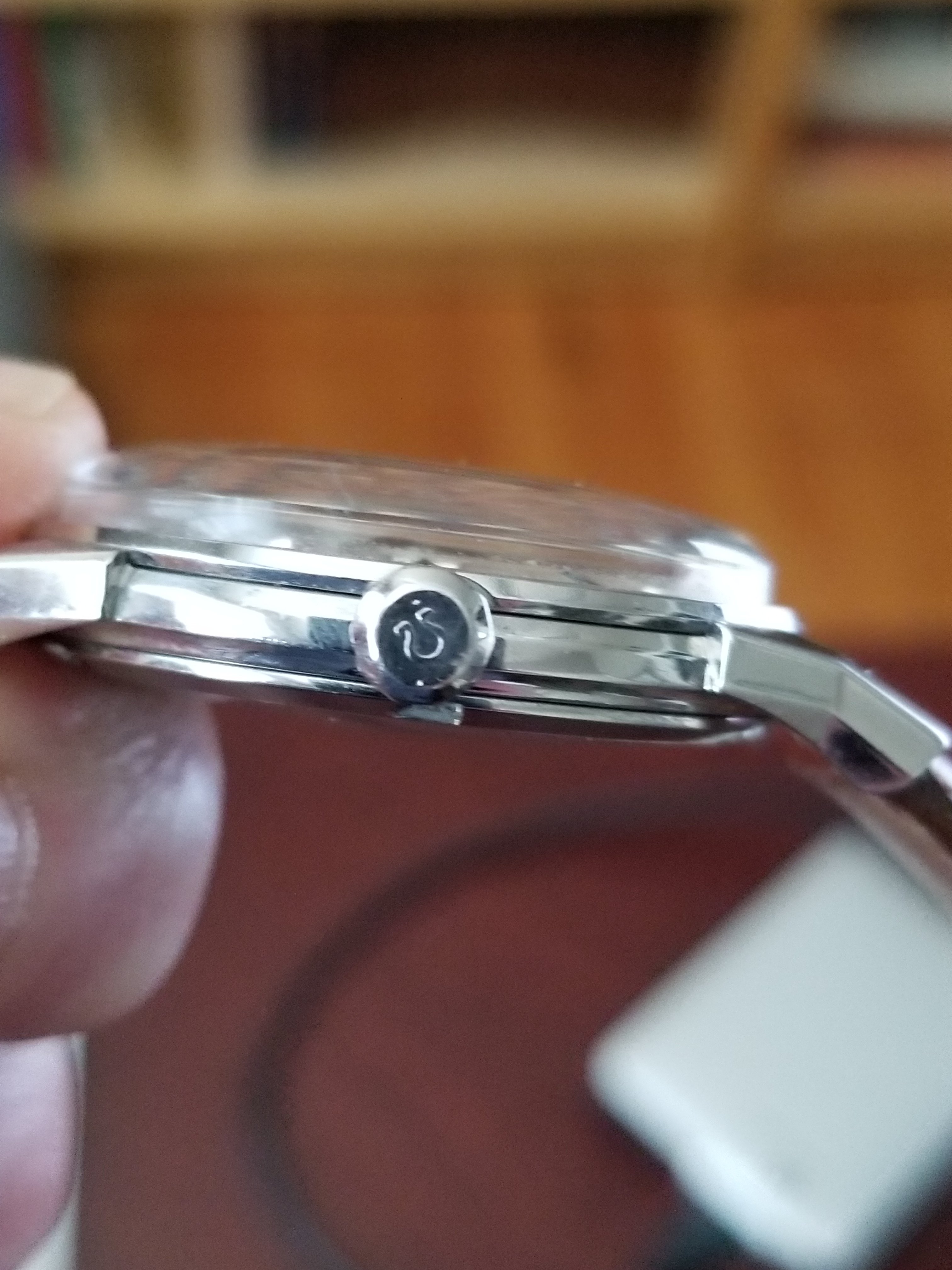

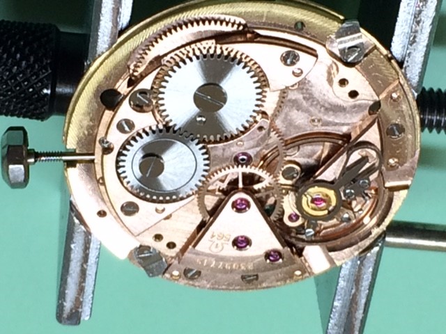

I just realized that I never posted pictures of the Connie after it was repaired. I'll start with a before picture.
165
212

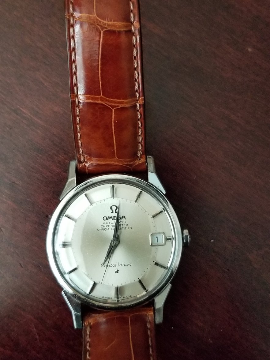

And here are some photos of the watch after it was repaired.
165
212
This was my first Connie, so long as i exclude the one that UPS lost, and I'm grateful for all I've learned from the OF members.
