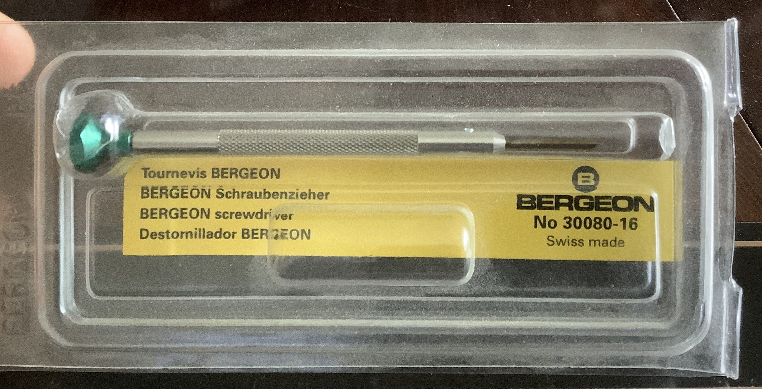

I found this screwdriver amongst my tool stash:
It’s marked as a “2.0.” My question: if I wanted to retro fit a 1.8 blade into this screwdriver, can that be done, or do I have to buy a 1.8 screwdriver to take a 1.8 blade?

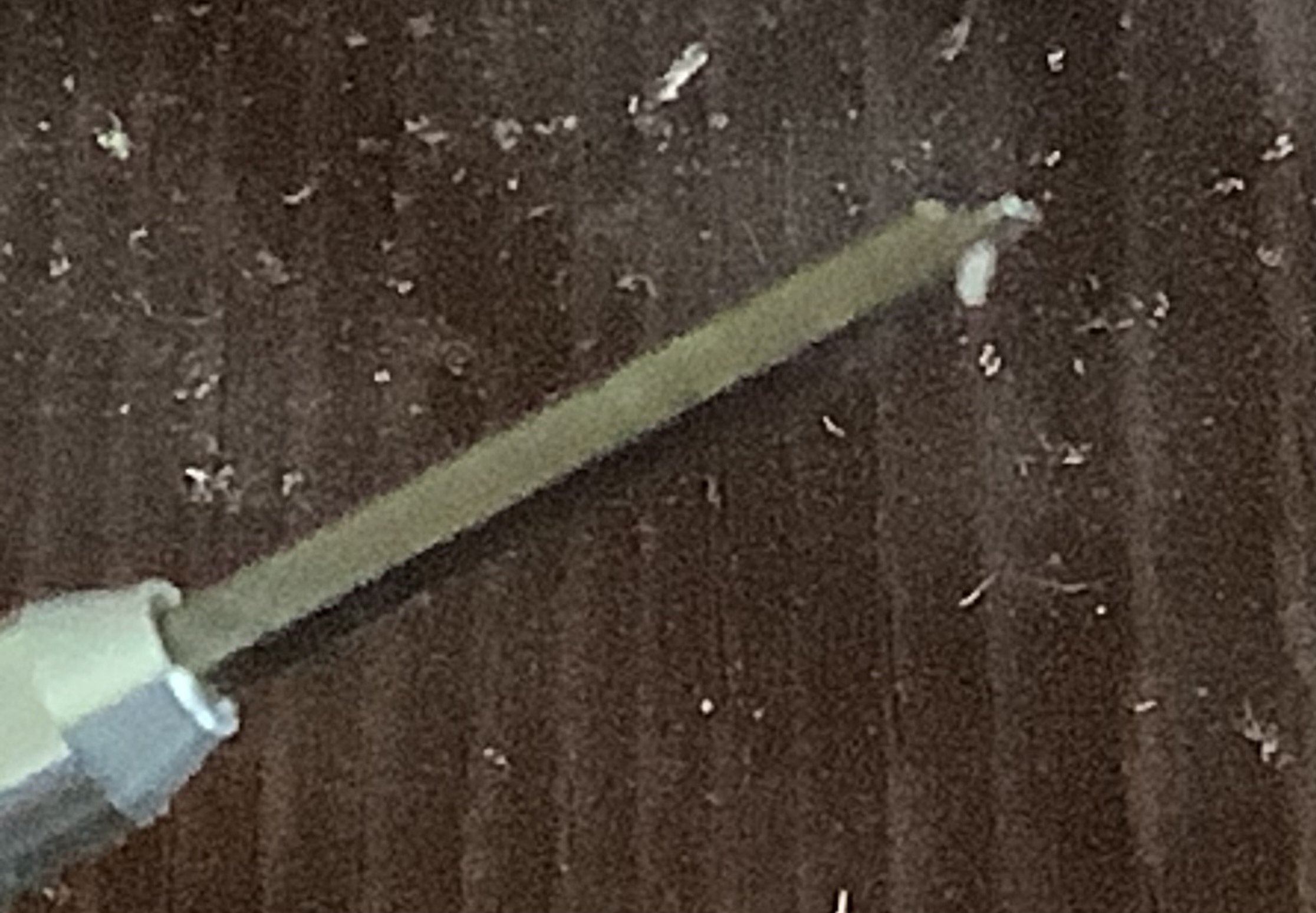

Also, look at this tip:
This is the way it came from the factory. Has anyone seen this particular model in the Bergeon line? I can’t seem to find this and I’ve searched. Many thanks.

you would not be able to secure the 1.8mm blade properly on center into a 2.0mm handle

Thanks, interesting. So most/all of the screwdrivers have internal diameters specific to the respective tip sizes?

i have seen one with shanked blades i cannot remember who made that set, but my horotec and my bergeon are both specific handle per size

You generally have to fit the size blade that the handle was made for.
That is a hollow ground blade by the look of your photos - ideal for rounded heads on screws, but not as good on flat headed screws.
