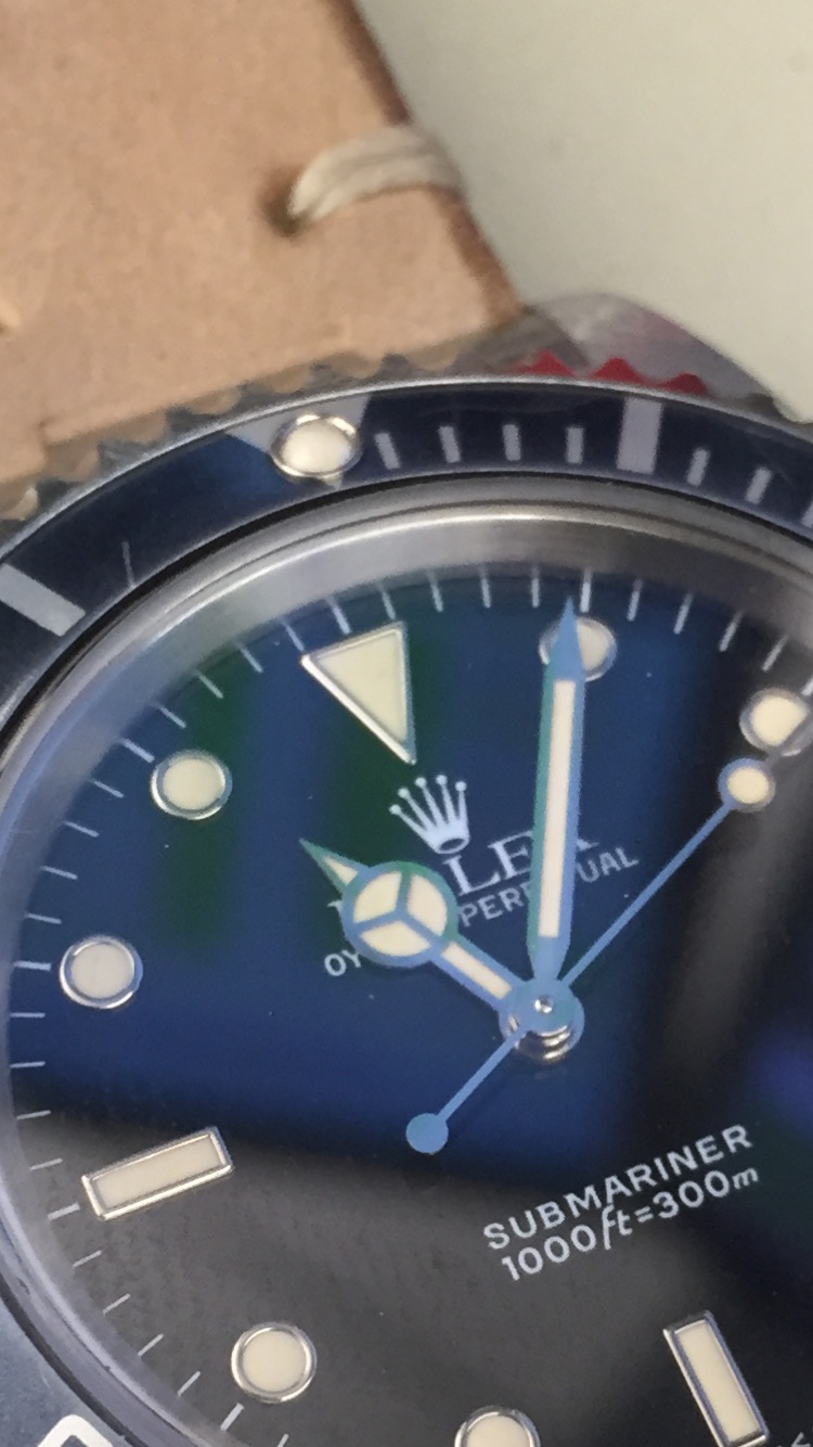

I specifically bought this 14060 because it had tritium that had started to turn creamy, and I loved the contrast with the WG surrounds ...
