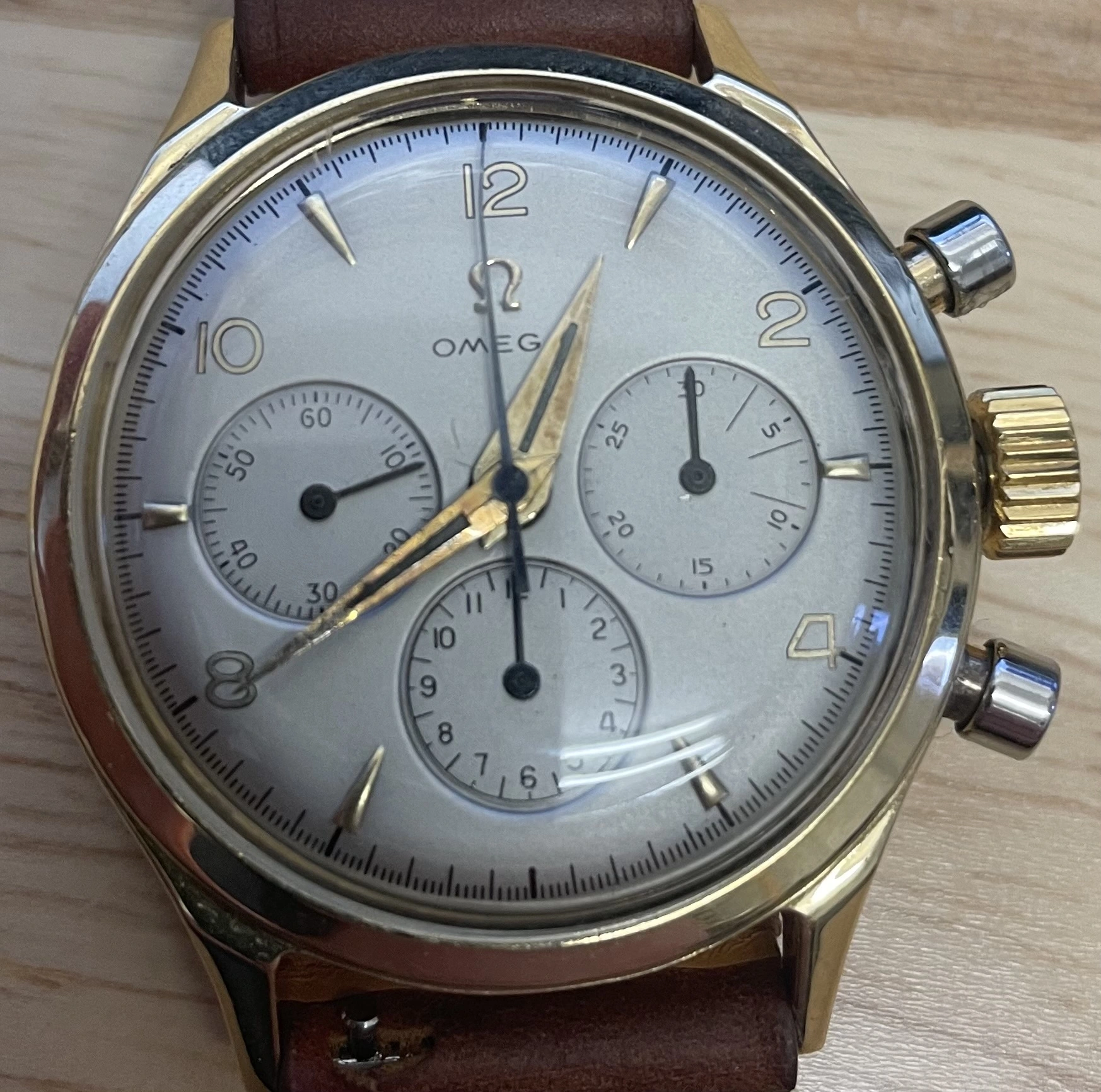

Are you certain this is the same size, from the same reference?
And the good dial repainters I would assume would do their own homework. I don't really know. It's so frowned upon here, nobody really gives a ton of info about the really good ones. Most are crappy, and we like it that way. Makes them easy to spot.
It's meant to be from a 321 movement, apparently a seamaster and diameter is 29.6mm. So it's a risk, but why not.
Don't think you lot will have any issue spotting that it's a respray!
8,186
36,740
I think you've been pretty lucky there as there are quite a few different 321/27CHRO C12 dial sizes depending on case reference.
I've measured a 2451 dial to be 29.7mm so 29.6mm will certainly fit.
40
4
I measured mine at ~29.6 before buying, but still not counting my chickens until it arrives and I offer it up to the movement.
i haven't managed to find a picture of a watch with that dial, plenty of similar with metal numbers, or painted numbers but without the metal logo.
40
4
Just in the process of getting this watch tidied up, doesn't anyone have any recommendations for places in the UK that do laser welding so I could get a couple of dents in the case filled?
Also just trying to find a replacement crystal for it, all of the tables on the internet seem to suggest that this reference needs a 32.1 - 32.2mm crystal but I think that assumes it's a steel/plated case rather than a gold one. The actual ID is only 30.8 - 31.1mm - any idea where I might be able to find a genuine replacement - or is it just a matter of trial and error?
Incidentally, if anyone in the UK needs a 32.2mm NOS one (MIS 977) with logo in the centre and a gilt expander ring let me know.
40
4
It’s an obvious repaint but it’s useable again now and the original dial is safely tucked away whilst I decide what to do with it .
