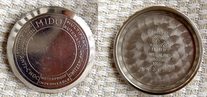

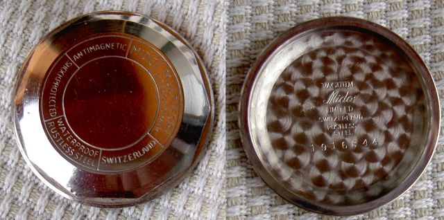

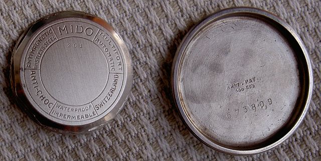

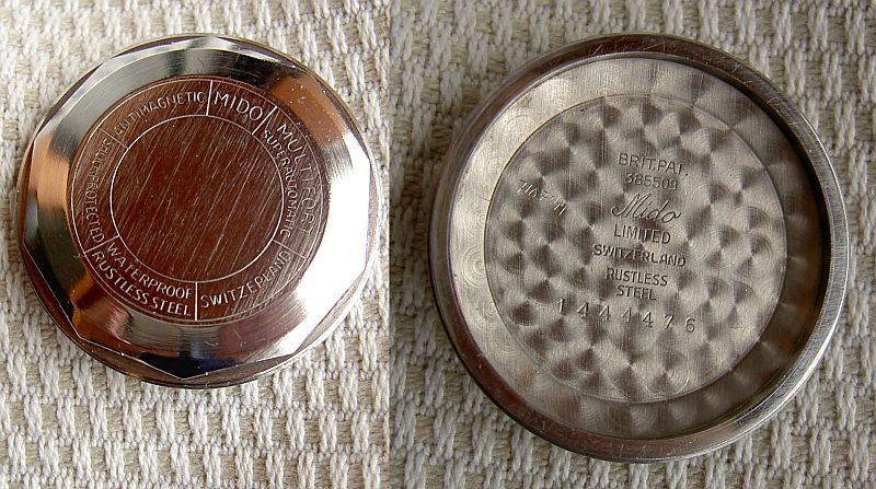

..............No idea if the back is actually a two part design where the decagonal part has been merged with the screw-down back or if there is another explanation for the design.
It is probably due to the case maker being a perfectionist.
The circular case has had a groove cut with a parting tool, and then the decagonal flats have been machined on the outer/upper rim. This results in a clean definition between the circular case back and the decagonal flats and an absence of machining or stamping marks as you can observe on case backs of similar design.

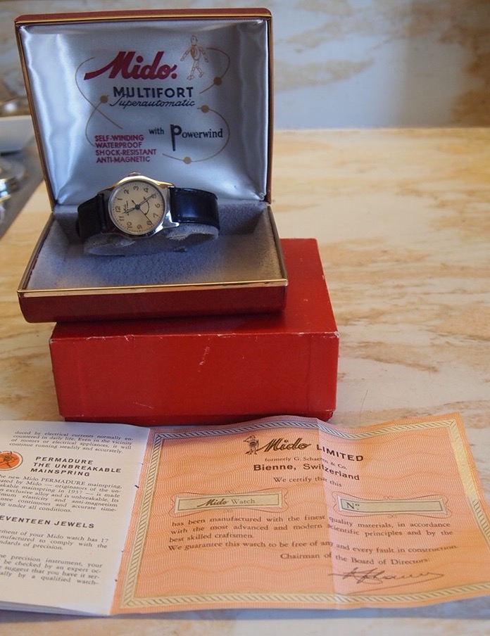

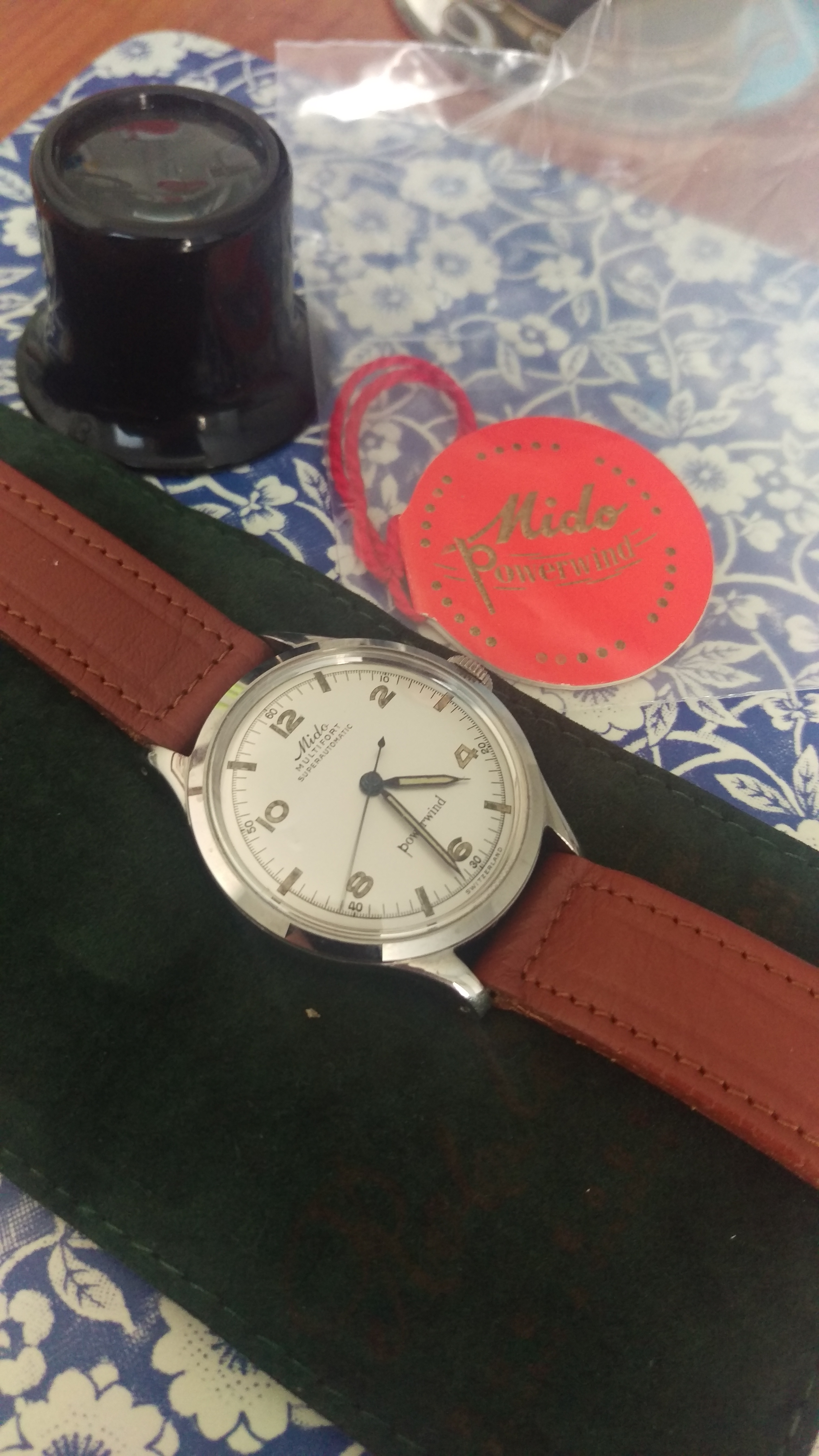

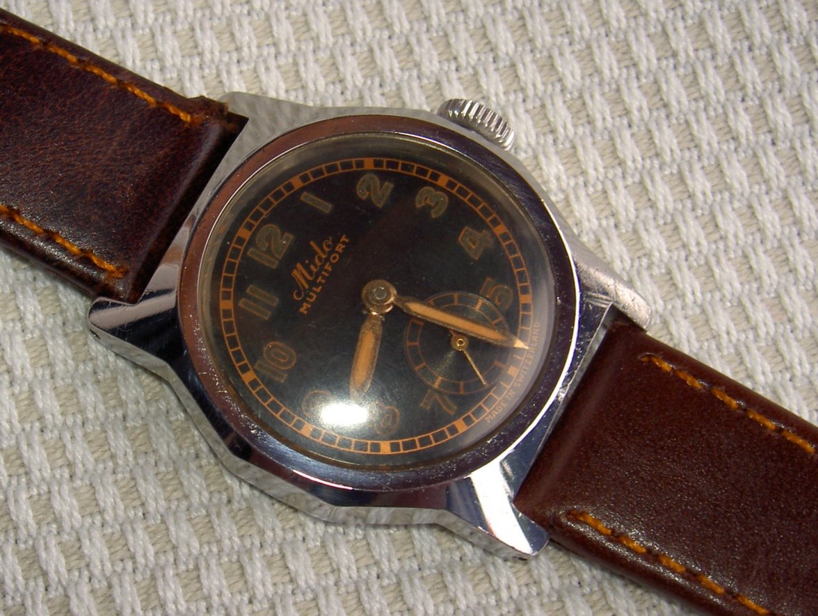

My only Mido. Bumper automatic, early 1950s. Boxed set including POS case, outer shell, and un-dated warranty. Never wear it as it is far too small,on my large wrist. File photo, so not the greatest.
That makes good sense. When you look at the sides of the ten-sided "nut" you can see clear marks from machining.

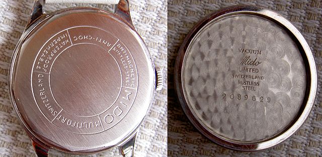

Taubert, actually.

People will correct me if I'm wrong, but I think the point is that all of the cases posted here were Taubert designs, using the famous decagonal screw back system patented by the Taubert manufacture. Taubert bought François Borgel in 1924 and introduced noteworthy and very successful innovations like that closure system, even though it kept using the FB brand and logo. The François Borgel cases in the strict sense were famously used on WWI era watches.

As Syrte suggests above, Taubert bought Borgel and continued to use the FB signature. All post-war Midos with such cases were certainly Taubert, not Borgel, even if the latter's designs endured.
Consult David Boettcher's seminal history for details:
http://www.vintagewatchstraps.com/taubert.php

Many thanks to both @Syrte and @Tony C. I've always been annoyed at the "Ooh, killer Borgel case" etc. found on Instagram and the like...
Technically, it is a Borgel case. Taubert just owned the design and name. You can call it Borgel and only be referring to the design instead of the brand name.
