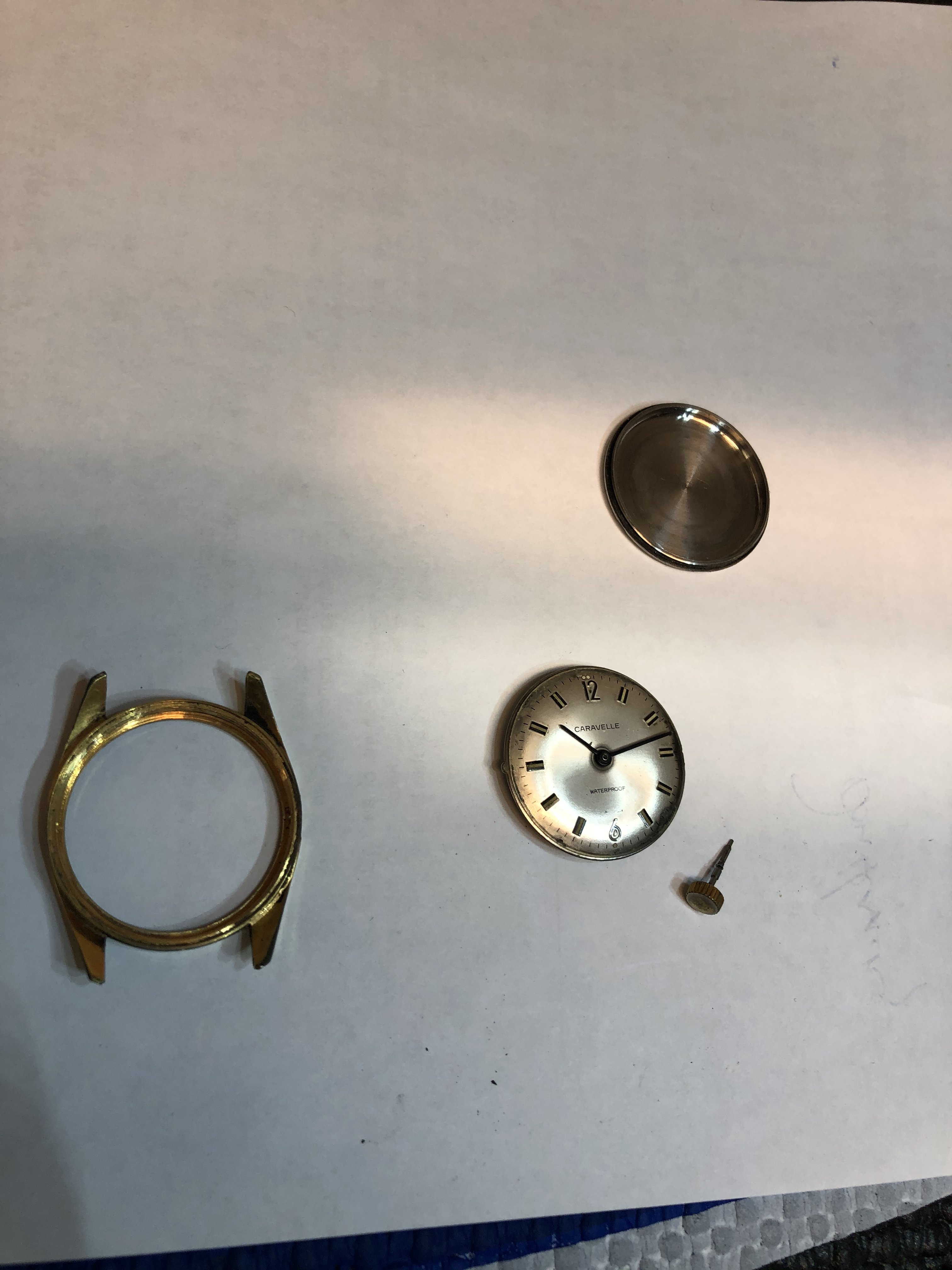

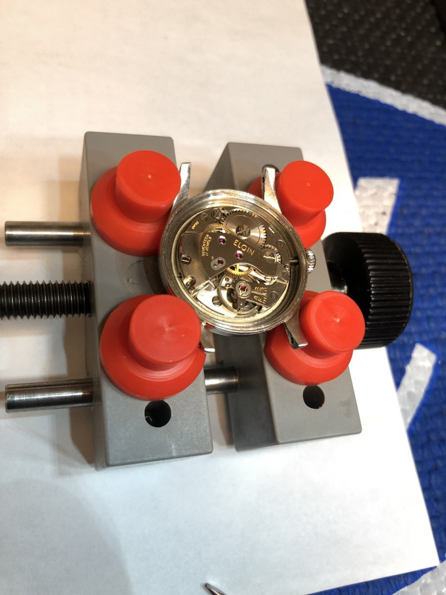

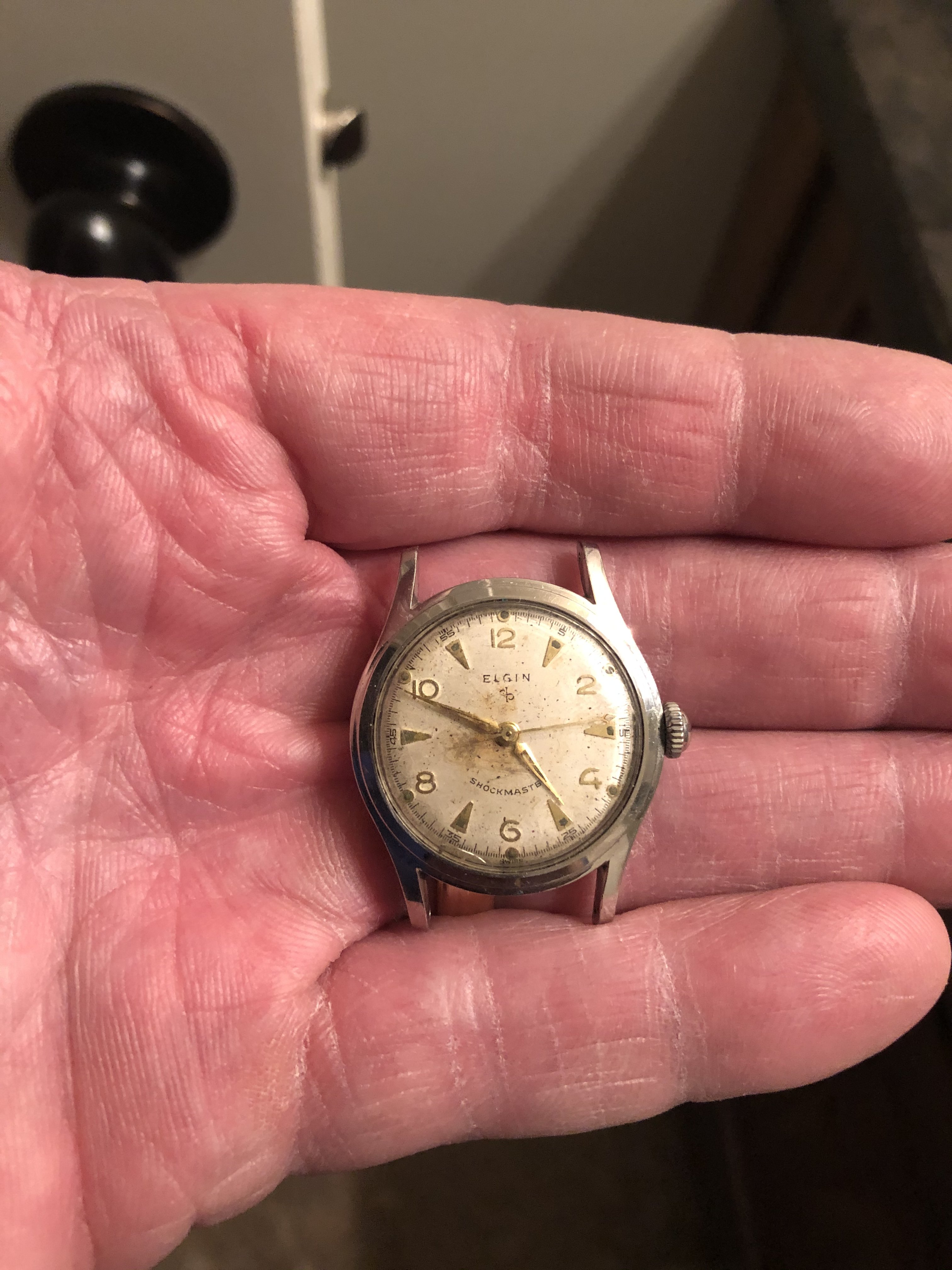

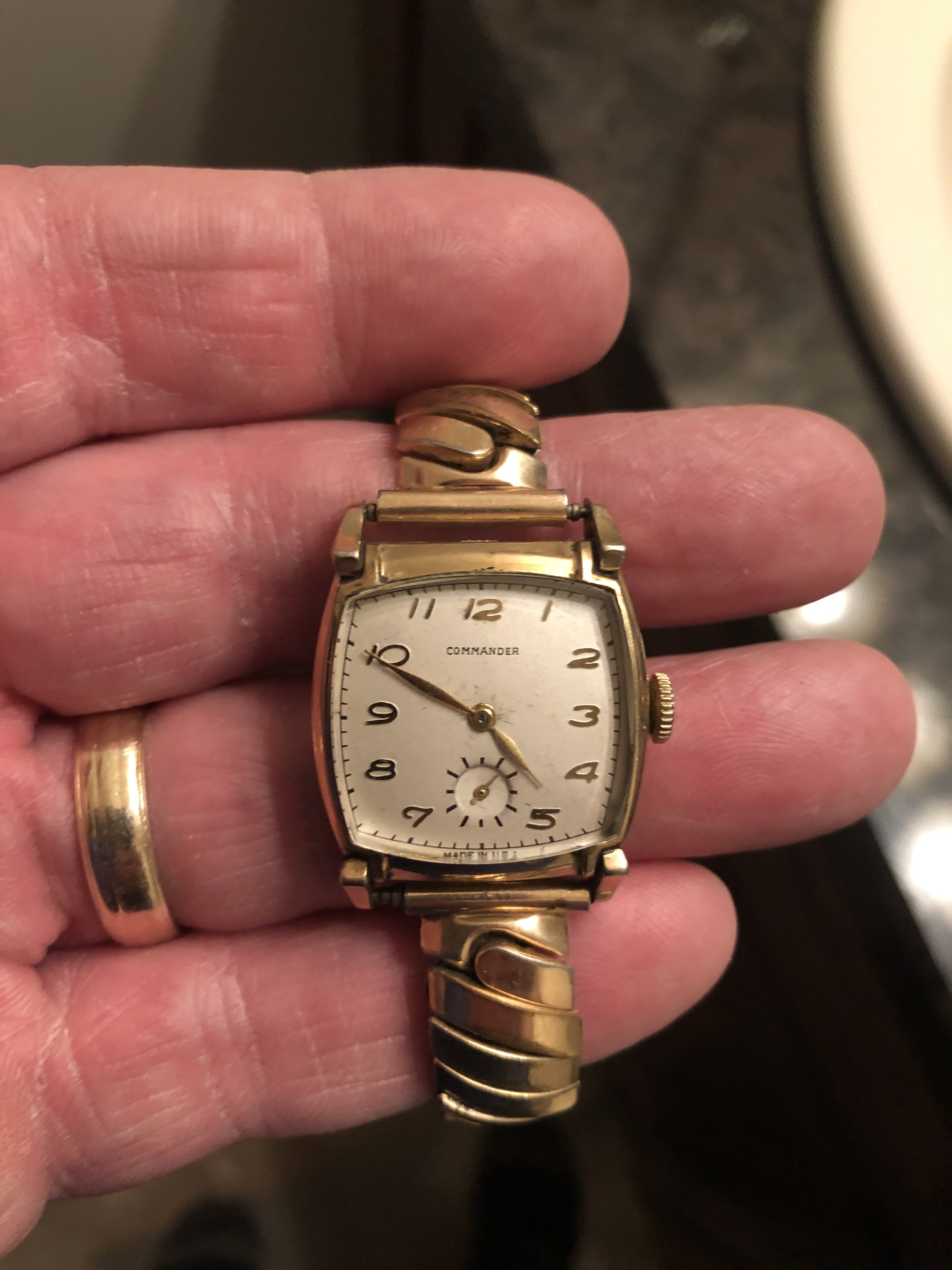

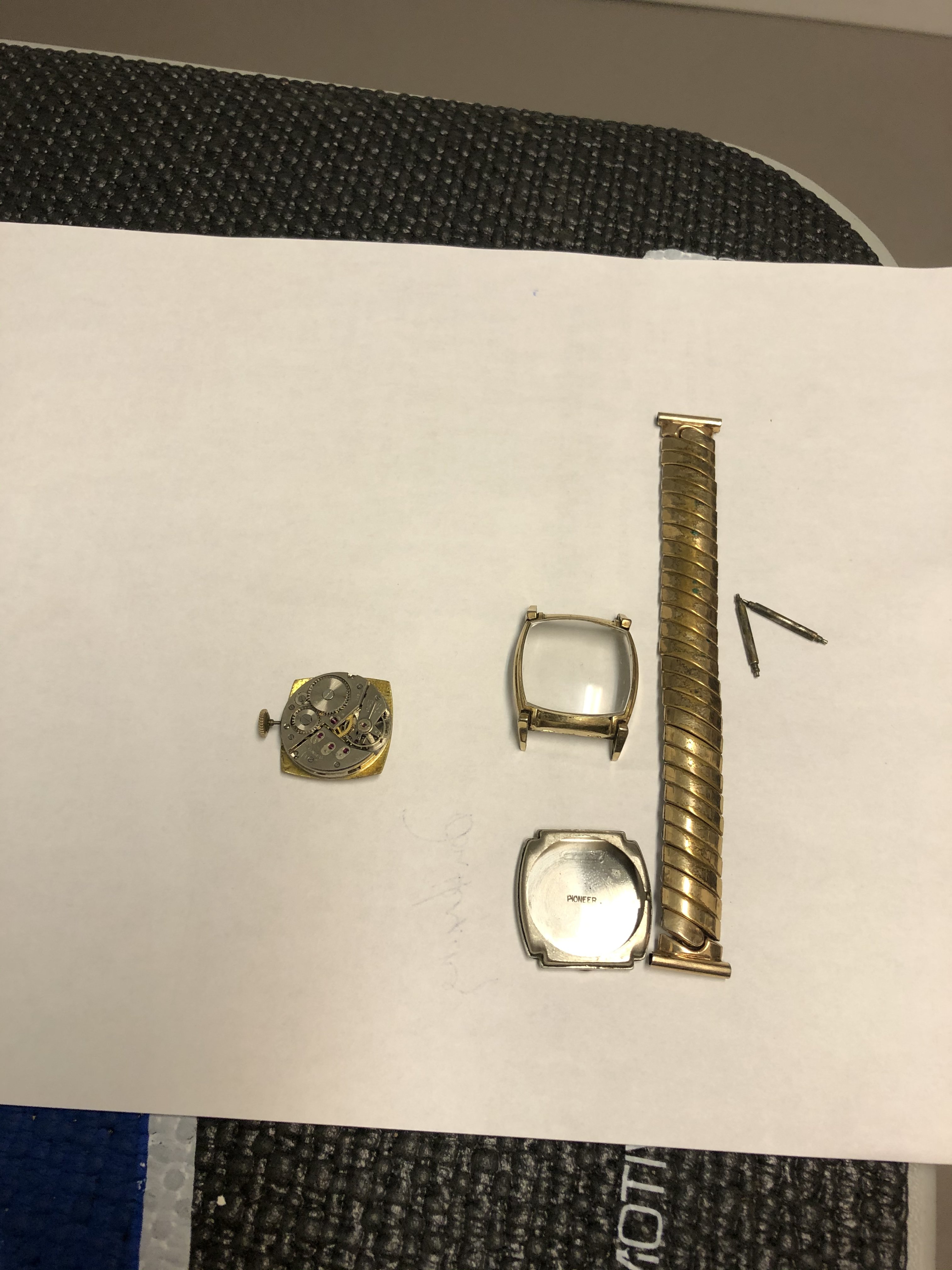

Ok. I actually got the backs off of both of them as well as a Caravelle that was in the box that has no crystal but actually still runs. I’m sure it’s nothing special but I took it apart for the experience. My photos of the Commander movement are terrible. If no one recognizes it from my bad photos, I’ll take it apart again and re-take them. Here are my pictures of them.
Commander:
Elgin:
Caravelle:

The Commander looks like a Gruen based on style. But I don’t recognize the movement as being Gruen. There were 6 other outfits that used the Commander name, so it could be one of those. The case was made by Pioneer which was not the name of a watch company.
The Elgin is definitely Swiss. The movement is a Swiss made Font. Calibre 28, not made by Elgin. A very common movement from the 1950s. See image from the Ranfft archive.
The Caravelle movement is a Japanese copy of the Eta 1080 movement. Bulova used this movement a lot in Caravelle and Arday brand watches. see image from the Ranfft archive.
