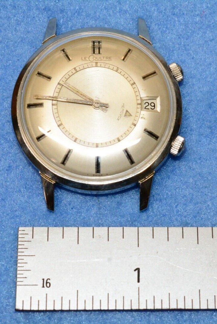

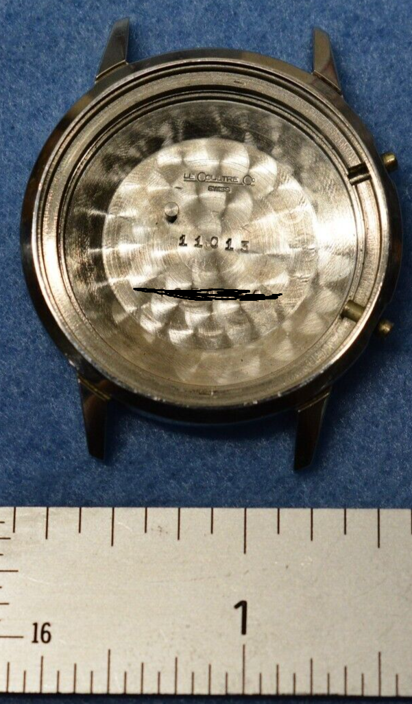

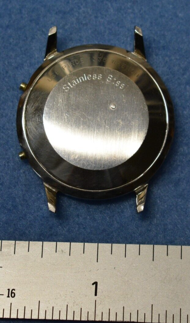

Hey all,

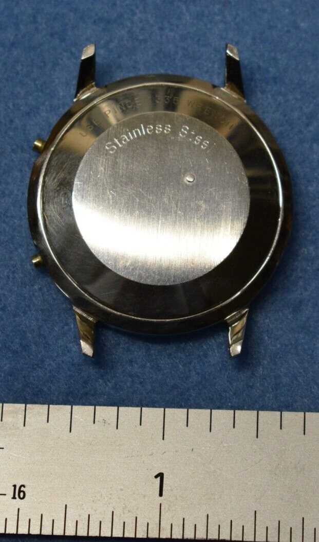

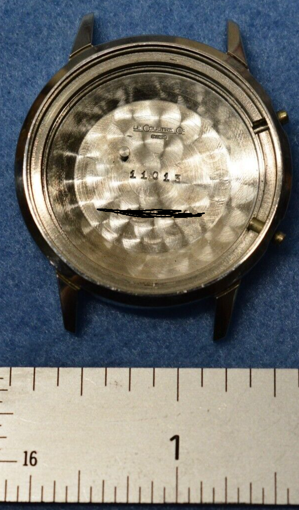

Pretty stoked with this find. Jumbo 37mm front-loading SS (and one of the rarer JLC cased versions, with signed JL crowns, and fancier pearlage on the inside of the caseback than just the standard domestic Star cases bearing the "Cased & Timed in the U.S.A." stamping. The manual K911 movement will need to be serviced (likely some gummed up lever on the date changer that stops the movement during the date changes), along with a seconds hand needing to be sourced. But, for $150.00, I'm not complaining. I've a jumbo K825 bumper automatic with a very similar case design (but instead is gold filled).
What do you all think?

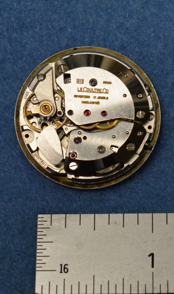

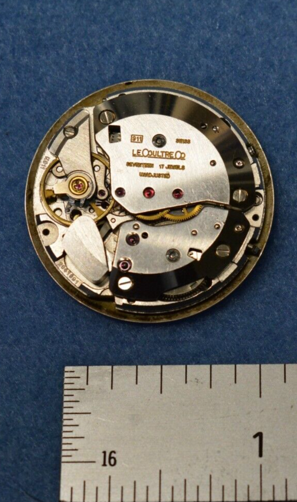

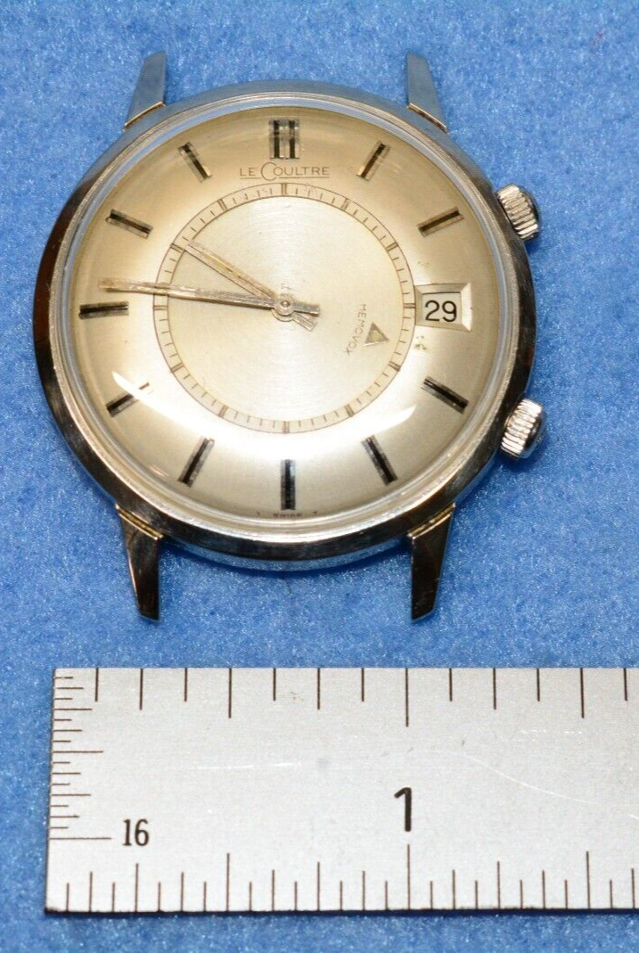

So, a bit of an update:
Got the watch a few days ago (didn't have time to write this up). All looks pretty good. However, the upper crown freewheels in the setting position for the alarm disk (seems like it's not engaging at all with the alarm works) and the hand setting position for the lower crown slips in either direction, which to me sounds like a potentially stripped gear in the setting works. I'm thinking the watch originally jammed up when it got close to the date change, and someone tried to brute force the hands and did some damage to it (but this does not explain why the upper crown does not set the alarm disk). The hour and minute hand are misaligned - probably the hour hand was completely jammed up by the date change mechanism.
