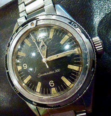

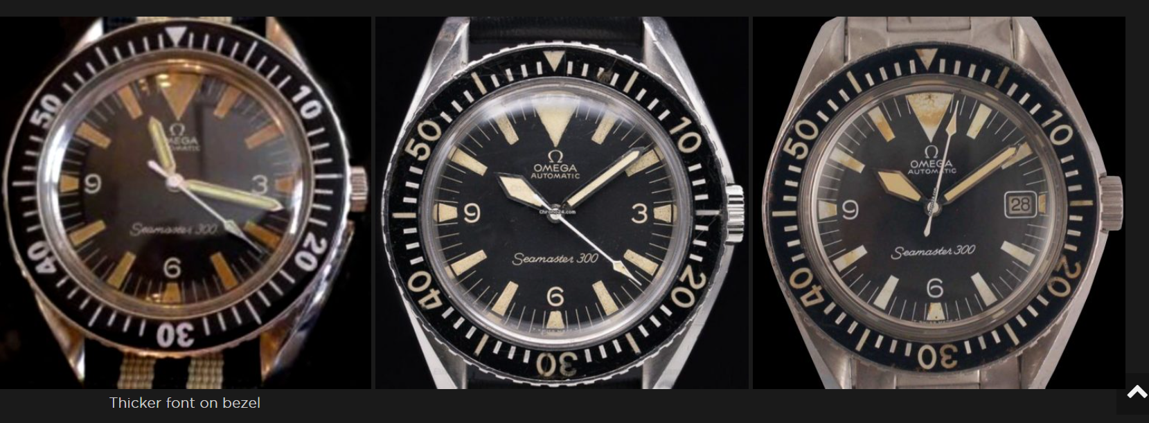

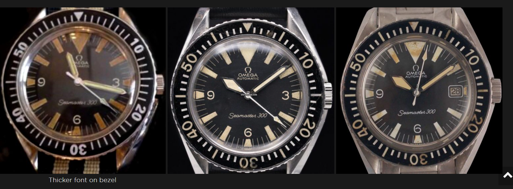

And what makes you think yours is original ?
The Omega Seamaster 300 collector's guide has a big triangle/baton hands in its image gallery. I don't believe it's particularly common but I see them occasionally. Some made it into the British Military this way, I believe. Amsterdam Vintage Watches sold a '69 with a date window and baton hands (no proof if originality, I know), but I can't say a date window and Baton hands is something I've seen often, not that I've looked...
@Fallout Boy help me out, I forgot, what's the significance of the circle in your 12'oclock marker? 😉

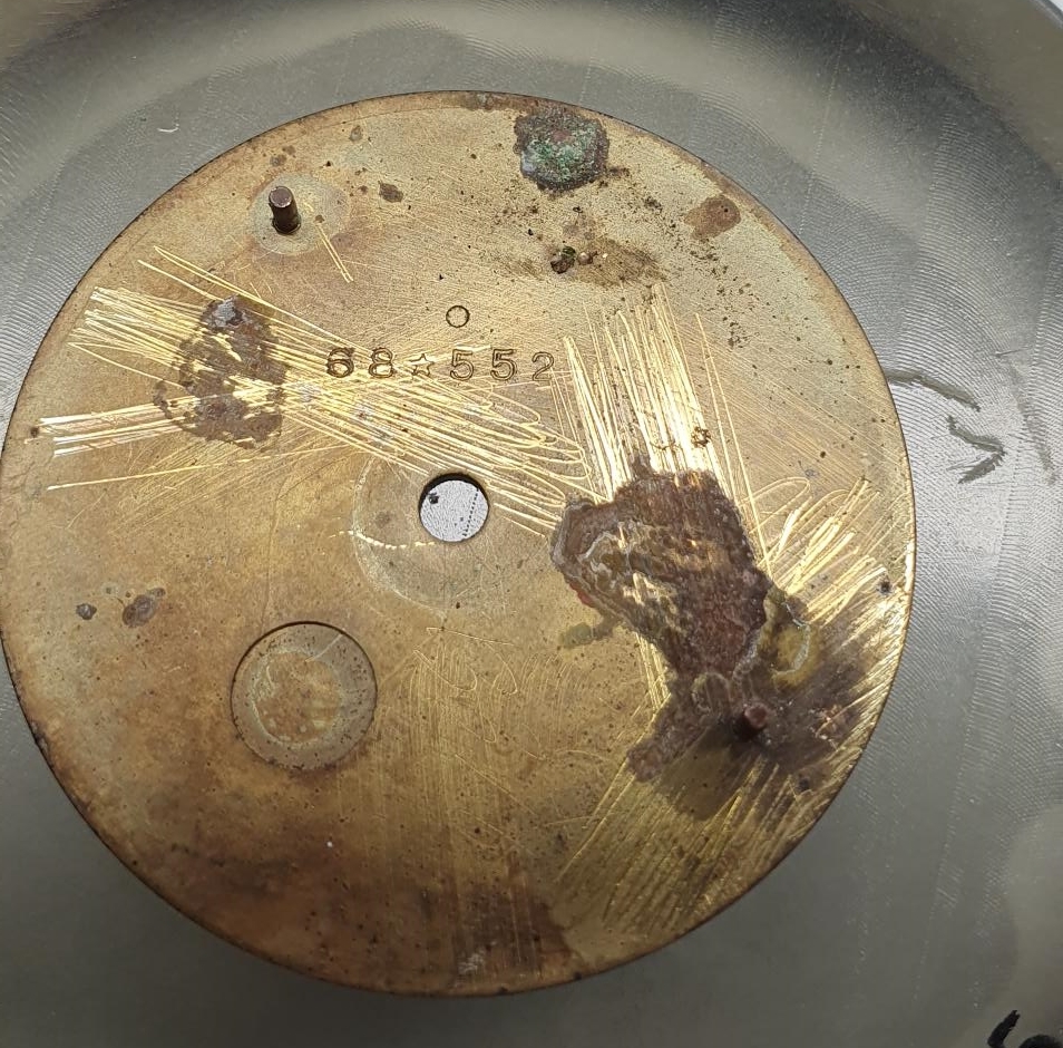

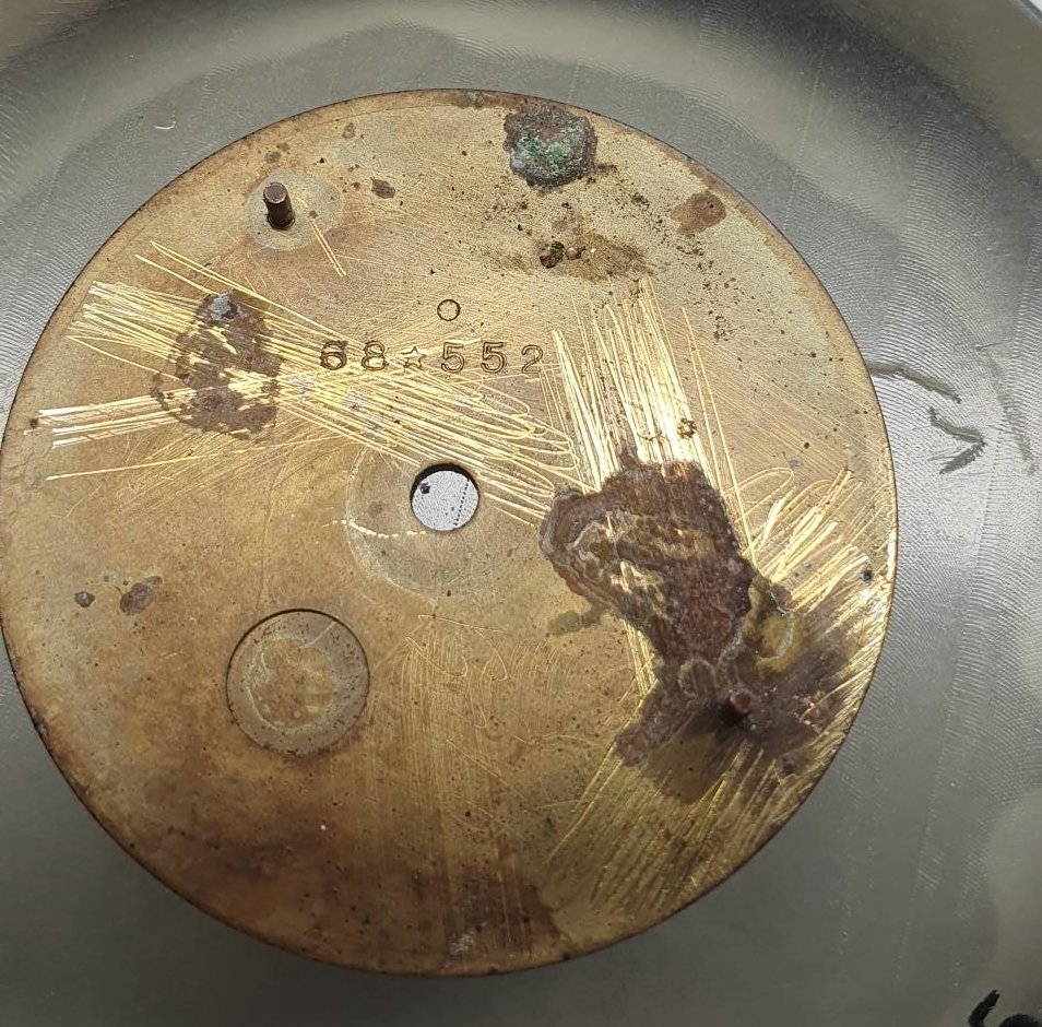

voilà the back-side of the dial:
and @Seaborg I don t need to show my photo-collection of similar variants I ve seen the past years on www.
As mentioned above, I agree with Jose aka perezcope ´s "proof" of "overall patina".

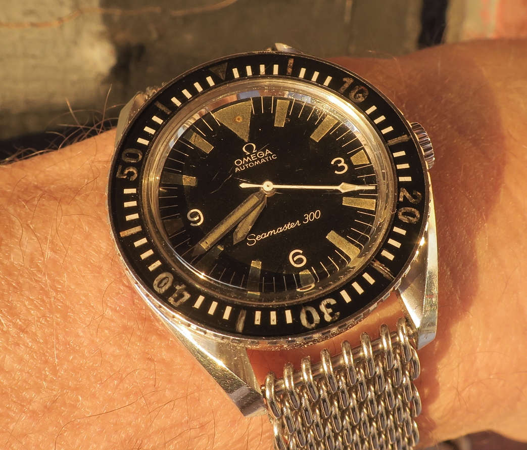

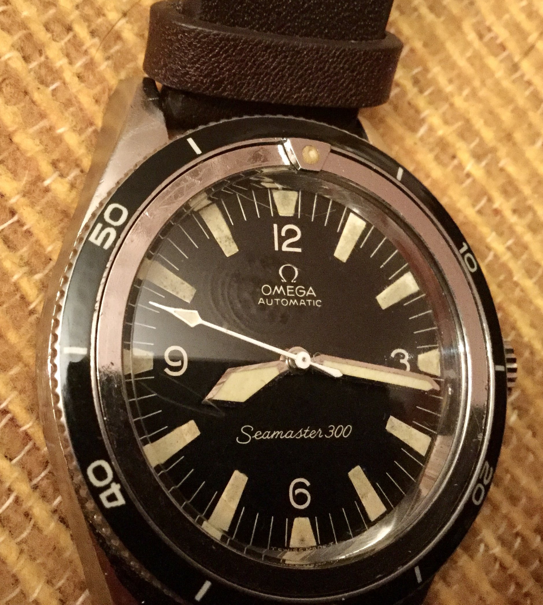

I wouldnt do anything with the lume, except have it stabilized, but that’s just me
Why not?
Please share your extensive knowledge about these watches. I suggest you to post your photo collection gathered from the Internet so that people can judge by themselves.
The overall patina can indeed be a good hint, but may equally be tricky.

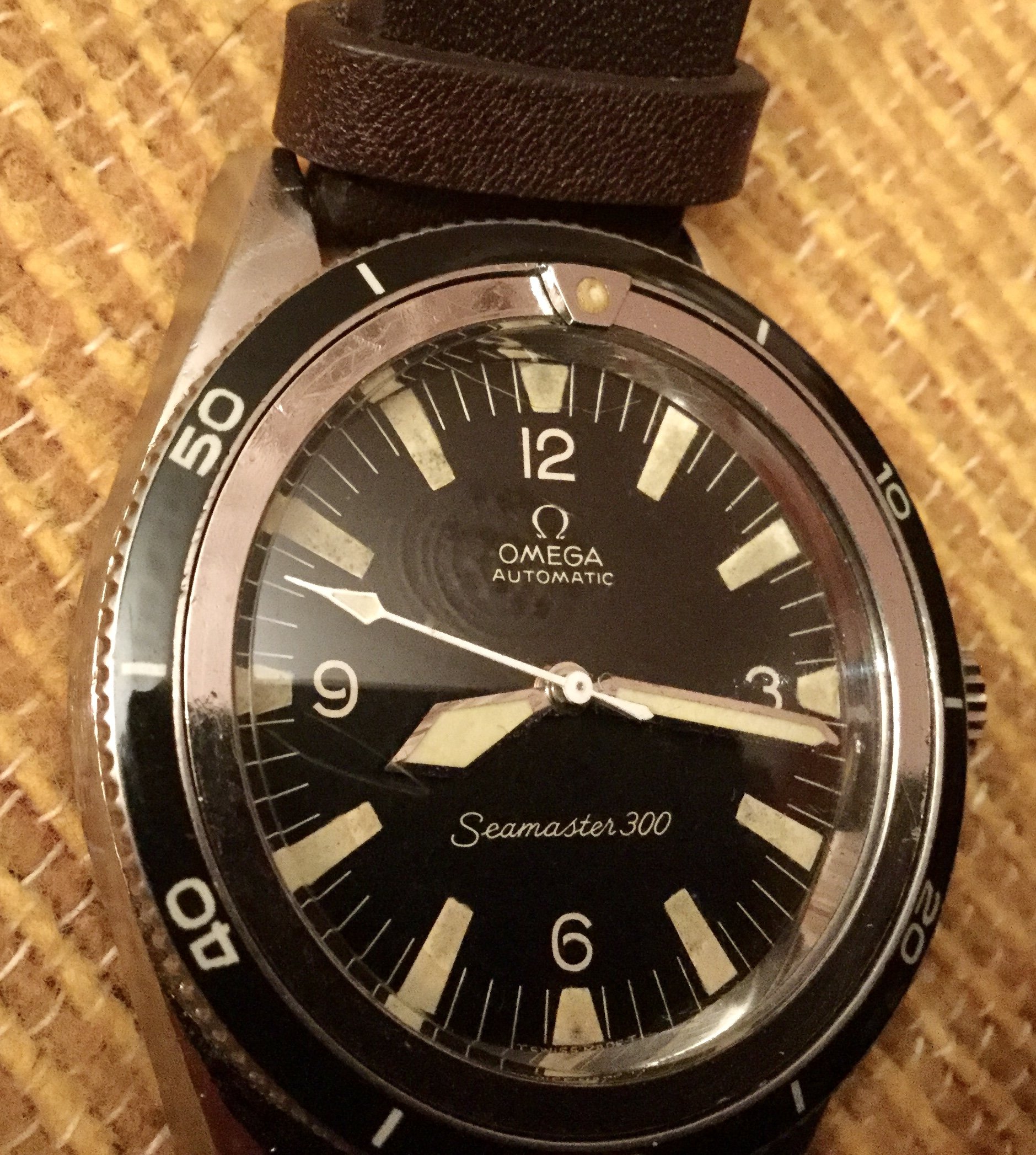

It’s subjective but id say the lume has just reached the point where I’d consider a good relume to improve the overall look.

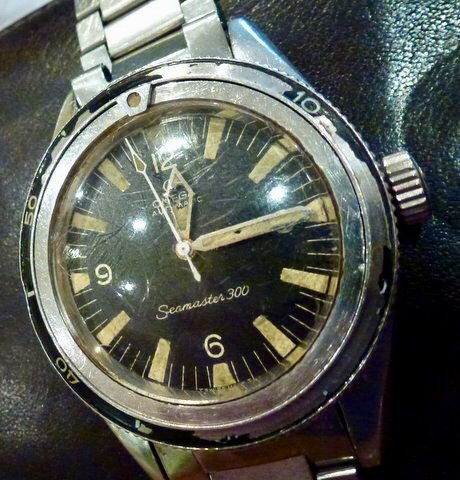

Here’s a before and after of a different reference but with similar lume condition
I generally don't like reluming.. but this one looks nice.
Personally I would probably get a crystal, service and relume too.

It’s a polarizing topic and there are some that are firmly in the keep it original camp. I have a narrow window for “patina” verse damage. When it’s a matter of moisture ingress (which is what dark moldy lume results from) that’s damage to me. Neither is wrong or right, it’s your watch.
As a random thought, is there a treatment that reverses the blackness of the mould in the lume? Carefully applied H2O2 or something like that?
Not that I’ve ever seen or read about. Any application of chemicals can have an effect on the lacquers used on the dial surface so that needs to be considered. Just like when working with art conservation- some materials respond well to one chemical but not to another and the different media can be next to or on top of each other so a knowledgeable professional is better than trial and error when it comes to rare irreplaceable objects.
There are a few people in the world who do this professionally (one in Italy and one in the UK as far as I’ve seen) but they aren’t watchmakers- reluming is an art in itself and is not usually in a watchmakers skill set. They can also color match or give it an aged look so it doesn’t look brand spankin’ new on a well worn watch- you let them know your desired outcome. It’s not very expensive in the grand scheme either considering the value of a watch like this. And as you saw above the difference it makes in the pleasure of ownership is huge.

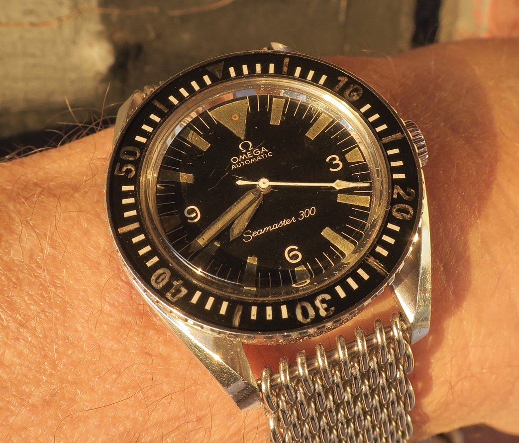

Would go for usual service of the movement, new caseback gasket+crystal+SD crown = water tight again.
Keep the original parts.
edit: IMHO the hands are okay. There was a batch of 166.024 for far East, Autralia&Oceania and US with baton hands.
