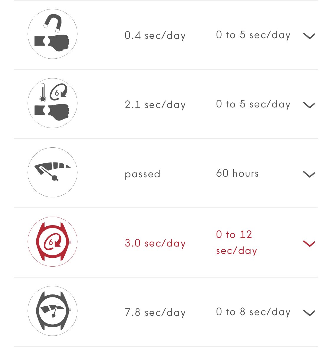

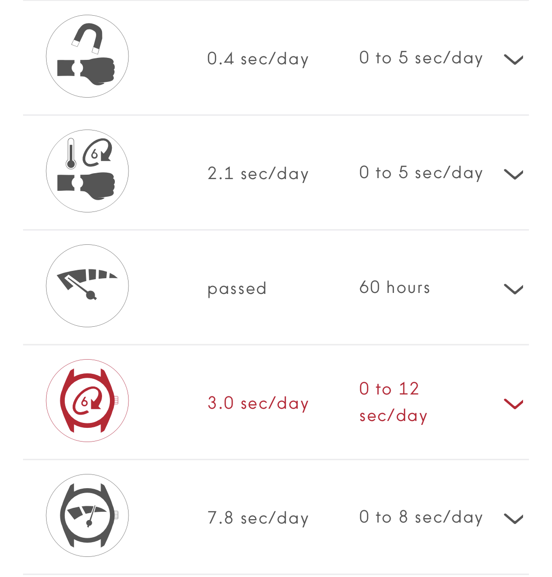

A few months ago I purchased a used 8906 GMT Black and White 215.30.44.22.01.001 cir 2019. I'm happy with the accuracy etc. This is not a post about METAS gripes with the rate being less than 0. I have read many of those posts. My curiosity, which I have yet to assuage despite endless internet searches, is why my watch continues to have a positive rate change while the mainsprings unwind. This inquiry did spring, no pun intended, from the fact I noticed the watch was losing time about 0.5-1s per day over a month. When I started monitoring it on the time grapher I noticed as it sat in a stationary position the rate was increasing over time as the mainsprings unwound. I know very little about watch movements, but from what I do know I thought rate would decrease as mainspring potential energy decreases. Based on reading about how the double barrel setup works, my hypothesis is that because the first barrel acts alone at full wind lower torque is put out thus resulting in a lower rate. As the first barrel's energy equals the second and they work in concert a greater amount of energy is available so the rate increases. Here is my time graph data. I have run this twice with similar results. The watch was worn for a day. Then taken off the wrist and placed dial up. It sat stationary for 53 hours. I then hand wound it and checked the rate again.
Aug 03 4:00 pm -1.4 s/d
7:00 pm -1.0 s/d
Aug 04 9:00 am 0.6 s/d
6:30 pm 1.3 s/d
Aug 05 8:30 am 2.4 s/d
9:00 pm 3.7 s/d
Full manual wind after 9:00 pm rate dropped to -1.1 s/d.
Thoughts? I assume all Omega double barrel coaxial movements exhibit this behavior so it must be a feature of the design.
