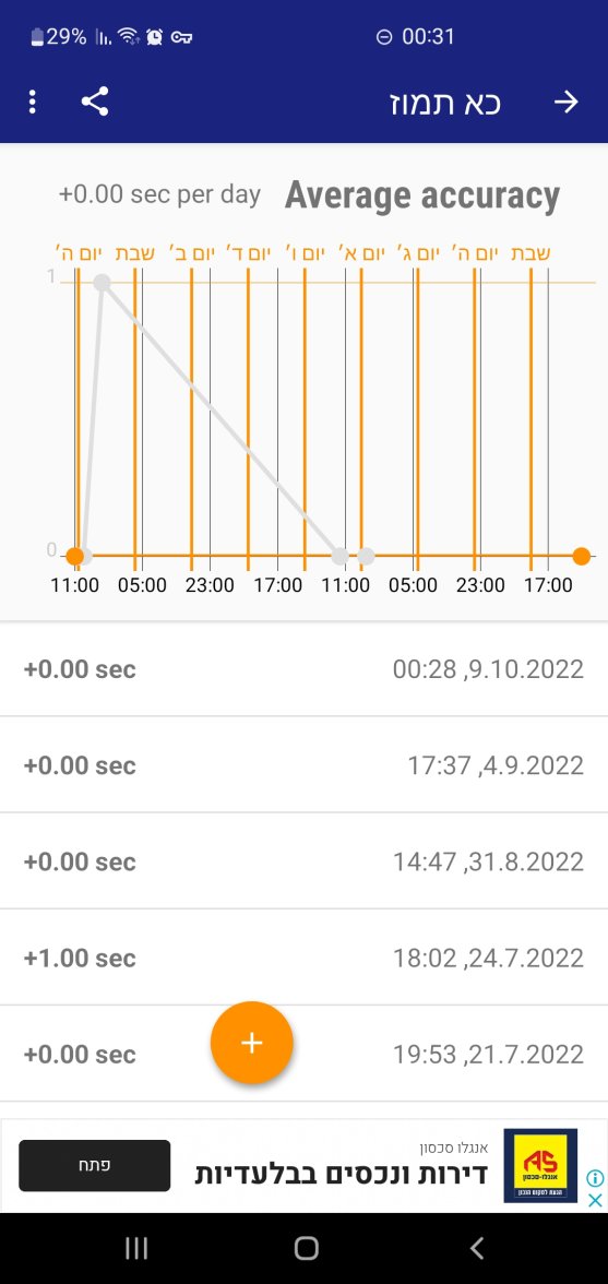

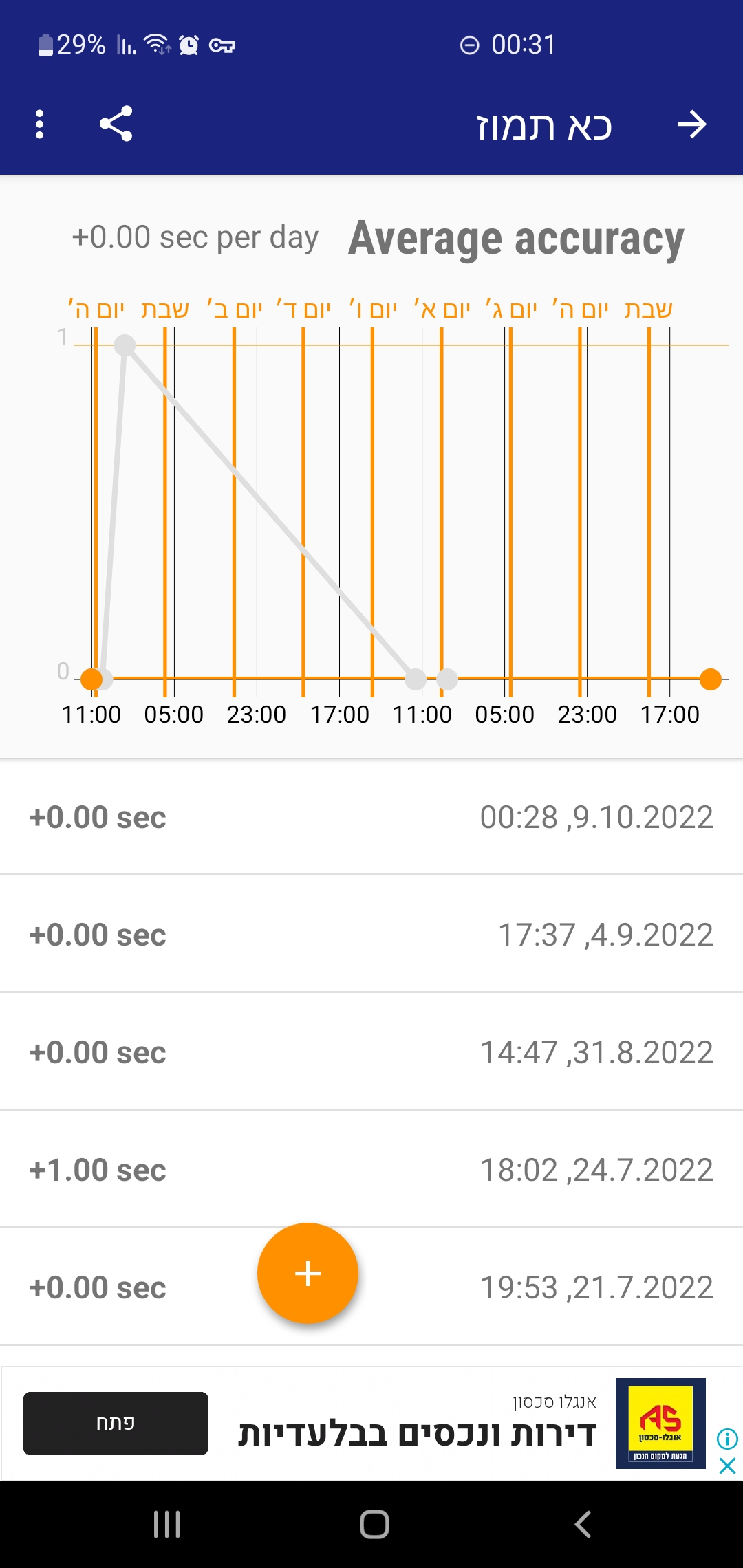

Did you find yours gained with dial down?
Yes. I mentioned that somewhere above, I think. After a date wheel replacement, the watch ran I guess a second slow. Immediately I started to experiment with positioning but I didn't have to continue experimenting: first thing I did was dial down and since then it's behaving like a quartz. Thank God.

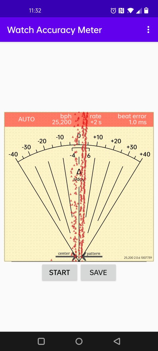

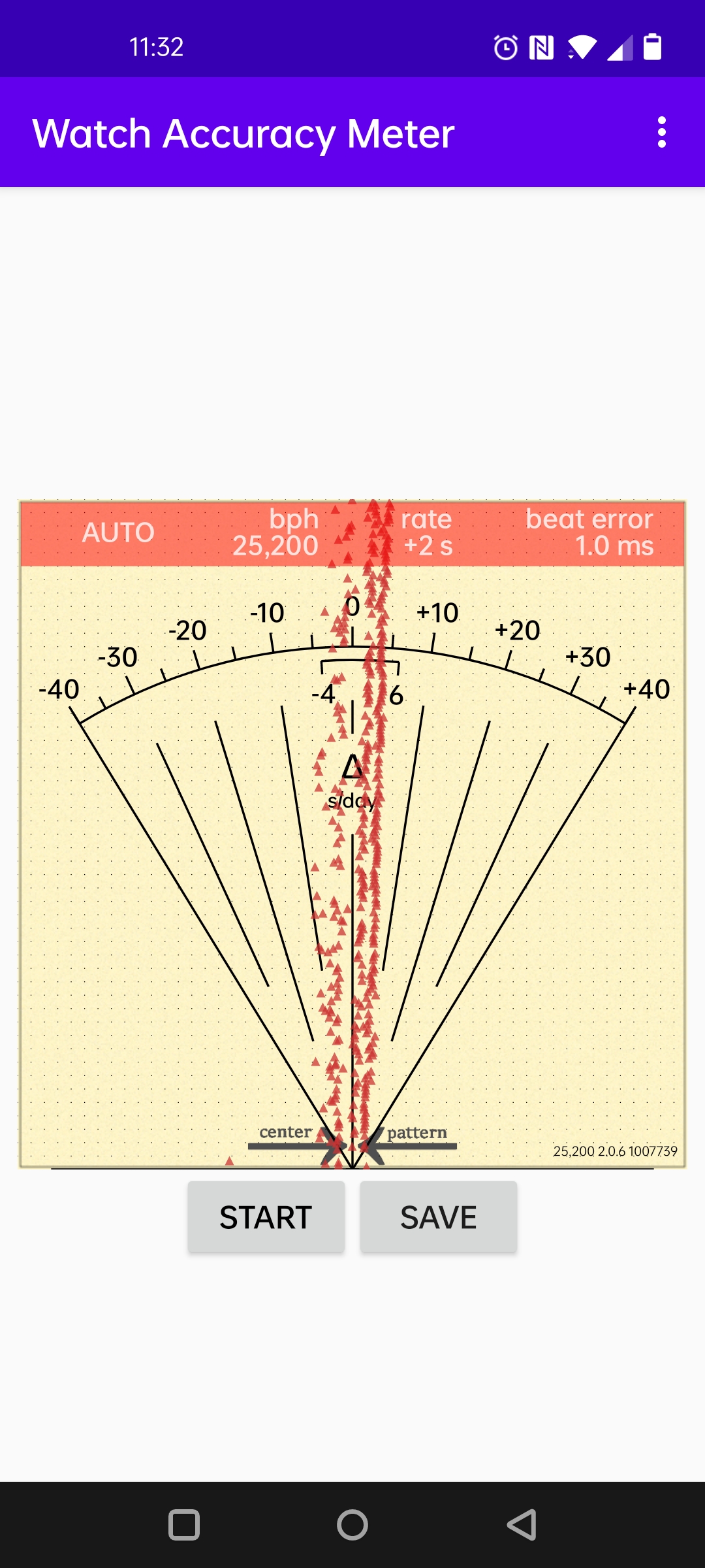

Max beat error allowed (any position) is 0.8 ms. So if this thing is actually reading it correctly, it's out of spec. My guess is that the device is not reading it properly.
Watch Accuracy Meter is a great app and I use it often, but it is known to have issues with co-axial movements. That might be the case with @meglos Seamaster Heritage?
That's what I am thinking too. I was hoping someone would confirm to put my mind at ease. Your post does a little. Can someone who has an 89XX movment download the app and run it to see if their trace looks similar? It would be greatly appreciated.

Five weeks later since starting this post and still on- the-nose accuracy. And I began checking accuracy on July 20 after receiving the watch back from the lab in Petach Tikva, Israel following a date wheel replacement. I haven't touched the crown since, beyond a date change.
I should revise the title to say "quartz-like accuracy" instead of "near quartz-like".
