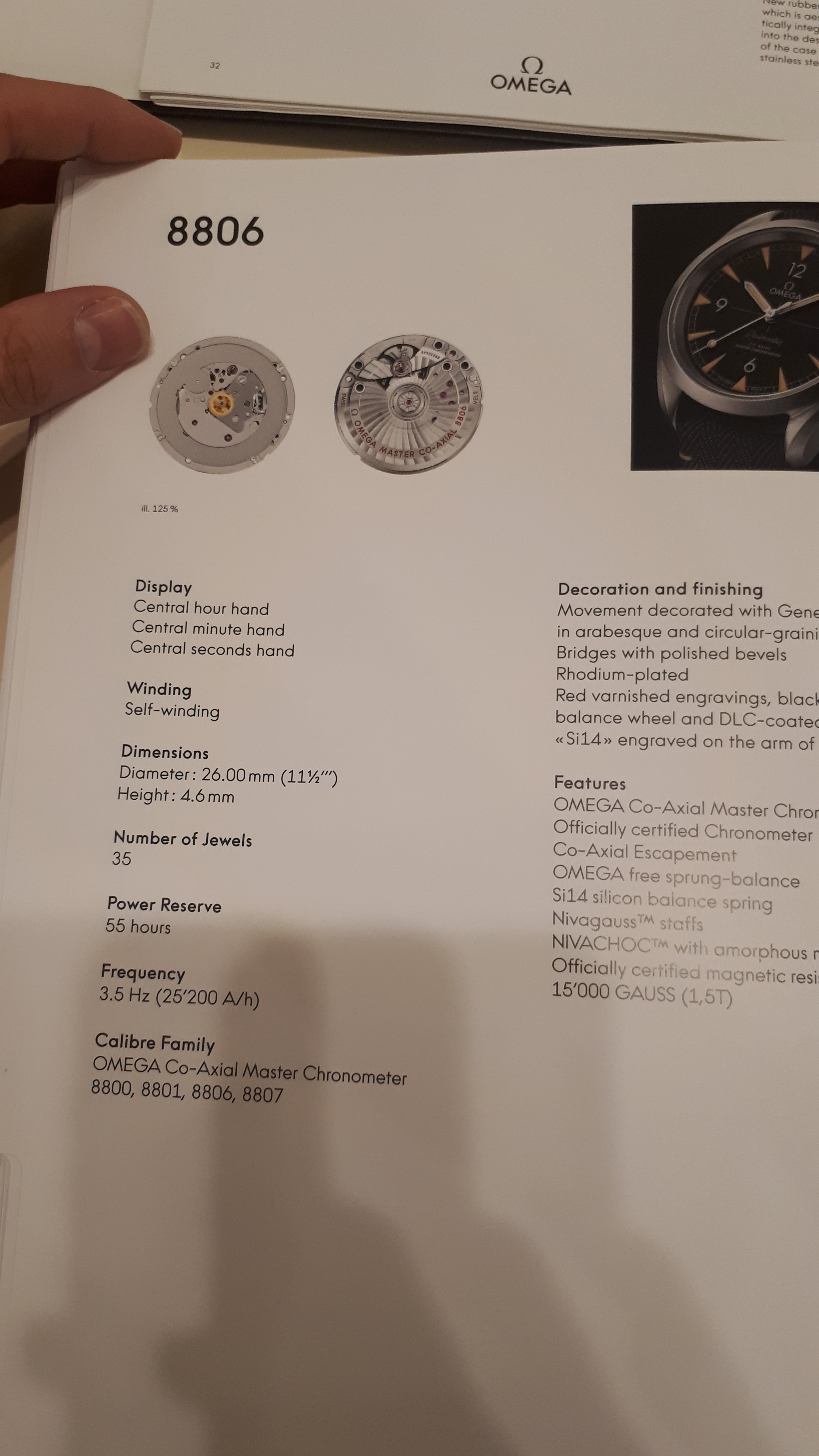

These sites like Watchbase and Ranfft are useful to a degree, but are often full of errors, so take the information posted on them with a large grain of salt.
Omega says the movement is 11.5 lignes, so 26 mm:

I think people need some perspective here. An 11.5 ligne (26 mm) movement is not considered "small" in the watch world by any means.
I've never heard anyone refer to a Speedmaster movement (861, 1861) as being "small" yet it is a 12 ligne movement, and at 27mm is only 1 mm larger in diameter than the 8800.
Is there as disparity between case and movement size? Yes of course and it's very common, which is why movement spacers (what Omega calls and enlargement ring) are also very common.

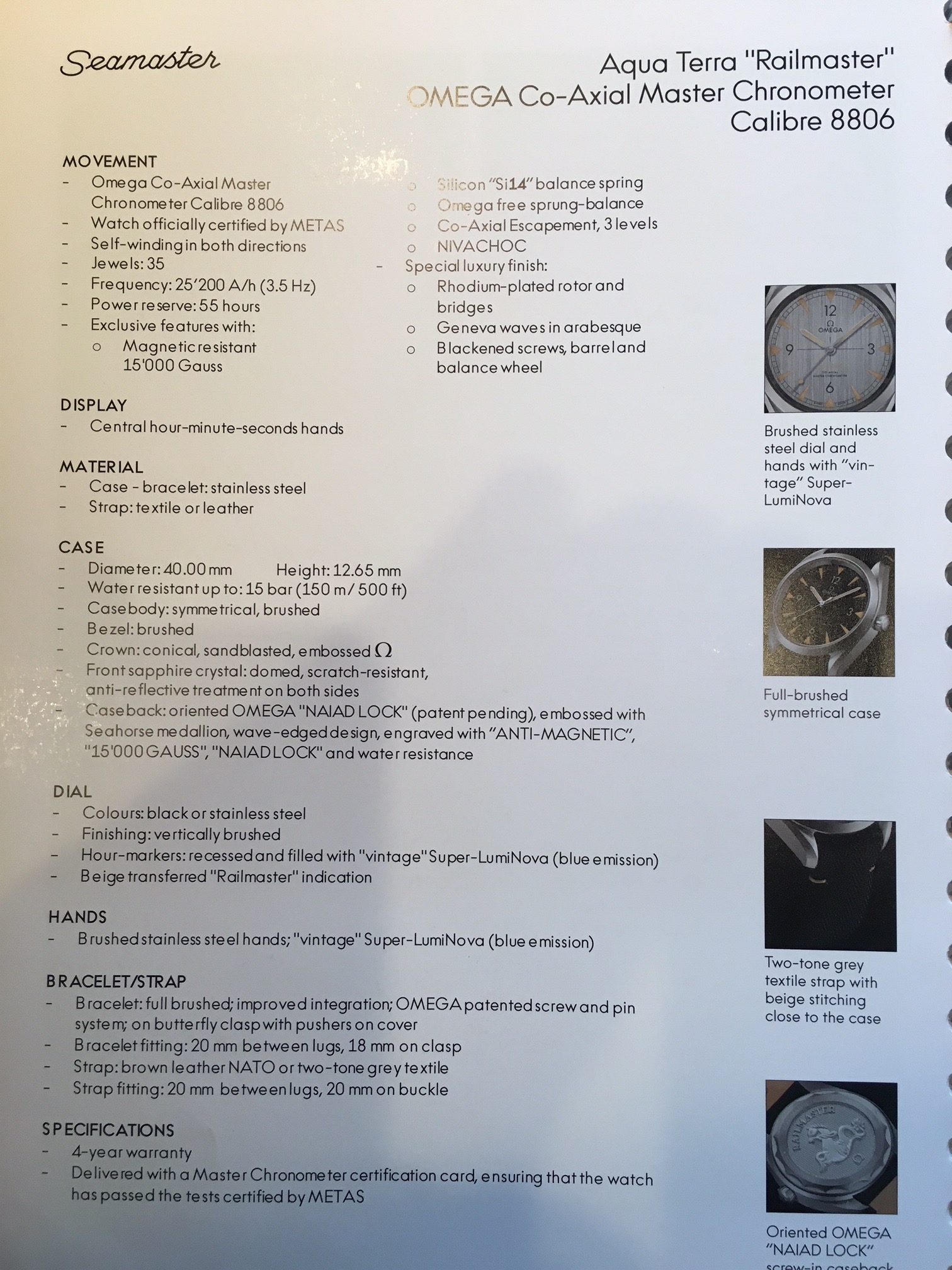

Might be useful
This is great. Is there a PDF available for this or is it copied from a dealer-only book or something?
430
398
Yes it's from a book that OB salesmen are using.
Thought it might be. Is that the large hardcover one, about 1.5 inches thick?
430
398
I took this pic more than a year ago so can't recall but they have several books
