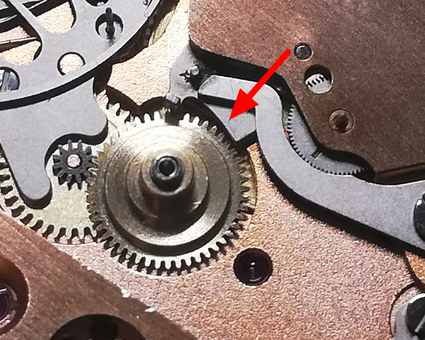

Hallo,
i have a question on lifting the hour wheel of the cannon pinion.

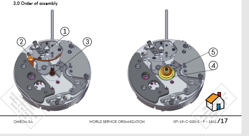

According to the service manual, setting of the cannon pinion and the hour wheel are the last steps of the assembly.
However when i try to lift the hour wheel, i cant get passed the hour hammer, that somehow sits above the hour wheel.
Do i understand it correctly, it is not necessary to disassemble the hour recorder-bridge in order to take the hour wheel out?
Thank you!

Fully press the reset button to move the hammer onto the hour recording wheel, and you can lift the hour wheel off the CP.
Cheers, Al
