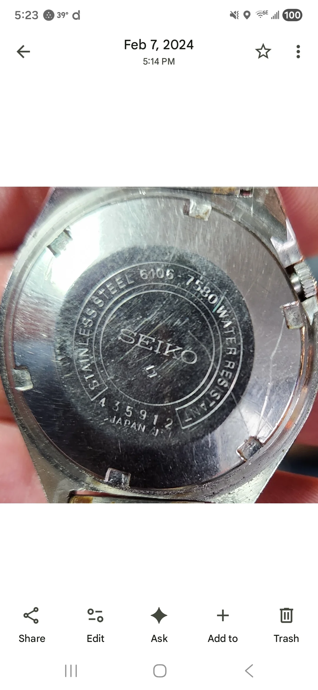

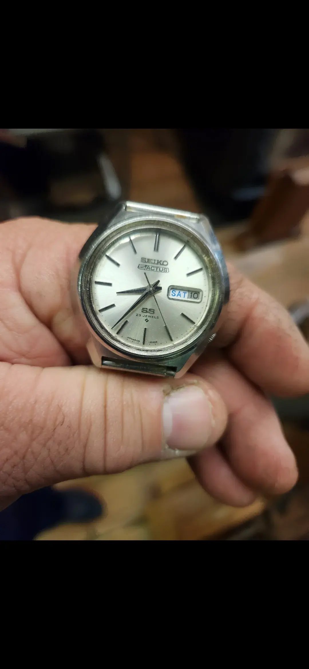

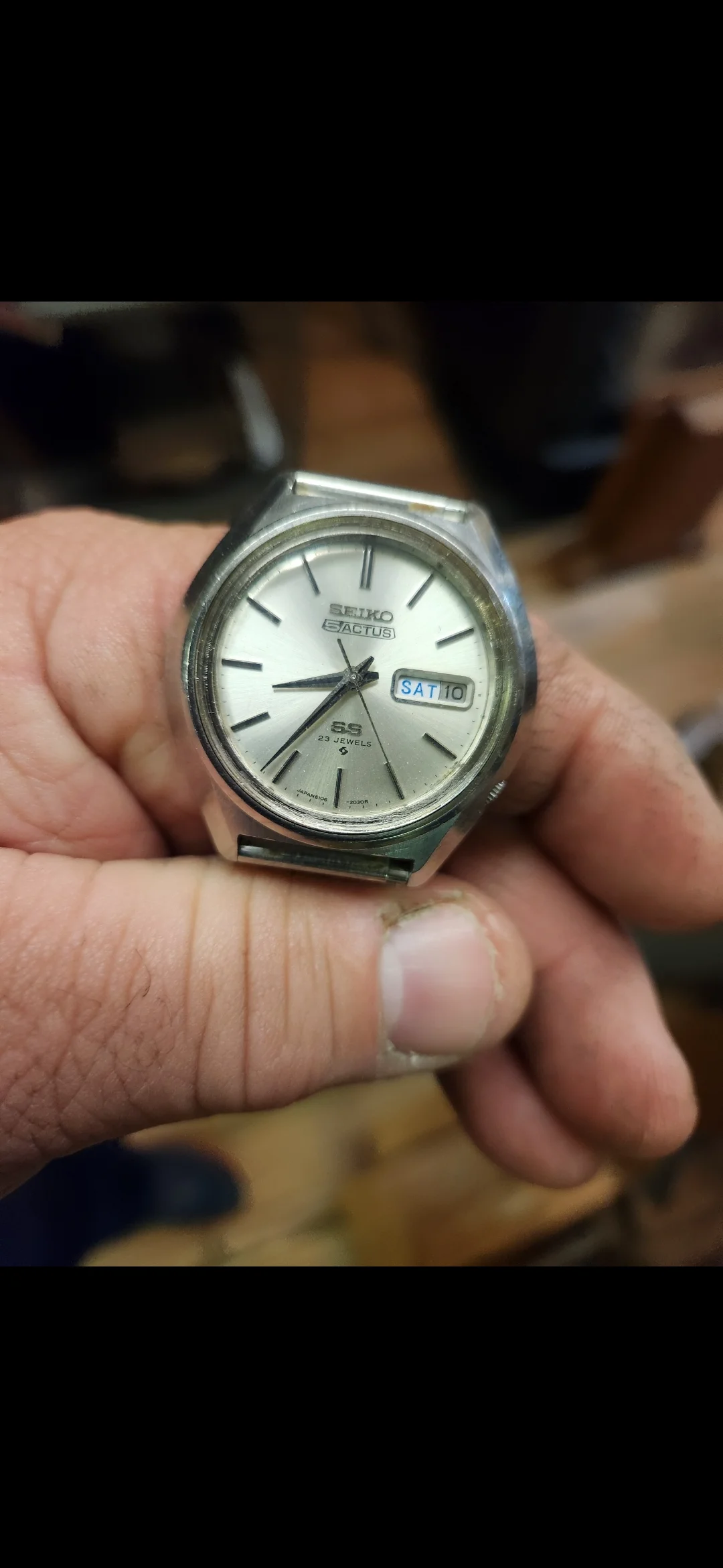

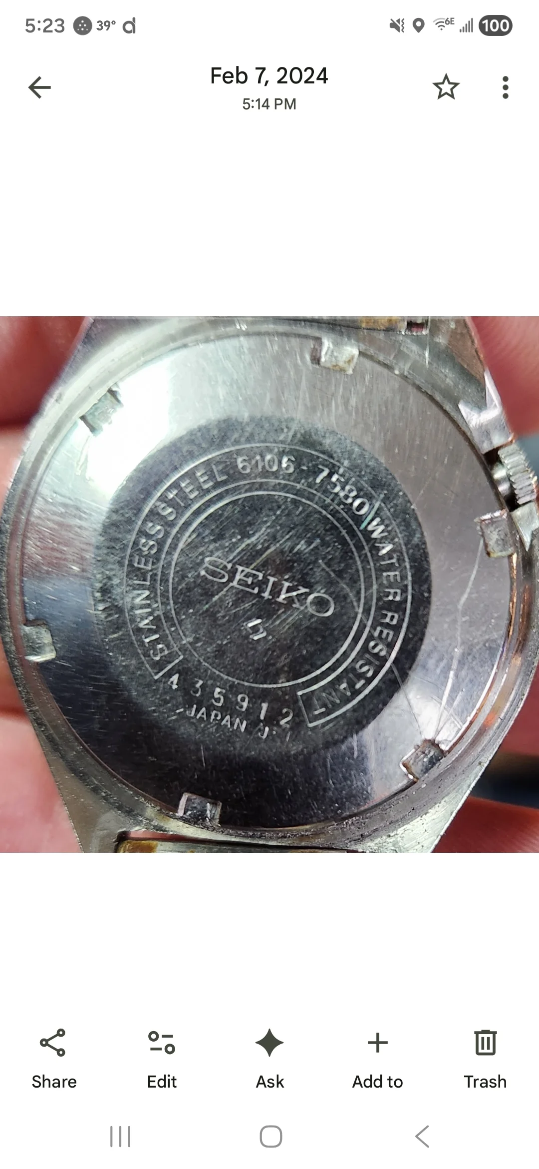

I'm hoping someone here can help me or can point me in the right direction. I am in need of a complete automatic works for a Seiko 6106B movement as the one I had got miss placed somehow. If someone has a complete works or a donor movement that's not running ,but has a good automatic works, and is able to part with it, please let me know. Or, if there is a works from another 61xx series movement that will fit, please let me know.
I haven't been able to find any on eBay, only for a 6119B.
Here is a photo of the dial and case back.
Thank you in advance.

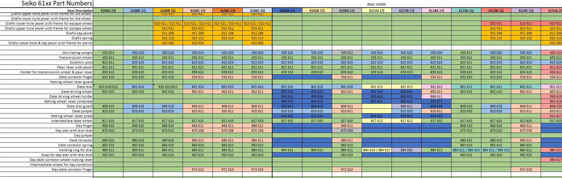

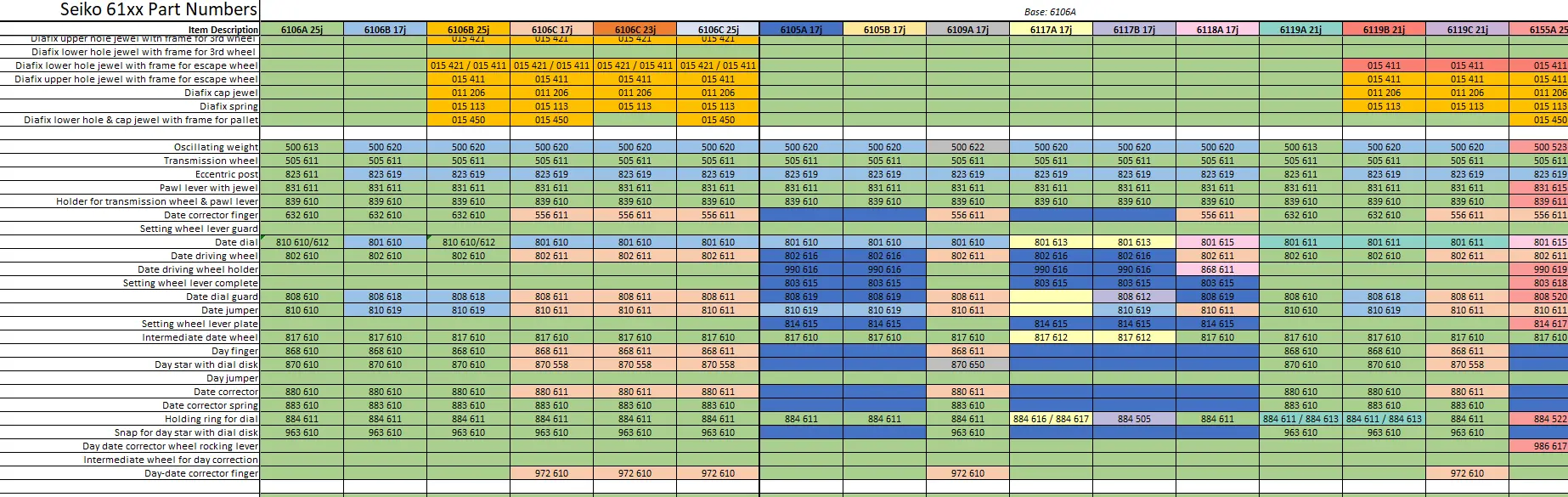

Most of the auto works is shared around many of the Seiko 61xx range, see below a screenshot from my spreadsheet which is fairly self explanatory.
