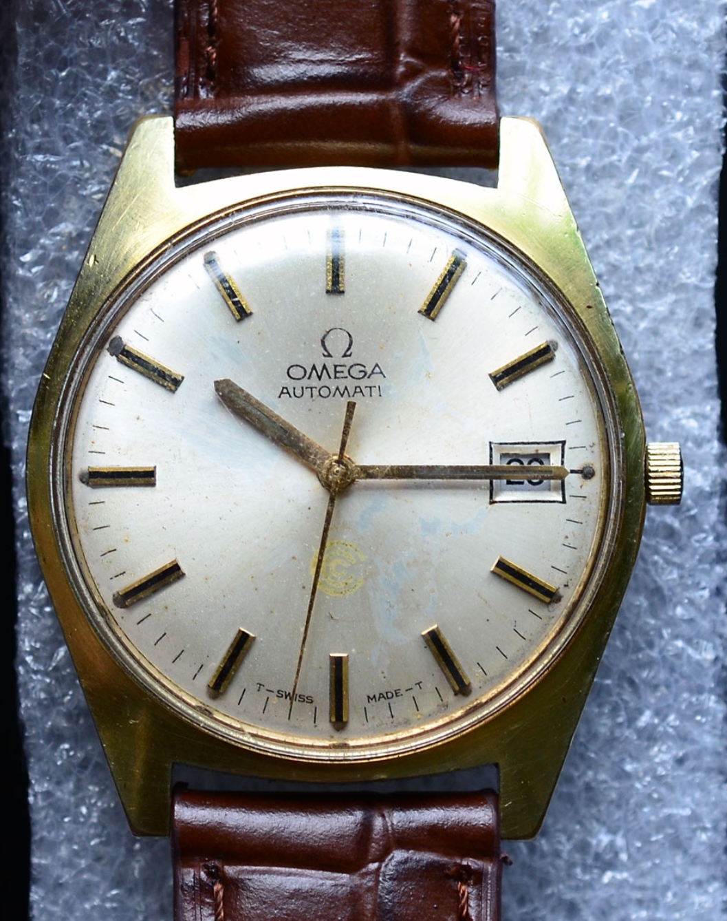

This was my father’s watch which I would like to renovate and use. Could anyone tell me about this particular model, and what would be the best way to bring it back to its former glory. I can remember him buying it, which would have been the very early 70’s. Thanks in advance

It’s a very nice watch, nice shape, good size and very reliable.
Cosmetically, I’d get jewellers cloth (nothing abrasive) and rub the tarnish gold plate gently until it shines.
I can’t see if the crystal is scratched but I’d polish it with Polywatch.

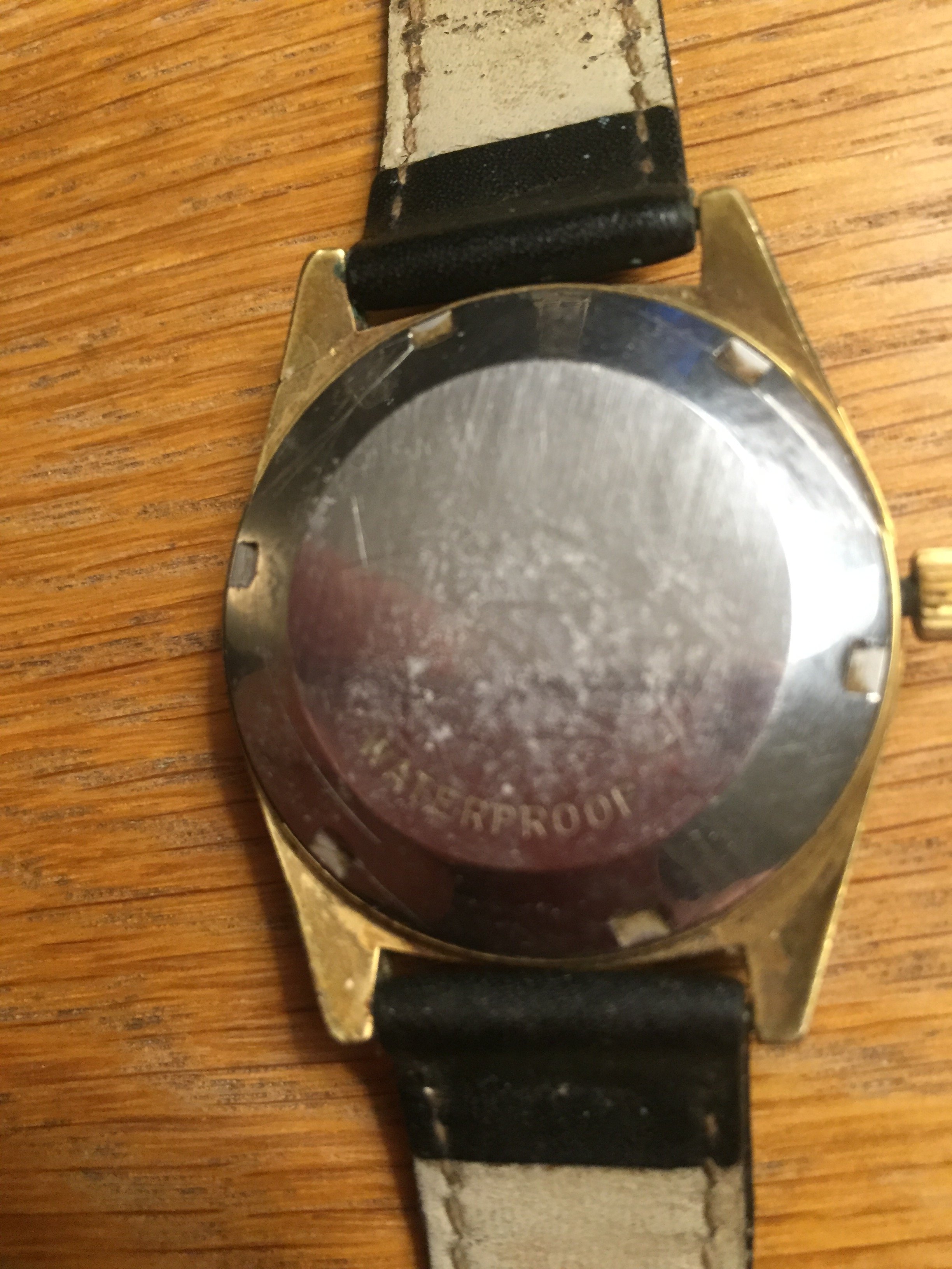

I can’t tell you with the caseback being unscrewed, which movement it is but, assuming it just needs a service, that would cost you in the UK, at a local watch repairer, about £120 plus parts and postage. It’s well worth having it serviced. Omega watches are very and many of us regularly wear 50/60 year old models.
If you’re not sure where to take/send it, post where you are and someone will make a recommendation

Thankyou for the reply. I’m in Norfolk, and the Crystal isn’t scratched, by the way

I know the photos aren’t great but it’s a one owner watch, probably looked after carefully and not likely to need replating. It’s likely that any discolouration is tarnish rather than wear

I also thought I saw plating loss, but obviously the lighting in the photo isn't good enough to tell. That will really be the deciding factor as to whether the watch can be successfully restored.

My guess is ref 166.041 with cal 563 (17 jewels), gold plated case, wrong crown.

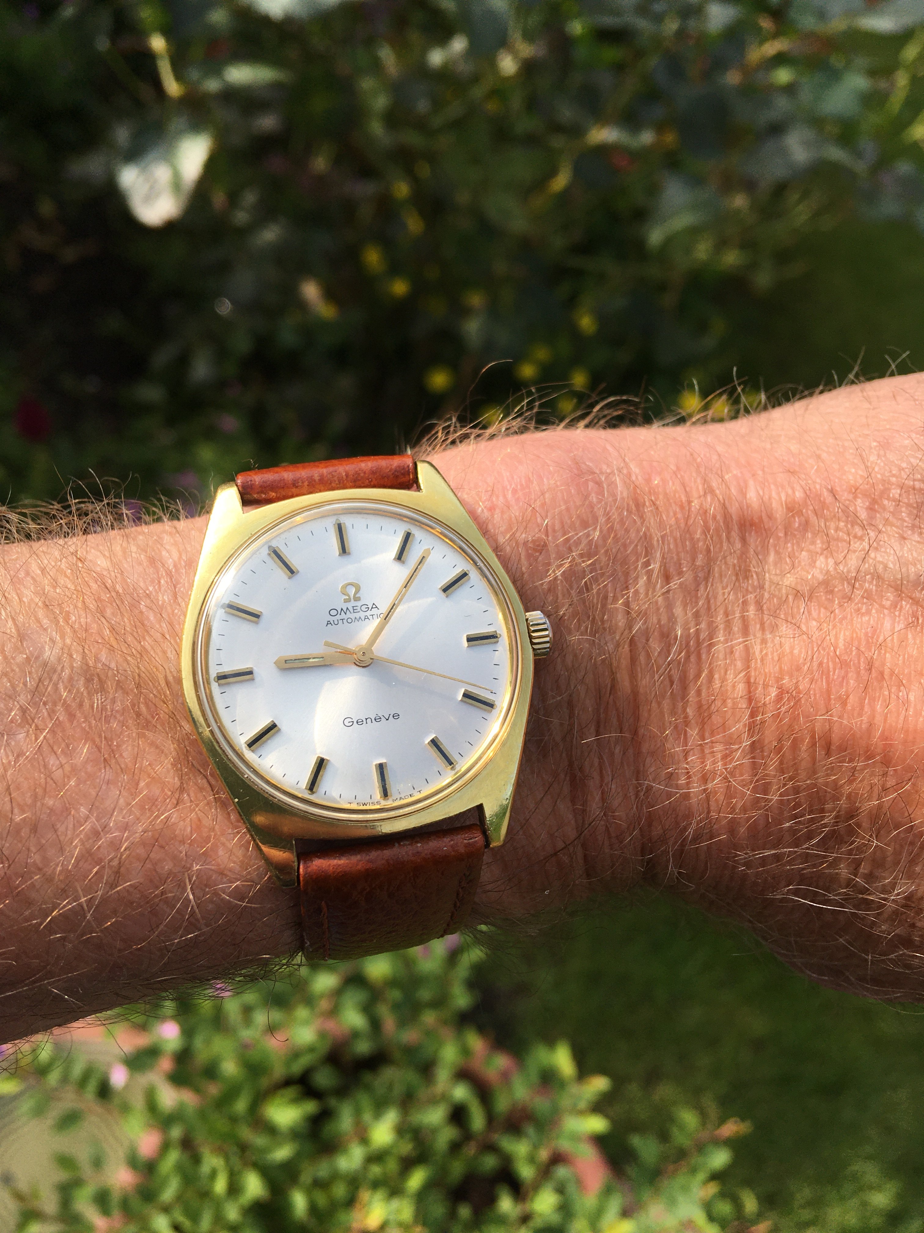

PS: My "ex" photo

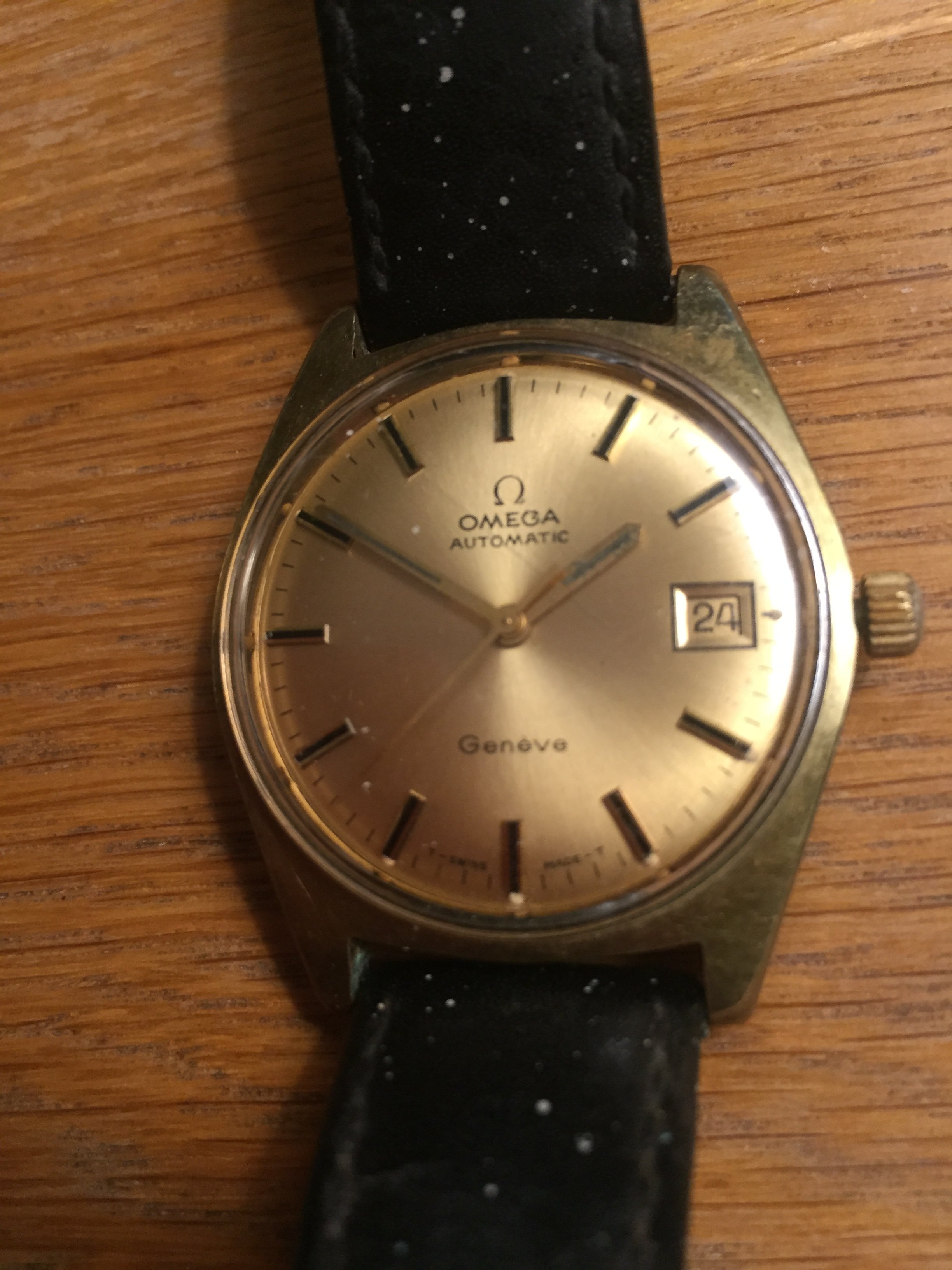

This is my mid 70s with a 552 movement (no date) bought from the son of the original owner.
I can’t now recall if I replaced the crystal but everything else is original (I think).
@Apotts16 I am novice too so take what is said below with a grain of salt ...
@Spruce Nice watch and so is OP's one likewise.
To OP: Apart from sentimental value of your inherited watch I think yours must be much nicer than mine (your under lugs are still sharp). To me your photo of upper lugs don't make justice to them. But then again better pics should help experts here to help you (and I ame surely NOT expert)
... In brief:
- Your watch case might be in acceptable conditions, with sharp edges even on the under lugs. Just clean it with jeweler cloth to bring watch case to former lustre. No polishing absolutely.
- Crown could be a replacement one but that type of crown was still available on Offrei site at least back in 2019. And @Spruce example could be helpful to determine a right one for your watch. Or call Archer the OF expert to obtain correc part number otherwise.
- Very clean and well preserved dial (much better than that of my "ex" 👍... ) with lumes still present and in nicer color.
