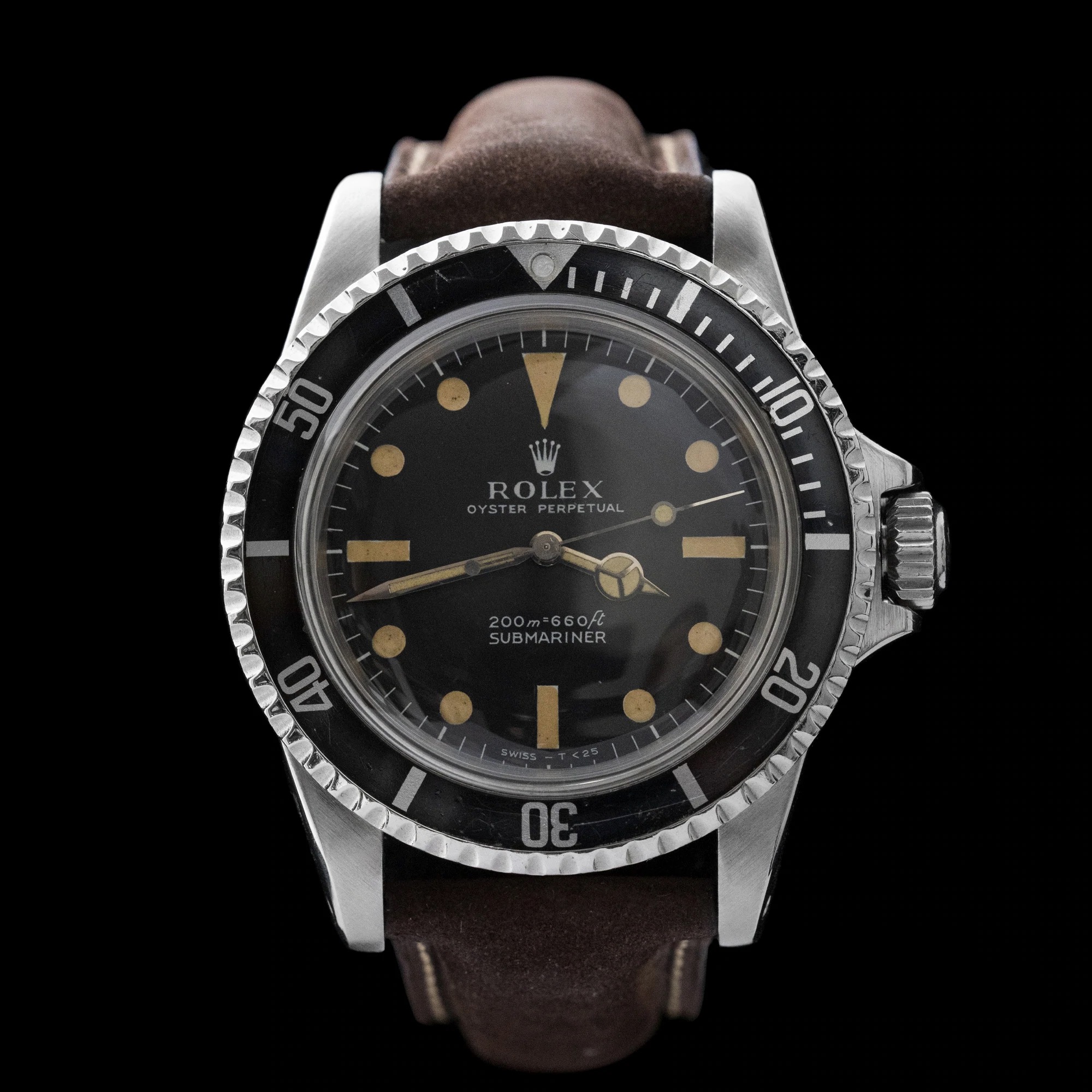

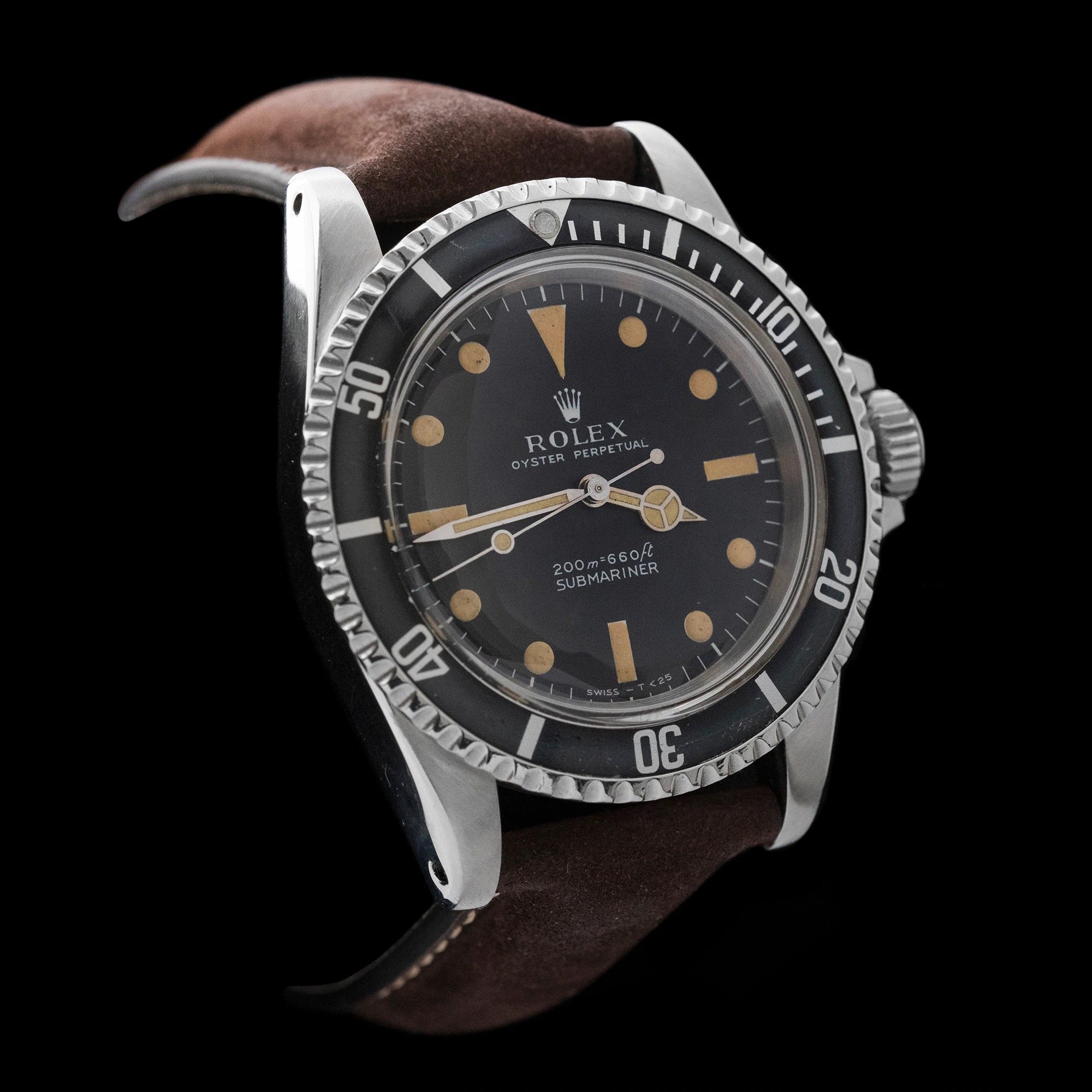

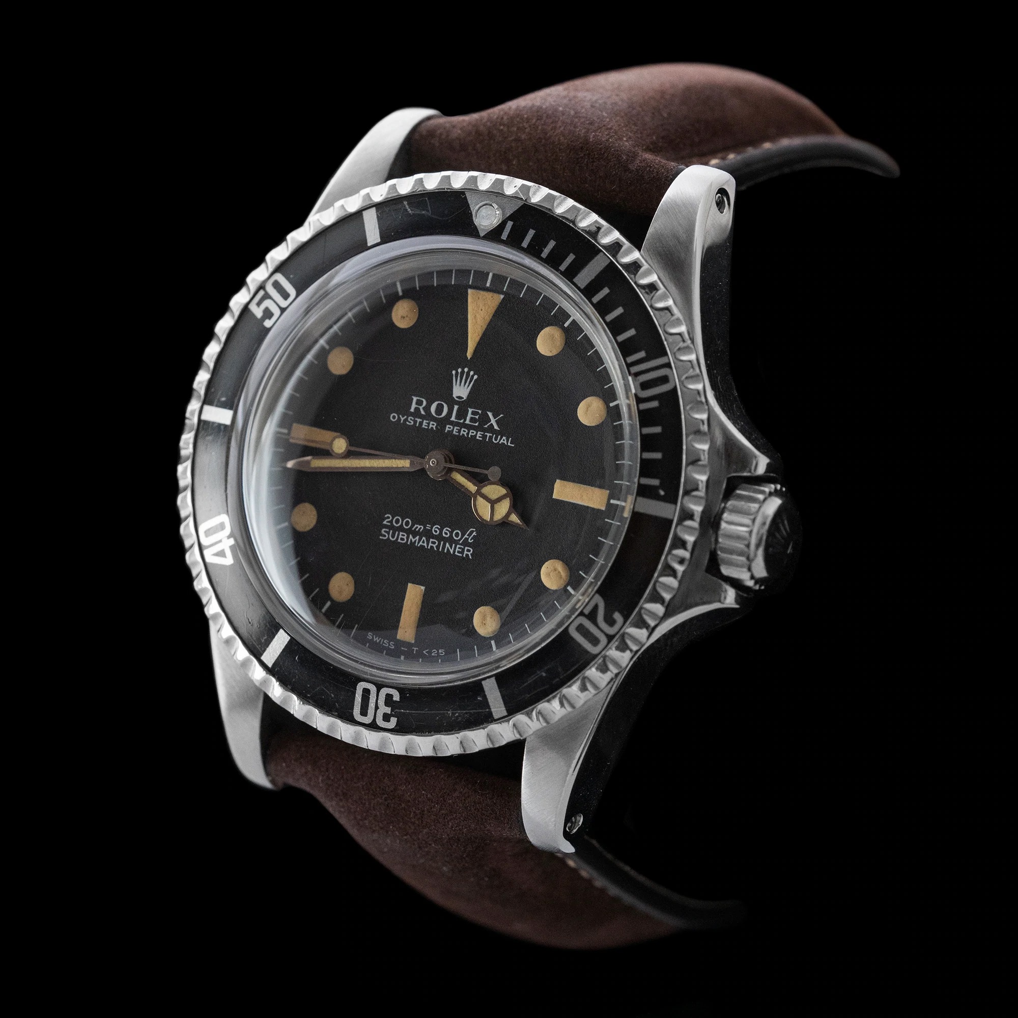

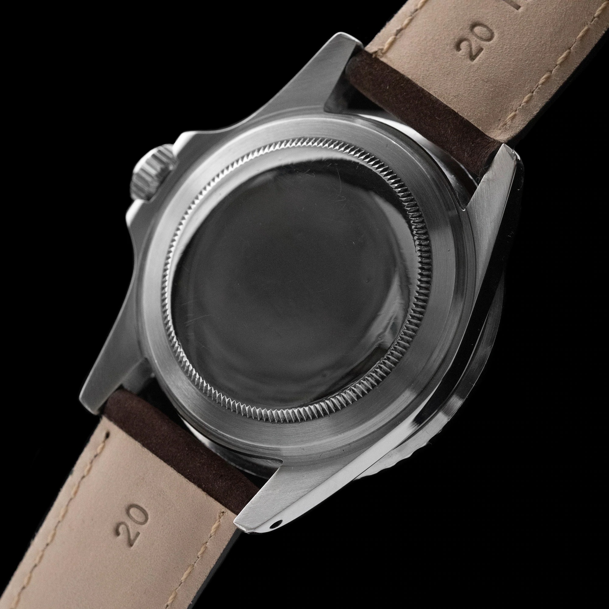

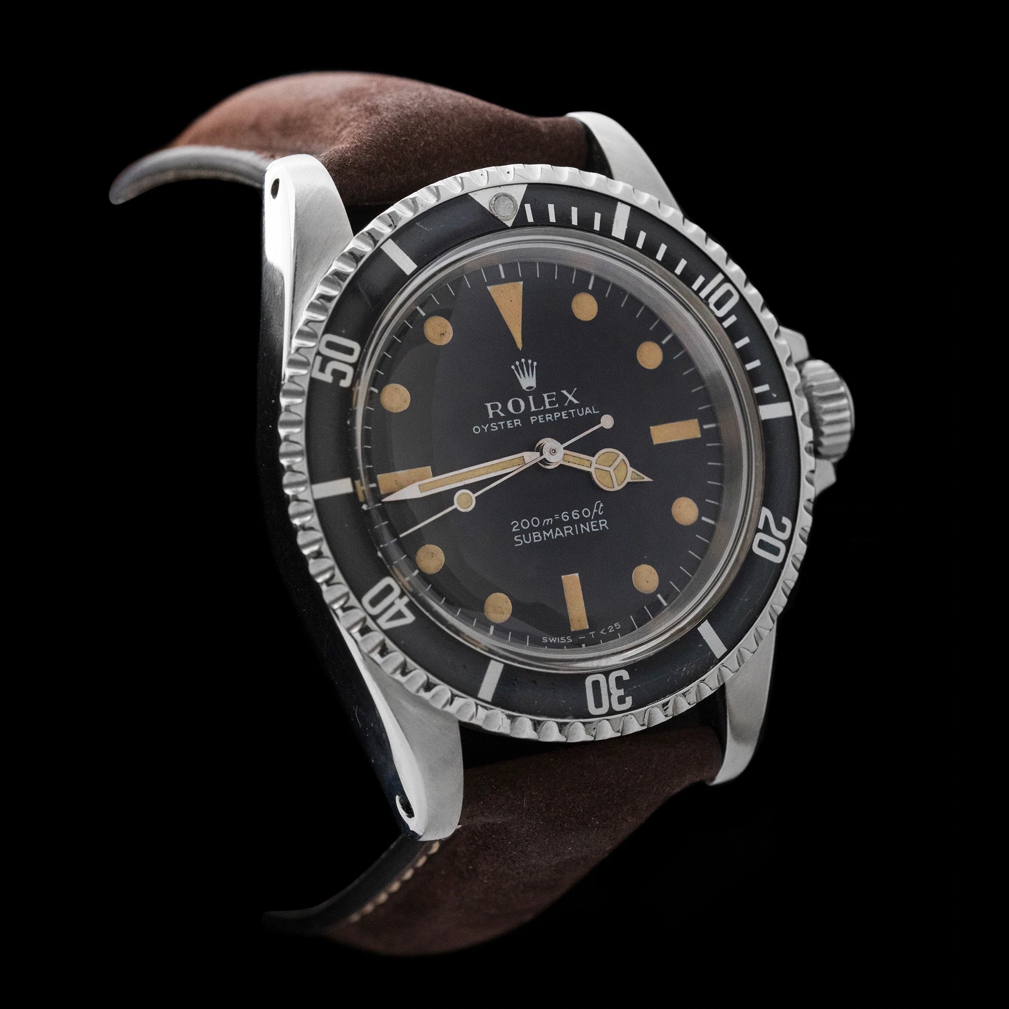

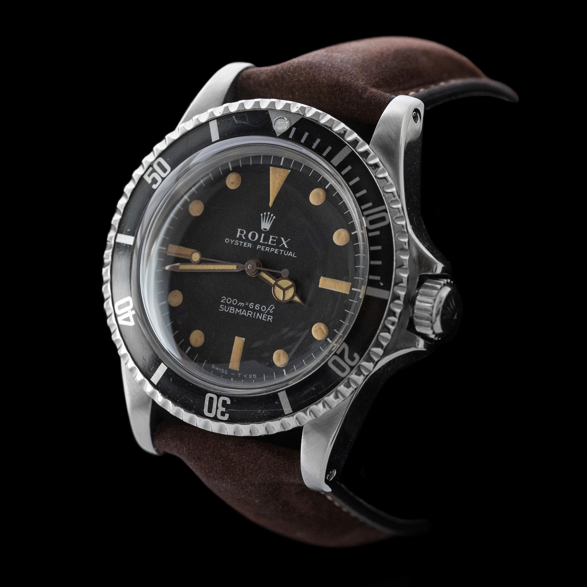

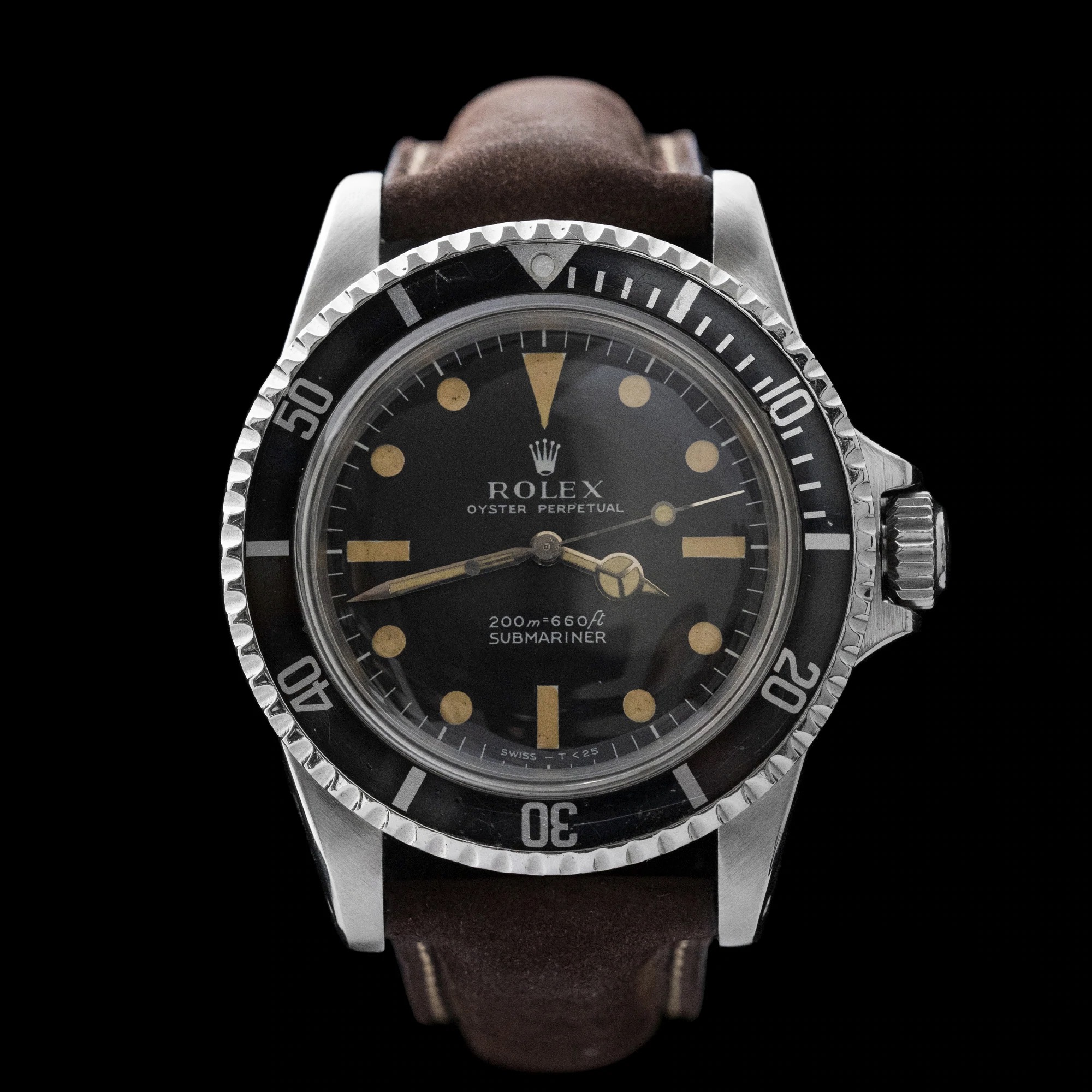

This 5513 has popped up locally and hoping for thoughts from folk with far more experienced eyes than mine. Have only just started thinking about adding a vintage no-date subbie so not well prepared yet, but believe (from the pics available) this has original dial, hands and bezel and the lume looks nicely aged and consistent.
Concern is how much polishing the case has seen - some is certainly fine, but I don't want a watch that would immediately be seen as "over-polished". Any thoughts would be much appreciated ahead of a look at the watch 'in the flesh'.

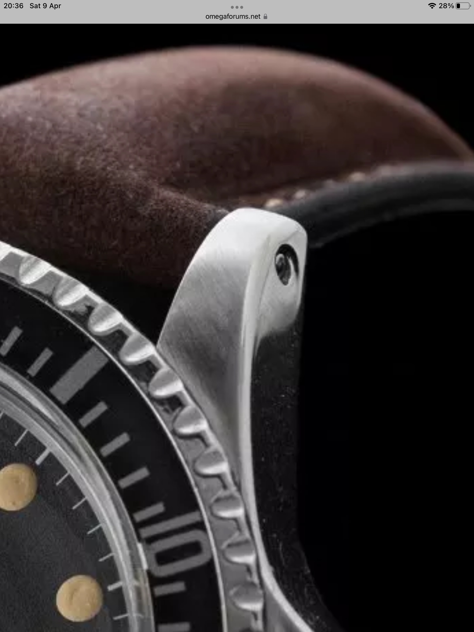

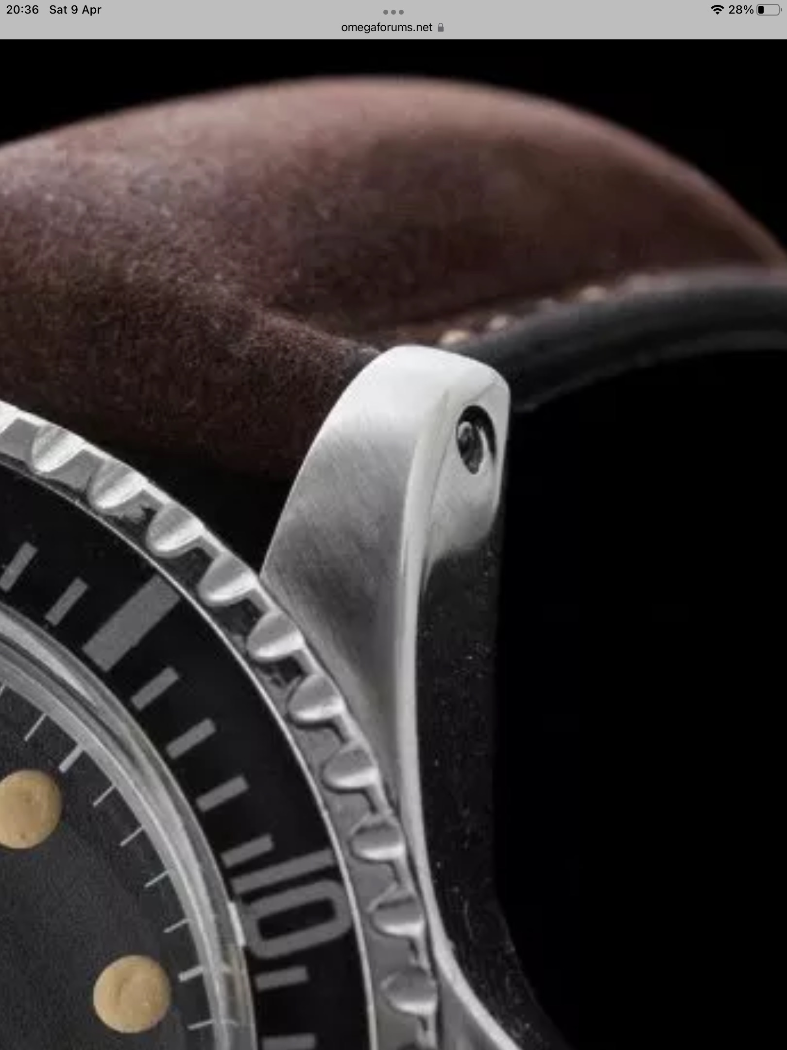

It’s hard to give feedback as “over polished” is subjective and ultimately up to you to decide what is within your tolerance. The case for sure has seen a polish. I would say it appears from the pics to have had someone attempt to refinish the case as the newly made bevels are close to the hole of the drilled lugs but could be just the angle. Crown guards look thick so maybe metal was also added back on during this restore process. Let’s see what more knowledgeable collectors think.

Definitely has seen significant polishing on the lugs, as evidence in looking at the shapes of the lug holes. Otherwise it's a nice looking meters-first, and has the correct long-5 insert. So there's enough upside on this watch to consider having the case restored if that's something you'd consider. Depends on the asking price as always.

Hi Dan - I hear you and absolutely understand the sentiment (you have helped me out before 😀...) Guess what I'm asking is how knowledgable collectors see the case as - while you buy a watch with intention of taking it to your grave - things can change and maybe you have to sell and suddenly something that was fine for you, isn't fine for others. Just trying to do the research and thinking...

I would like to see better photos, especially of that 1 o'clock lug hole, but my initial response is that the buffing wheel has done enough damage to the case that it would bother me. However, the rest of the watch looks really nice, and if I could get the watch at a good price, I might consider having the case restored. Obviously, a watch with a restored case is never as desirable from a collectible perspective, but they can look very good and be enjoyable to wear.

I would not purchase this watch based on the handful of provided pictures above. The case has most definitely been polished and the hands look like they've been re-lumed. I would need to see serial between the lugs as well as caseback stamp.

Agree. With w case that’s seen that much polishing I think it’s unlikely the hand and dial lume aged to such a consistent, uniform look so likely relumed

Since this should be a zinc sulfide dial, it may be straightforward to evaluate the lume using a black light. Hands and dial should respond strongly and consistently to UV.

Thanks all for your comments - certainly add up to giving this one a big pass on the case alone - but I'll check out the lume for interest... what this has done though is ignite real interest in finding a good example... 👍

I would always stare at the (serviced?) lume dot (pearl) on the bezel....which doesn't really fit to the rest....

Definitely seen too much polishing in my opinion. In the world of vintage Rolex, that seriously devalues the watch.

The polishing here is horrendous … I also agree the hands are redone. I couldn’t buy this watch at any price.

Considering the quality of repair options available to damaged cases now, I would not hesitate to have the case restored if the price were right. Its not as if these are rare watches, just expensive.

Are the original case sizes, and width/thickness of the lugs measured over the lug holes not known ? How do the known case restorers do this then when adding laser welded material ?

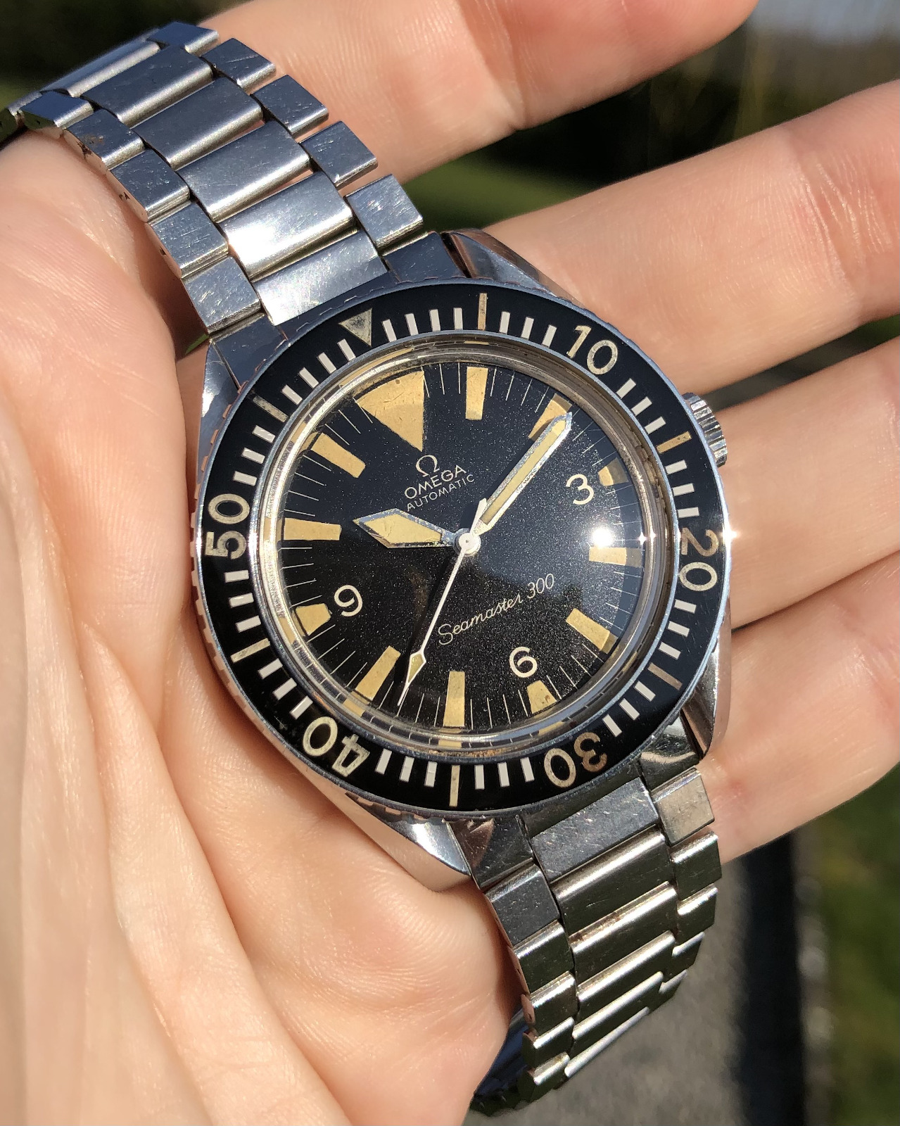

I had another look at this last week and it is a stunner (thought the case does blinds you with reflected light it's so polished)... but the seller remains unrealistic as to price - asking the equivalent of USD16k (compared to the nice example which came up on the forum here a few days ago for just over USD11k - albeit with a slightly later bezel insert - and was gone in a flash...)
https://omegaforums.net/threads/1968-rolex-submariner-ref-5513-‘meters-first’.145896/

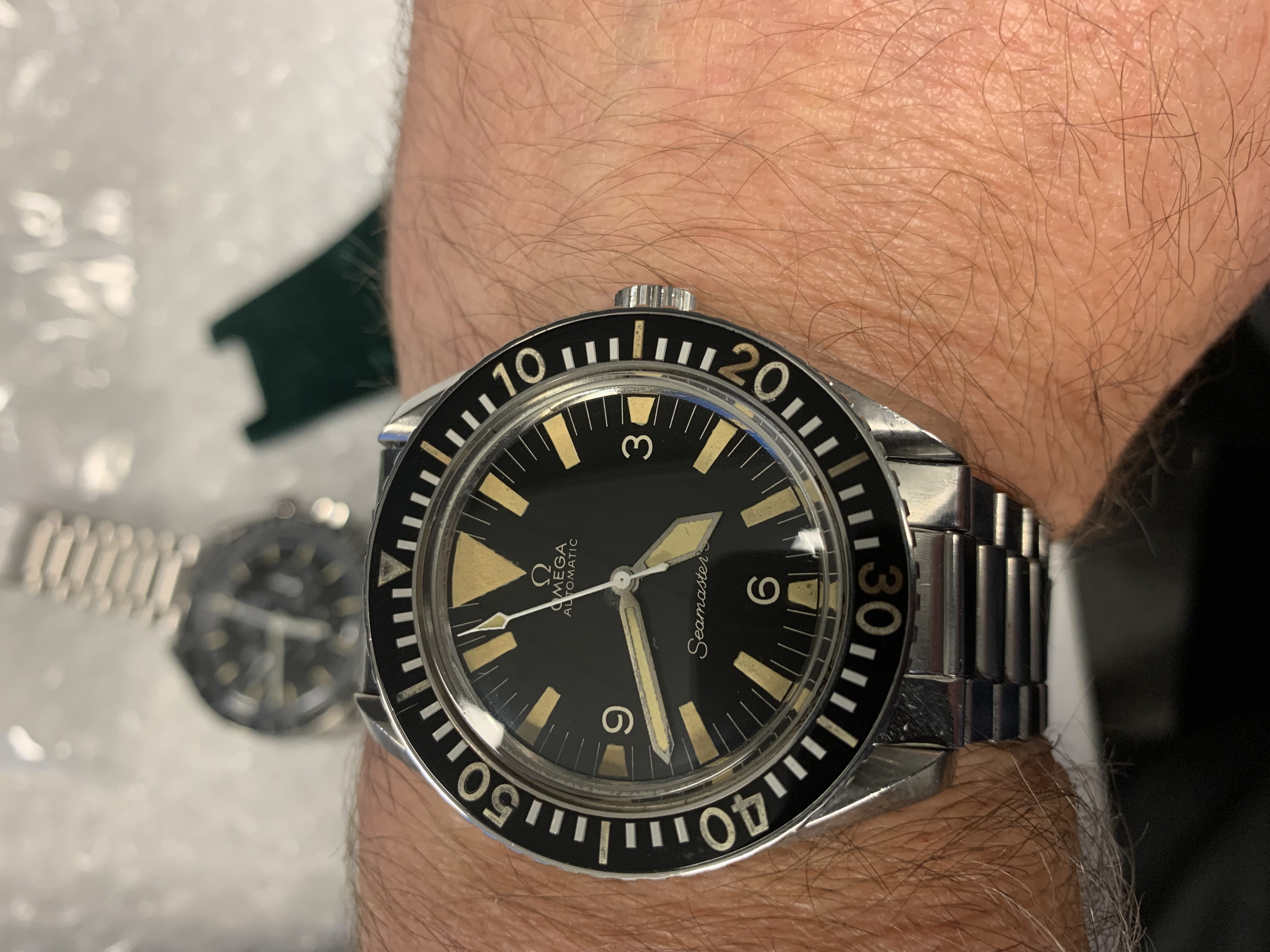

I'm still struggling to understand the prices Rolex command given how relatively numerous they are (and few are in really nice condition) - so put hand in my pocket for a SM300 Big Triangle on a rare'ish bracelet with an EoA for less money...

Congrats !! and what a very nice watch.

Looks like they were trying to polish it into an Ed White shape - run away !
