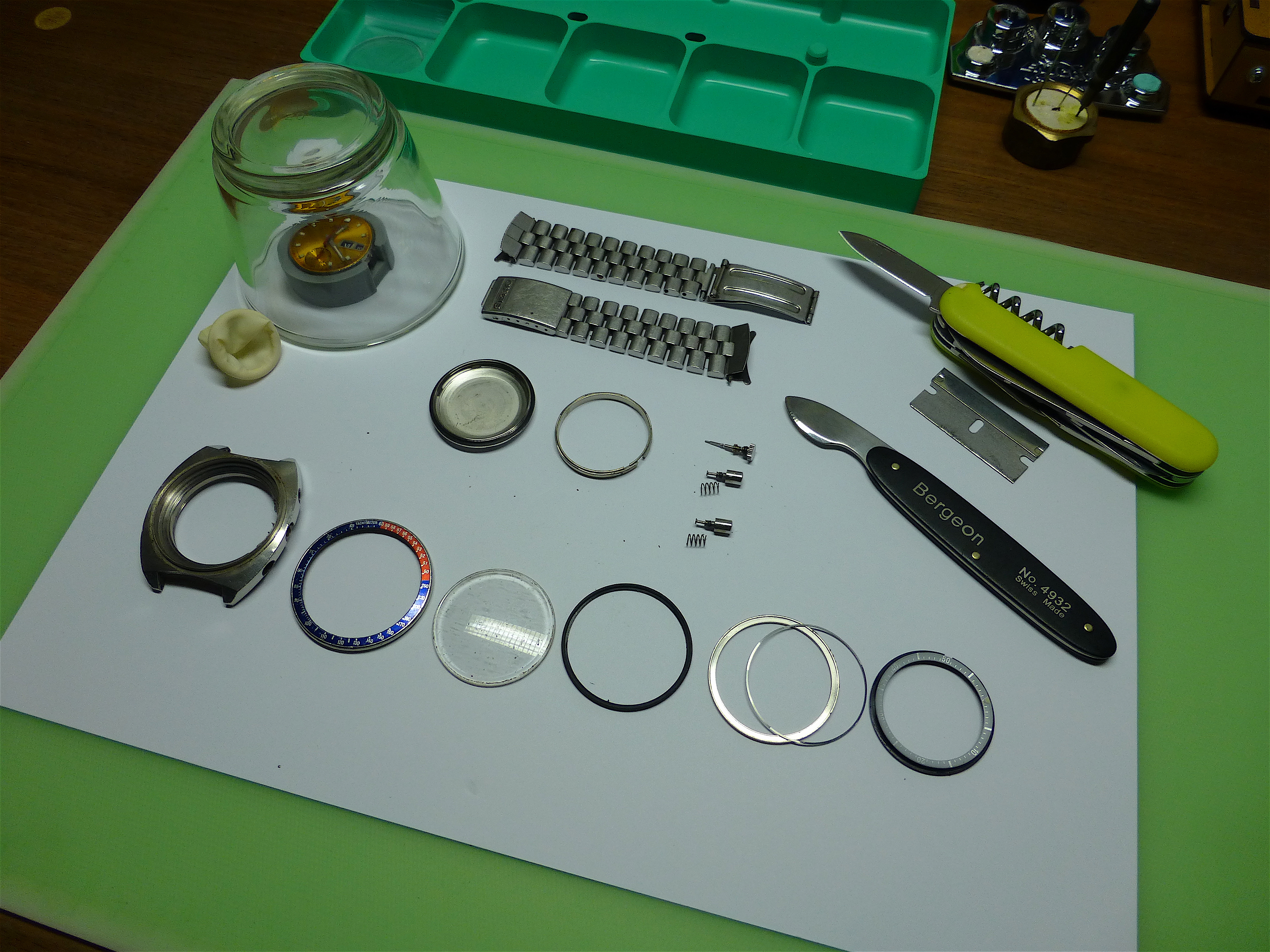

65 Speedmaster 105.012 in for restoration.

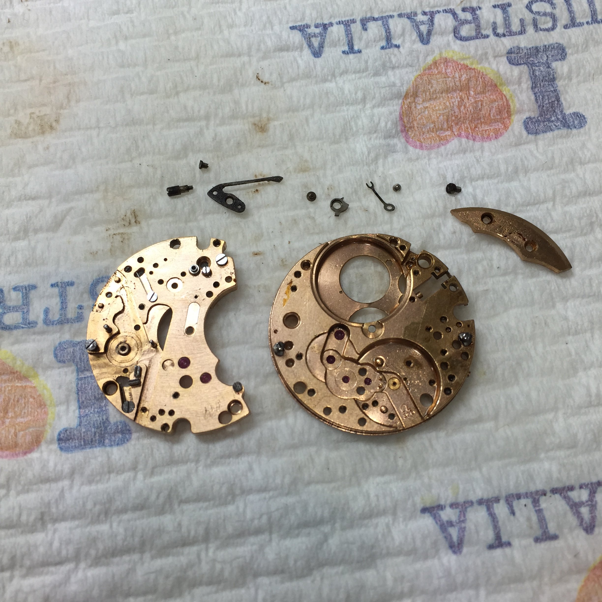

Thanks everyone [emoji2]! Yes it's in a pre clean right now then it will be stripped and the individual parts cleaned. This way the rusted screws may be easier to remove and it gets rid of the worst of the muck. I don't know exactly what the oil was inside but it was everywhere and a lot of grease had been smeared around the pushers and chrono levers probably in an attempt to get it to work. It'll be a few days before I can get back to it but I'll keep everyone posted on the progress [emoji106]

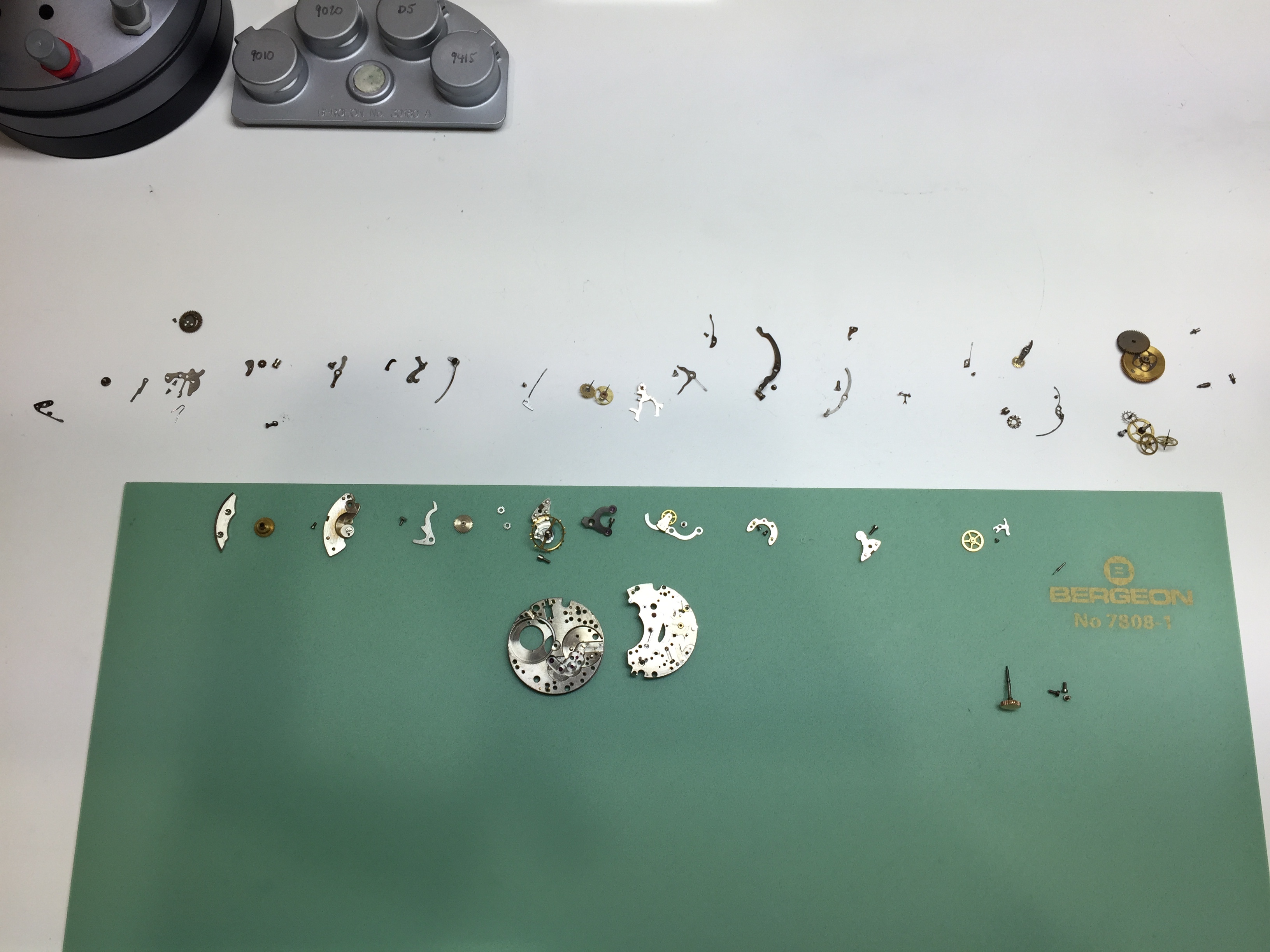

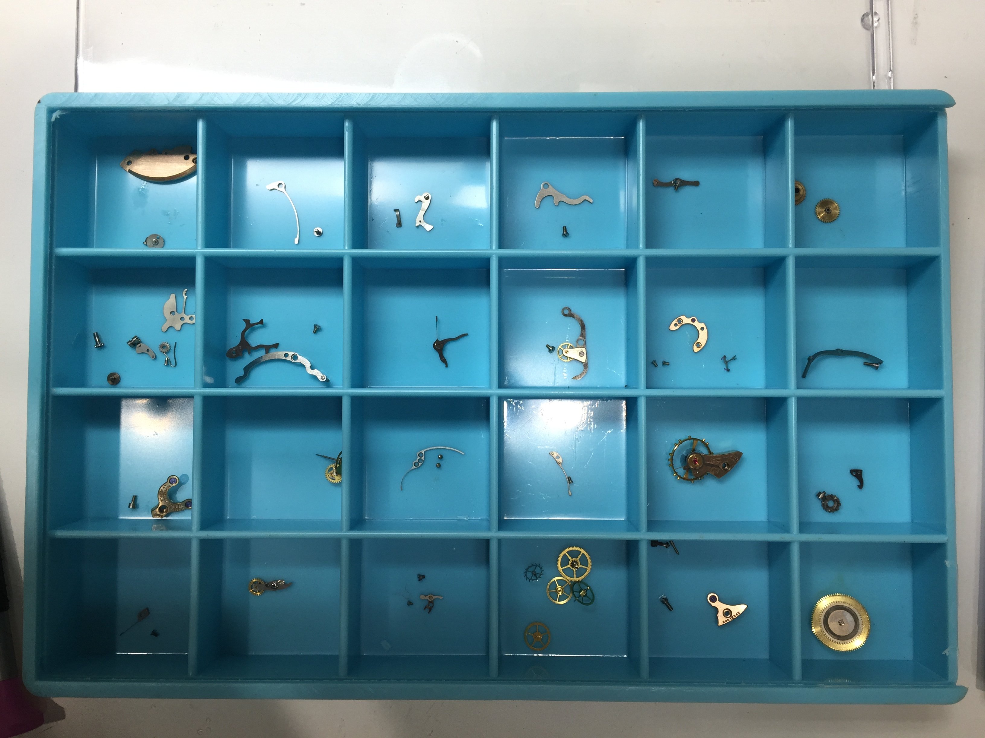

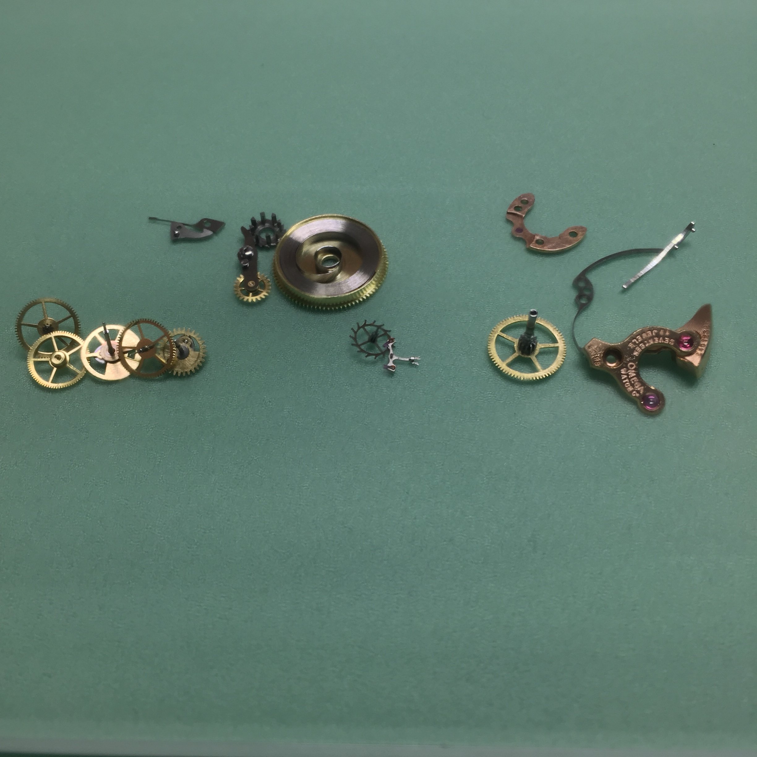

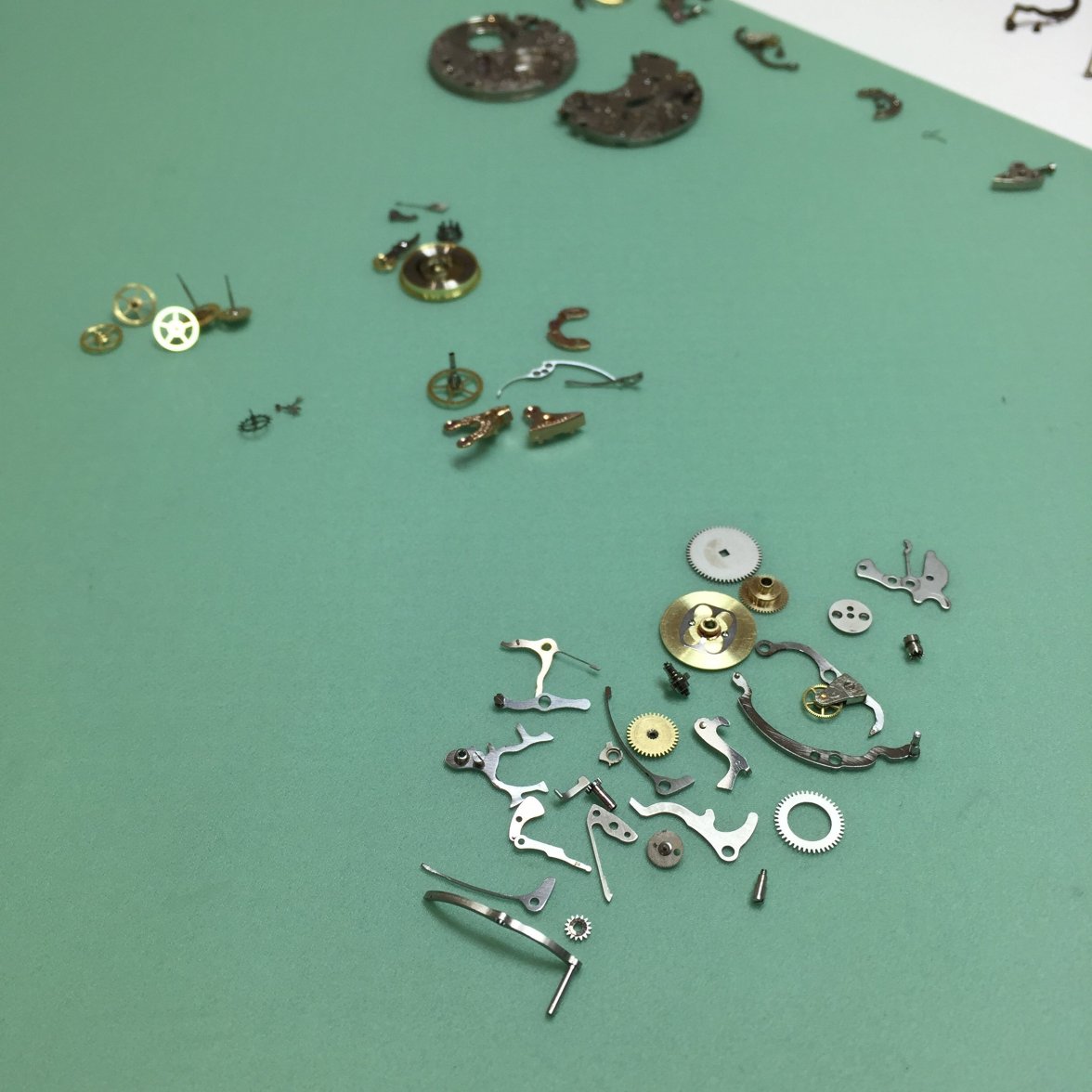

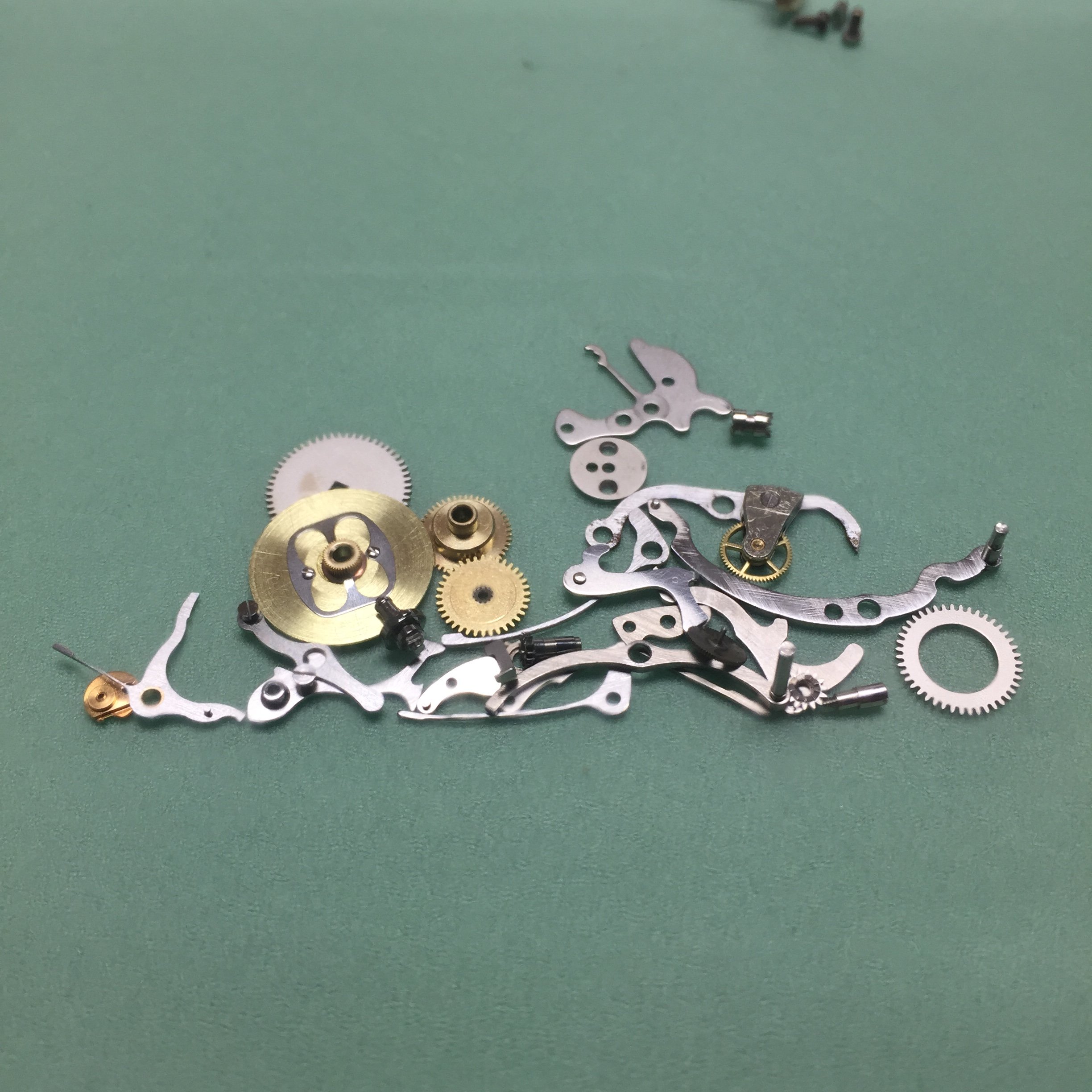

Alright well I've been away from this thread a little longer than I'd expected.....

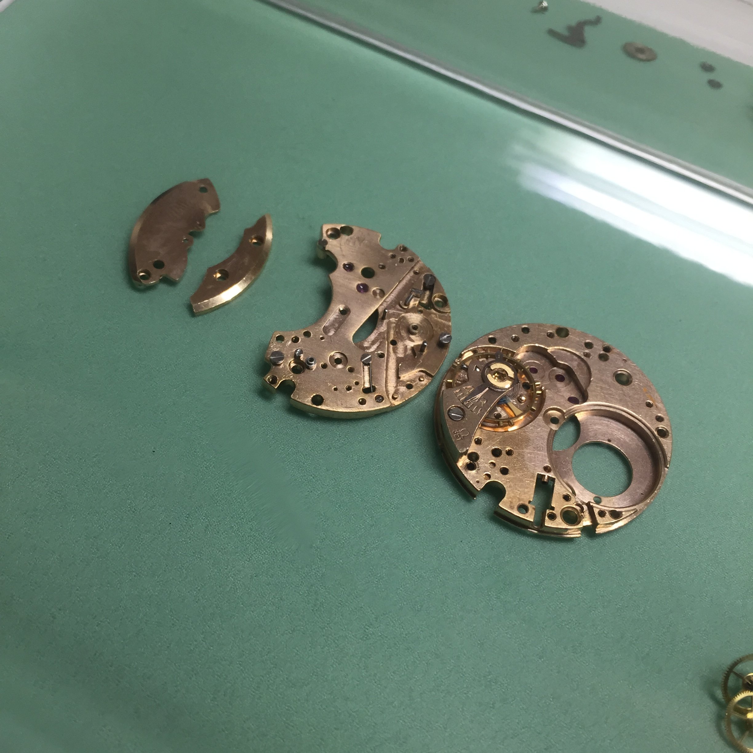

I have managed to fully strip the movement and select the parts that need replacing, there's quite a few of them. Some could be cleaned up further but in a watch like this I'd rather not take chances. Several of the screws refused to come out first time but with some gentle persuasion they have all come out without any breakages.
The balance and hairspring are fine luckily on the 321. I have a perfect Lemania donor movement which has come in very handy......
Last rusty screws are removed, cleaning to follow
sorting out the parts
Everything on the white desk is for replacement, parts on the green mat are from the donor movement and not needed.

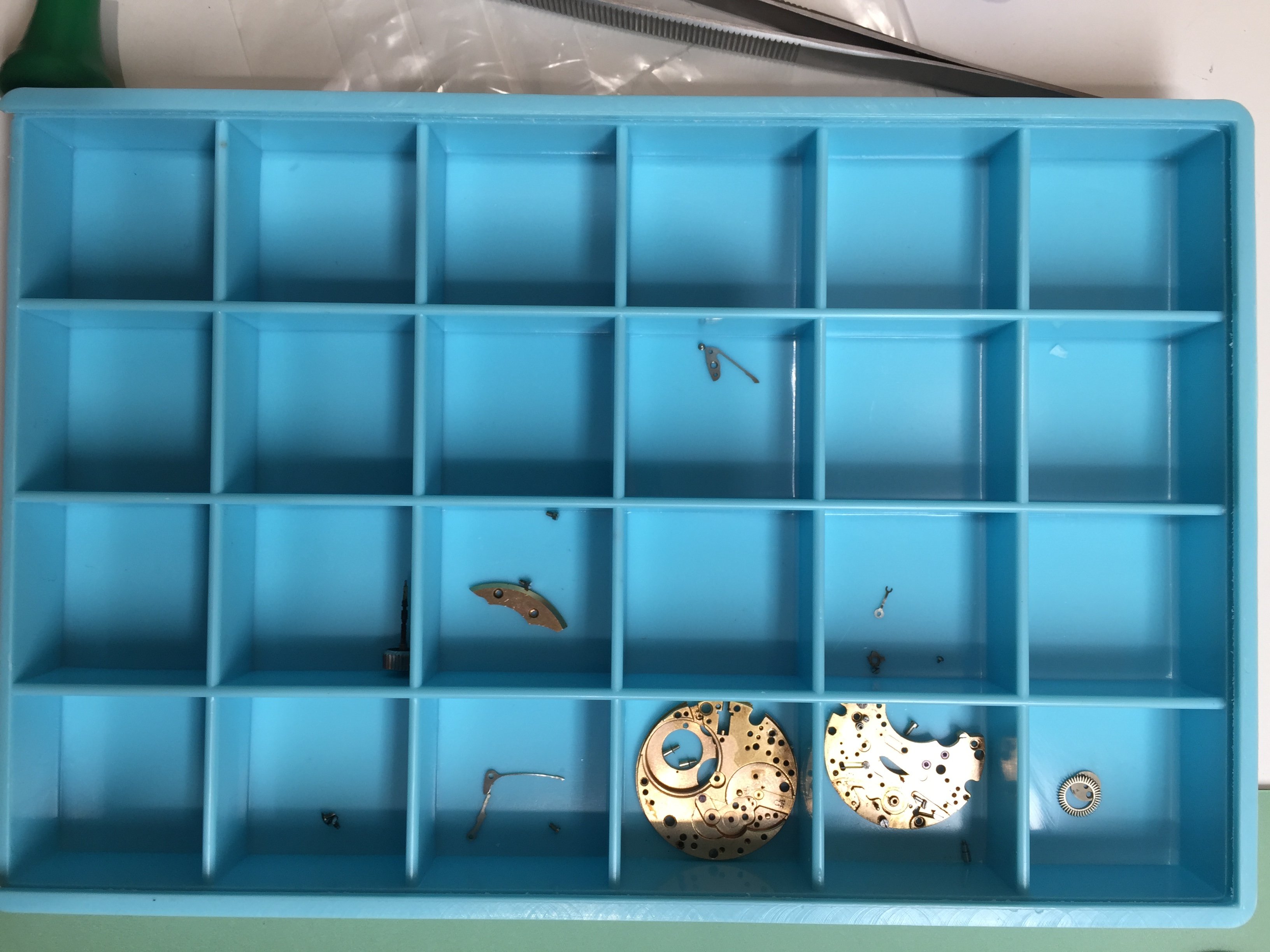

After ultrasonic and cleaning machine steps
New Mainspring installed

This 65 Speedmaster is in a pretty poor shape and I thought you guys might like to see the first few steps of its restoration and service. Not all 321's have survived the last 50 years in perfect condition...
