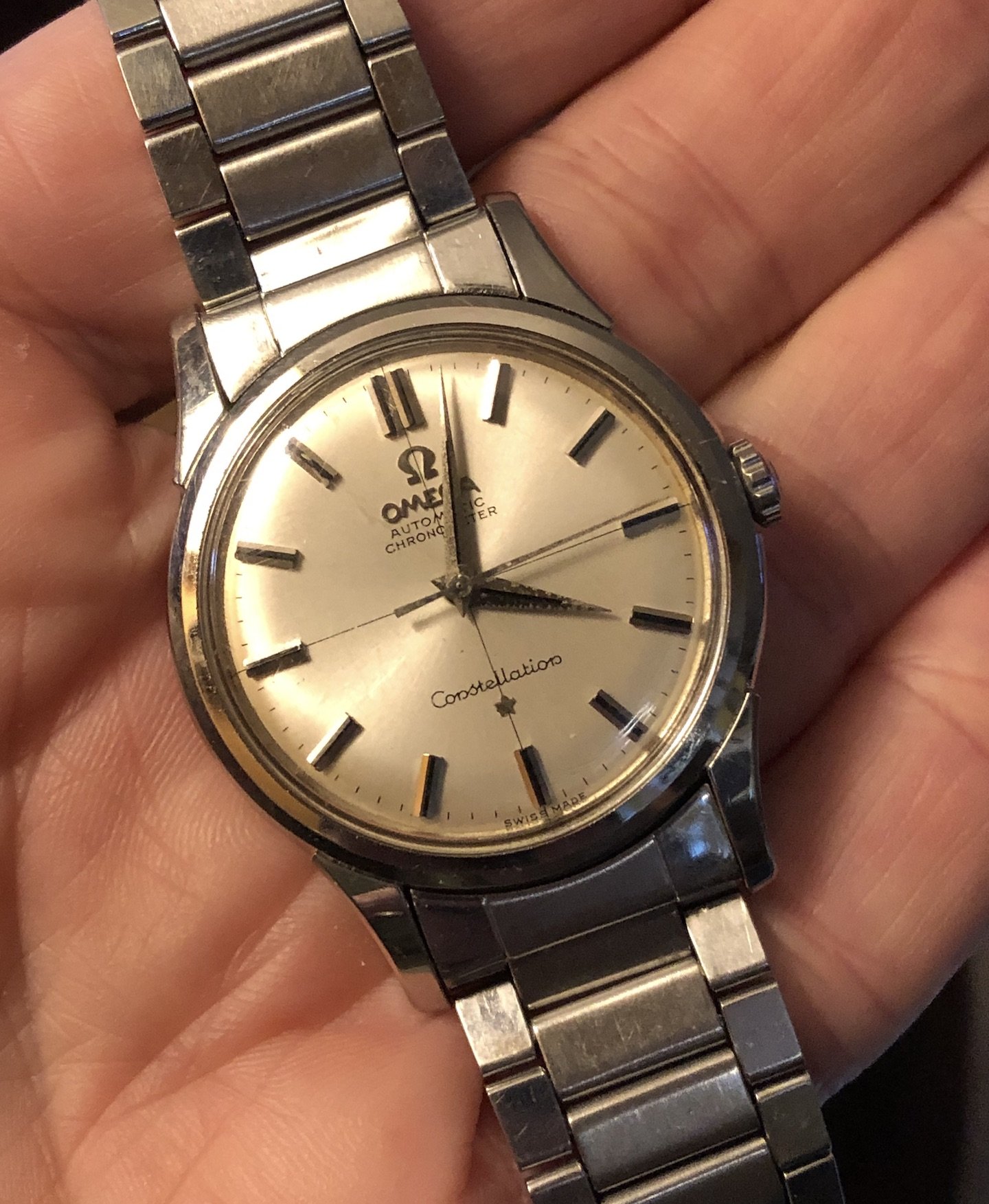

Funny, same here for my two 14381s and I figured it might have been just a coincidence. However, if you make the endlinks fit, they do sit just great:

Funny, same here for my two 14381s and I figured it might be been just a coincidence. However, if you make the endlinks fit, they do sit just great:
Thanks for the photo, it looks fantastic.
I wish I could use my 1035/630 on a 14381, the end links fit between the lugs, but the end links are a tad shorter than the lugs and the last link of the bracelet is slightly broader (only on one side interestingly) than the lug width, so if I force fit it, the bracelet just hangs there twisted as there is pressure between the tips of the lugs and last link of the bracelet. Did you guys file down the sides of the last link so it fits in between the lugs?
