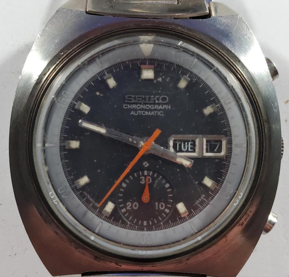

Quick question for the Seiko experts. I'm starting a basket case 6139 restoration project. I'm trying to source a crystal and bezel. Can you point me to the best place? Just trying to get it up and running for personal use. Not trying to make it perfect. Any help is greatly appreciated 馃榾

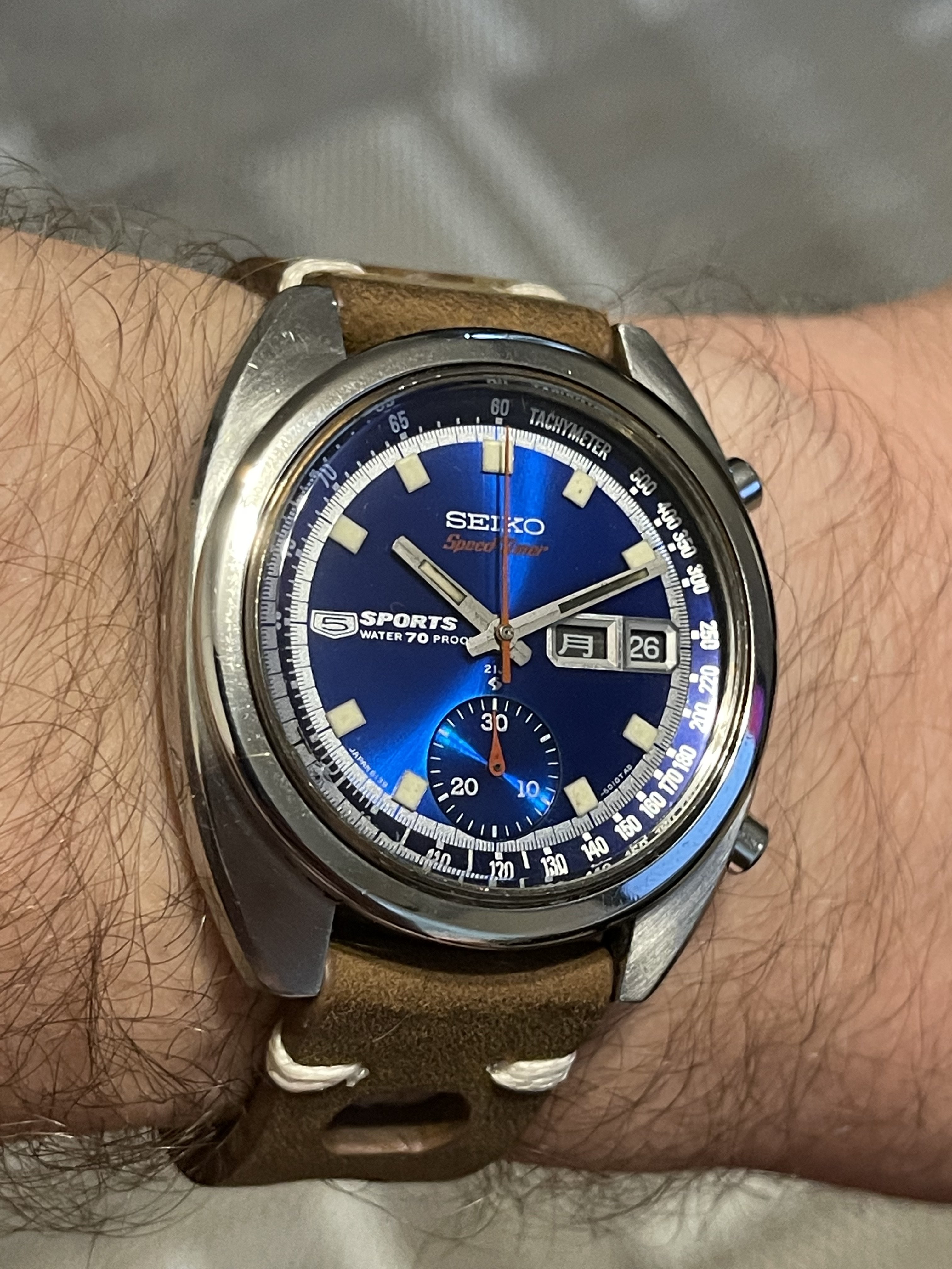

I have a 6139-6010 Bruce Lee myself with the blue dial. Got a NOS set of hands but these are the original and matt which were only on the earliest models, so decided to stay with them for now.
What is your case number on the back? I am not sure about bezels, but aftermarket bezel inserts are plentiful.
