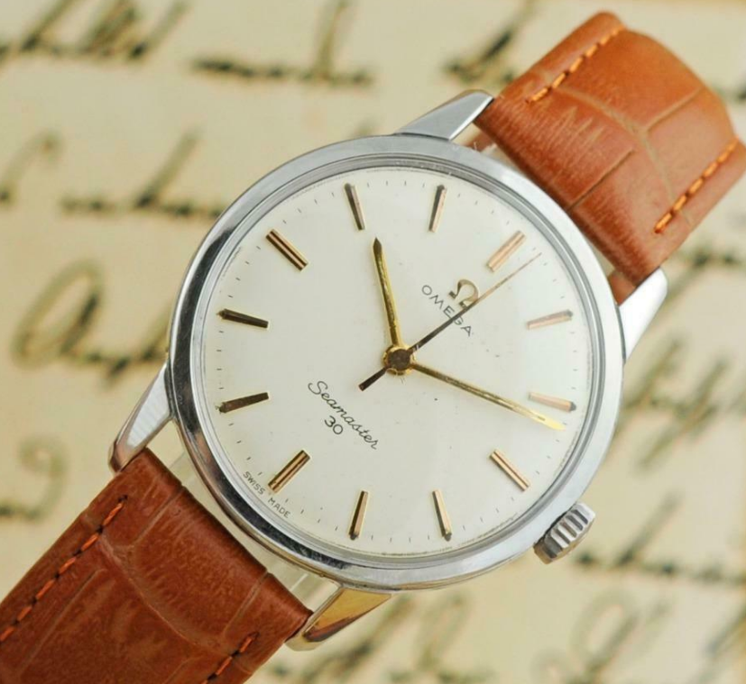

Looking to grab my first Omega (also first watch ever) and stumbled upon this offering:
https://www.ebay.com/itm/SWISS-VINT...sh=item46ad5ef515:g:xyoAAOSwYoFerDQv#viTabs_0
I've popped in the movement number into the Omega Vintage Database and was able to find similar reference numbers, but not identical. Is this a effective way of verifying the watch, and if so, is this one a fake?
In addition, how does the watch look for that price point? The seller lists this as being an original dial, and it looks good to me, but I'm not certain. Also the case and lugs seem to be quite polished.
Any input would be greatly appreciated.
Thanks much.

If you are dipping your toes into the vintage market, you are wise to check here first- glad you asked before you bought.
Read up on the sticky’s in the vintage forum, there are good threads on how to spot fakes and over polishing.
Even though you are a new member with a post count lower than 200, you can still PM any seller in the classified’s and start a conversation about a watch there that you may find attractive. The benefits of buying from the classified’s here is that they are group verified- as in bad redial will be called out quickly and a fake won’t even make it up for sale.
The learning curve on vintage watches is steep and can be expensive but if you know going in about what to look for and any hidden costs (parts or servicing required), you are a far more educated consumer and can make better choices.
Welcome to the group- dude.
1,709
5,705
For a few hundred more I think you can find a much better piece. And it’ll be worth it. A few listed right now here and on other forums, good luck with your search!

I think you could do better for the price, considering the overpolished case, several watches that are much better than that (IMHO) have sold for under $500 in the private sales forum here recently. It takes patience, no need to rush. The right one will come.

Ditto the above, but it’s worth saying that as a first-post watch, this one’s actually pretty good. Aside from the fact that the case has been polished (which will bother some vintage collectors more than others), it’s a good piece: authentic, not a frankenwatch, doesn’t have the regulator pushed all the way to A or R and isn’t being listed for $1,300! You could buy this watch, imo, and come off better than a lot of first-timers, myself included. If the polished case doesn’t bother you, I don’t think it’s a bad choice.
it’s a good watch. And thorough.
1,940
2,955
I’d want to get a little more clarification from the seller: the listing says it was “tested,” but was it serviced? What are his/her standards for keeping good time?—within seconds a day or minutes? Depending on the answers to these questions, you might want to factor in the cost of a service, which could be 200-500 bucks.
4
Appreciate the input, man. I'm assuming that the fact that the regulator hasn't been pushed to the A or R indicates that it has been serviced properly, correct?
Those are definitely great questions to ask, I'll update when I get some answers.

A centered regulator is not a strong indication of anything. You can center easily the regulator on a watch that doesn't keep time or even run. Having the regulator pushed all the way to one side is an indication of a need for a service (either it has been awhile and regulated heavily to keep decent time, or a recent "service" was poorly done.)
16,305
45,025
Always assume a watch will need a service and account for it in the purchase price unless the seller can show documentation of a recent service. Think in terms of a $600 watch will cost you $800-1k all in.
And particularly on eBay- if they say “serviced”, ask if they can provide a watchmakers invoice. If they say “we tested and regulated it”, or “we have a guy...”, run.
1,940
2,955
What he said. The centered regulator is a better sign than one that’s not centered, but it is not, all by itself, a sure sign of anything. All I meant to suggest was that the watch was a better first post than other ones that show up sometimes with their regulators limited out—a definite bad sign.
