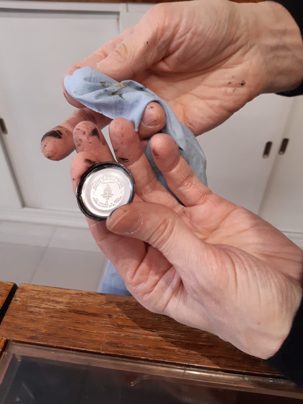

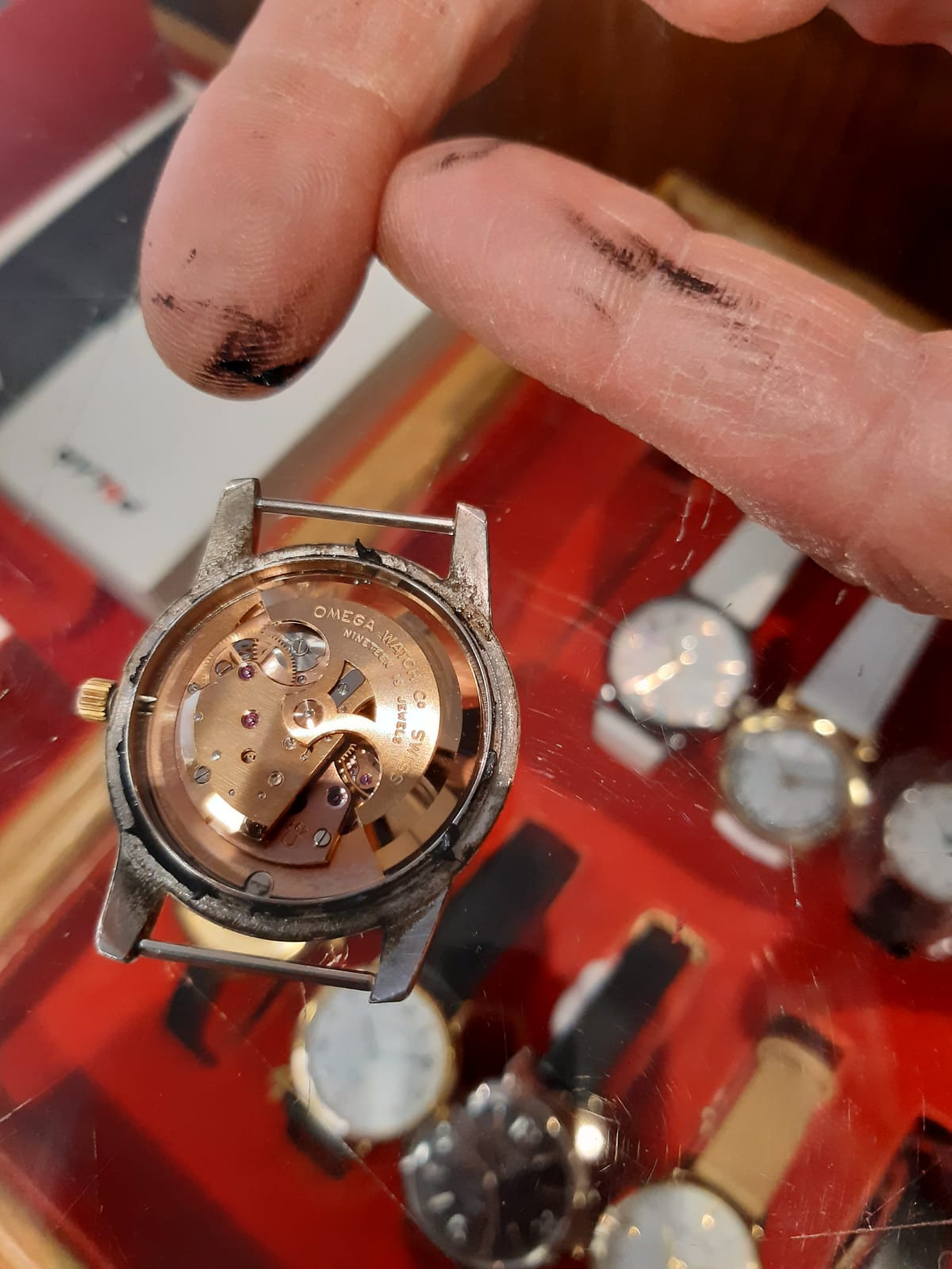

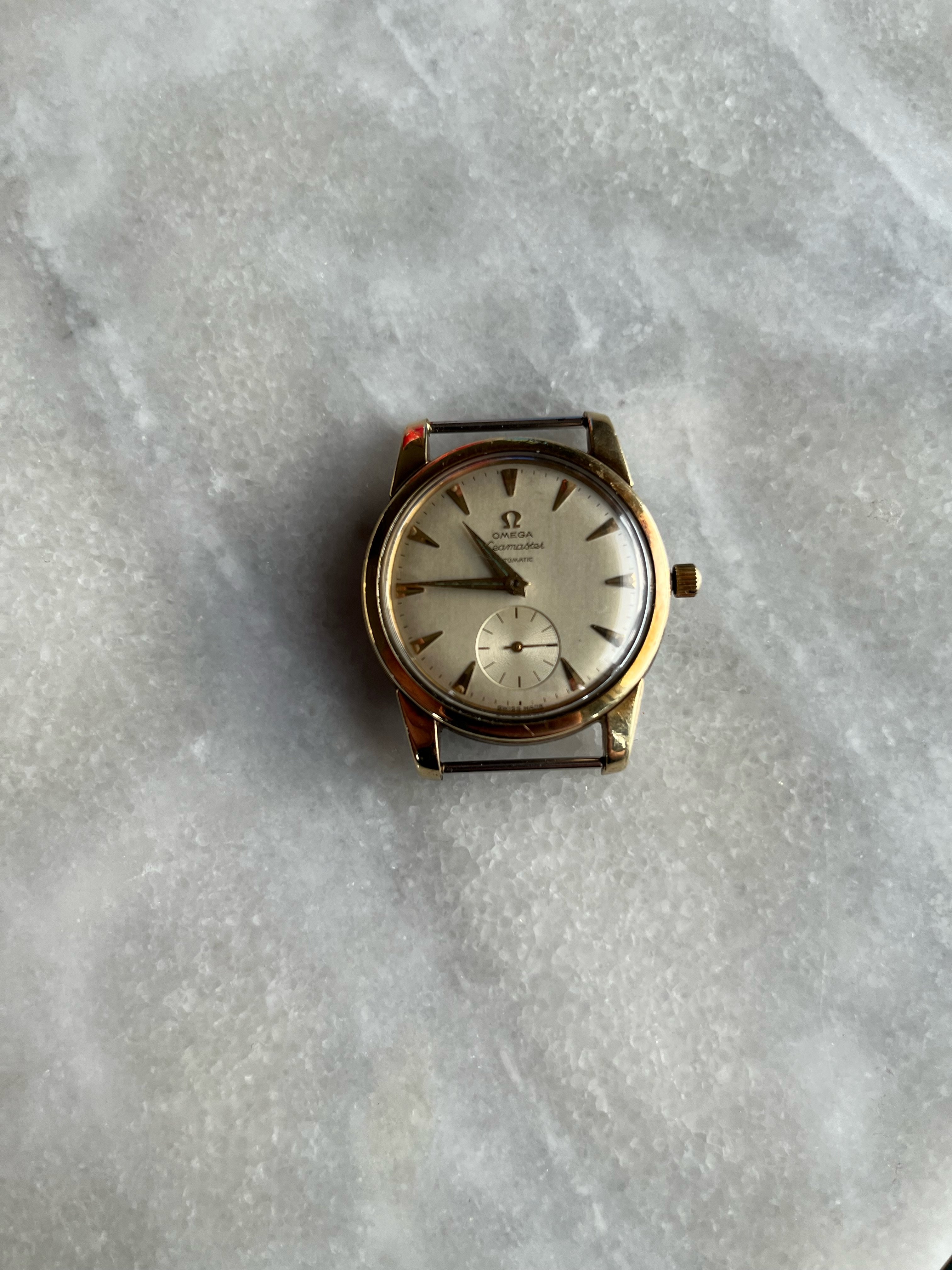

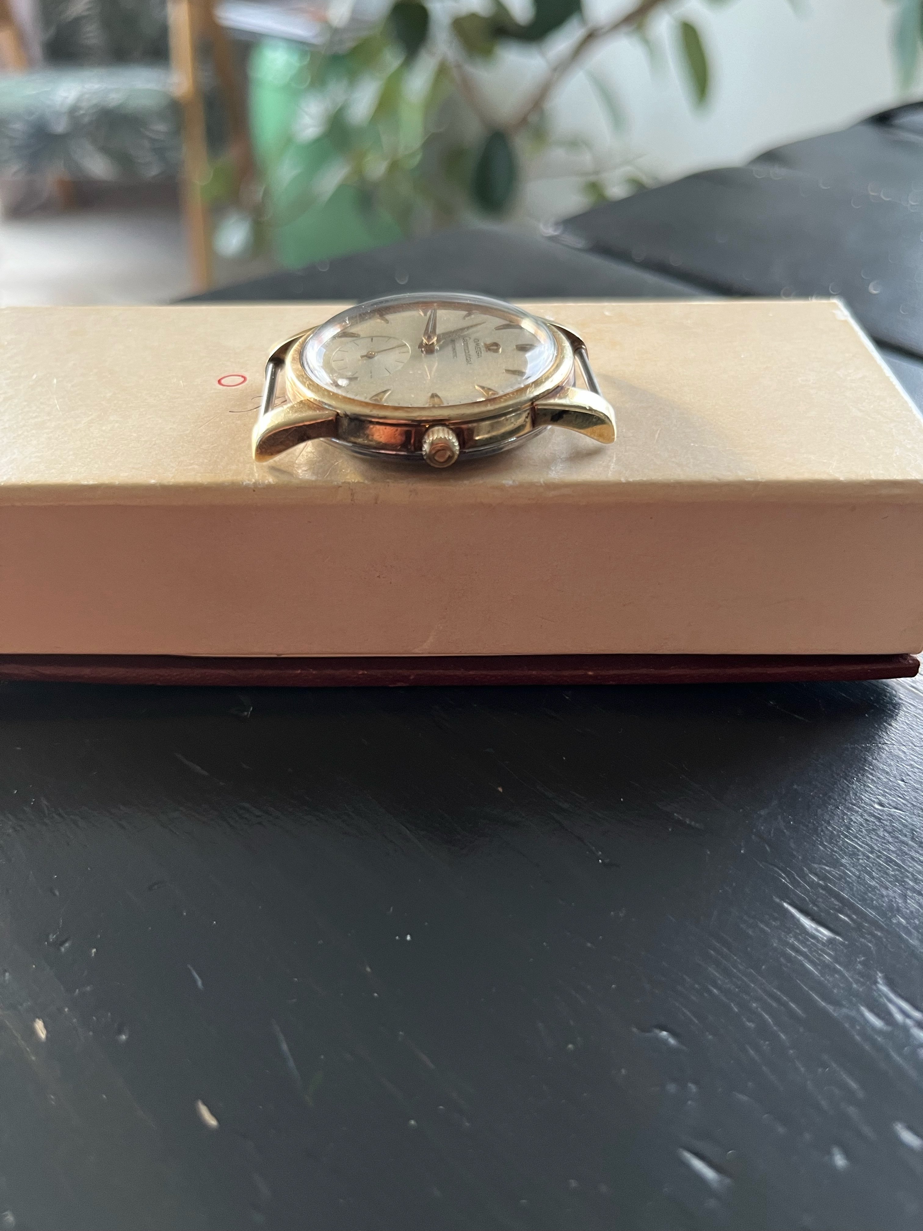

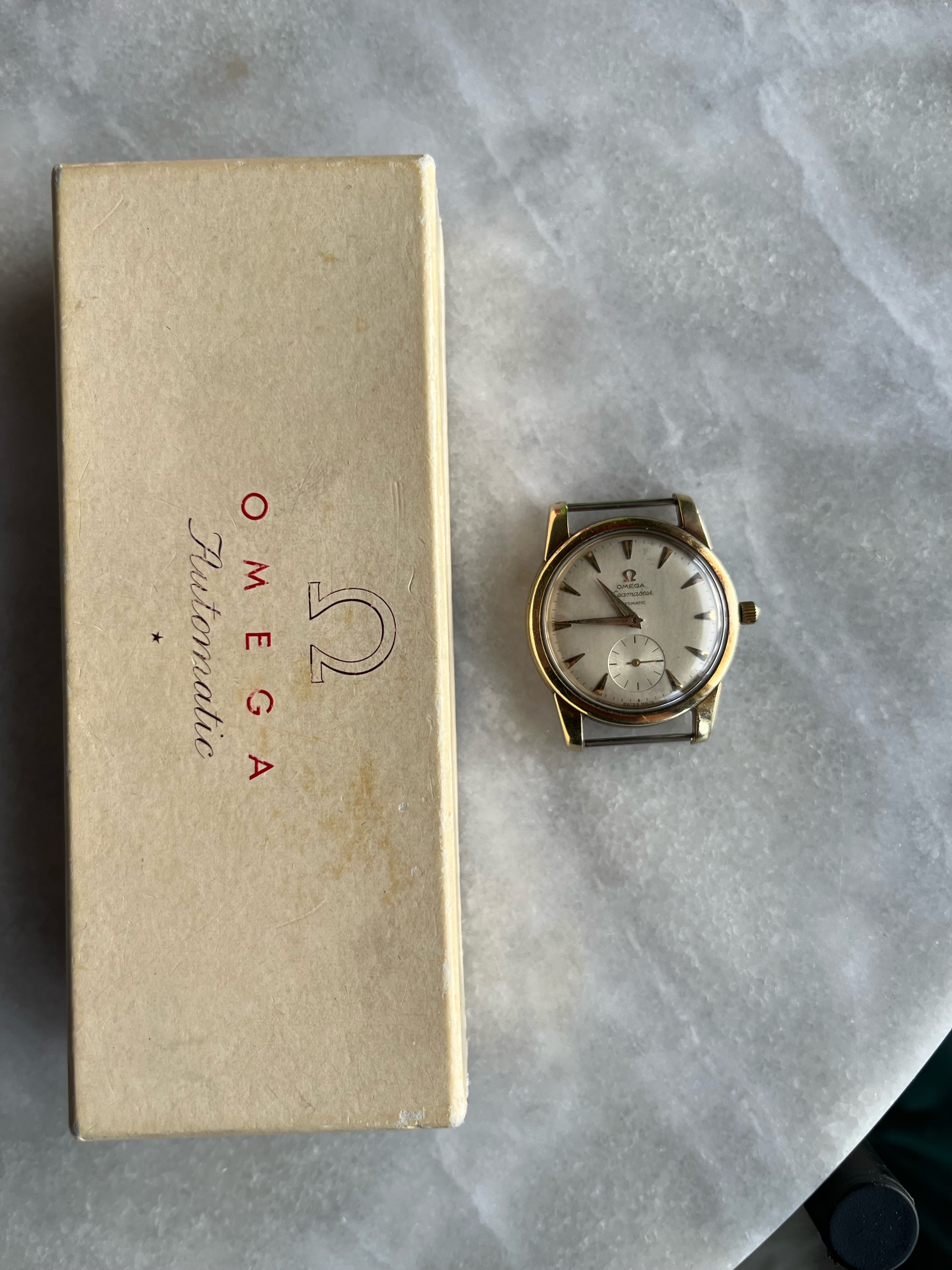

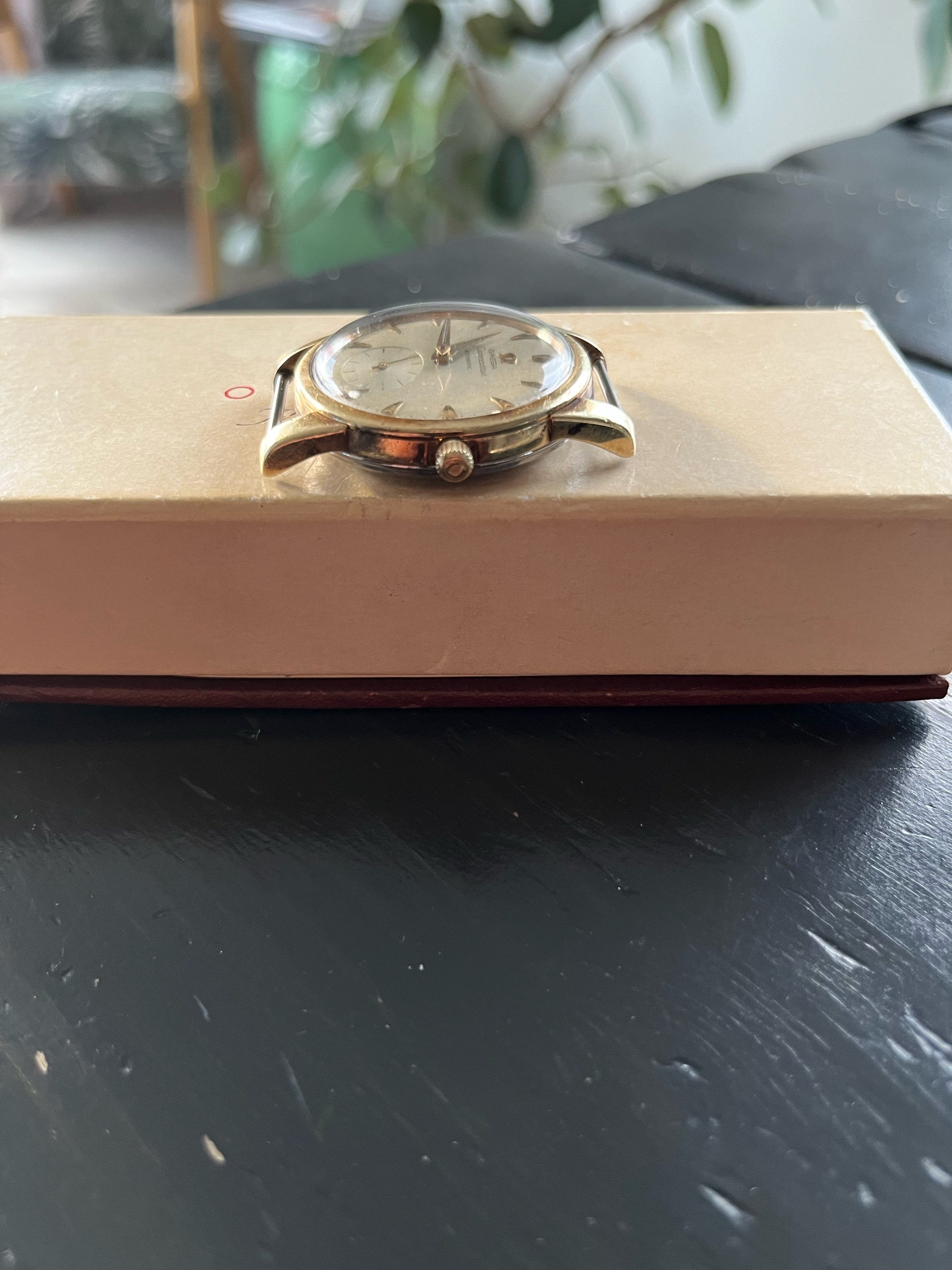

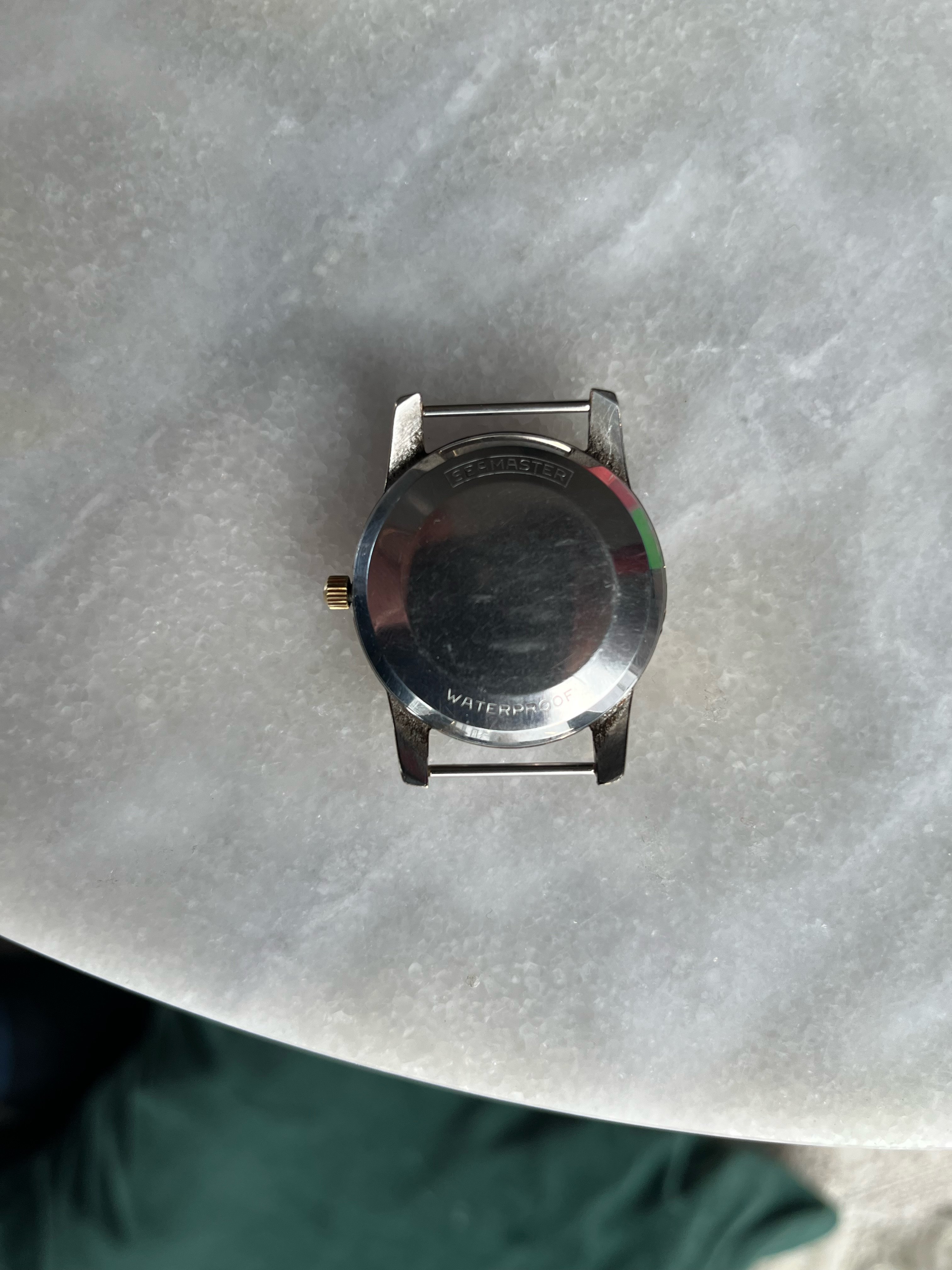

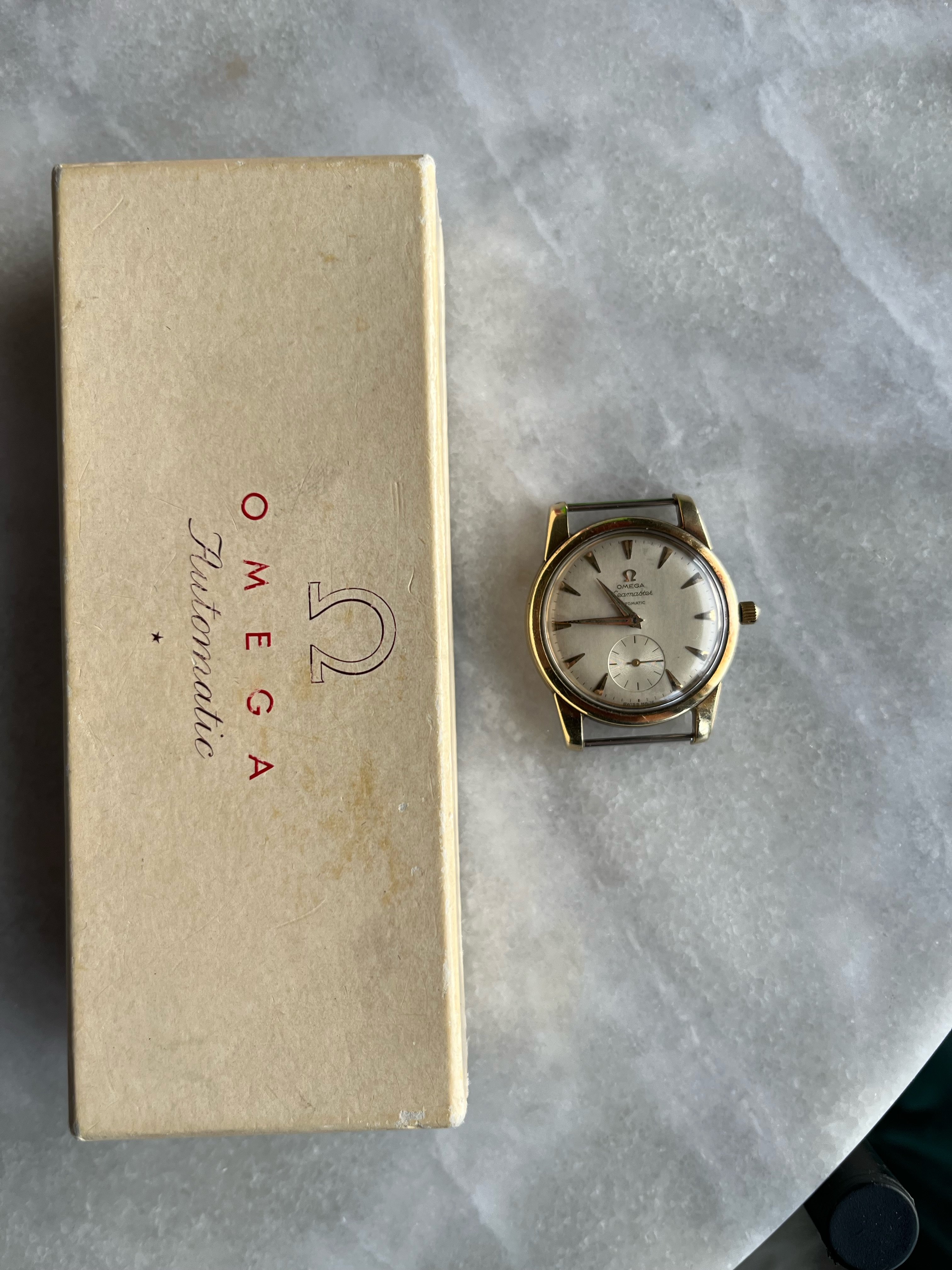

Hi,

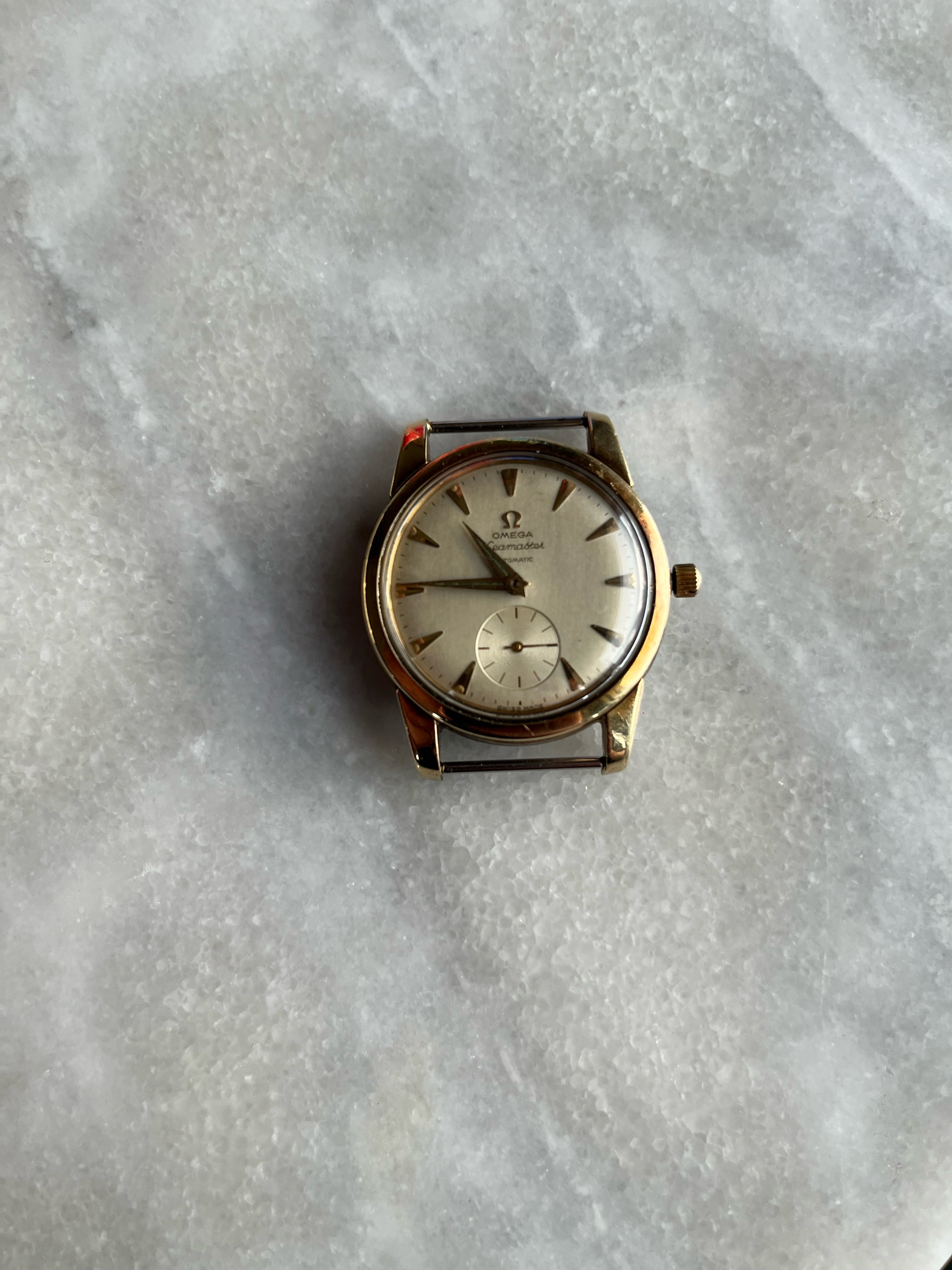

I inhireted this vintage Seamaster from my grandfather and I'm looking for some advice. I struggle to identify the exact model and woud like to know what to do with it and what to avoid. Unfortunately I don't know about the history anything except it's most likely been in the family since new but no service information is available.

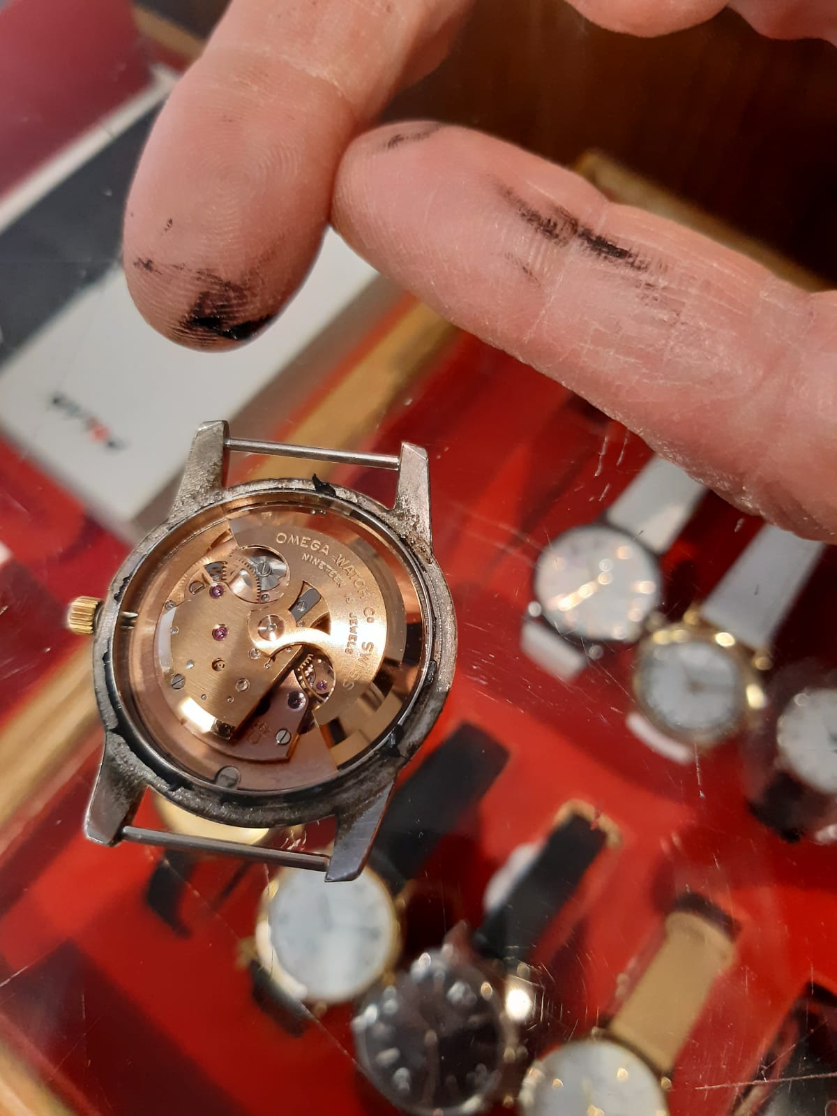

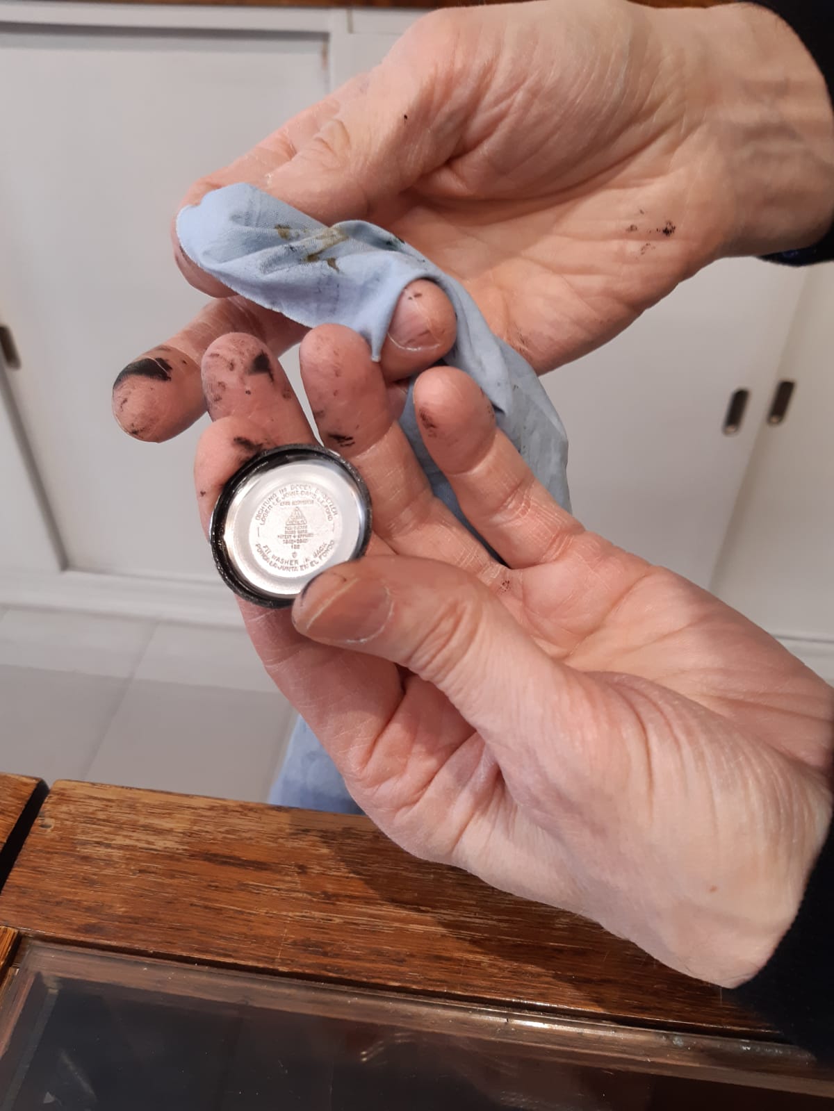

I had the local watch shop open the back but unfortunately pics looks like being taken with potato. The shop confirmed mechanisms work alhtough not smoothly and the back seal has started to detoriate. Some kind of service is needed but I would like to know if it makes sense to pay for proper work or do I have some kind of frankenwatch on my hands.
311
185

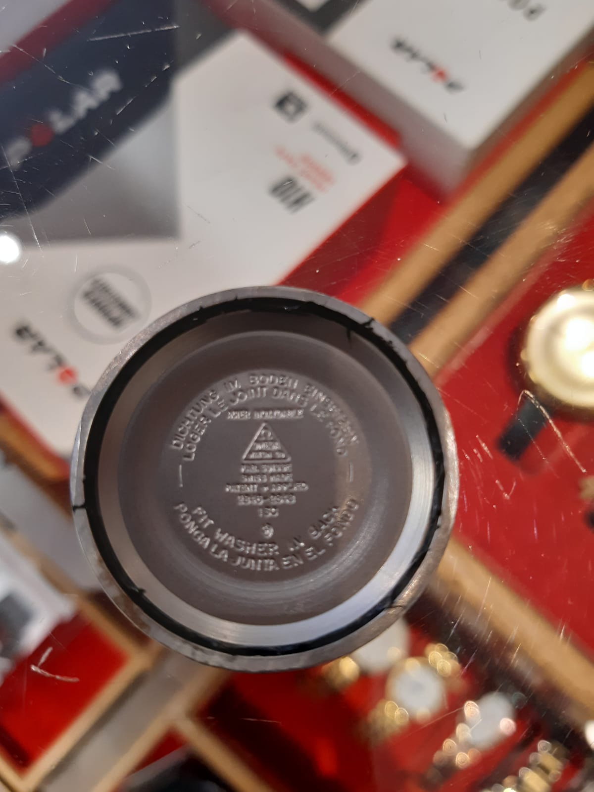

Hi. The model of the watch ( or reference number ) it's written inside the case back. I wasn't able to see it in your pictures because are very poor quality but it's there.. Your watch is authentic and because you inherited i think worth to restore it and keep it in your family. The machine looks very good but i am not an expert.
10,804
16,814
Looks like model 2848 using movement 491. Probably from 1955-58 but if you list the serial we can narrow it down further. The movement looks very clean but will need a service. It’ll be worth it.
3,595
13,551
Looks legit, from what I can say of those pictures. Question is what you want to do with it. If you aim to sell it then don’t have it serviced, just take clear pictures and describe it well. If you want to keep it as a beautiful heirloom, have it serviced by a watchmaker who’s sympathetic to vintage watches. No polishing of the case, nothing done to the dial, just a mechanical service and new gaskets of course. The watch was serviced before, someone took care of it at least for a while. +1 regarding 2848 by the way.

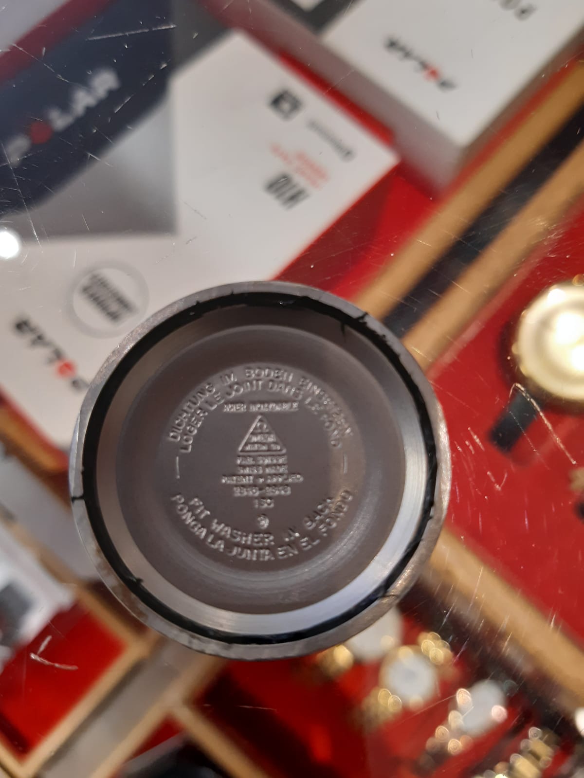

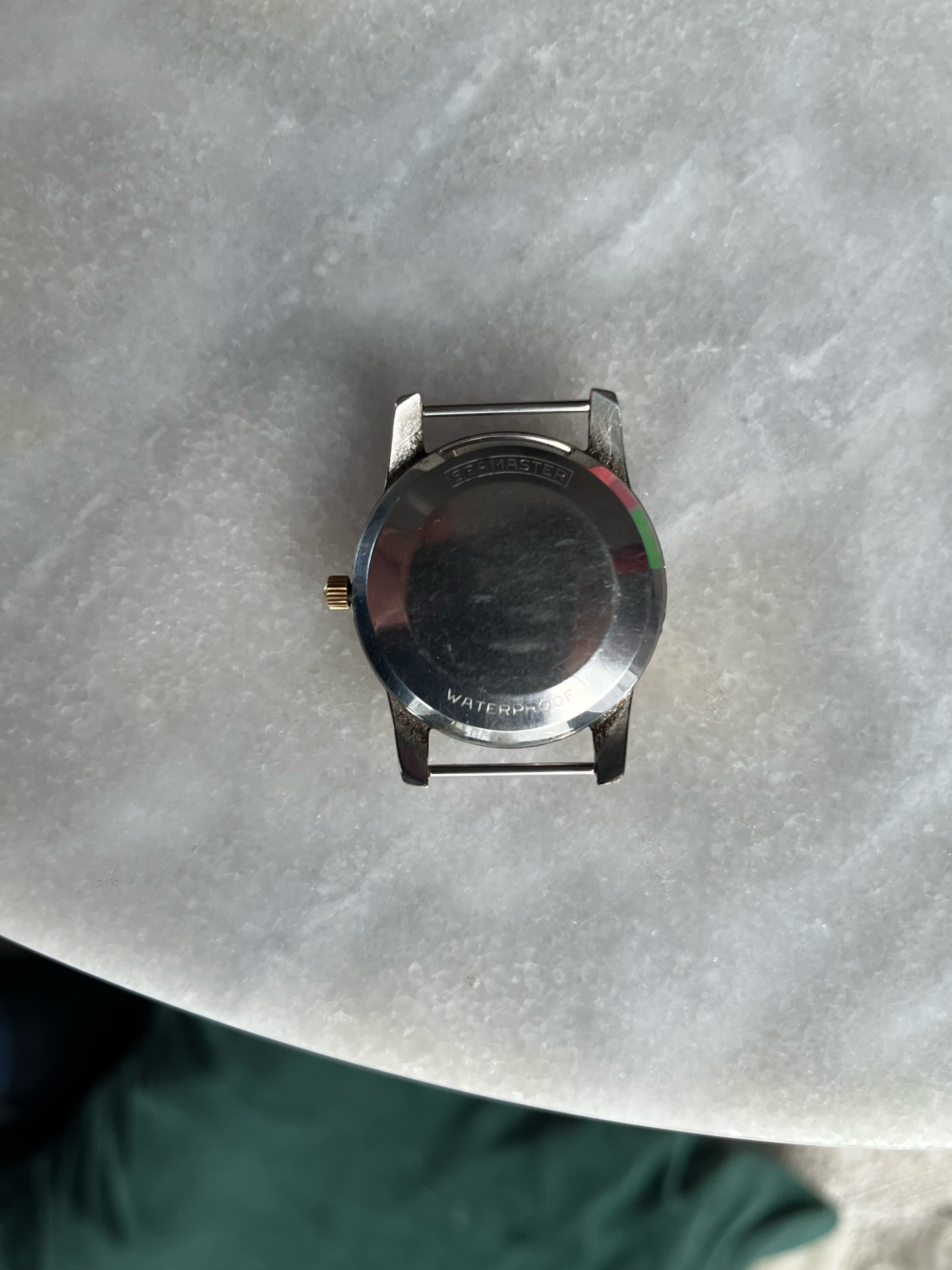

For the model informatio if I really squint it could say 2846-2848 on the back cover and either 1SC or 15C below.
3,595
13,551
The "1SC" isn't quite relevant. 2648-2848 will be in the case back, as the case is used for both references. 2648 is the center second version, 2848 the sub-second.

The watch looks basically legit to me except for the crown. Unfortunately, it's hard to evaluate the dial, because the photos are blurry and the hands are blocking some of the printing. But I think the information you have been given is correct.

It's a nice gold capped model. You don't need to send it to Omega and watchmakers don't need an Omega parts account to get parts.
While a small number of parts are discontinued. There are many parts suppliers one can order from to get parts that are available and Ebay is another source for the discontinued ones.
I myself have sold parts to members here as I used to restore.
Crystals are available (ordered based of reference numbers in case back)
The crown is another thing. Guessing it takes the 4 notch model. While it is available. All crowns are now gold plated. Not gold filled or capped. Color will be a little off the case color or you try and find another vintage model in gold fill to use instead. Ignore a number of Ebay posts about NOS crowns. You can call anything NOS (new old stock), but original haven't been the same way since the end of the 60's?
