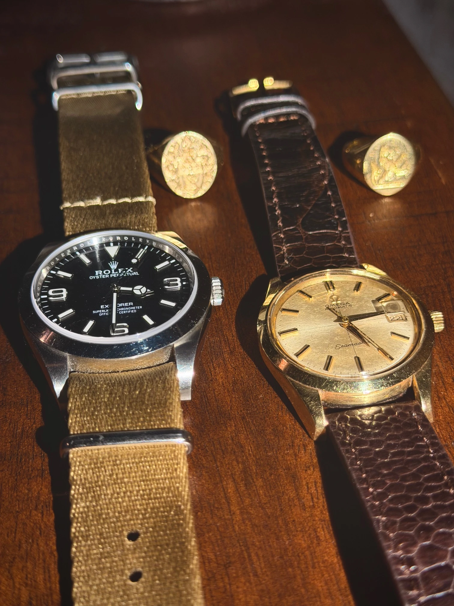

Here's a bit of an "artsy shot." Thought these two pair nicely. I enjoy this case style the best on the vintage seamasters, as it feels explorer-ish to me. Also personally enjoy the magnifier and aging on the dial.

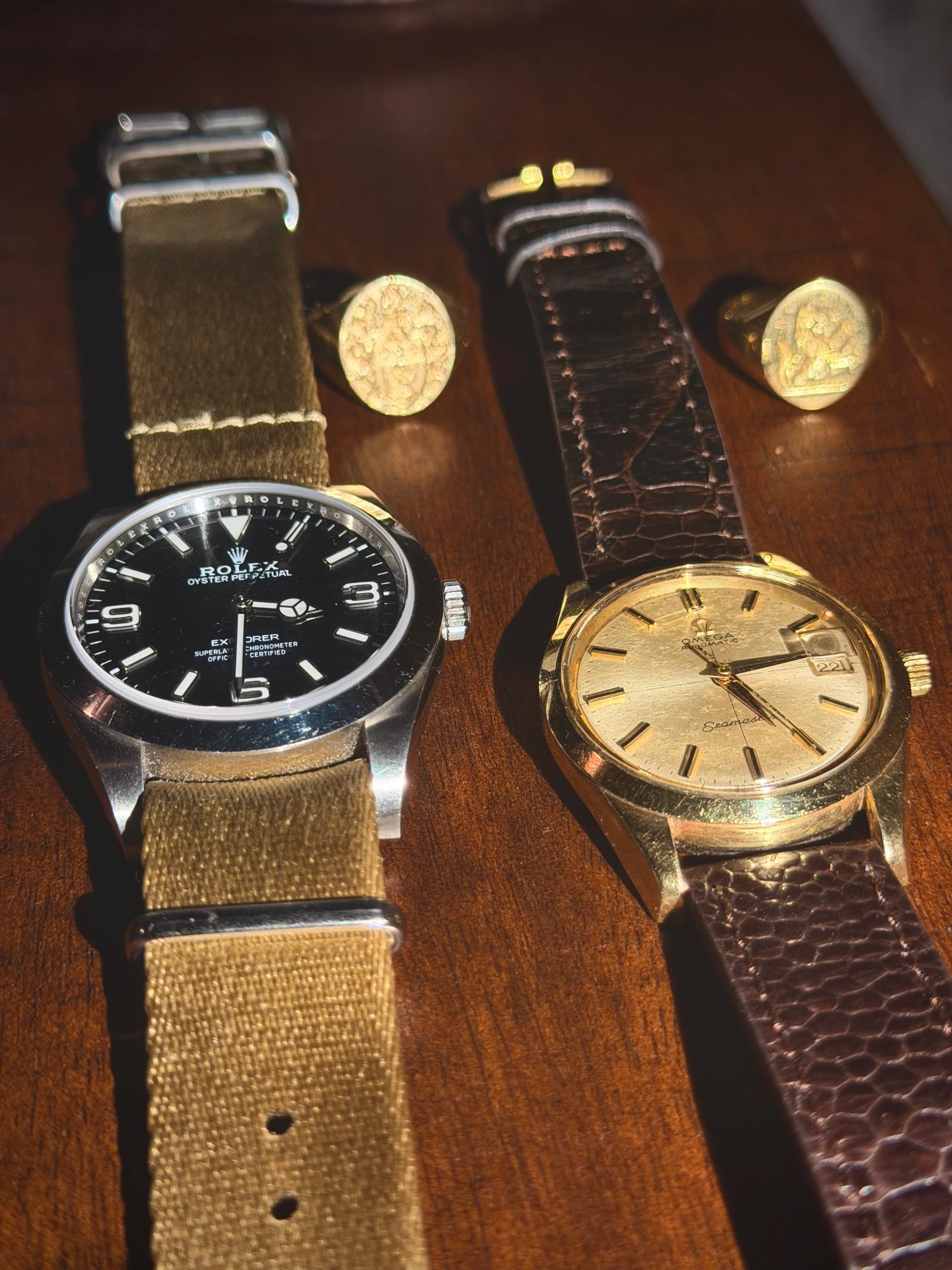

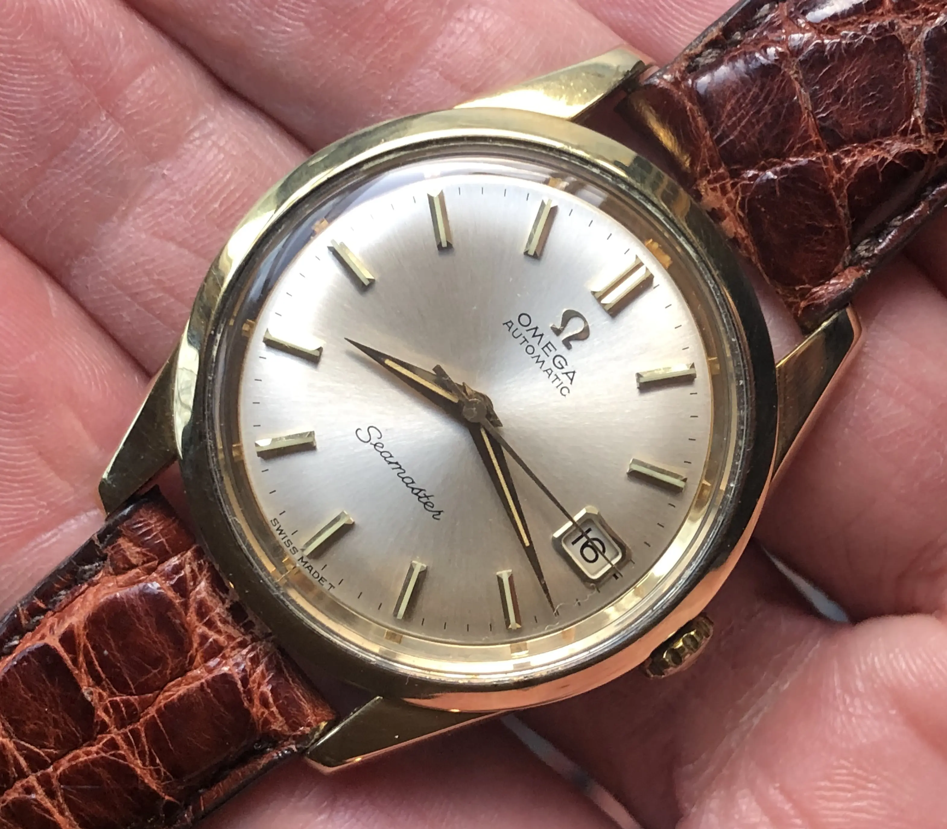

!!!UPDATE!!!!
Well, I have quite the update. I went to my local watchmaker. He happens to be an Omega authorized watchmaker. He has only good reviews online.
He took a look at the watch and said there is no chance the watch was serviced. His words were that the movement has wear, debris, and dried oil everywhere (including the crown area which explains the tension), and it appears as if lots of fresh oil was simply applied on top all the dirt and debris. His assessment was it needs an overhaul and quoted me at $1350. I responded if he can just regulate it a little bit and clean the crown recess, but he said it would not make much difference given the state of the watch. I generally trust his assessment as the shop has a good reputation and has been there for generations.
So I contacted the Chrono24 seller, because again, his listing states a "January 2026 service" and a timegraph report of near chronometer ratings (the seller could not produce the actual documentation of either when requested). In truth, if the listing just said something like "runs well" I'd be fine with my own data. Also in truth, I'd have bought one of the many others on Chrono24 at around 900$ rather than $1500.
In the meantime, does anyone happen to know a watchmaker in the NJ/NY area that might be able to service this for less? Or might perhaps be a bit experimental rather than a full blown overhaul?
What the heck do I do now! Lessons being learned...

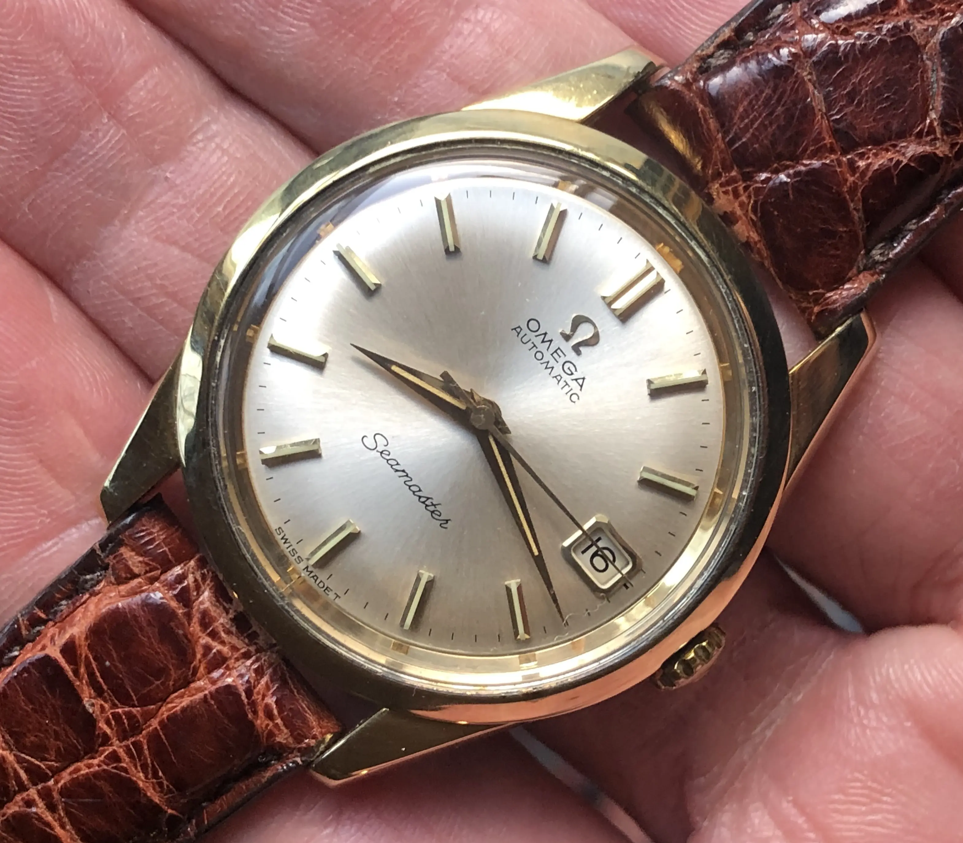

!!!UPDATE!!!!
