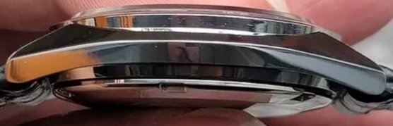

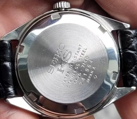

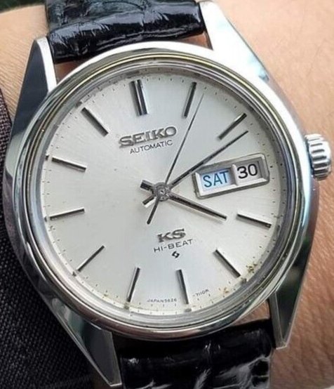

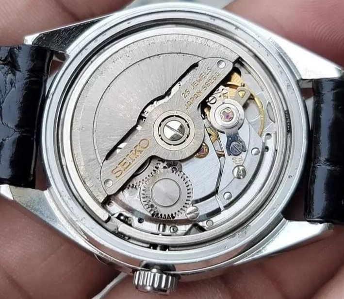

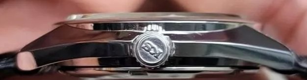

I am looking at a listing for a KS, the case back says 5626-7140, but I can't find any watches with normal dial on that model.
It's obviously overpolished. And it's presumably serviced.
Is this a frankenwatch?
Is just the caseback wrong?

Depends on the price . Definitely has been polished at one point . Maybe they replaced the dial for a better looking one .

Isn’t the model number written on the dial around the 6pm area for these watches?

5626-7140 case back is from a Vanac. Dial looks really like a 5626-7110, but the hands are wrong... 5626-7110 caseback has a medalion and also it should come on a KS metal bracelet.

The listing here is from eBay btw. I bought two minty LMs 5606 with wrong dials from the same seller. Otherwise the cases are shiny, minty, unpolished with nice crystals and they have original metal bracelets.The movements look clean and the gaskets are replaced.
