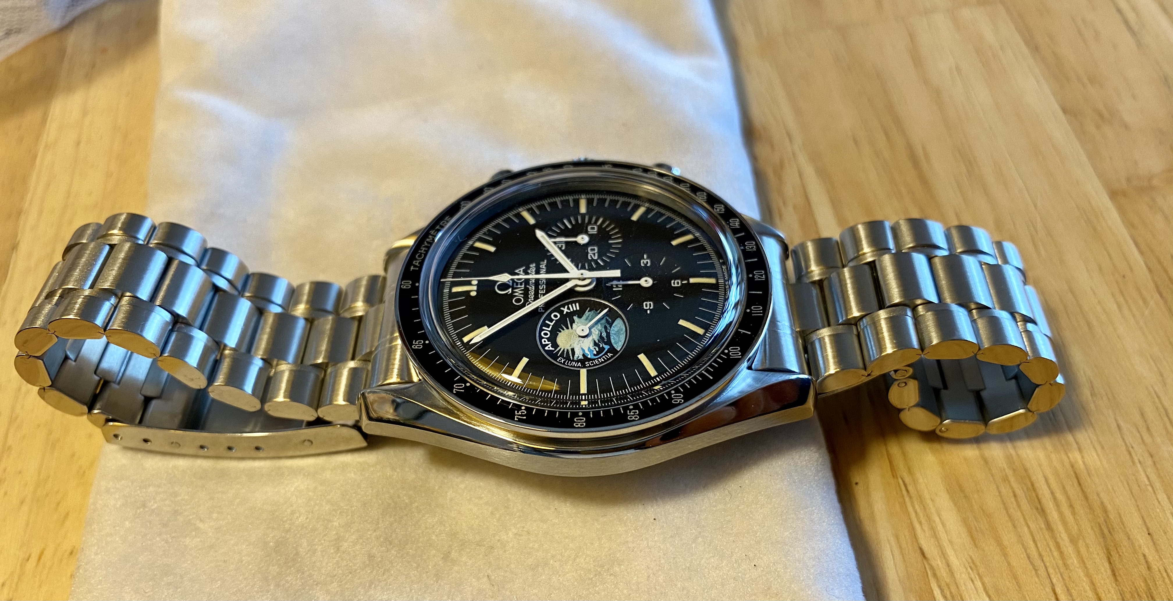

I found a local seller with a 3595.52.00 Apollo XII 25th Anniversary patch. It is completely authentic. Has all the papers/box/ etc. Except there is one thing I noticed. The dial is not tritium and instead of “T Swiss Made T” it just says “Swiss Made”.
My guess is this is a service dial. SO my question is with this watch still being somewhat rare (limited to 999). Is it still a good pick up and how much can the value be effected by this dial?
I see these go for no less than $16k on the grey market, what is a decent price I should offer? 117590580_1_x.jpg

This LE never had a tritium dial IMHO... Too late for that. Switched to luminova.
So to me, the dial could be an original one.

My mistake... Tritium dials exist....
(Thanks @Gefa !)
This was released in 95. There was the missions box set that came out a few years later... You think maybe the dial came from there?

In terms of wearability, for the small amount of lume a Speedmaster supplies, Luminova is much preferred over tritium.
Whether that matters to you in terms of collectability, only you can say.

The Apollo patch is cool, but not interesting enough to me at that price point. And if I was spending that money, I would want a nice tritium with dark yellow indices like I have seen on other ones.

Checked mine which has beautiful patina and the dial sports “T Swiss Made T”. Spent few seconds on Google and saw T Swiss Made T dials only. Not sure if Swiss Made dials were ever mounted as new or if it’s service dial only.

This watch came with both tritium and luminova dials. Like I said if I were getting one, I would want a tritium.

Didn’t know that. Thanks!
