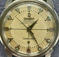

A short while ago I got a 1959 Constellation PiePan arrowhead knowing that it'd need to be serviced, although it auto-winds, runs, is settable, etc. The watch repairer I used to go to pre-Covid times didn't do a good job a couple of times, so I took it to another place. When he called earlier today to tell me his estimate I wasn't able to jot down everything that needed to be done, but as I recall, a couple of parts (definitely the crystal, but OFrei didn't have one for a case 14381) in addition to a very full service.
His estimate was almost $800, which is about double what I was hoping/expecting.
My question is: What's a good guess on it's value if repaired? That way I can figure out if it's worth spending the money on fixing it.
Another friendly AD had previously said that sending it Omega would start at $875 (which might not have even included any parts), and he guessed it might only be worth around $1000. He said he wouldn't repair it unless it had sentimental value ... which it doesn't (other than a vintage piepan Connie is a great looking watch!).
Thanks for any quick thoughts...

In short don't do it. It's a redial and likely worth less than any of the quotes you have been given. Don't throw good money after bad.

Bad news, I'm afraid - definitely a redial and while I don't want to be too blunt I gotta admit it's a rather bad one...
I'll +1 @padders recommendation, dont invest any more money in it. Many people here (including me) will tell you that it's value is basically what the usable parts are worth. I cannot really see how the case is, if the crown is correct etc. but let's say it's 500$ at best if the movement looks good (even though it needs a service). That's not to say someone who doesnt know better might pay more in an eBay auction, but it'll be a stretch.
Note that even at Omega, they wont replace the dial with a factory-finish one but will just redial it once more, and it'll still be very apparent. You'll likely be investing 1k+ to have a watch that's probably worth less than the service cost. Wear it as-is or sell it to recoup some money and look for a good example. It's a relatively common ref and they're still comparably affordable (if looked at vs. dogleg or the 50s examples).

Too bad about the dial as the lumed arrowhead variant (if original) is quite rare.

Wow! I had no idea it might have been a re-dial! Thanks... That sure is a deciding factor.
So that I can learn an expensive lesson, what's the major "giveaway" of it being a redial from that small picture. (and I've gotta ask... any chance that it's NOT a redial?)
And, to @MtV - the crown seems original (correct shape, with logo), case seemed ok too... but then I evidently got suckered by the dial.

Besides the far too thick and sloppy printing, cross hairs are supposed to go through the text. Overall quality is very bad / uneven. Zero chance it’s not a redial I’m afraid…
If you Google "omega 14381 arrowhead 1959" and you look for examples on OF you will immediately see the difference with your 14381. The text on your dial is sloppy with thick font. The genuine dials are elegant and subtle. Thin font, etc. Some examples here:
Thanks... I found one quickly on watchrecon and looked at it and immediately saw what y'all were talking about... Wish I had done all of this months ago when I bought this watch (medical stuff got in my way to get it serviced, plus I'm trying to find a replacement watch-repair person in the SFO area).
