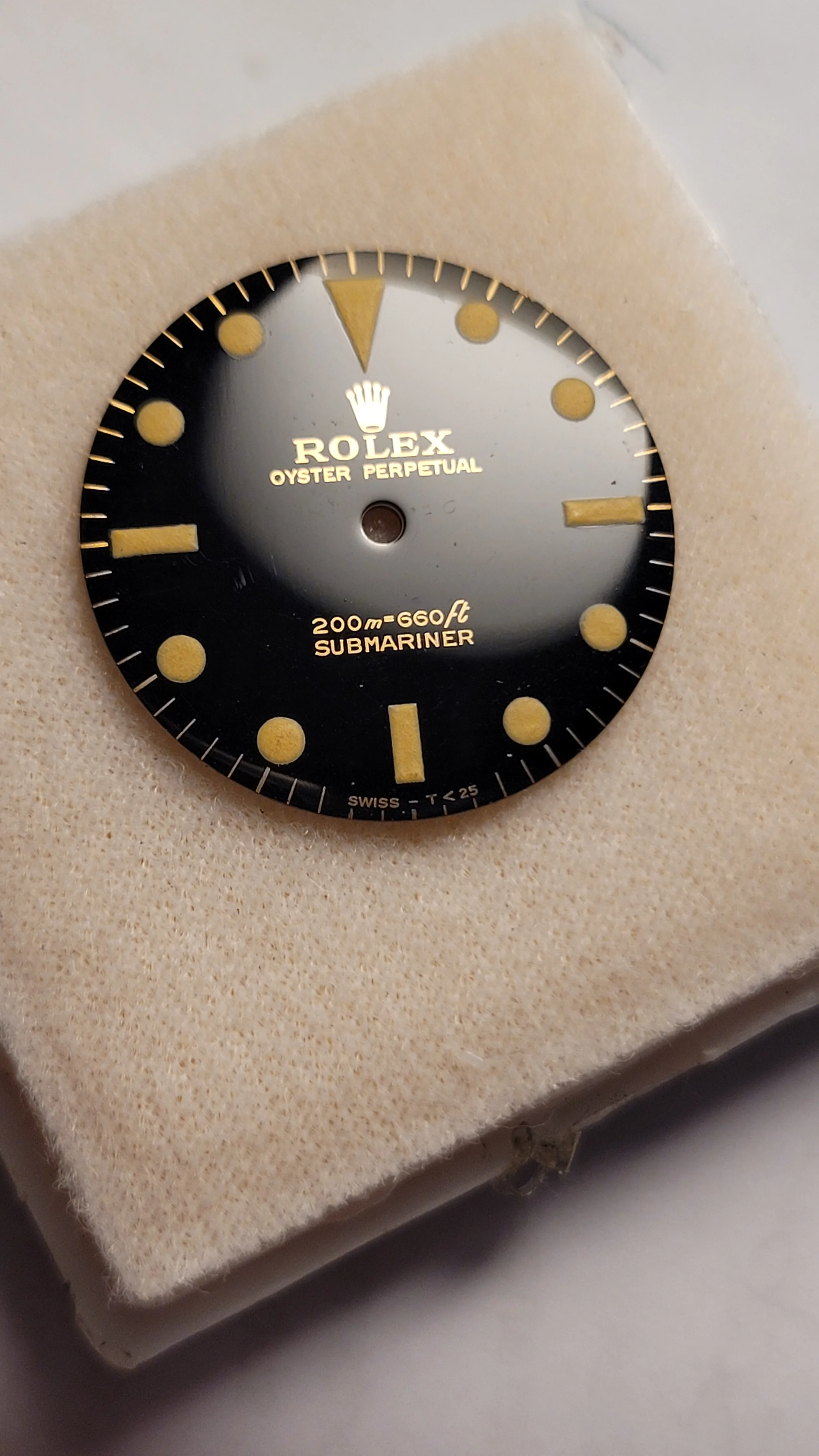

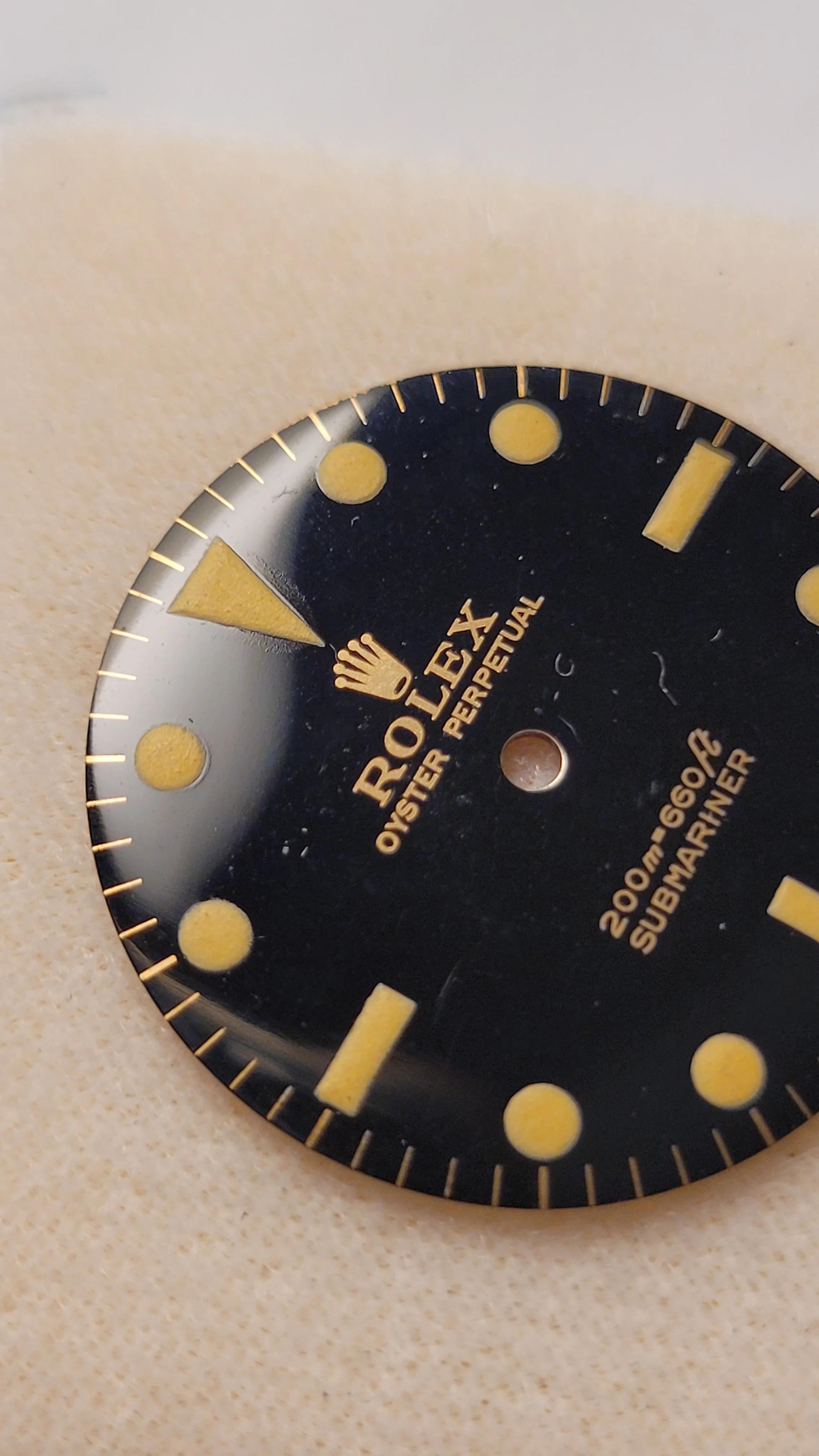

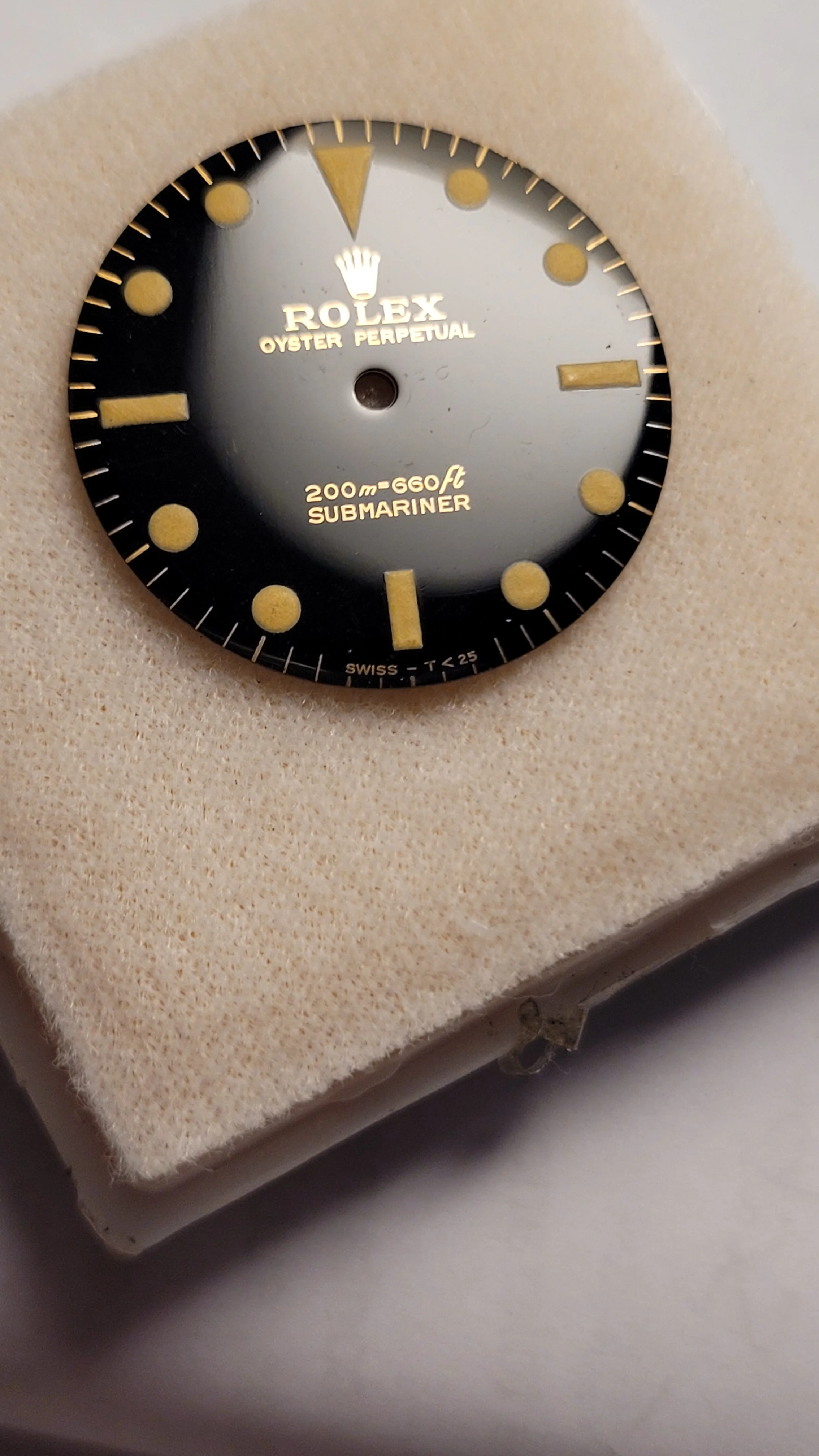

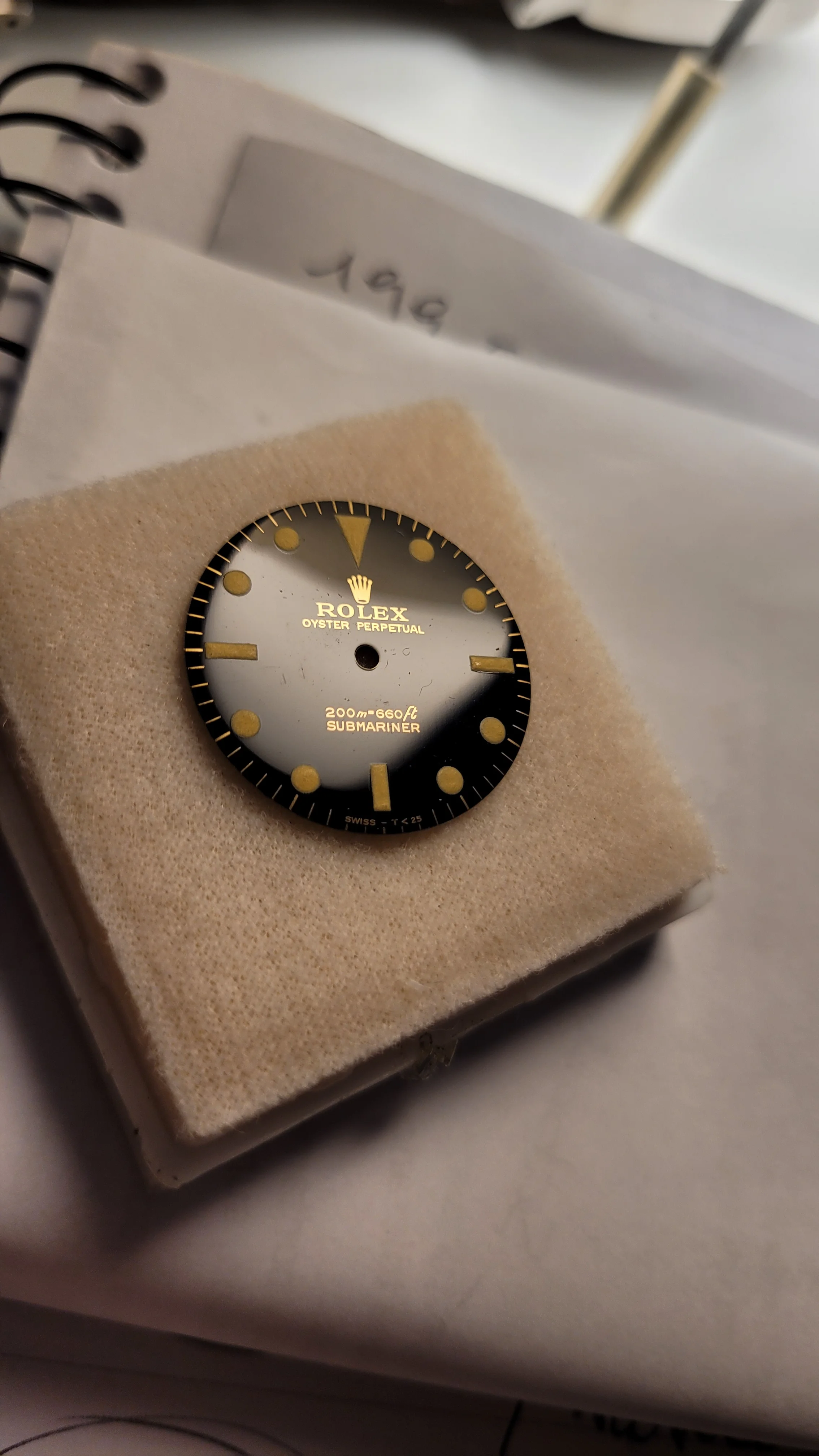

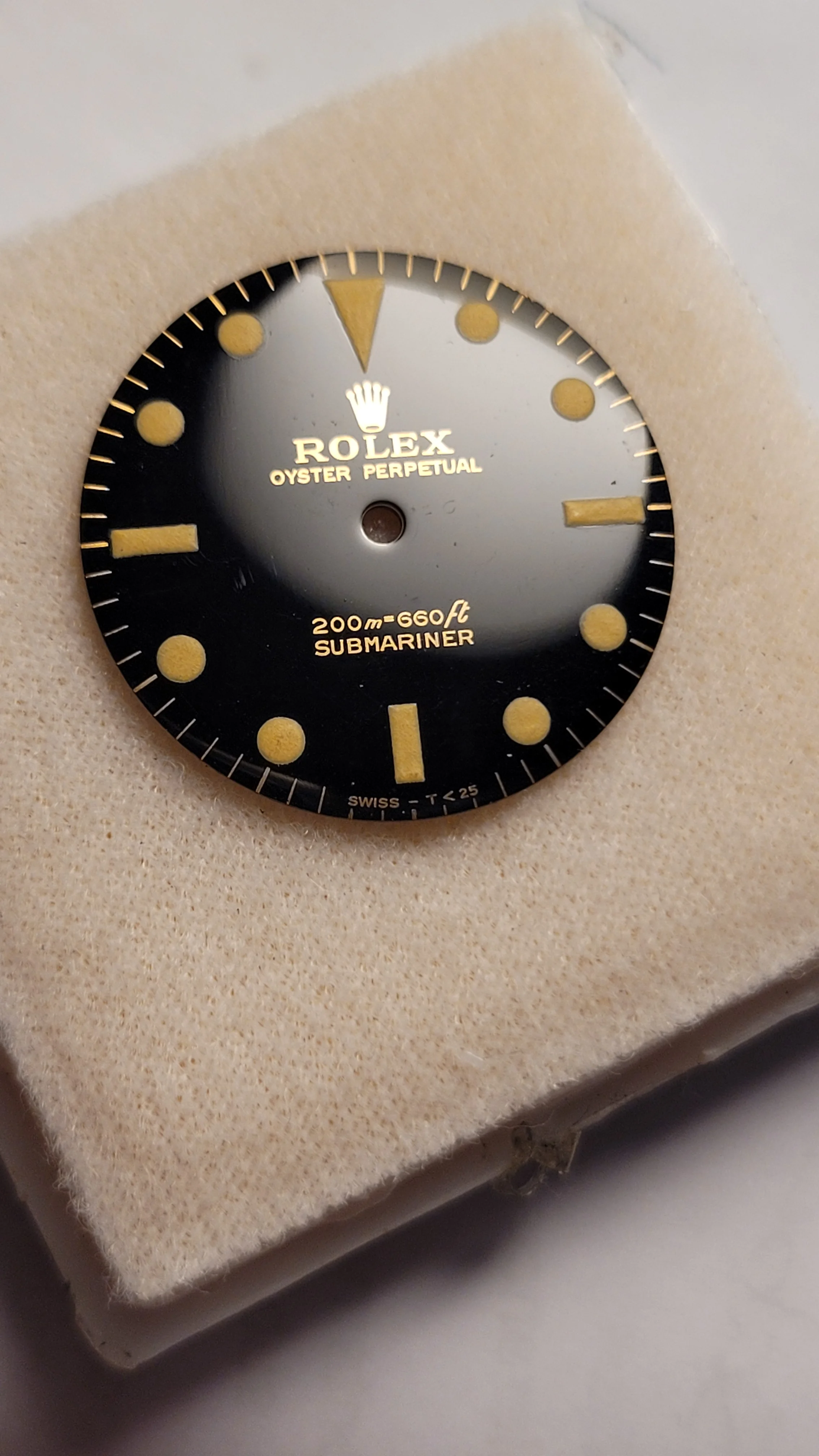

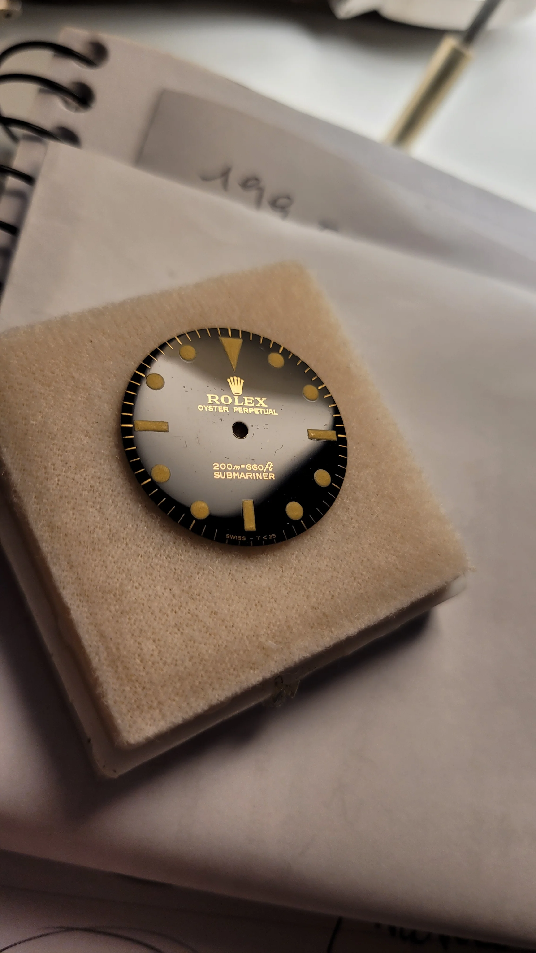

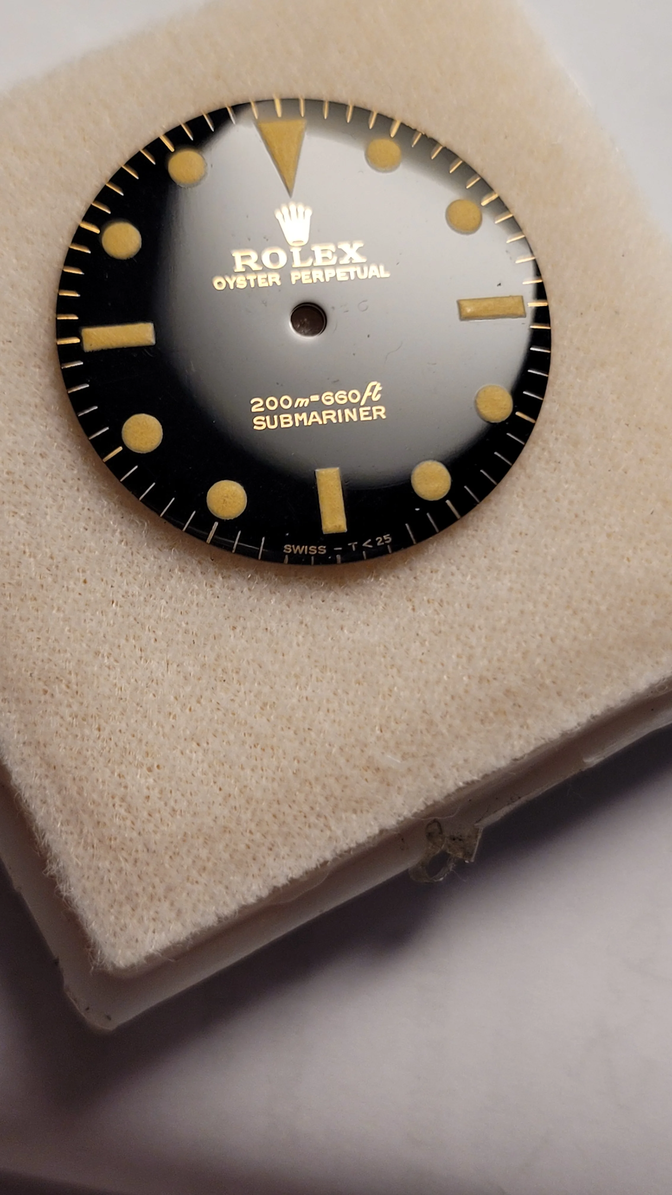

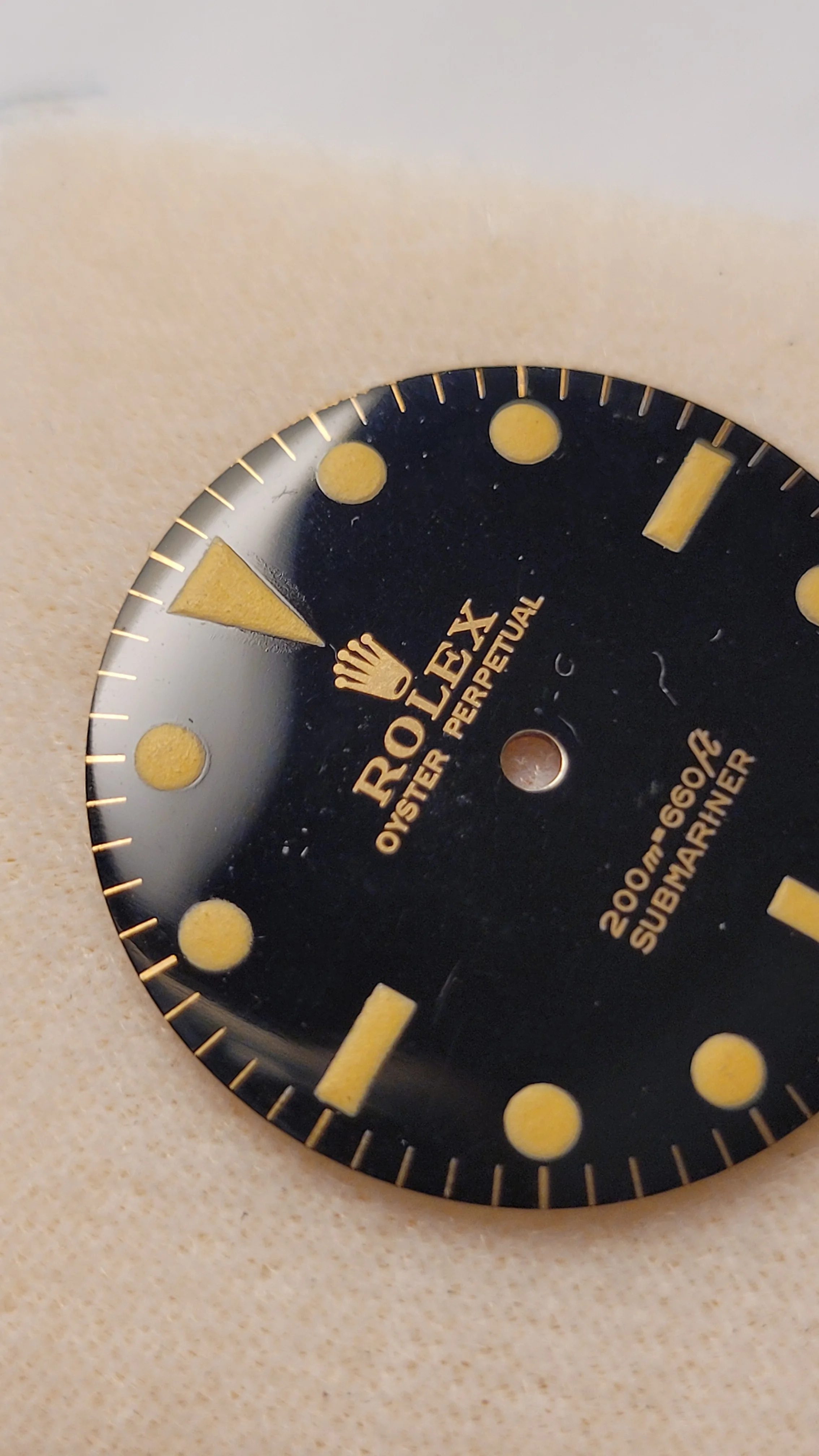

Hi, please, I would appreciate your opinion on this dial it was offered to me some time ago and as not convinced if original, I let it go. What do yu think? Was I right or wrong?
Many thanks in advancce

I think you were right. Text looks too thick compared to real ones I have seen.

Thank you, Donn, have my doubts too, specially the S of submariner- Regards
8
repainted
Yep, look like repainted to me but were not sure. Appreciate your opinion. Tegards

he dial does look very suspect and would warrant a lot more forensic analysis.

Thank you Hert3, just to keep learning, what do you see as most suspect on the dial? colour markers, glossy, fonts? Thank you

As I understand, in an original gilt dial the gold lettering and markers are etched into the black dial, they are not painted on at all, instead it’s the underlying plate shining through. So if you look at the dial at an angle under some magnification the letters appear sunken in a bit.

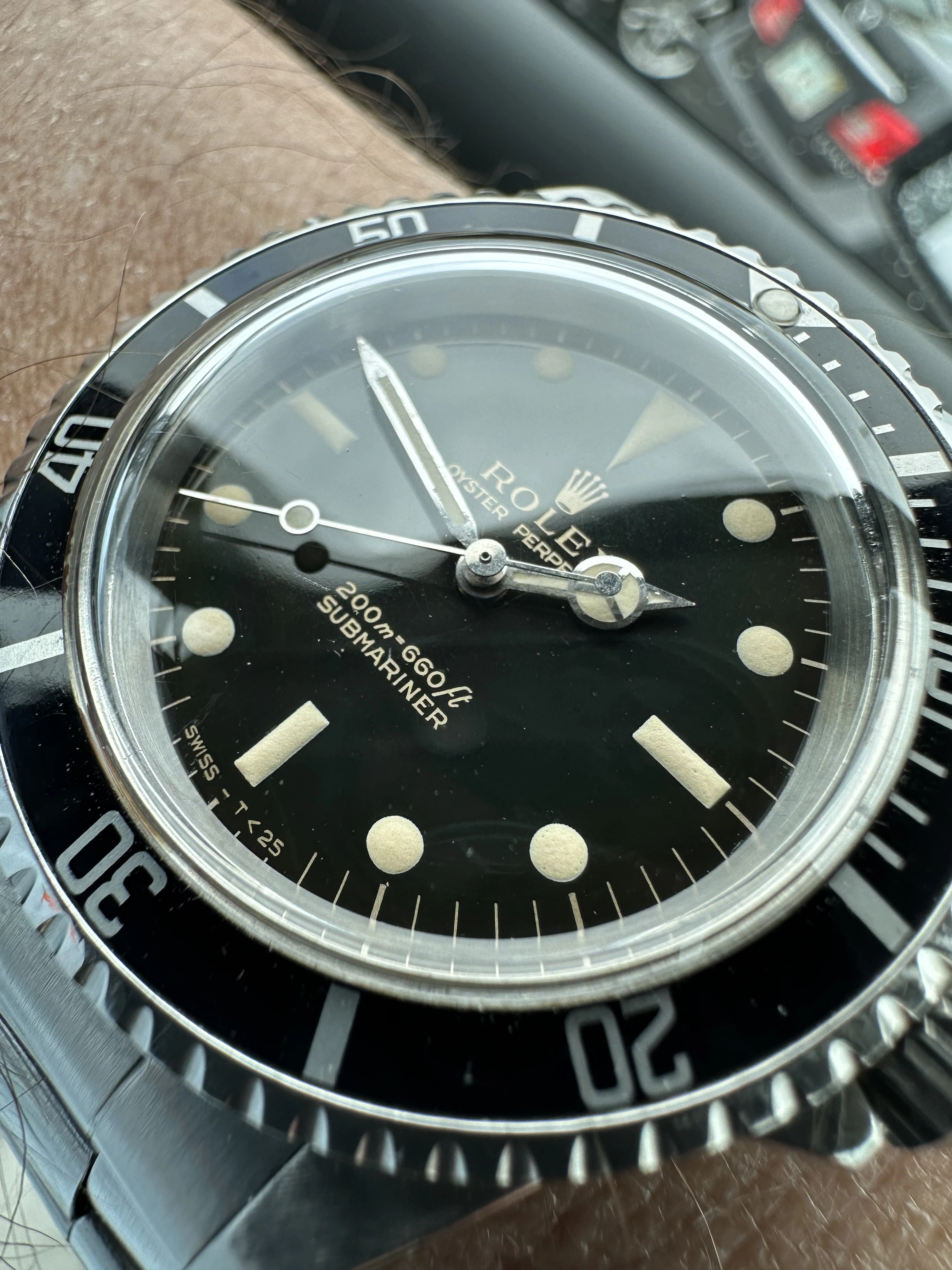

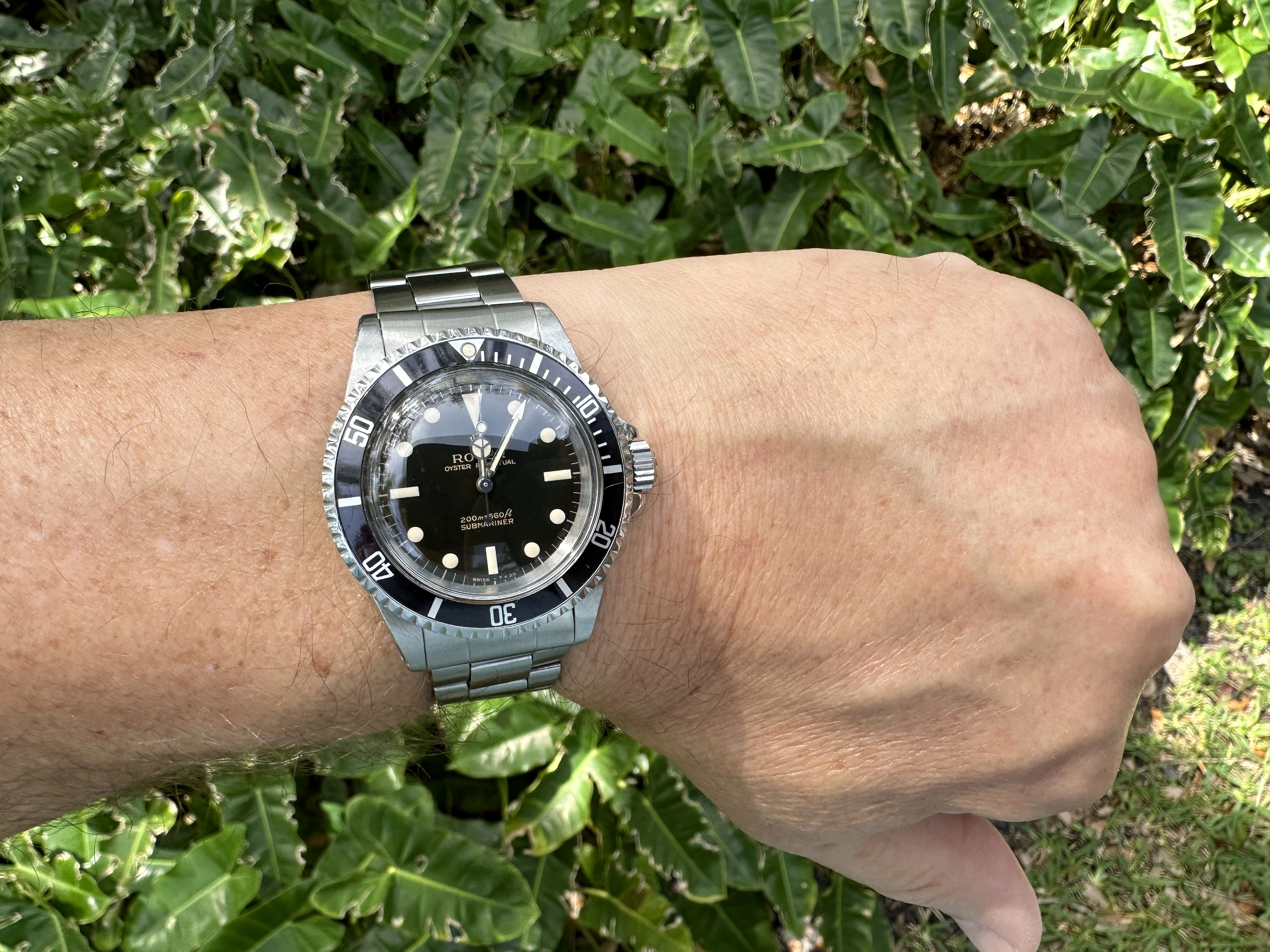

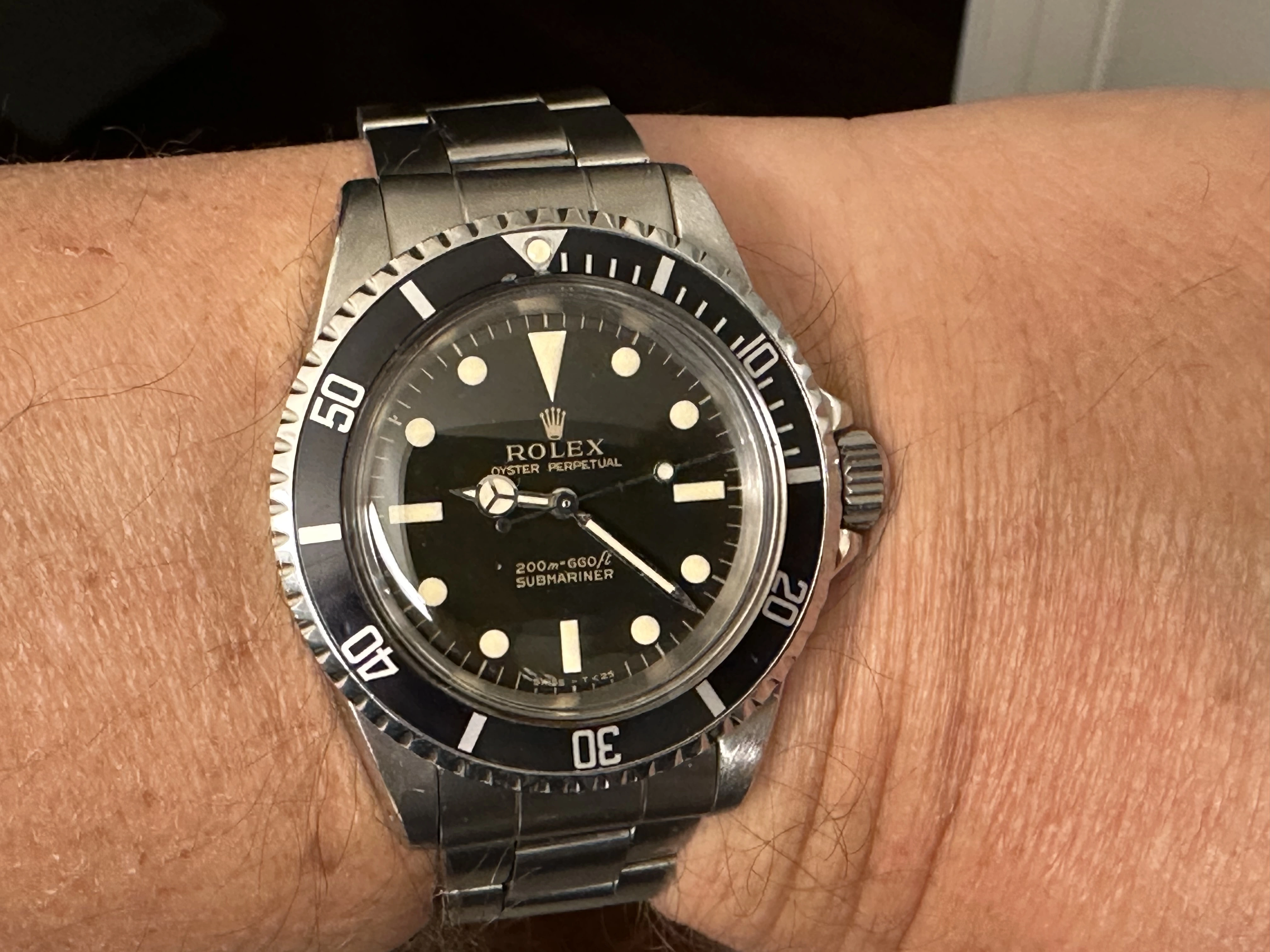

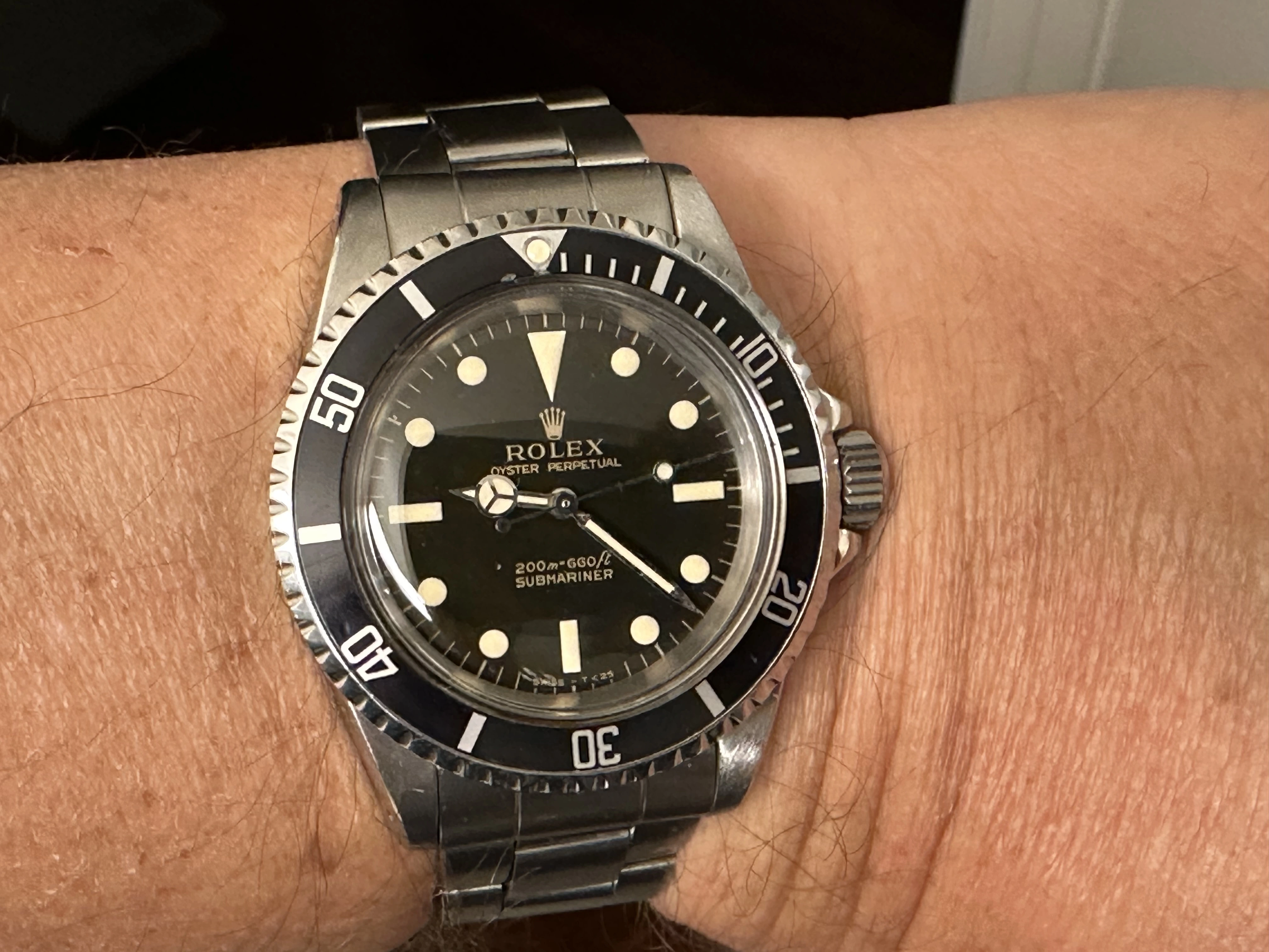

My gilt dial was totally damaged and it was a family heirloom. So I had my watchmaker send it to a specialist in London that replicates the original Rolex process. Very expensive and probably has a negative NPV as most all collectors will hate the watch, but it looks like NOS.
exactly this.
have a look at this page: https://awco.nl/gilt-dials/
the dial you showed doesn't look right.

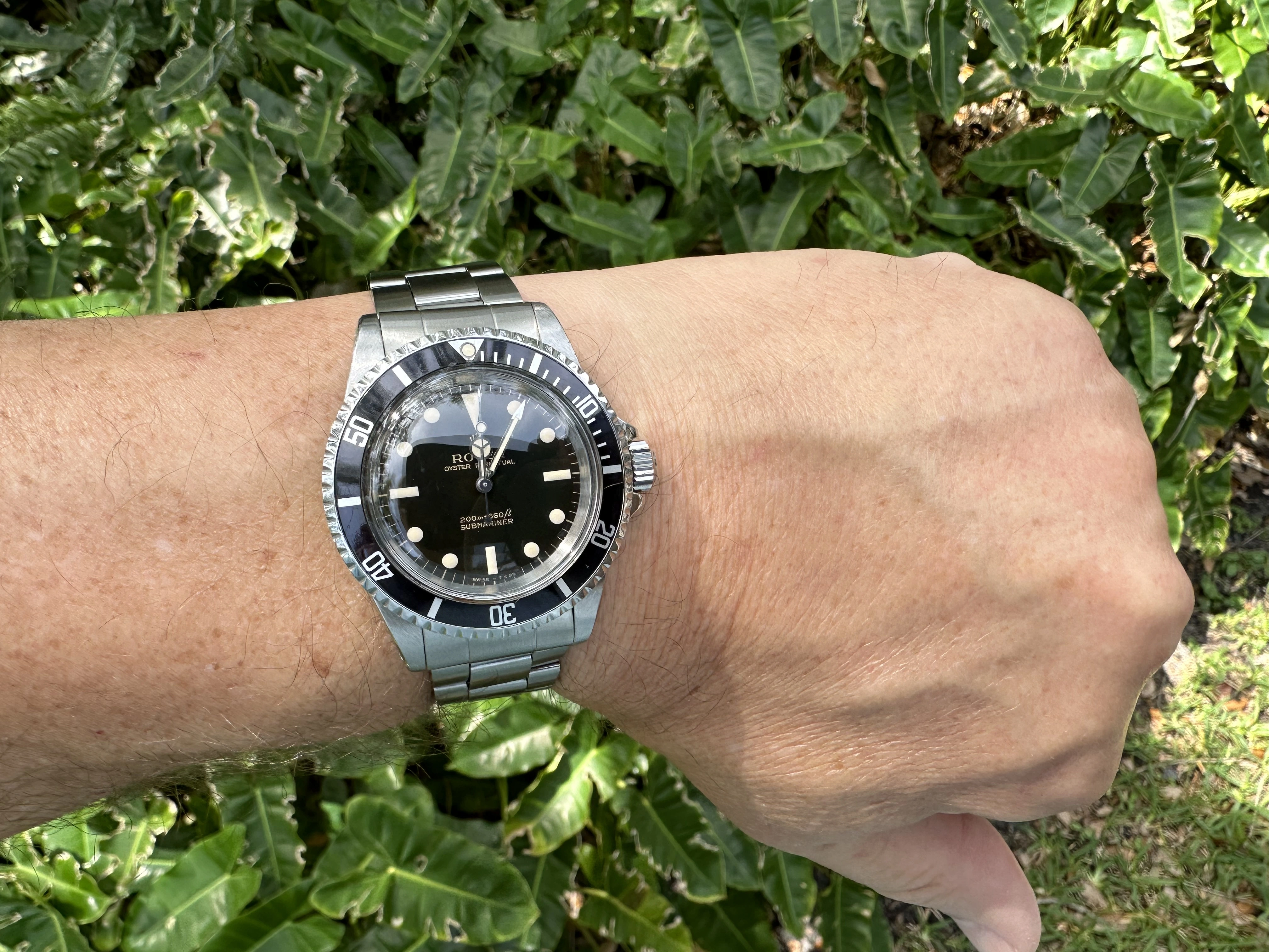

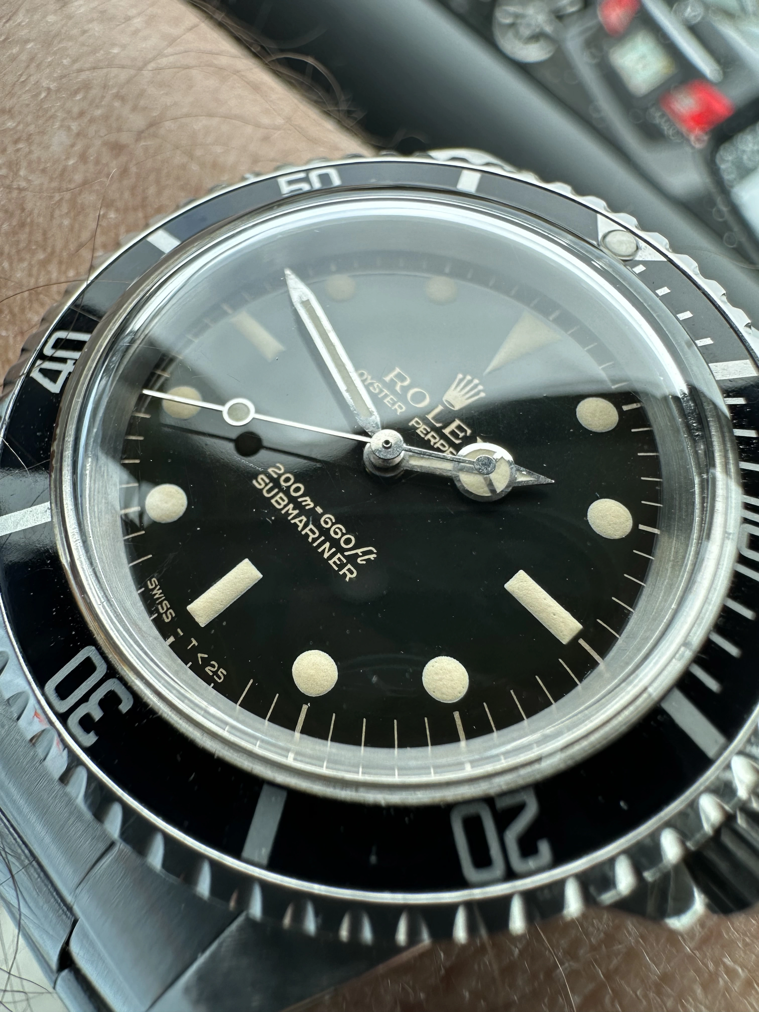

Great explanation of the gilt process. Thanks for sharing. What looks off to you? There were several variations of the 5512/13 gilt dial. Mine is from 1966, classic coronet.

sorry, misunderstanding. I meant the dial posted by the OP. to me the text looks raised (i.e. printed).
no worries about yours!
Thank yo so much for you clear and definition "...in an original gilt dial the gold lettering and markers are etched into the black dial, they are not painted on at all, instead it’s the underlying plate shining through. So if you look at the dial at an angle under some magnification the letters appear sunken in a bit." Many thanks again. Kind regards
Looks great, mind sharing the details of the artisan that did the work?
My 5513 was serviced by Rik Dietel www.timecareinc.com. He’s great on all things Rolex. Rik sends the dials to a specialist in London. I don’t believe he’s sharing publicly who this is.
