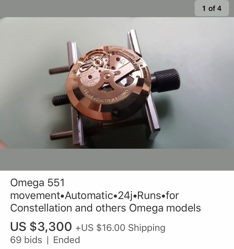

Curious what folks think of this: Dead Link/rover/0/0/0?mpre=https://www.ebay.com/ulk/itm/333000122106

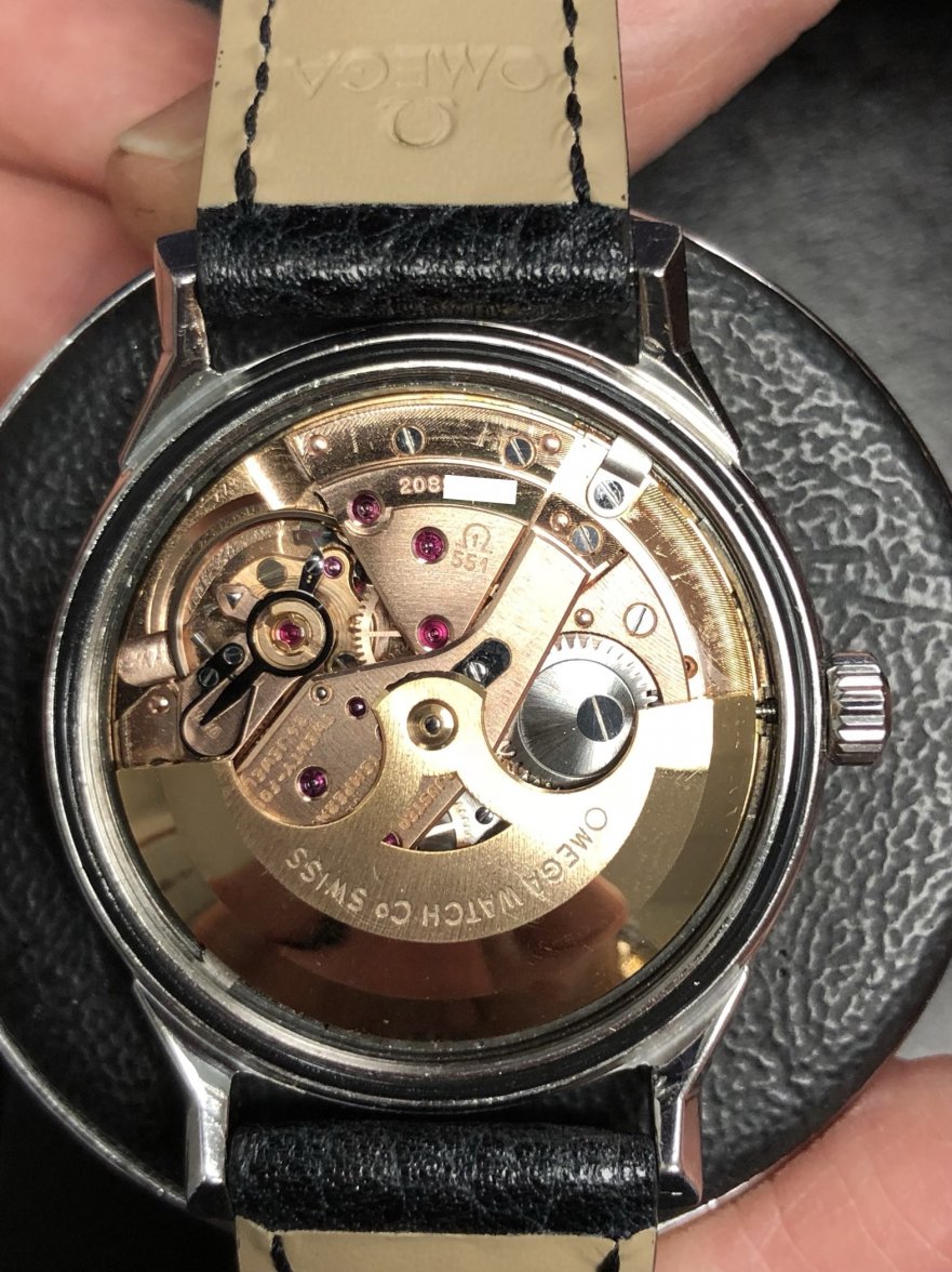

And here’s a pic of what’s currently inside - which I’d like to see keep ticking for a long, long time! (NB: please ignore the incorrect service crown. This photo was from before I got that changed out; it was right after I finished getting the movement serviced last June so I could wear it at my wedding this past November.)
Worth having a backup movement for it?

One thing I should mention here is the serial # of the one you are considering to buy. It has 17 mil serial # stamped on it and only good for earlier case ref like 14381. If you swap the whole thing into your watch, serious collectors will frown on you.

Yes, I should have perhaps mentioned that a parts watch is good for everything except the train bridge, which contains serial and calibre number. If that was a problem, re-jewelling would be the only option, in my opinion, if the integrity of the watch was to be maintained.

Looks like it didn’t actually sell for that. It’s since been re-listed.
