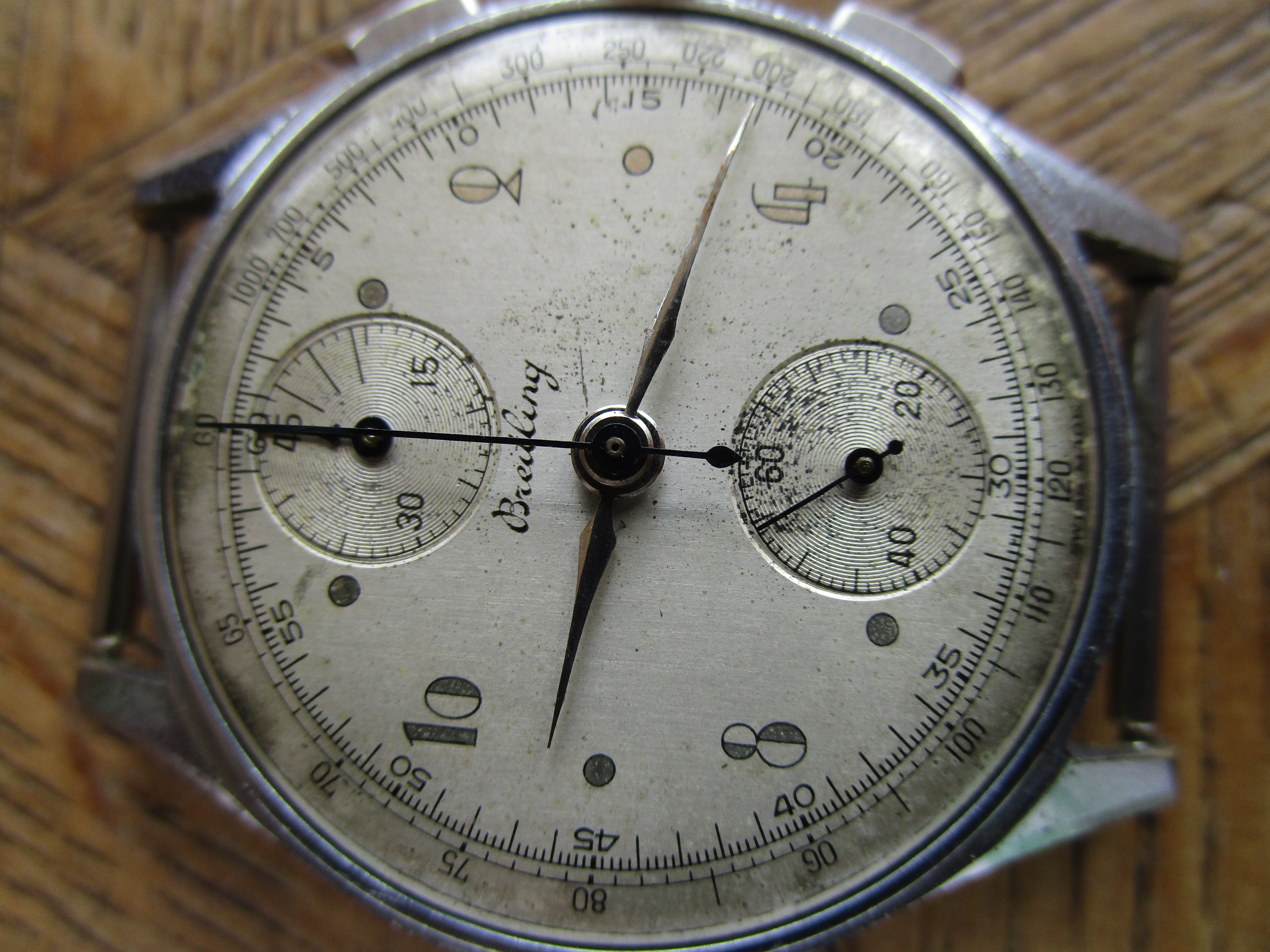

I'm considering the purchase of this 40's vintage Breitling chronograph. The I don't really mind the dial and case condition, but I'm not sure what to think about the movement. I've come to understand that an unsigned movement is not out of the ordinary for Breitling for this era.
My question is on the overall condition of the movement. My plan would be to wear it maybe once a week or so. I'm wondering if it would tolerate that type of use?

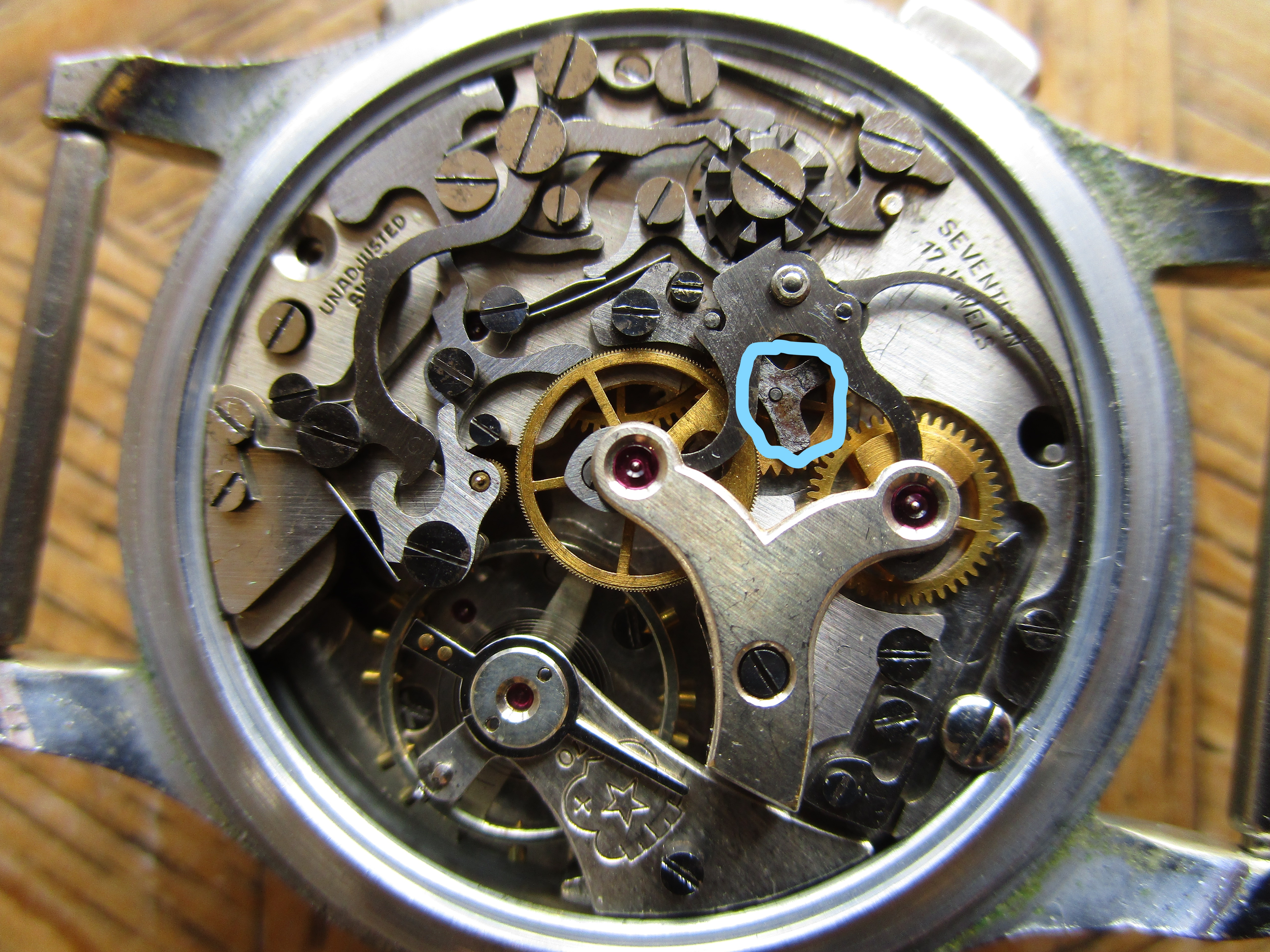

This is the area that caught my attention. Seems to be corrosion?

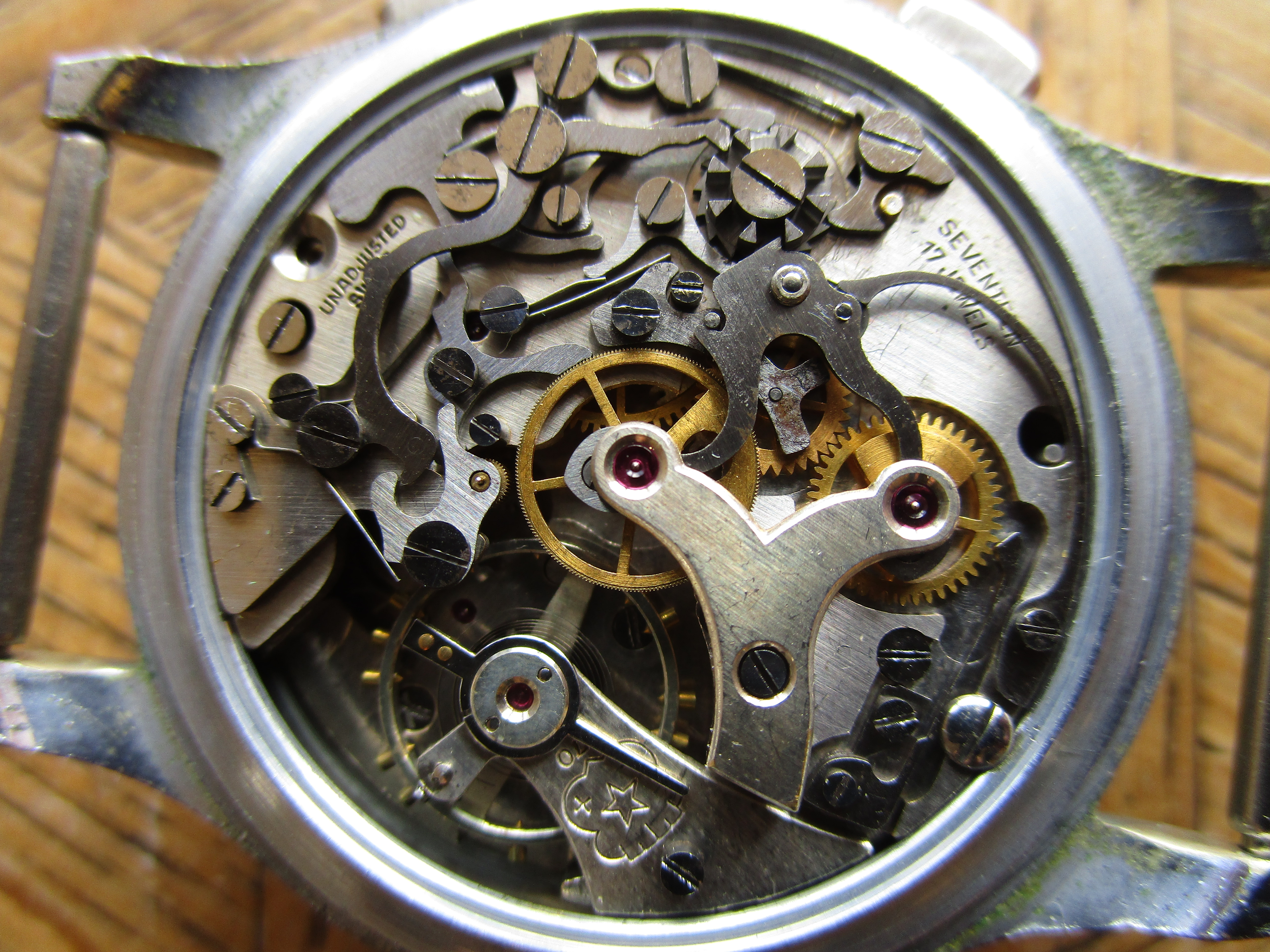

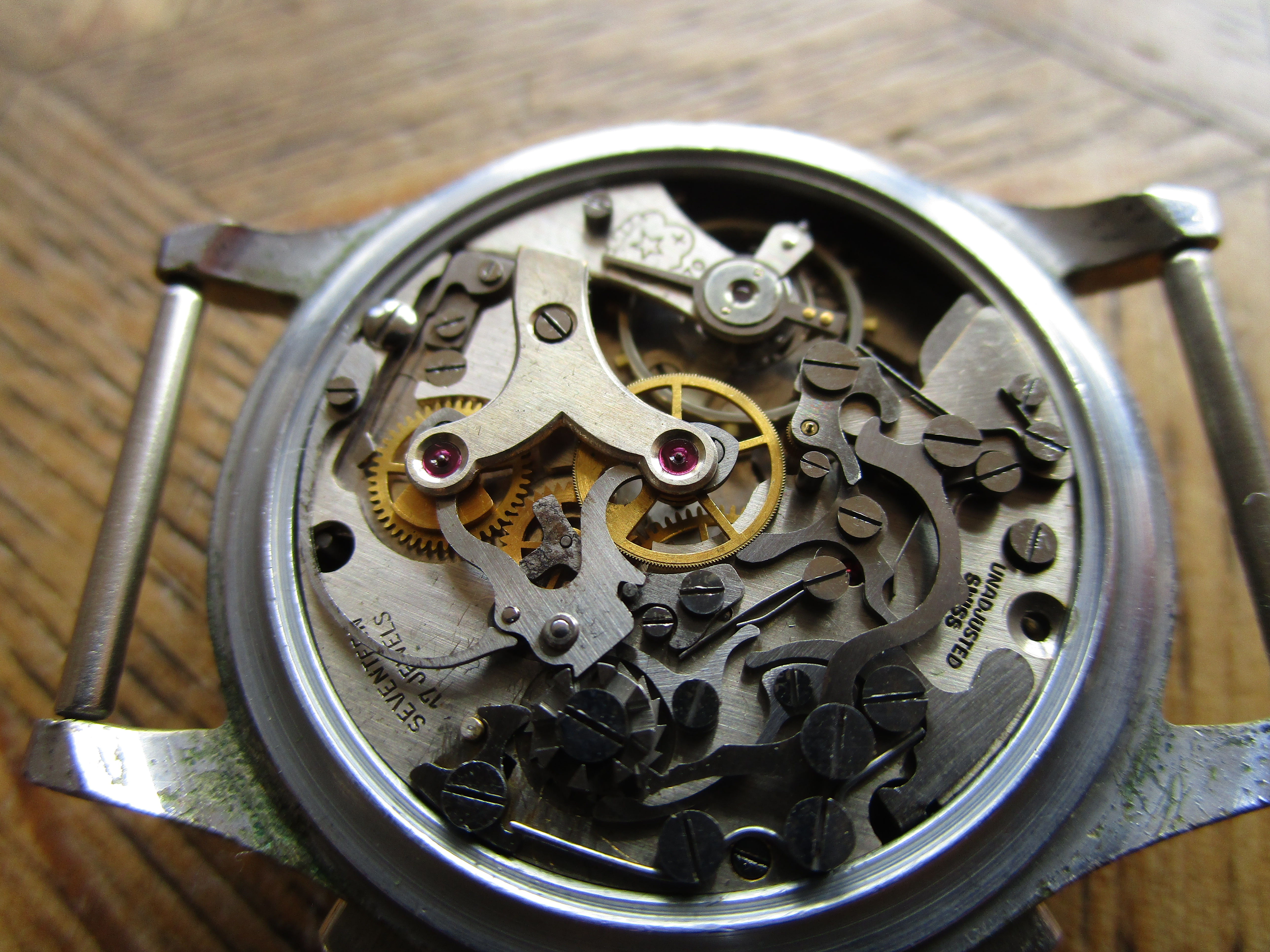

A bit of superficial corrosion on a part isn't necessarily a problem, but it's really not possible to judge the condition based on a few photos. Old watches often have issues and may have been tampered with over the years; this will become apparent once it is completely disassembled. You will have to take your chances and hope for the best. A good experienced watchmaker is a great asset for watches like this since parts are not always easy to find. There's no reason that you can't wear a 1940s chronograph as part of a regular rotation, many of us do it. But they can require some TLC, and it's also good if you can tolerate less-than-perfect timekeeping and some quirks. Sometimes you get lucky, but sometimes you don't. I've bought some old chronographs that only needed a service, and others that became money pits.

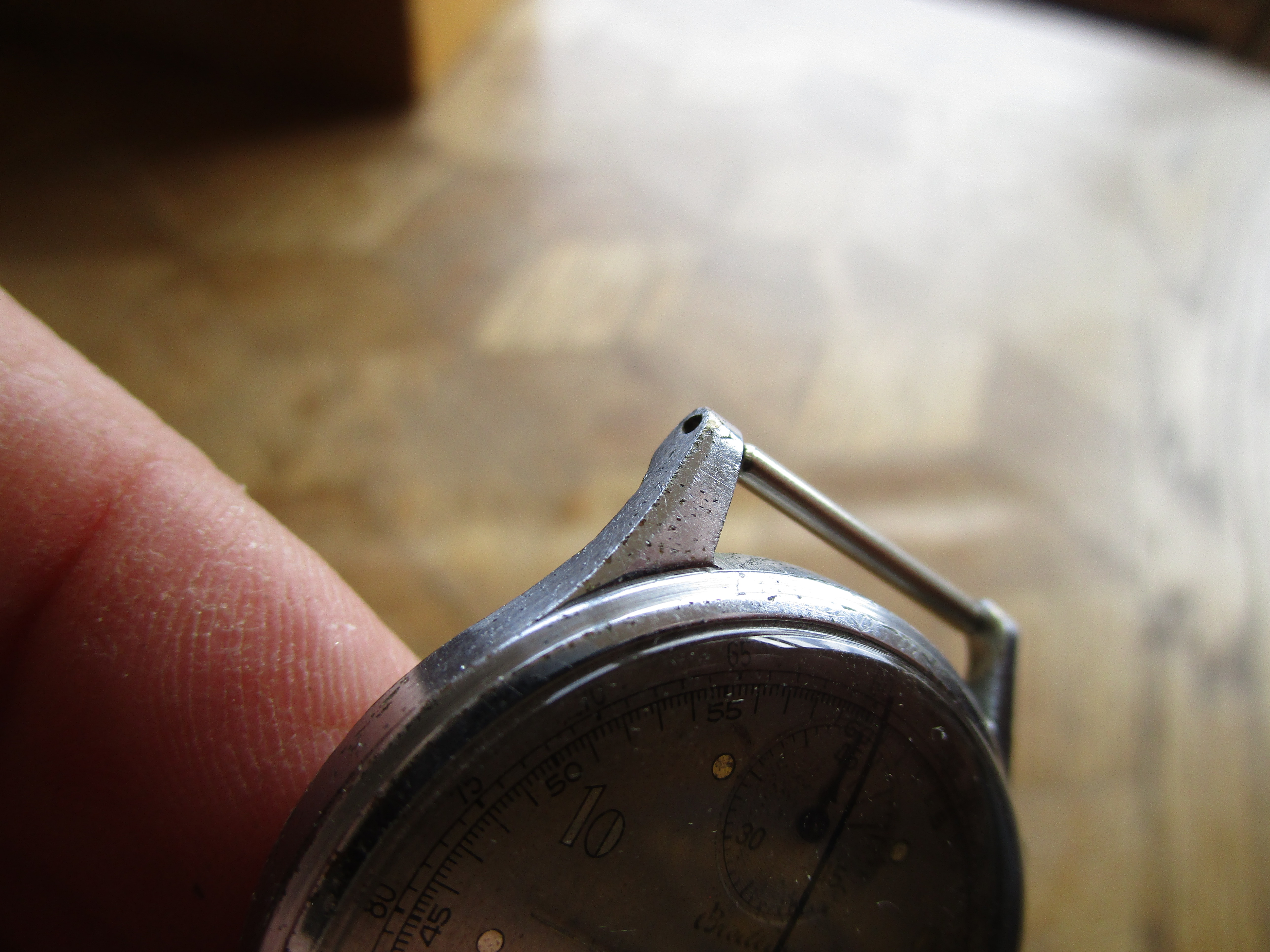

Personally I don't generally like to invest my time and money into watches in plated cases and with damaged dials since repair costs can add up quickly and I prefer to have more upside and a watch that will really give me joy. A full service and a few parts, and the amount you pay your watchmaker will exceed the value of the watch, and you will still have a watch with brassing and damaged dial. But if you like it, go ahead. Good luck.

- Venus 170s have often developed a loose cannon pinion problem, sometimes it can be corrected, sometimes not. New parts availability is of course problematic for 70 years old movements.
- Plated cases : meh. Avoid, they only look good when new from the factory.
- Those square pusher chronos have zero WR: keep it in mind when wearing it, and that is why so many dials are damaged.
I would rather have a better watch (case and movement) for the same price than an old venus 170 labelled breitling. You pay for the name only, there is no step up in quality from any other generic plated case watch. At least try to find a steel one imho.
