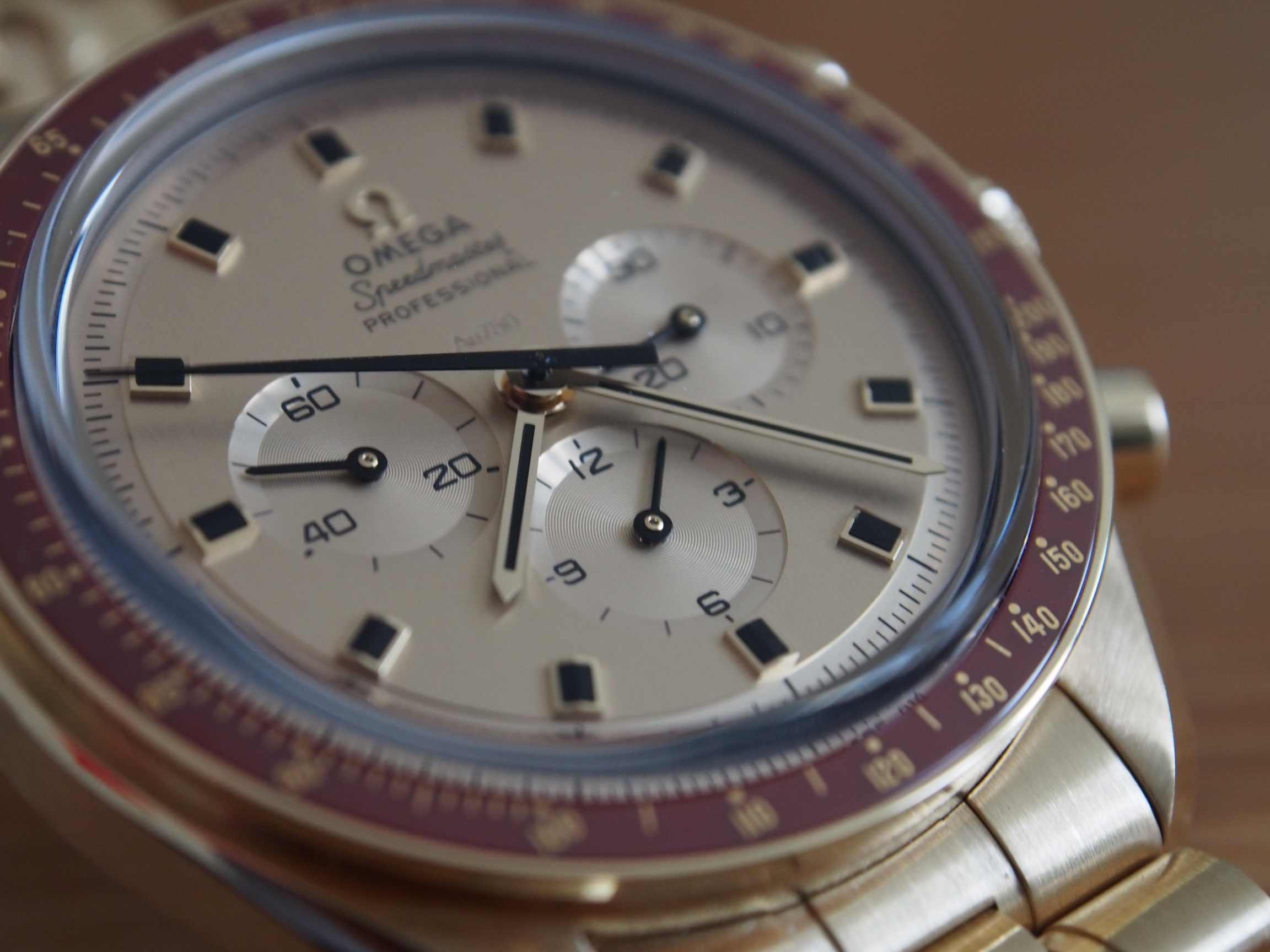

Update on my watch. Picked it up from Omega Boutique in London this afternoon. Fabulous service. It’s only when something goes wrong that you can really judge how much they care for you as a customer. First rate service and very happy. Took 4-5 weeks in total. Put it on a distressed leather strap and looks fab.
Edited to add better picture
