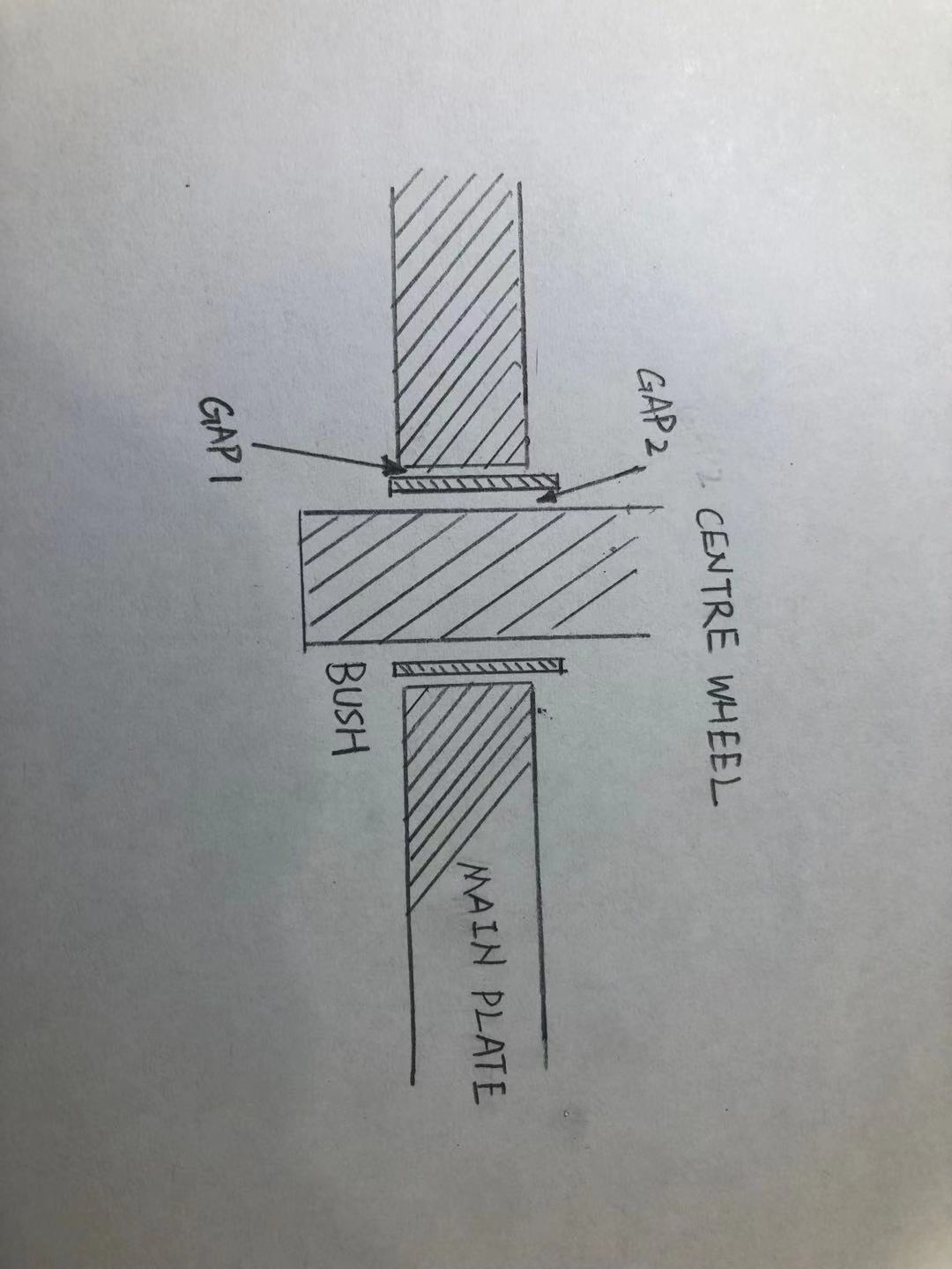

You can refuse to answer, I just want to understand this question out of curiosity.
As shown in the figure, which one causing the problem? gap2 or gap1? In my understanding, bush should protect the centre wheel from direct contact with the main plate, so the main plate and bush do not move relative to each other.
There is no "gap 1" as the bushing is press fitted into the main plate and another into the barrel bridge. The bushing is of coruse fixed in palce and doesn't rotate.
Also, the way you have shown contact is not quite right. In addition to the contact with the circumference of the center wheel shaft, there is also a face (thrust) contact between the center wheel and the bushing.
