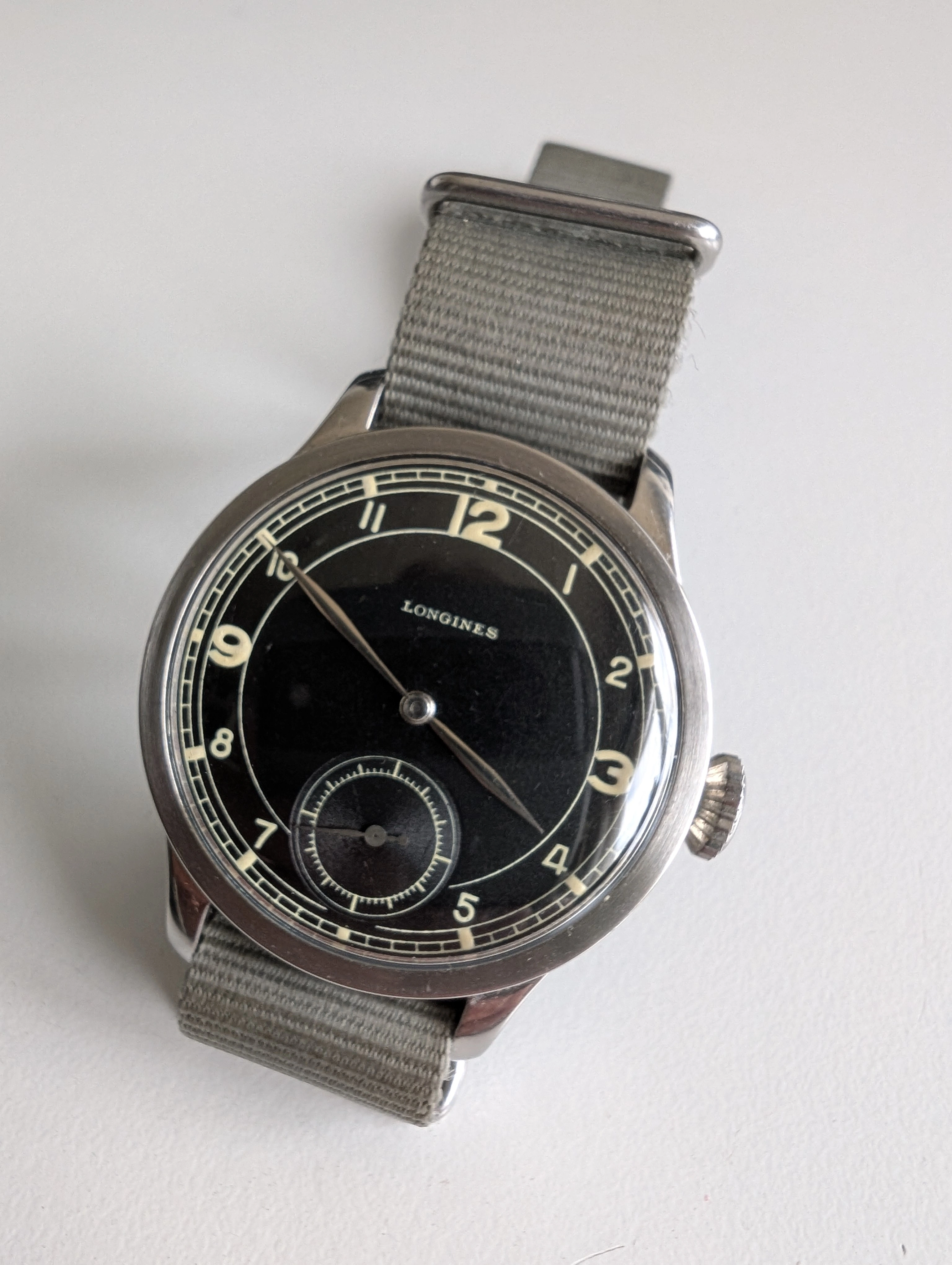

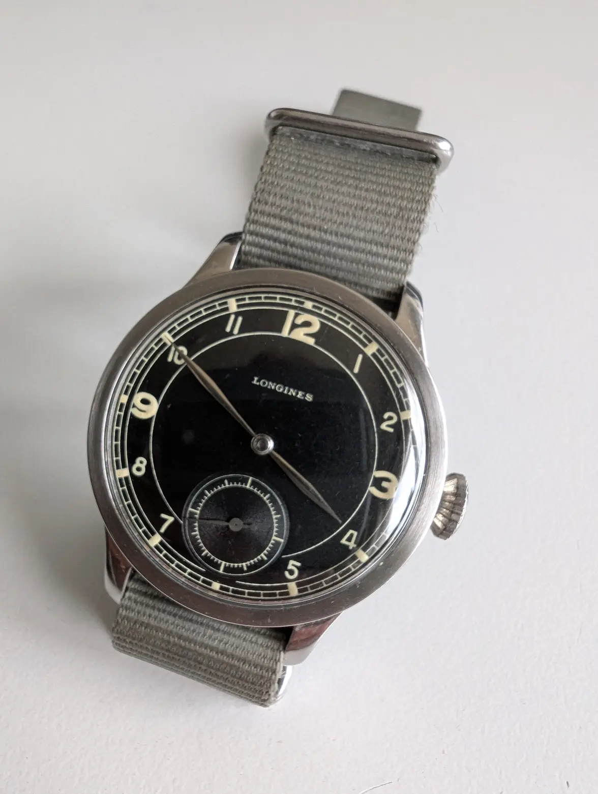

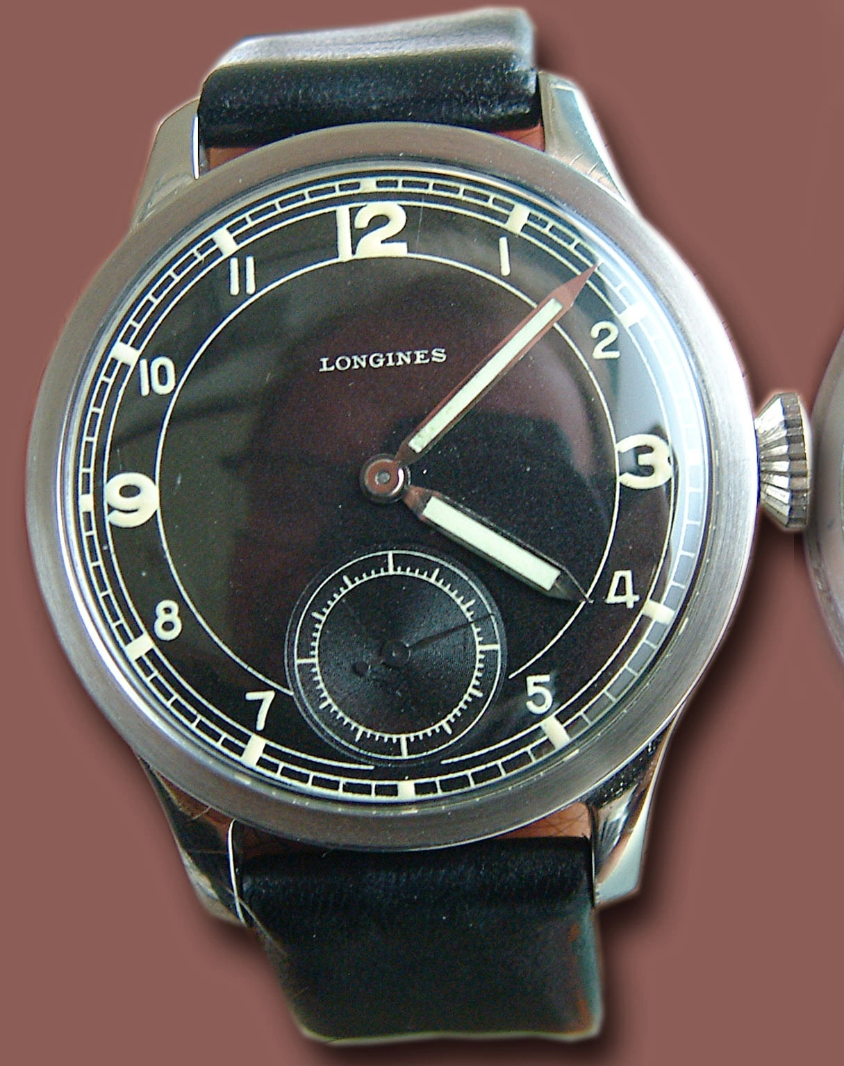

Bit out of my league so hope someone can help. Somebody offered me this Longines. Movement is a 15.26 with 5.6m serial. Diameter 37mm. Caseback is not marked Longines but that may be correct as far as I can see. Serial in caseback is same as on movement. According to the seller watch was serviced at the factory about a decade ago. Something was done with the hands. Dial was not touched. However: IMHO the logo seems correct but I assume the dial is at least relumed. Curious about your opinions.

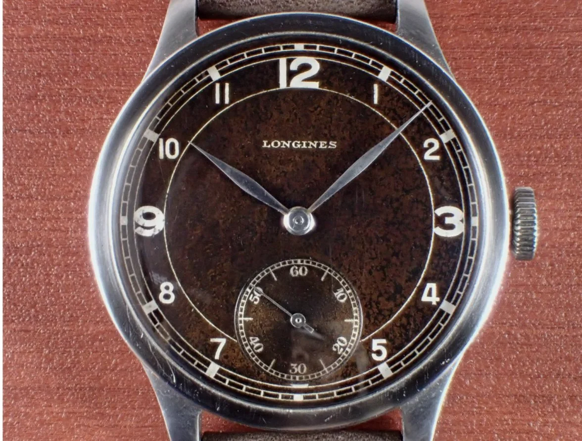

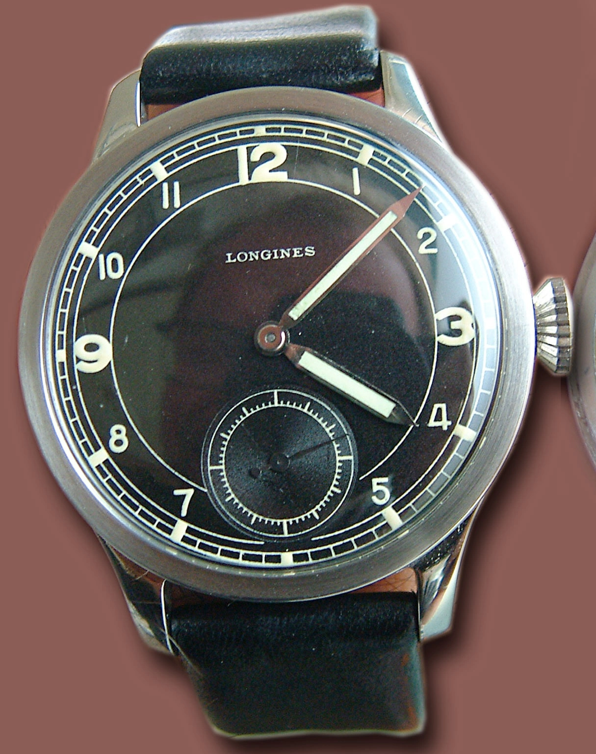

Im 99.5 % sure that this is a redial. Logo isn't correct. Look at this
The S of your example is very strange... Do you have a Macro of the logo?
Indexes are very 'strange' 馃
Seems they have put a layer of luminova in a no lume Dial 馃馃馃

If the dial has been lumed and no lume on the hands is always a red flag.

Agreed but the hands were replaced by Longines during the service

馃馃馃 I think the hands (minutes and Hours) are correct 馃馃

These hands were sent to the seller by L after he complained about the replacement of the original hands.

Strange 馃馃馃 those hands are pretty common in this Longines of 30s first 40s...

It came back from the service with these hands (replacing the original hands, which are now lost)

They converted a no lume dial (no lumed hands) in a lumed dial ... 馃馃馃
I would pass...

I don鈥檛 know the first thing about vintage Longines but my gut reaction to seeing that dial is that it鈥檚 been refinished.

Like @gilb12, I suspect that this dial has been refinished. The signature is atypical, especially the "S". The execution of the sub-dial also looks relatively poor.

Agree that it is refinished, unfortunately. I also suspect that the old hands were original, and may originally have been painted white to match the originally non-luminous dial text (which I鈥檝e seen on several original examples of this style and era of Longines).

I tend to agree with this too
