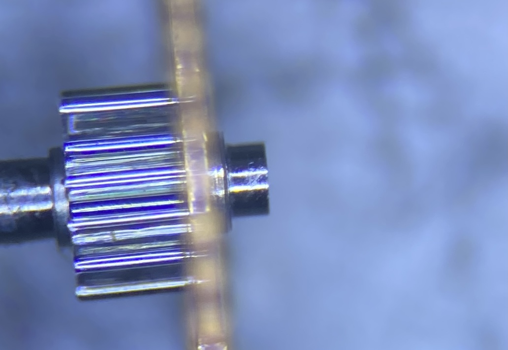

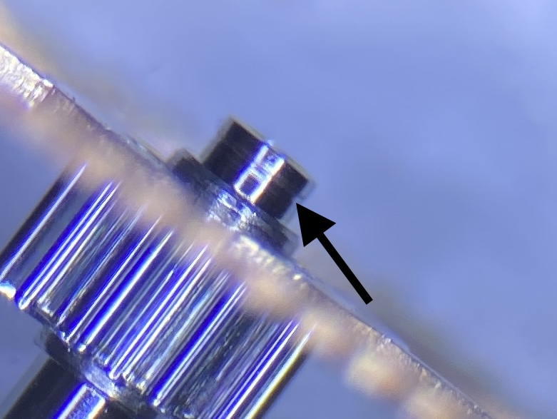

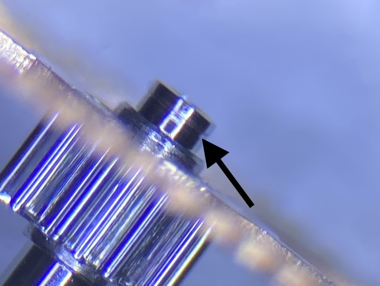

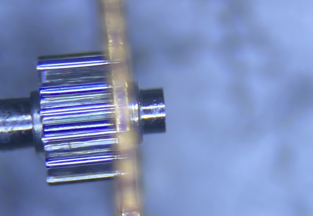

I tend to find a lot of people are very concerned with finding parts as the main problem with this kind of work, and it’s just not. Watchmakers might have access to parts, but they really need to understand how to correctly service a vintage watch. You can find a lot of parts that you will need on the open market, and most people can with a simple google search. But a true watchmaker who knows how to restore vintage watches will have the ability to burnish worn pivots, make and install bushings for worn plates and bridges, etc. So a lot of times - they won’t need new parts when watchmakers who are more ‘parts replacers’ may need them.
I’ll give an example. Here is a centre wheel from an Omega 354. A difficult part to find. Can you see the ring cut in it? That’s a groove that’s basically been cut in the pivot of the wheel. A new wheel isn’t necessarily needed in this case, we can burnish the pivot.
Here is the wheel after the pivot has been burnished. It hasn’t been cleaned yet so you can see residue.
Now, the wear could be too much so that the pivot is now too small and the fit in the jewel/bushing/bridge is too sloppy, but we would cross that bridge when we came to it.
