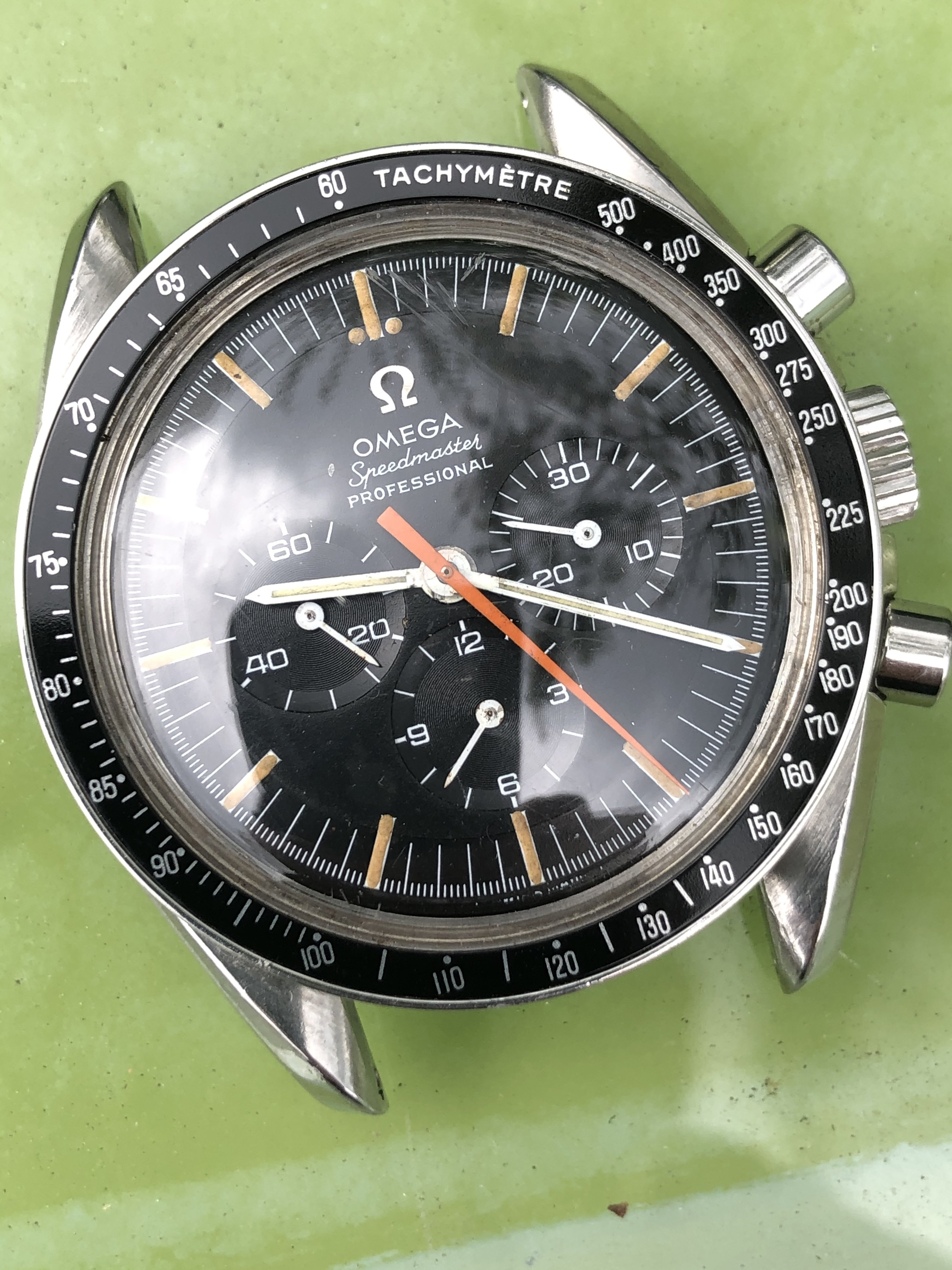

Oh right...
Given the fact it’s been butchered then it’s very probably cobbled together.
I wonder if the donor watch had the orange hand and was swapped over to this one. 😕
This is all very bizarre!

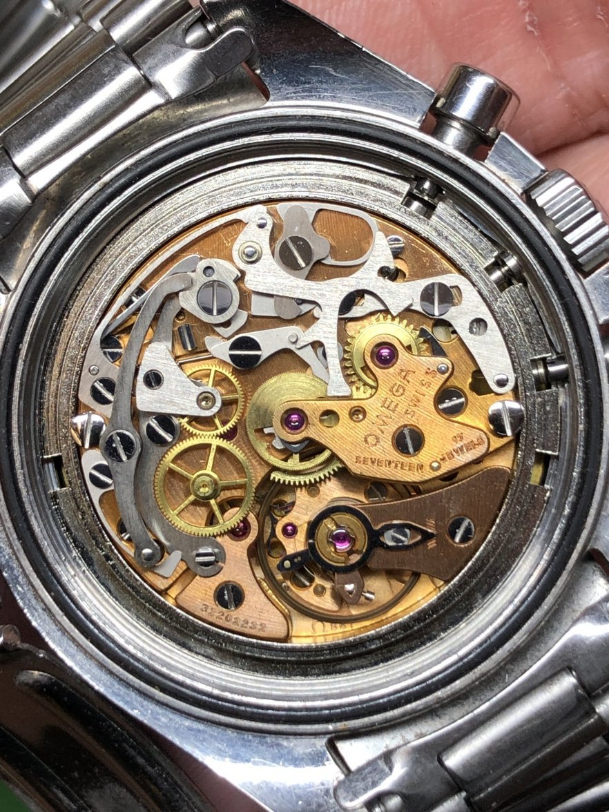

It is pretty straight forward to find out everything you need to know. Take a photo of the dial and back and apply for an Omega extract of the archives. Take a note of the full serial but maybe don't send them a movement photo unless they insist on it, they likely wont. How did you come by it?
7,797
14,399
Lots has changed in the Omega Service world in the 8 to 10 years since they last looked at it. Be prepared for a shock at the restoration price no matter who does the work. Personally, I'd get an Extract first and then plan the way forward.
It's sad to see watches cannibalized and butchered and then sold off to an unsuspecting soul. Knowing how the OP got this watch would be interesting.
2,844
2,440

Just my 2Cs...The more valuable the watch the bigger the mine-field. Best you tread with caution!
36
59

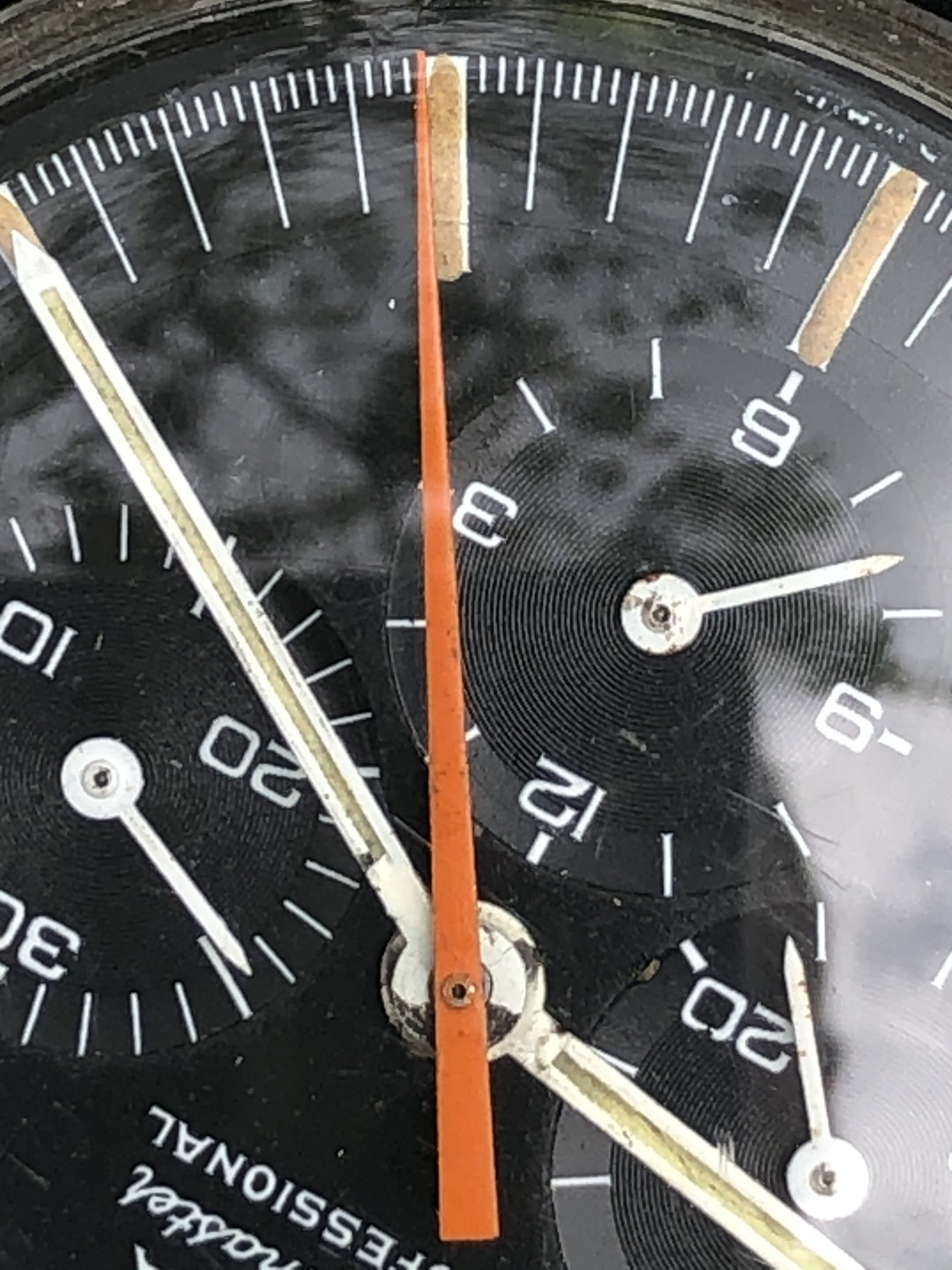

I just had a look at the archive section by Omega and I’ll go down that route first. Thanks!
I’m trying to remember when I actually bought it, i wish I could find the estimate paperwork as that would obviously tell me, but I’m thinking 2009/10
I bought it as a non working watch with the bezel missing and with what I thought was an amateur paint job on the stop watch hand.
This is the first time I’ve read about the orange hand being possibly an Omega option.
After I was told it would be away for a year at Omega I had it sent back and did nothing with it.
I didn’t realise until l saw the comparison to another 321 movement today that lots of parts were actually missing.
It’s in a bit of a sorry state along with half the movement missing and the dial isn’t the best...
I think this will be triggers broom if I go ahead with a service, who knows what that will cost.
Hopefully cheaper than the Rolex Heritage department!

I knew it was a different movement to the 74 Speedmaster and that parts were missing but didn’t realise how many until I saw the pic posted on the forum today.
I’ll admit I’m out of my depth on Omegas which is why I’ve asked so many questions on them...
The 74 I bought recently, it wasn’t something that I was looking to buy but the previous owner had received an offer from watchfinder which he was happy with and then asked if I would be interested in matching their offer as he didn’t want to post it to them.
I normally stick to Rolex so this is all a steep learning curve!

I actually thought the orange painted hand was an amateur job to make it unique for the owner and that they would change it for an original white one when serviced.
