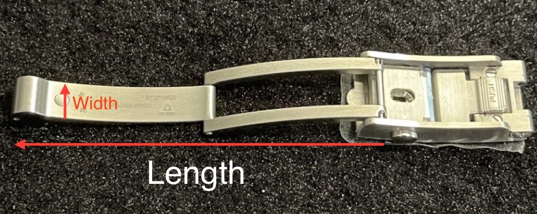

Since you have the Speedmaster 57 bracelet, could you please measure the width of the swing arm and how long it is (in mm ?) For reference below a picture of the Chronoscope clasp from Internet:
The swing arm length of my 50th anniversary bracelet clasp is about 64 MM and the width is about 6 MM at the bracelet connecting link end. Thanks 馃榾

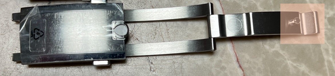

Which of the 2 part numbers above is the one that goes on the end of the clap arm (red shade below)
Regards,
Francisco

Answering my own question, the swing arm of the Speedmaster 57 clasp is 7 MM in width, so it is not a direct fit on the 50th anniversary bracelet (6 MM width) nor on the Speedmaster 321 bracelet (6.5 MM width).
The modification on either case is not that difficult, but would require to file either the Speedy 57 arm or the corresponding 50th anniversary / 321 bracelet interconnecting link 1 MM / 0.5 MM respectively to make it fit.

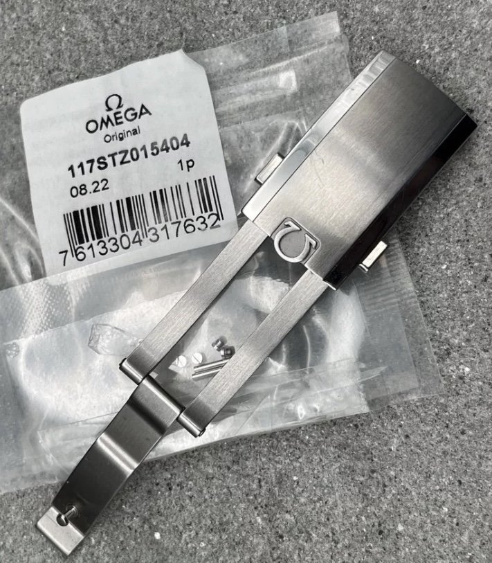

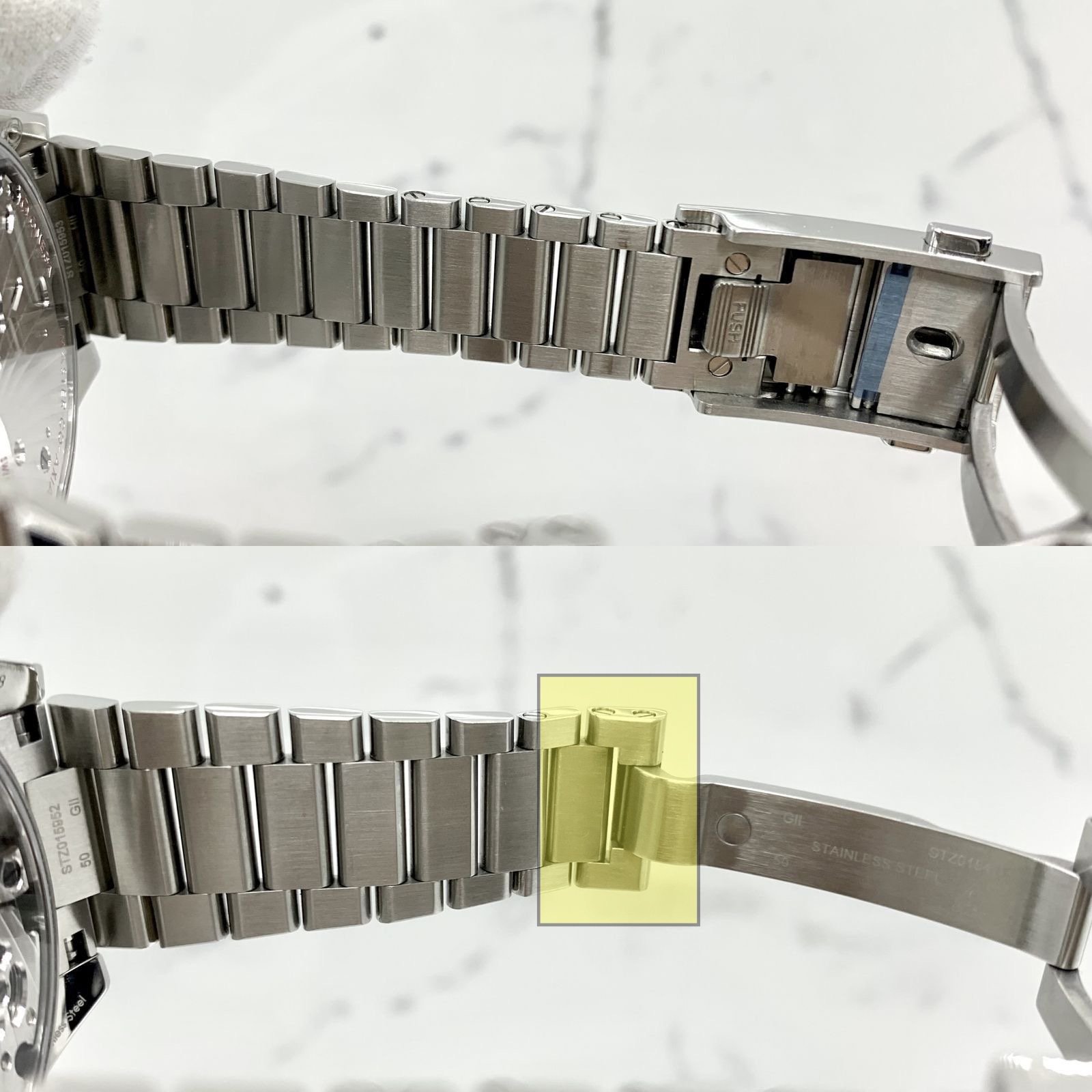

Can you help out in providing the part number highlighted in yellow below (clasp connecting link)? The bracelet is the one from the Speedmaster 57. The bracelet end links are labeled STZ015952; the clasp model is 117STZ015404. We are trying to find out the part number and if it can be ordered from Omega to retrofit the clasp with push button into the 50th anniversary bracelet reference 020STZ011626.
Thanks!
Francisco
