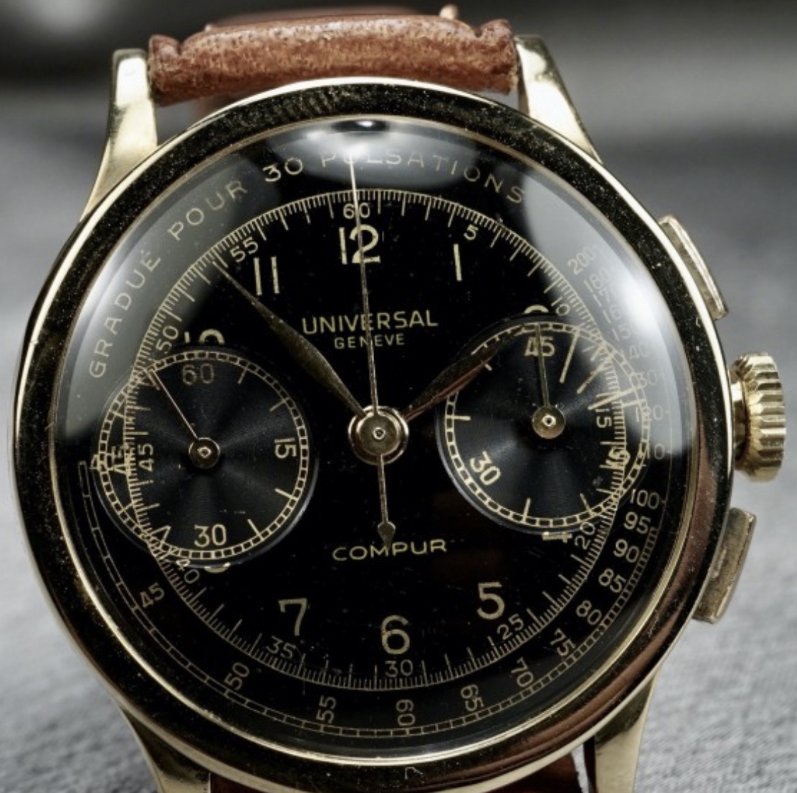

Hi! I wanted to get some thoughts on a 1930’s 30mm black dial compur. This would be my first universal geneve purchase. Seems to be coming from a trusted seller, have inquired about redial, hands, original parts, previous polishes . Looks like a real beautiful unique piece. Does the size worry from a collectibility standpoint?

Completely original, working order, priced at $4,000 but I am negotiating. I was only able to find one other example of this watch online (not for sale)

The watch looks lovely in the photo, but if it's really 30mm you would be disappointed to see it in person. Are you sure that is the correct size? I wouldn't seriously consider a 30mm chronograph unless it was as a novelty, and it would need to be dirt cheap. I couldn't see myself wearing it or even investing in a service.
If your budget is in the $4k range, you can do infinitely better.

I just want to make sure there isn't a misunderstanding about the size. I am looking through Sala's book, and watches with sub-dials similarly situated are more typically 33mm. Even 33mm is quite small (and too small for me), but if you have a very small wrist it might be acceptable to you.

I have a video of the watch on wrist it definitely looks like a 30mm. Dealer says it’s definitely 30mm found one other example online that showed this same watch with a description of 30mm

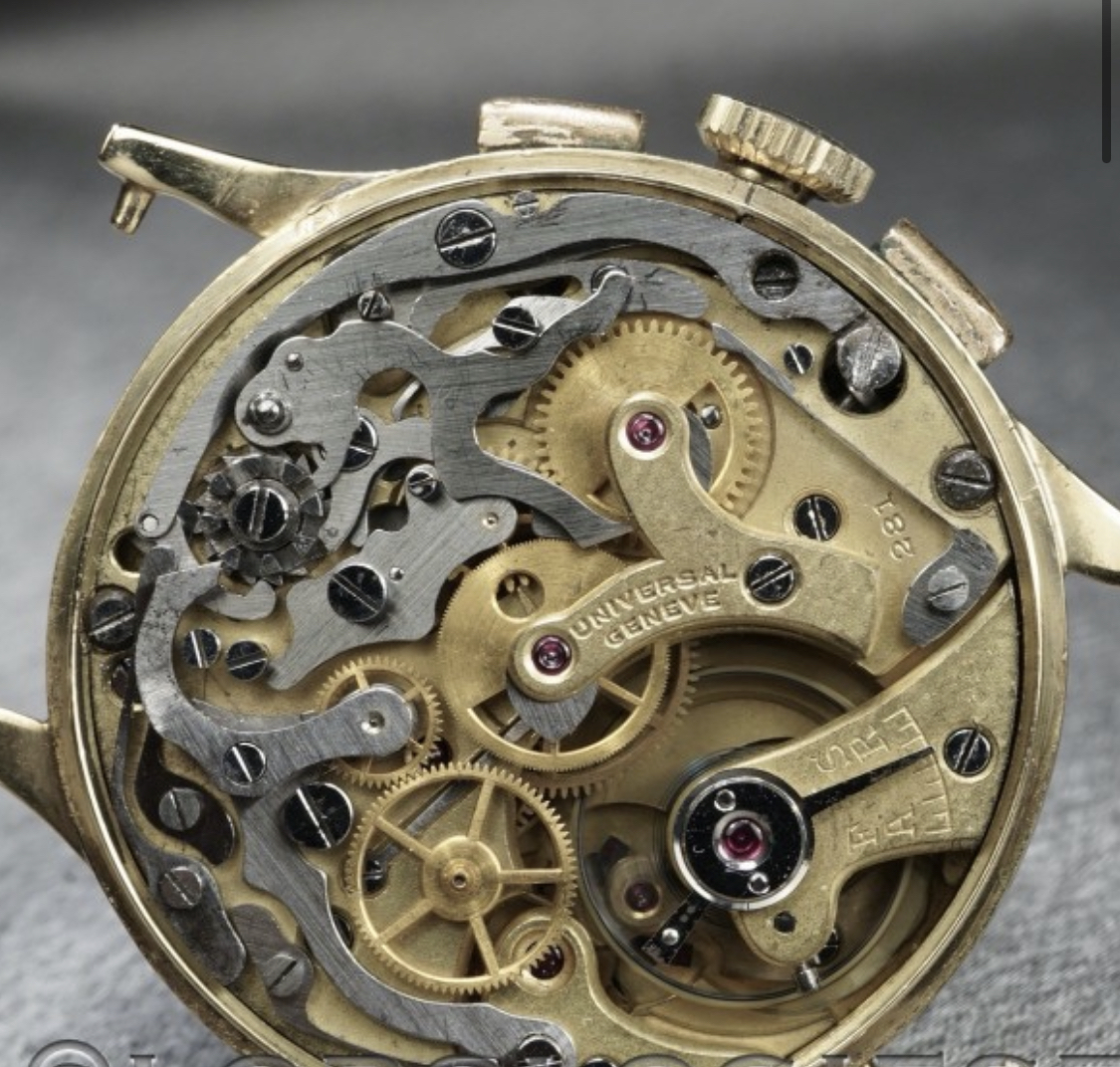

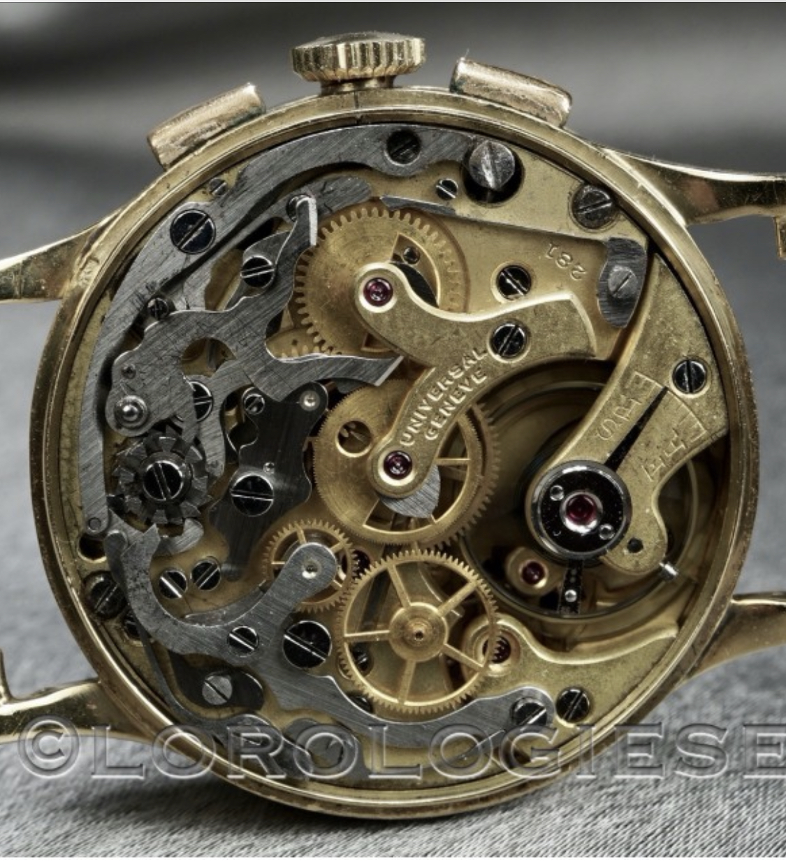

Can we see a movement shot please?
3,677
8,482
Jeanneret case which is cool, but chrono sweep looks wrong and maybe crown replaced, haven’t carefully studied the dial, but I would never buy a watch this small, and it would be extremely difficult to sell, and the asking price is nuts
24,796
55,077
Assuming that the cal 281 is 12''', it does look like the case is probably not much larger than 30-31mm.

Jeanneret case which is cool, but chrono sweep looks wrong and maybe crown replaced, haven’t carefully studied the dial, but I would never buy a watch this small, and it would be extremely difficult to sell, and the asking price is nuts[/
exactly the insight I’m looking for. I am very drawn to this watch but the size is undoubtedly an issue I was trying to look past

I think this is a sub 2000 euro watch that is getting a bump from a rare black dial and the desirable case maker. Questionable chrono hand and way too small. Slow down. Better opportunities will come along.
