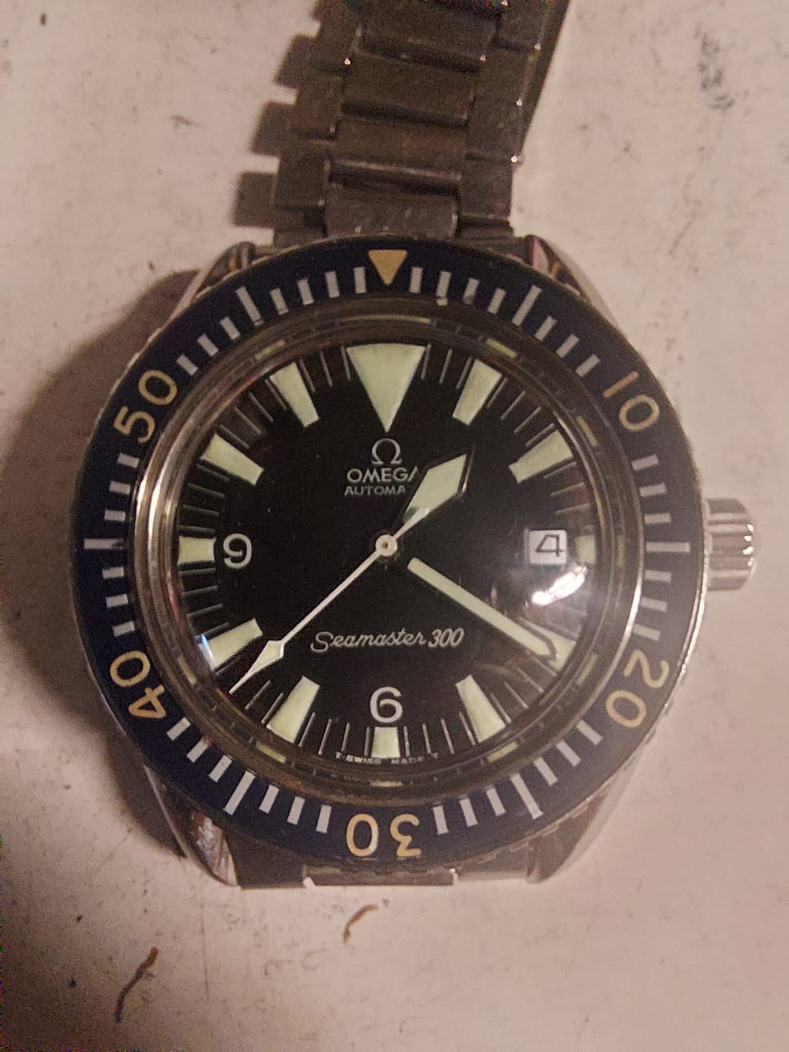

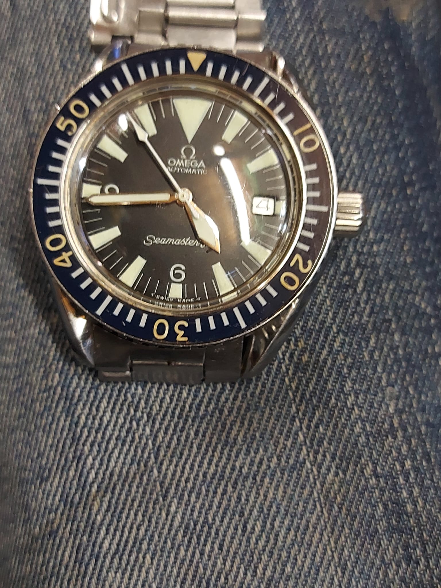

Hi,
Please may I ask for help with this SM300 Big Triangle I have been offered. Any observations welcomed
Cal 565 #2795####, owner says it’s a 1968.
I’m concerned the dial and hands have been replaced?
Also the bezel insert appears blue ish?, I’ve seen this before on other Seamasters on the net, is this the correct bezel for a 68 watch? Are the blue bezels ok
Any comments and insight welcome
786
841
The dial has been refinished and isn’t a factory BT dial.

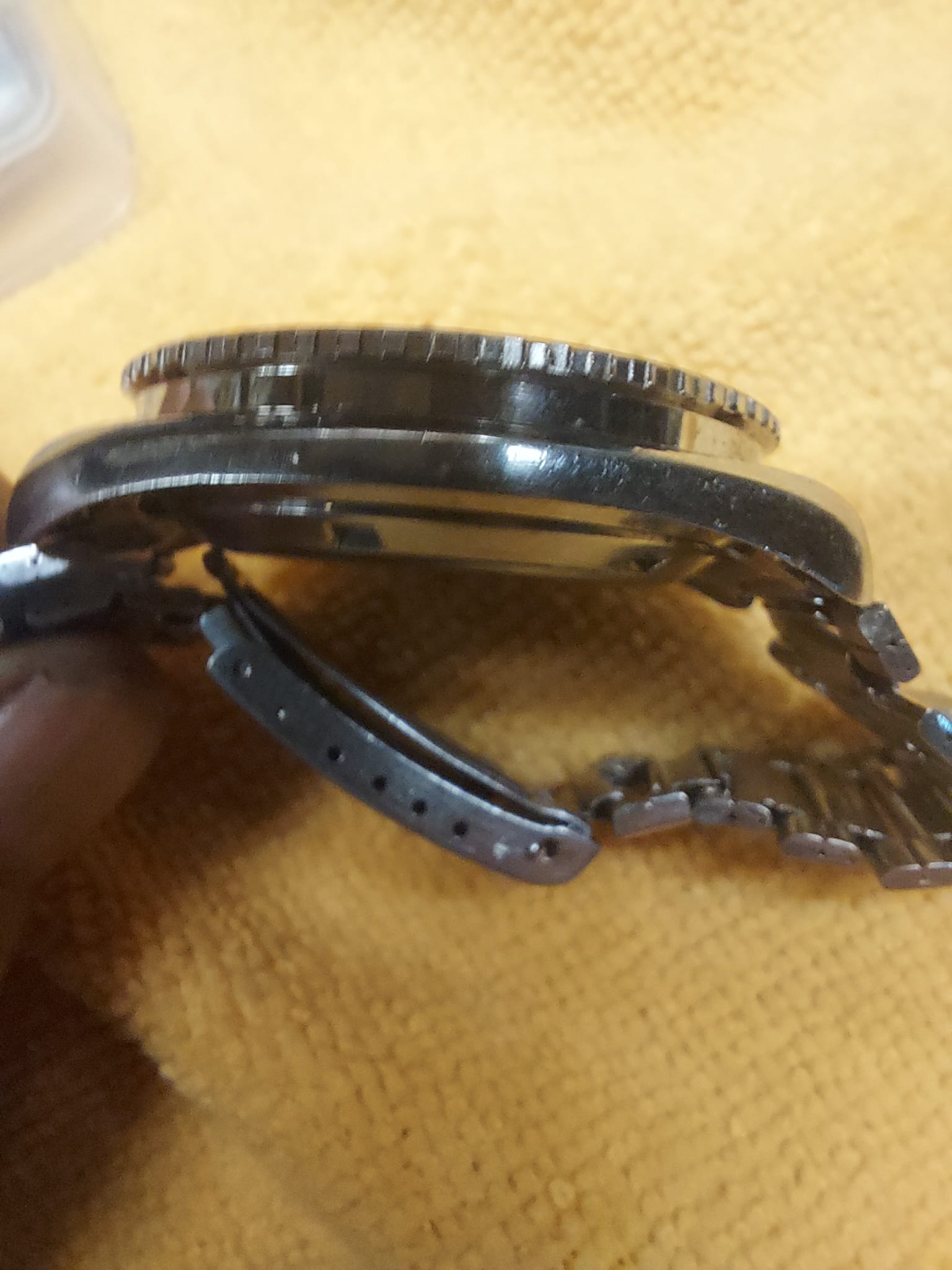

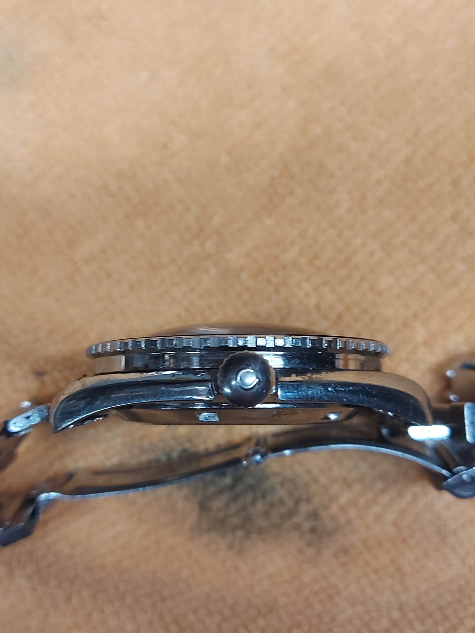

Blue bezels can be okay. Some are a little blue from a “rare” batch and there are some that are black but seem to look slightly blue in photographs. I’m not sure about this one. The insert looks fine, but the bezel seems very thick from the side view

Thanks for your reply,
The dial looks off as it has no line around the date window, and looks re-lumed, but I’m no expert so..
Any further insight into what you mean by re-finished?

Something feels off about the dial. Could be the camera angle.
I have been studying the fonts on these. In some ways the serifs on the fonts look too good. The ink too thick. Could just be the standards then are not what they are now with digital replication. I suspect there is/was a lot of attrition making these dials.
I do agree the date window looks way off.
to me the bezel looks like a 166.073 but i could be wrong
I think they look the same from the front , however the profile and click track is completely different so it won’t fit the 166-024 watch case

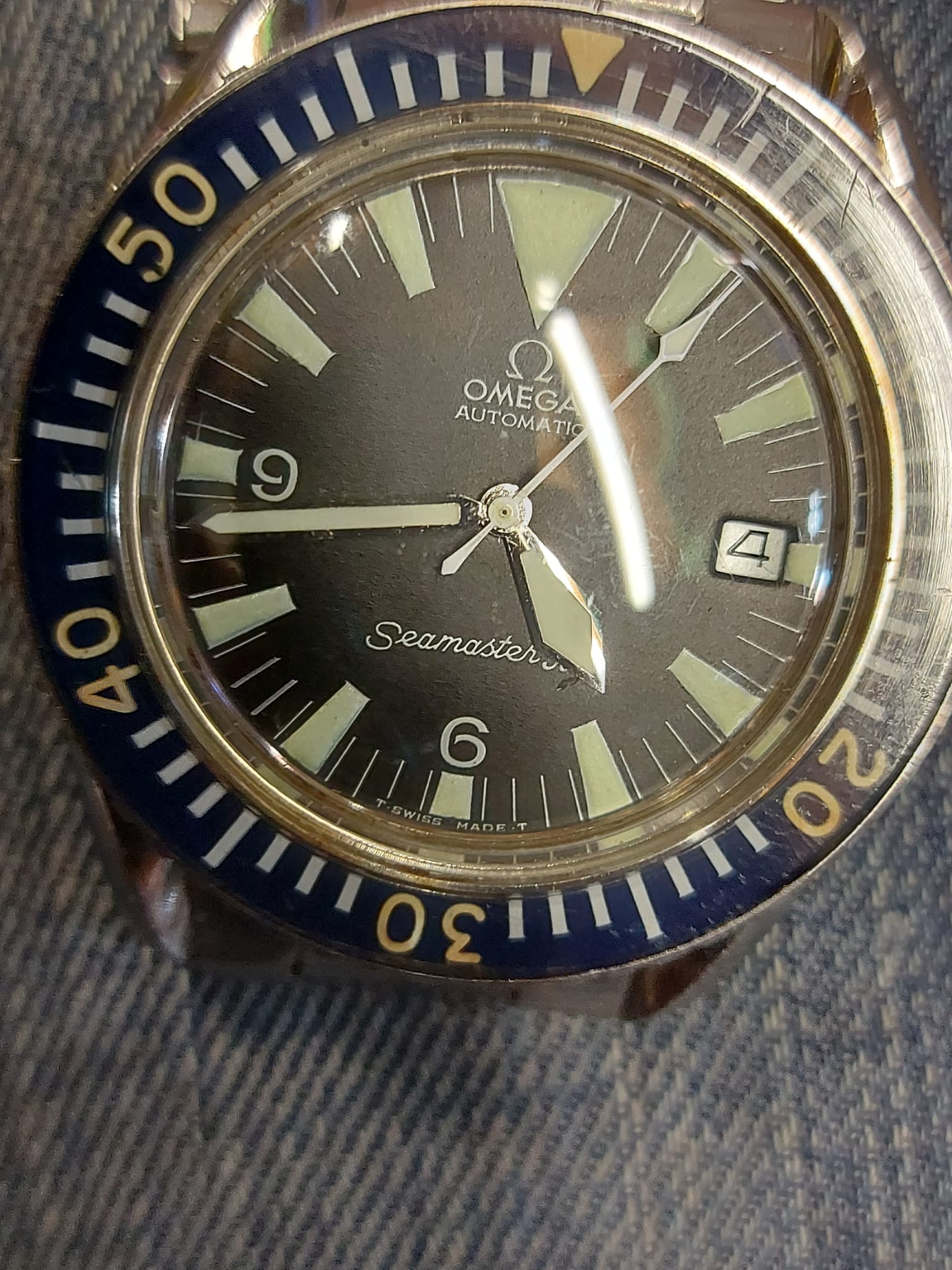

After taking a look at mine, the bezel is fine I think. The case is just so worn and polished that it seems thicker.
Like I said, the dial is refinished. It could be an original brass dial plate, but it was stripped and reprinted by a 3rd party. The hands are modern service replacements. The value of the watch is the sum of the remaining parts because the refinished dial carries no value.

Yes, this is the watch I was offered before it was put on eBay.

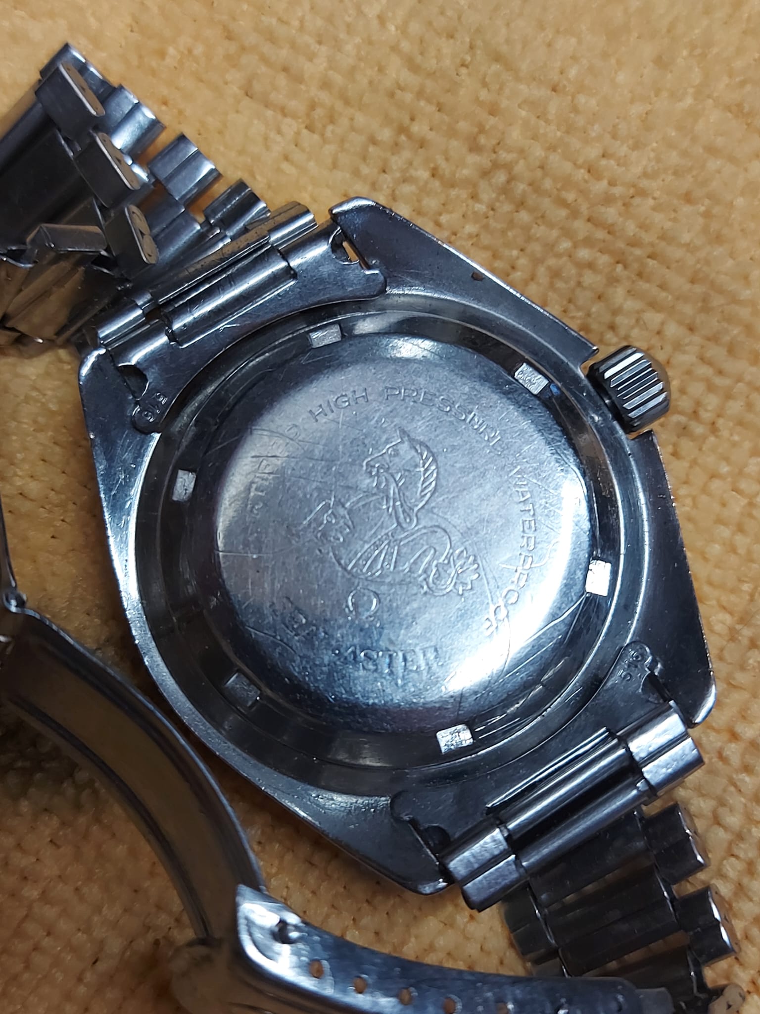

Also I noticed the date wheel is white with black writing, should be black with white writing, so the movement is probably from completely different watch, refinished dial and very worn and over polished case, very worn caseback , basically nice bezel and bracelet, and I think made up of parts.
