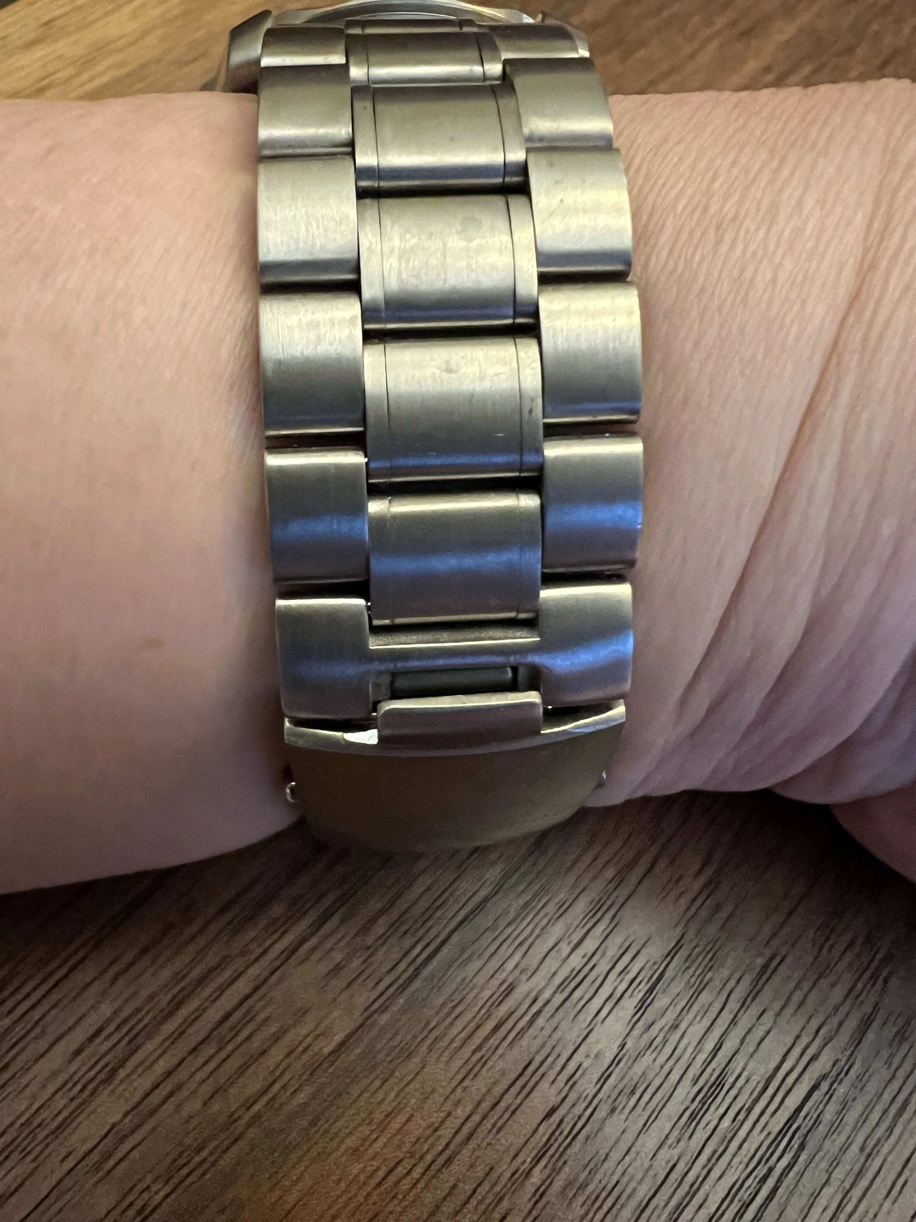

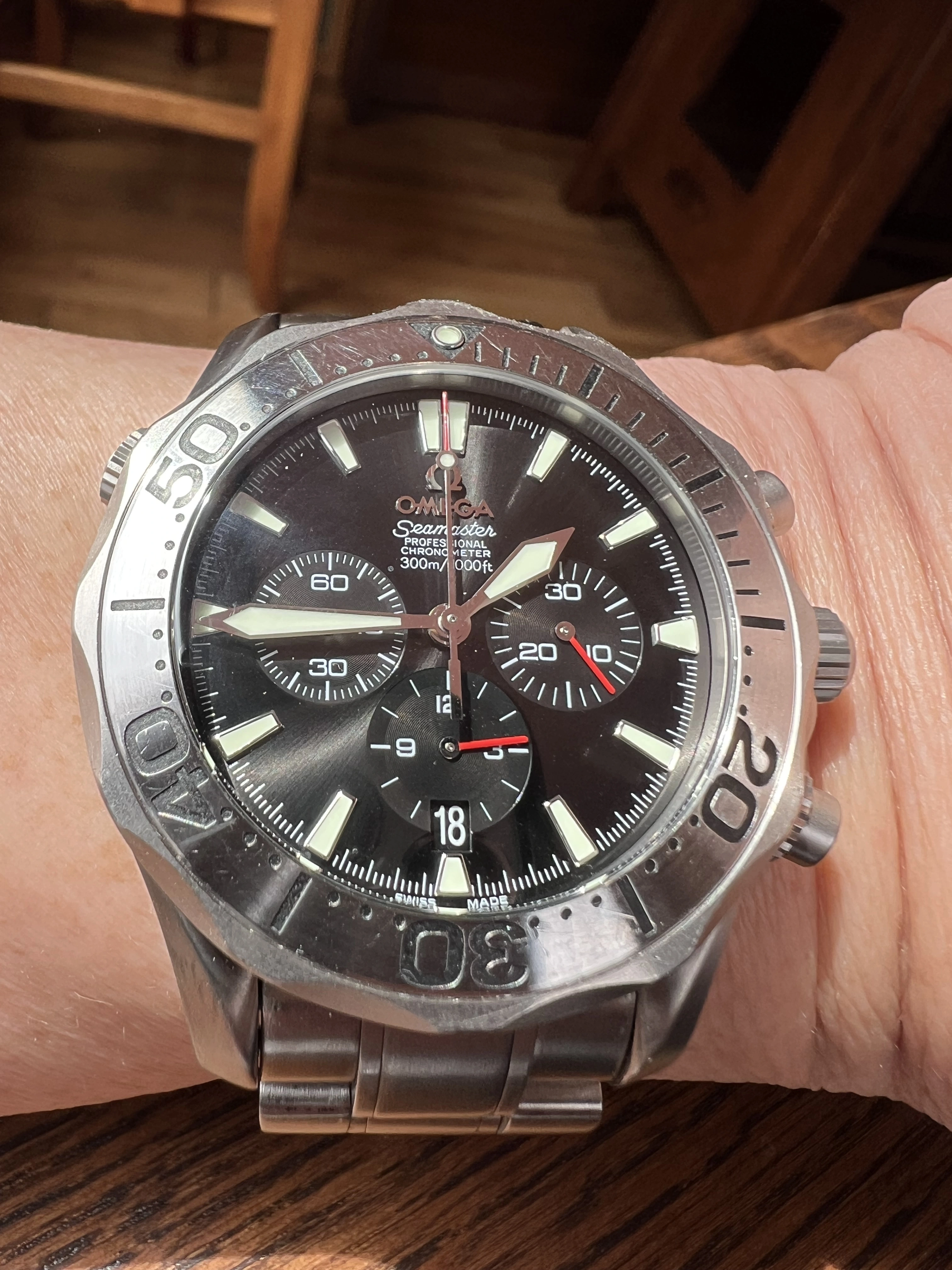

Just bought (yesterday!) this 2nd Gen Seamaster 300M Titanium Chronograph 2293.52 and I really like it, but the bracelet would fit just a bit better with a half link or with an adjustable clasp. I’m a newby here but I have spent a fair bit of time searching for any threads that might have information to let me know if such a thing is possible but I haven’t come up with anything. The bracelet is 20mm with no taper and has pins and not screws. On the clasp is 1613/934 and the end links are TI 934. I don’t see a number on the bracelet so I’m guessing it’s 1613. Is there any way to get a half link or a micro adjusting clasp to work? I guess it’s even more difficult because it’s titanium but I think I could live with a steel half link. Thanks for any help!

I did find a half link online and ordered it. I hope it is the correct part. Still would be really interested in converting to an adjustable clasp, even if brushed steel and not titanium.

I doubt a new adjustable clasp will fit. They require the modern screw and pin system to connect to the bracelet, not the older pin and collar system.
115TI1610 - this is a titanium 1/2 link for a 1610 bracelet from a Seamaster. It is the only one I can see that might work in this situation, as there is no official 1/2 link for the 1613 bracelet that I can find.

I found a 115TI1613 at a place called WatchBandExpert, although the pic shows an Omega bag labeled 114 but the 4 looks overwritten by a 5 so I’m hopeful that a half link arrives and not a regular link. I’m still wondering whether a 20mm micro adjusting clasp could fit as I did see some suggestions that with the right parts the newer screw clasps can be made to work with the older pin type links. I’ll probably have to go to a boutique and be hopeful that they are willing to explore the possibilities. The watch is heavier, even in titanium, than other watches that I’ve worn and the need for a good fit seems to be magnified.
