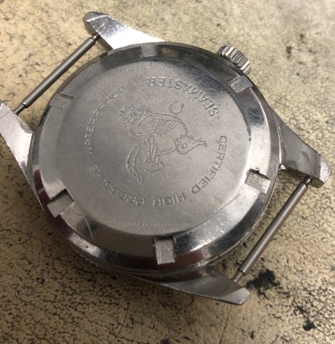

My Dad gave it to me. He owned it since the 70’s
I would like to have it serviced.
But do not want the case polished.
And do not want to restore the appearance.

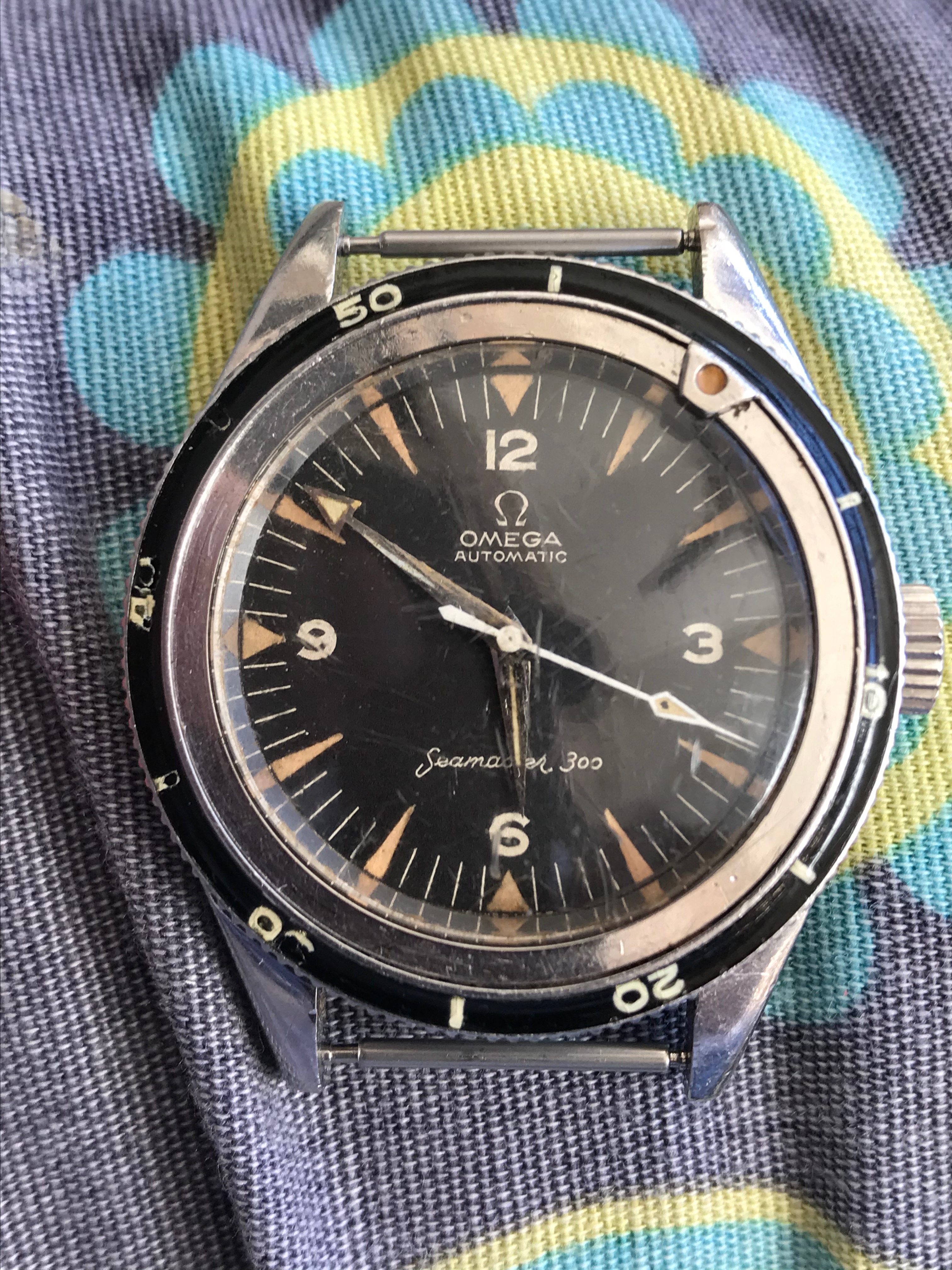

Known issues:
Stuck bezel. May need bezel spring. Can it be fixed?
Clean and tune.
Runs fast by 1-2 minutes a day.
Replace seals.

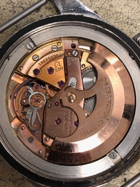

It has a 550 movement, which I believe, is supposed to be 17 jewels, but you can see 24 jewels when you open the back. If it has been hacked inside, it would be nice to get it back to original, I’d appreciate your thoughts on this.
Here is a description and photos for your evaluation. (apologize for photo quality)
Please give me your feedback.
Trying to research this watch has given me severe information overload.
It has been a challenge to figure out what is, and it's value.

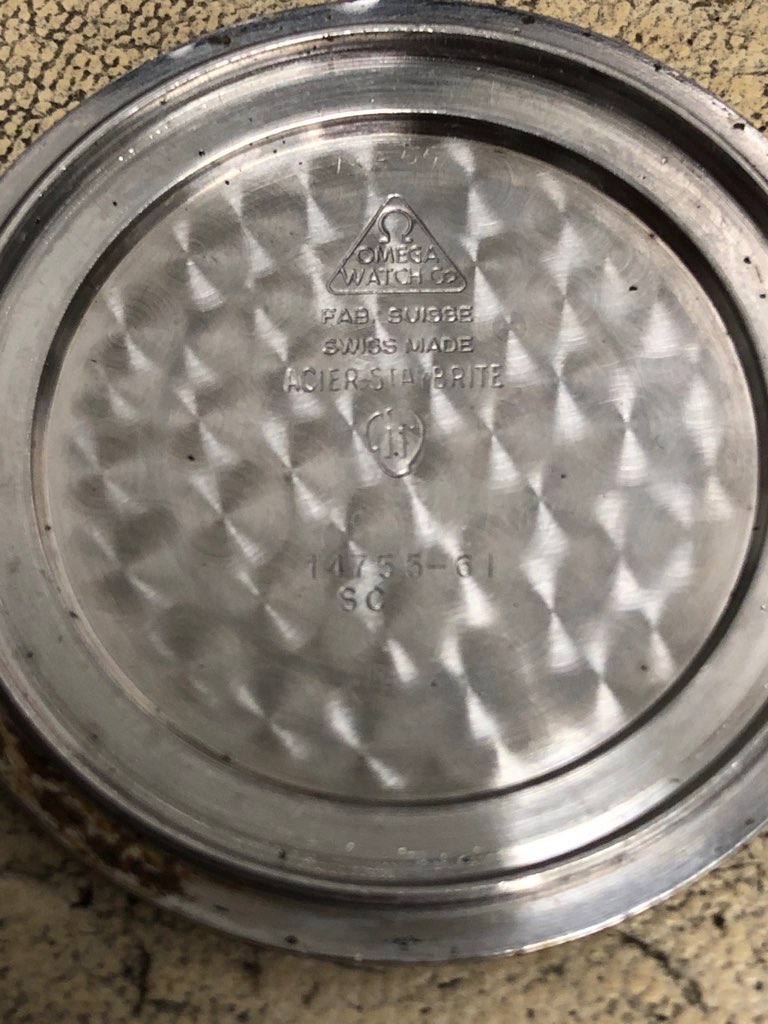

Omega Seamaster 300
14755 - 61 SC (inside case back)
Long arrow minute hand
Dauphine hour hand
Long Point “Teardrop” Second Hand
Caliber 550
Thin Bakelite Bezel
Can see 550 on the train wheel bridge and 24 jewels on the upper bridge.
Swapped Parts? (US Distributor, Norman Harris Oddity) 17 jewel due to tariff laws?
I believe the Serial # is 1963XXXX
Kindest regards,
David

We will need many, in focus, high resolution pictures to be able to offer any advice. Inside and out.
Taken in natural light, outdoors
4,593
10,813
The movement in that watch is of little consequence as the value is in everything else. I would be VERY careful picking who will service the movement as it's the least valuable component but will put everything else at risk as servicing it will require hand and dial removal. That is where the danger lies. Sorting the movement to original specs is only going to increase the value of that watch by a few hundred bucks. Do it only if you have your heart set on wearing it. If not then sell it as-is or let the thing sit as an heirloom.

Honestly if it was my watch, and this is just me, I would wear it once in a while and without servicing it as I'm too squeamish about dial and hand damage on rare old watches, especially that one where the movement is relatively inexpensive to overhaul compared to replacing an irreplaceable dial.

I don't want to sound like a broken record but if it was my watch I would leave that delicate bakelite insert bezel alone. The last thing I would care about is whether it turned. I would be afraid of breathing near it 😁
