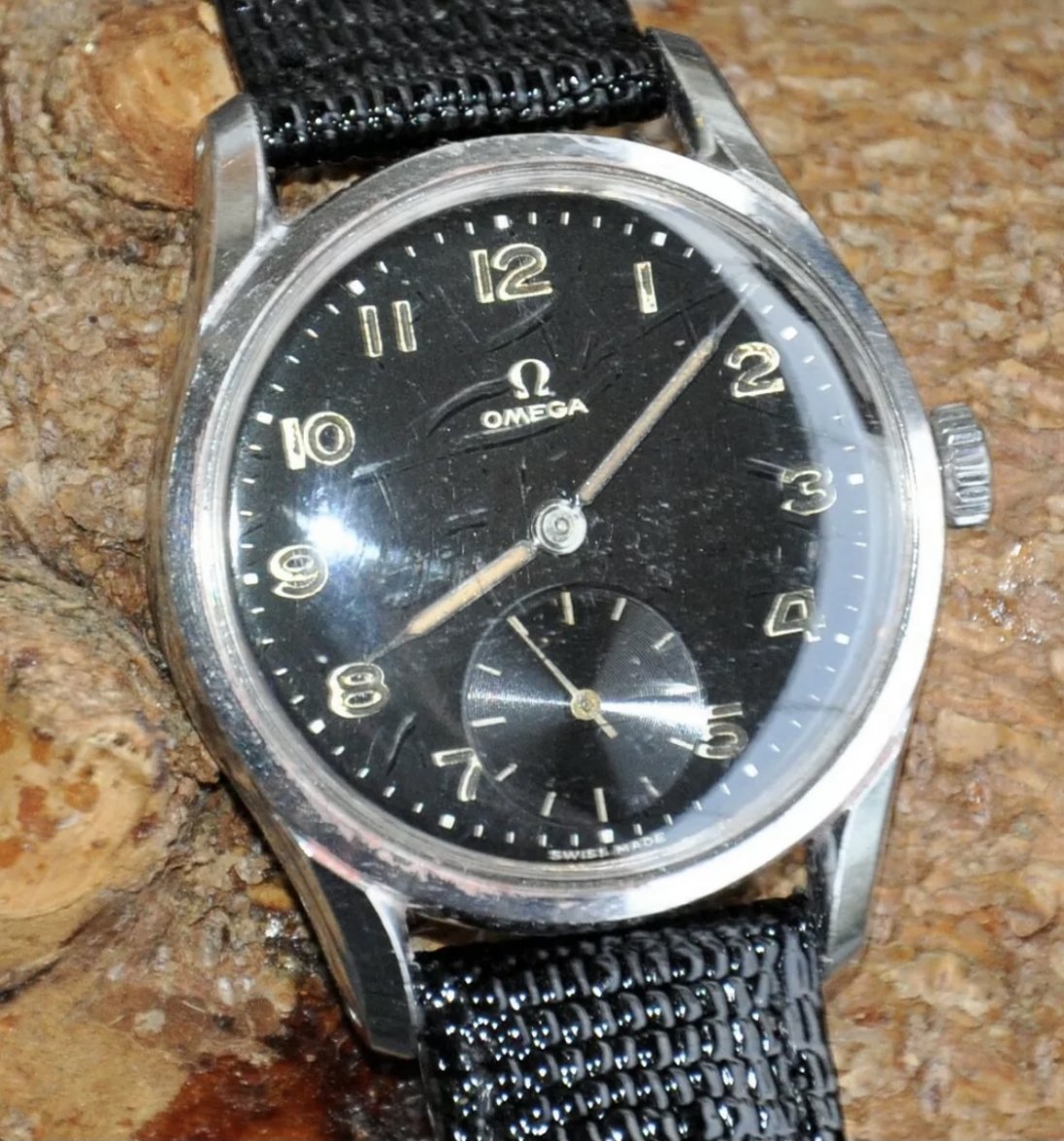

Hi all,
What are your thoughts on this 2639’s originality? It is described as untouched and the pictures are blurry but is there any major red flag I’m missing?
Thanks!
the lume on the dial’s dark coloration is a sign of water damage? If so, how could the hands not be affected...?

Looks ok to me. Maybe crown is replacement, hard to say from that view.
Hands where probably replaced during a service long time ago.

Looks great to me. I agree with above comment I think the crown might have been replaced but that’s not bad.

Thanks, it looked great but the auction ended before I had enough info to dare to make a bid...It went for 575€ which seems pretty ok to me
